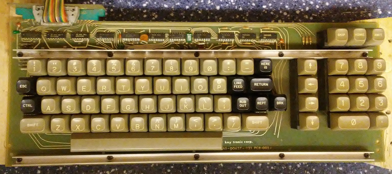

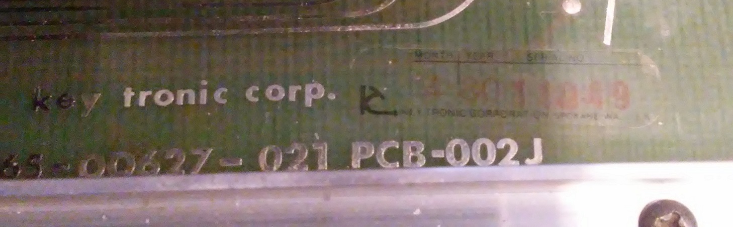

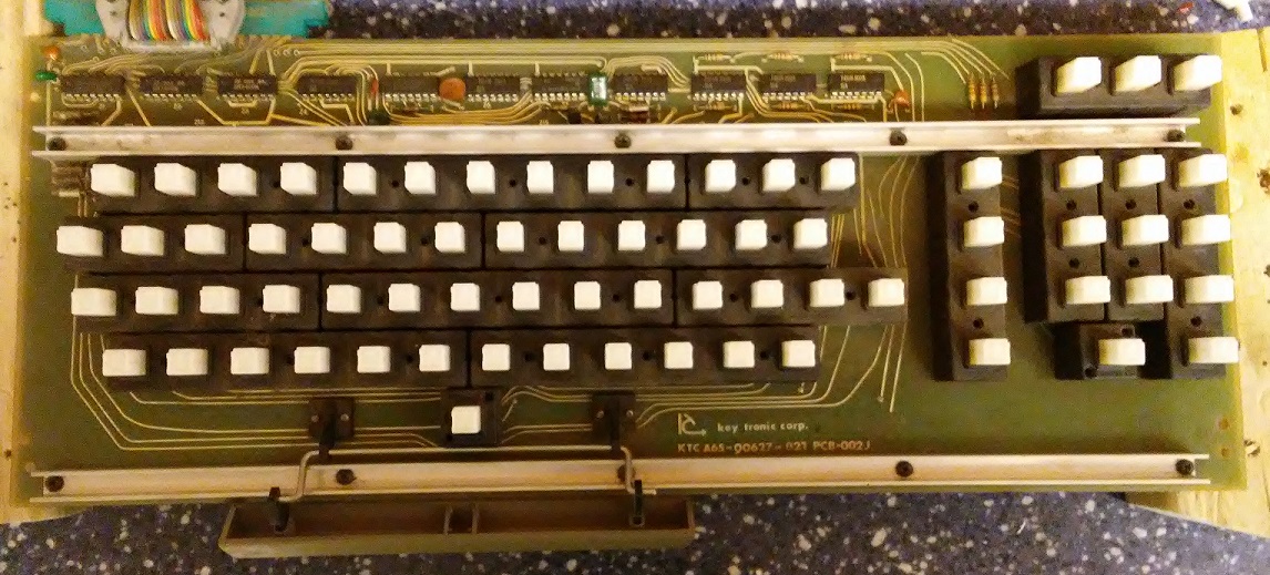

I recently acquired a KeyTronic magnetic reed switch board. No case just the internals.
It's hard to read in the picture, but it carries a sticker dated 4/80.

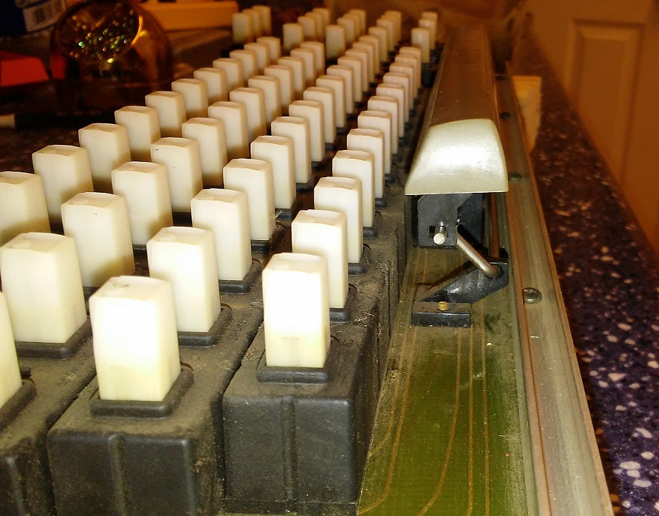

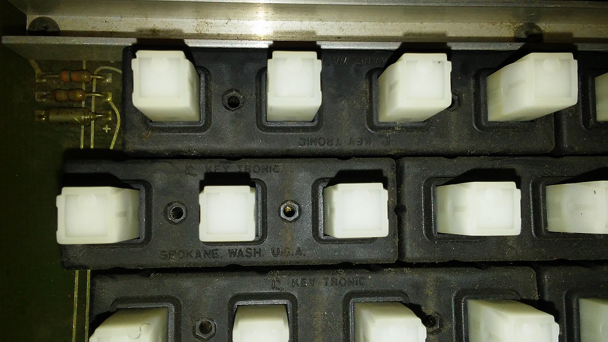

They are difficult to see but you can make out one of the reeds in this picture:

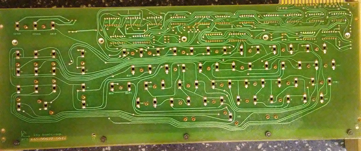

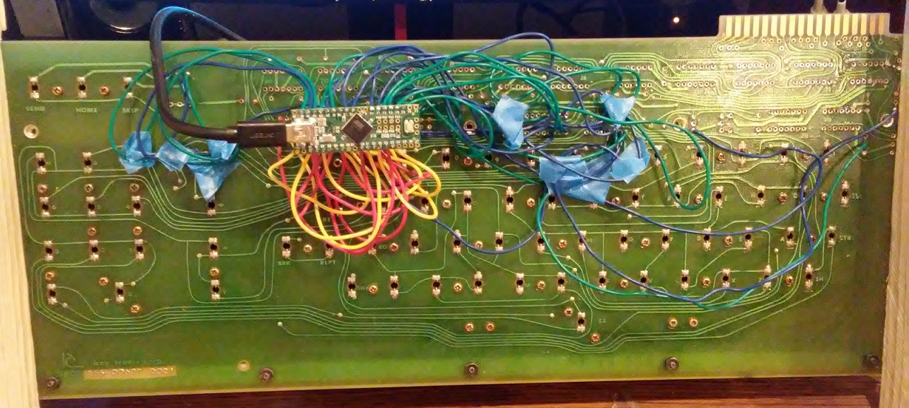

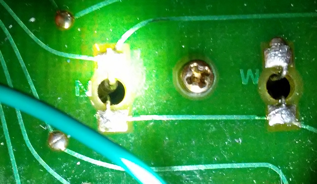

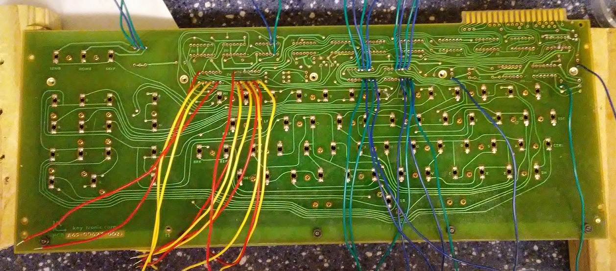

It took a while to trace out the matrix because there was either some sort of clear solder mask or epoxy type resin coating both sides of the board, including all the electrical contacts and I had to scrape it off each of the key contacts. Once that was done it wasn't too hard to figure out . A number of system keys were on their own columns and I ended up bridging them to other columns that had open spaces on their rows in order to save pins on the Teensy. Otherwise even the Teensy++2.0 would have been a bit tight for pins.
I really like this board! It's working nicely and I typed this post on it. The switches are quite smooth and have a nice "clack" to them. I think my next project is going to be fashioning some sort of wooden case for it. It's interesting looking as is but a nice case would be a plus!

Wow, overkill space bar mechanism to deal with the height of the switches!

The switches are smooth and if by stiff you mean that the springs are on the heavy side - they are. By the highly scientific nickel test they are somewhere between 65 - 70 gm. I like them!
And yes the space bar mount may be somewhat over engineered, but it sure works well - very stable and easy to take the space bar on and off.

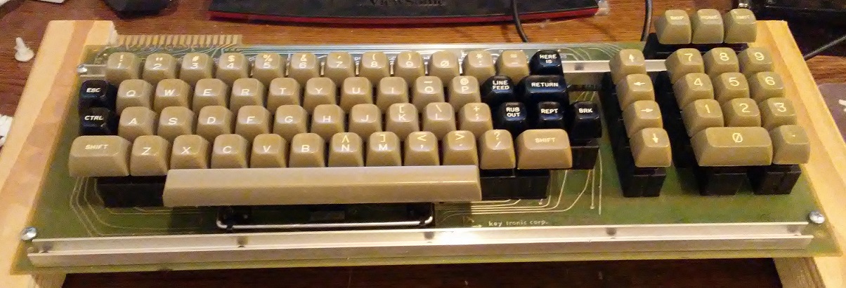

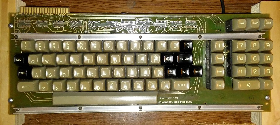

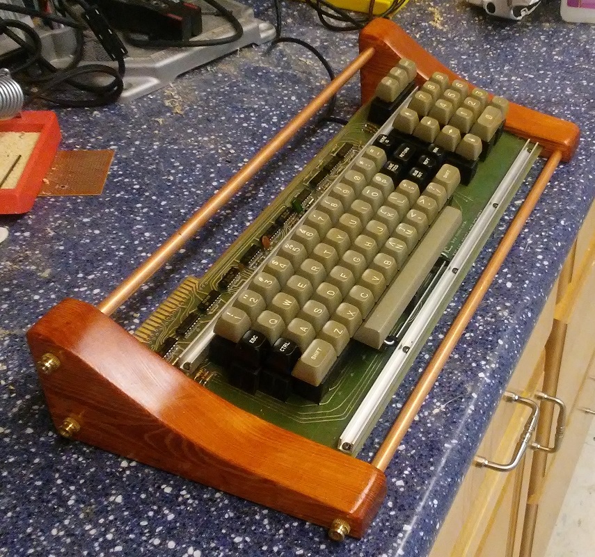

Well until I potentially invest in a real front panel like Sangdrax suggested, I went ahead and made a wooden frame case that at least holds the board at a proper angle and does look better than two flat pieces of 2x4. Also, I had to desolder all the ICs, resistors, caps, etc. in order to cleanly isolate the rows and columns for connection to the Teensy, but didn't particularly care for all those bare solder pads. So ... file this under anal compulsive ... I covered the IC pads with little Mylar rectangles, then trimmed the all the IC legs, resistors, etc. and put them back in place with dabs of clear silicon calk (so no electrical contact). Ok maybe it's a little nutty to do that, but I think it looks better.
28 Oct 2017, 07:38

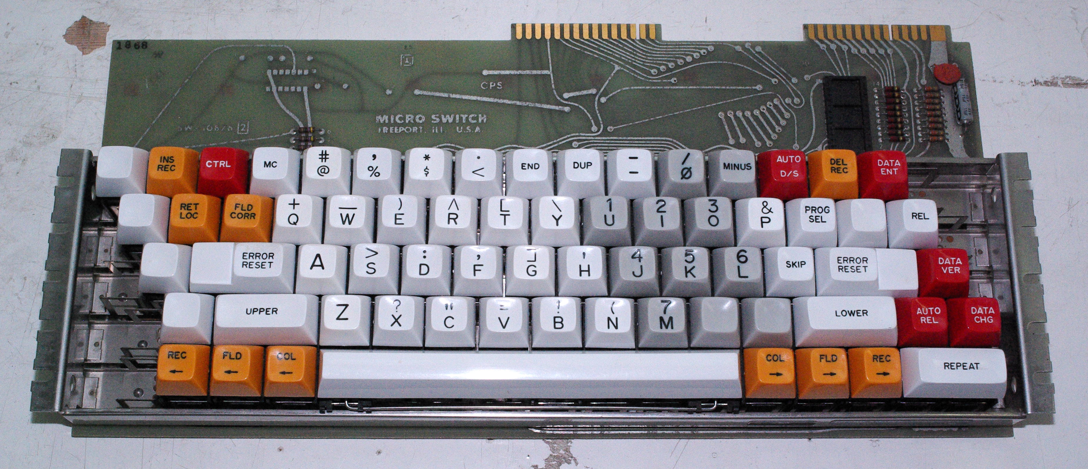

OldIsNew wrote: Well until I potentially invest in a real front panel like Sangdrax suggested, I went ahead and made a wooden frame case that at least holds the board at a proper angle and does look better than two flat pieces of 2x4.
Oh,what an elegant solution. I have several vintage keyboards that lack a case, this Micro Switch would be my first choice for a custom case:
keyboards-f2/micro-switch-sw-10876-t112 ... o%20switch
