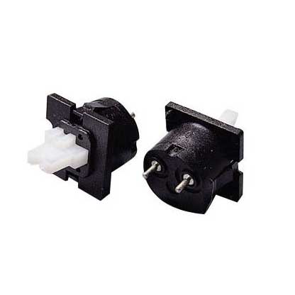

Futaba used two keycap mounts: cross and bar. The bar mount has that notch in it. You can see bar mount ML here:
http://www.epartshub.com/company/compan ... =SR0002189
Yours both have correct mould numbers and appear to be real.
I have what seem to be clones of both the black and white ones, since they have distinctly different mould numbering.
Don't take them apart for comparison unless you don't mind destroying them, as they tend to break when you open them up.

Daniel Beardsmore wrote: Futaba used two keycap mounts: cross and bar. The bar mount has that notch in it. You can see bar mount ML here:
Unfortunately the page isn't loading. I notice they where those switches in particular when I opened one. By the way, I wouln't open the black one.
21 Oct 2017, 22:42
This is the image:
ML88 image from ePartshub
Futaba colours remain a complete mystery.
