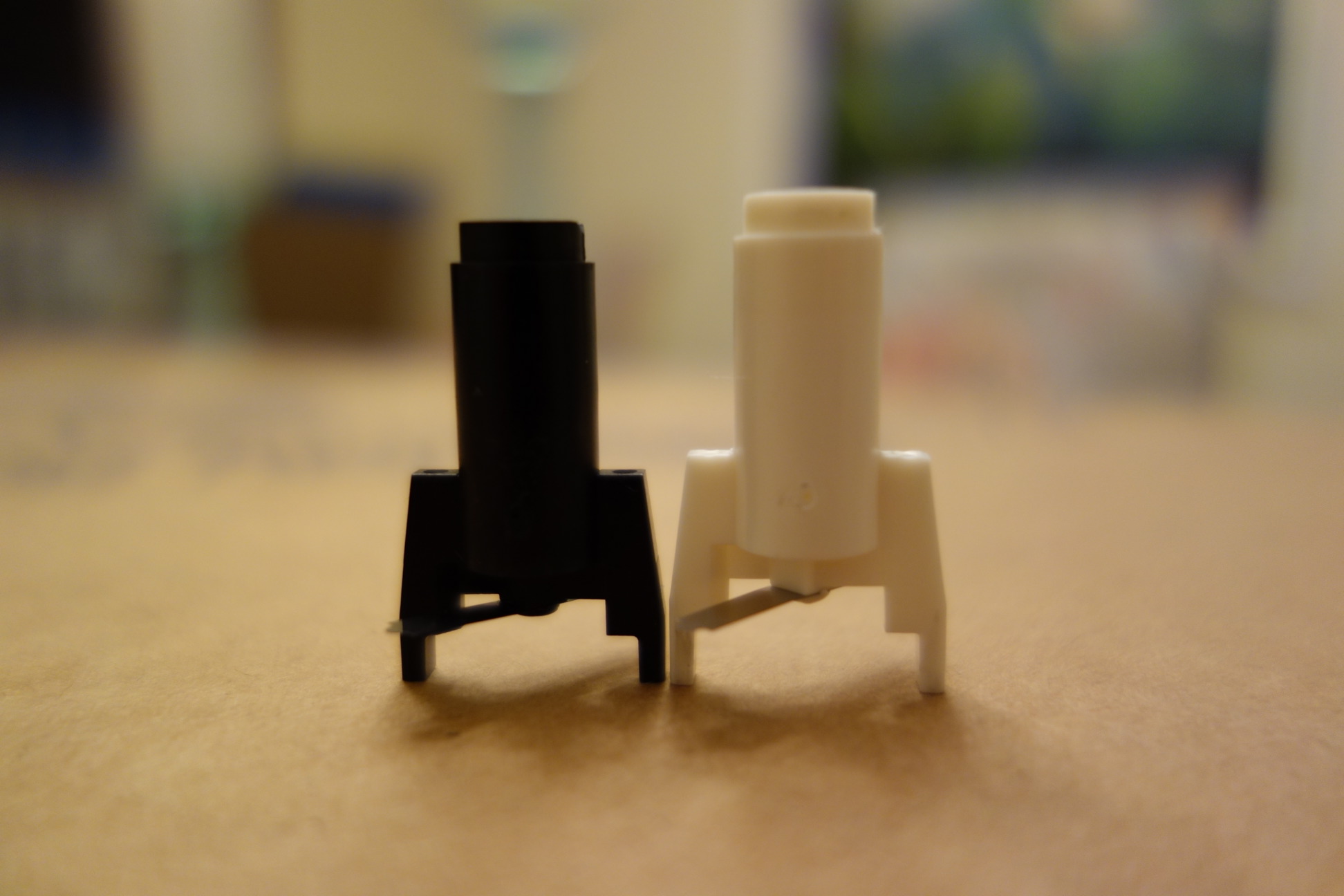

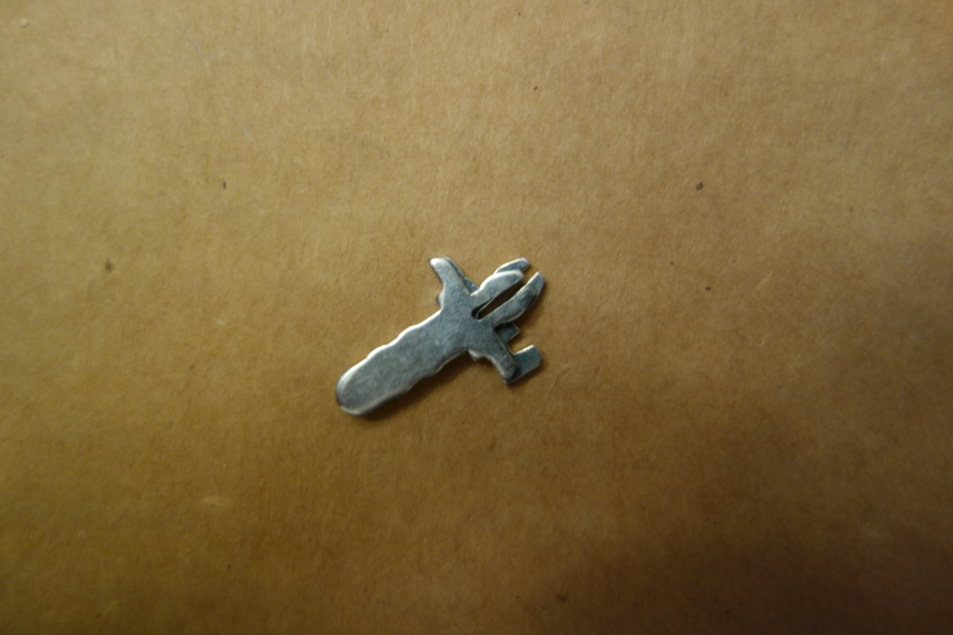

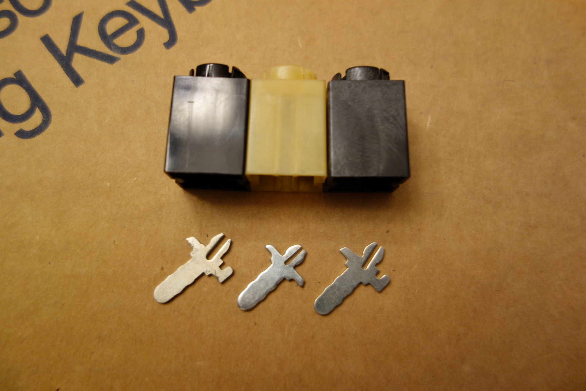

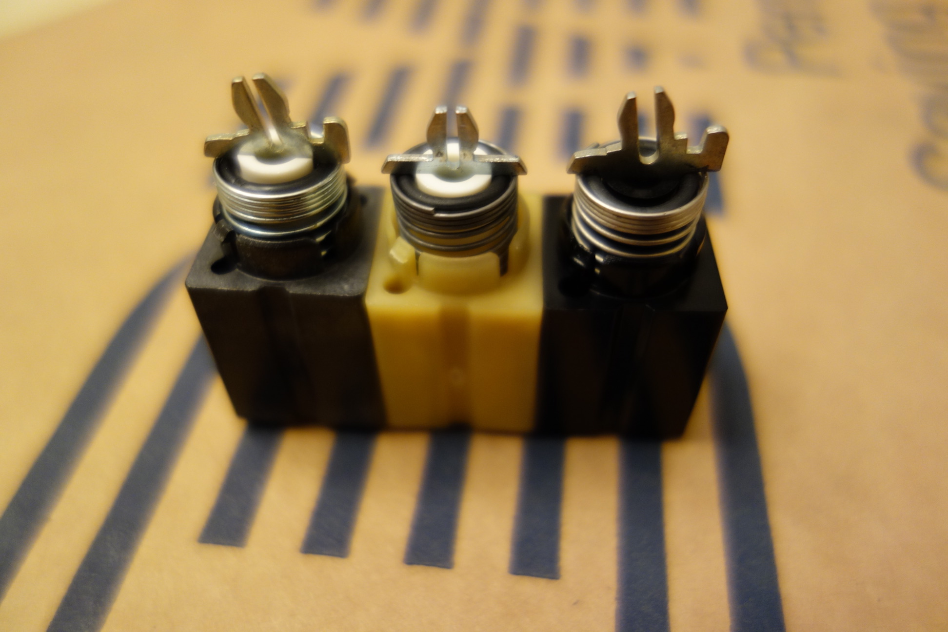

Well, since you asked about beamsprings switch variations, here is my contribution:
I plan to make a thread purely about beamspring switch variations eventually :)
Never seen yellow stems before. Oddly enough, the black stems were found in a 3277 66 key (Not from Scottex's Batch) and they all were that color on that board. It was also odd in that there was no dust shield and the barrel plate was painted black as well, apparently from the factory? The wider slit stem came from that 3277 as well.
Interesting thing about the black stems is that they actually have different dimensions as you can see, so they came from a different mold as well.
The shorter non-angled straight stems are what Datastations and presumably other desk-type beamsprings use.
The yellow housing pictured came from a Datastation, but there were only two on the entire board like that interestingly enough.
