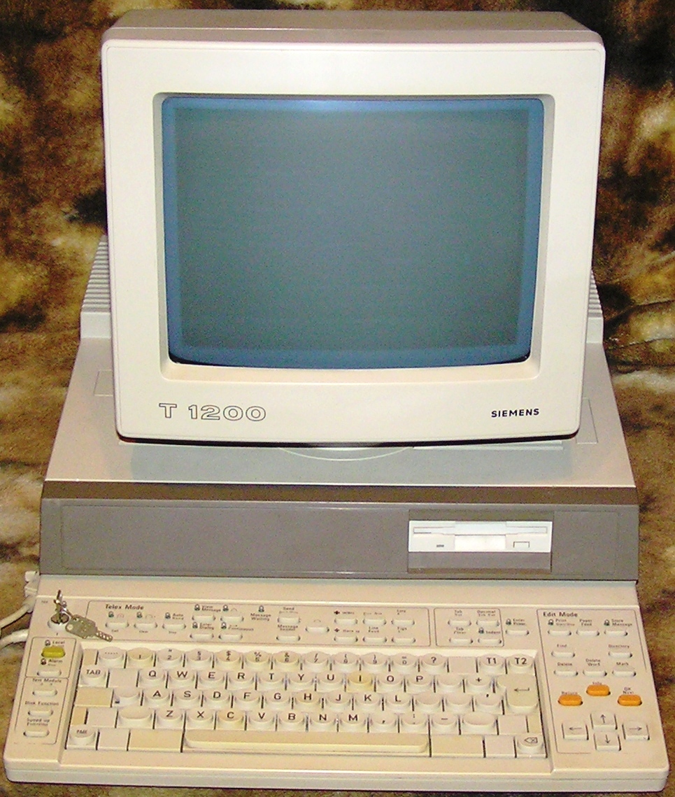

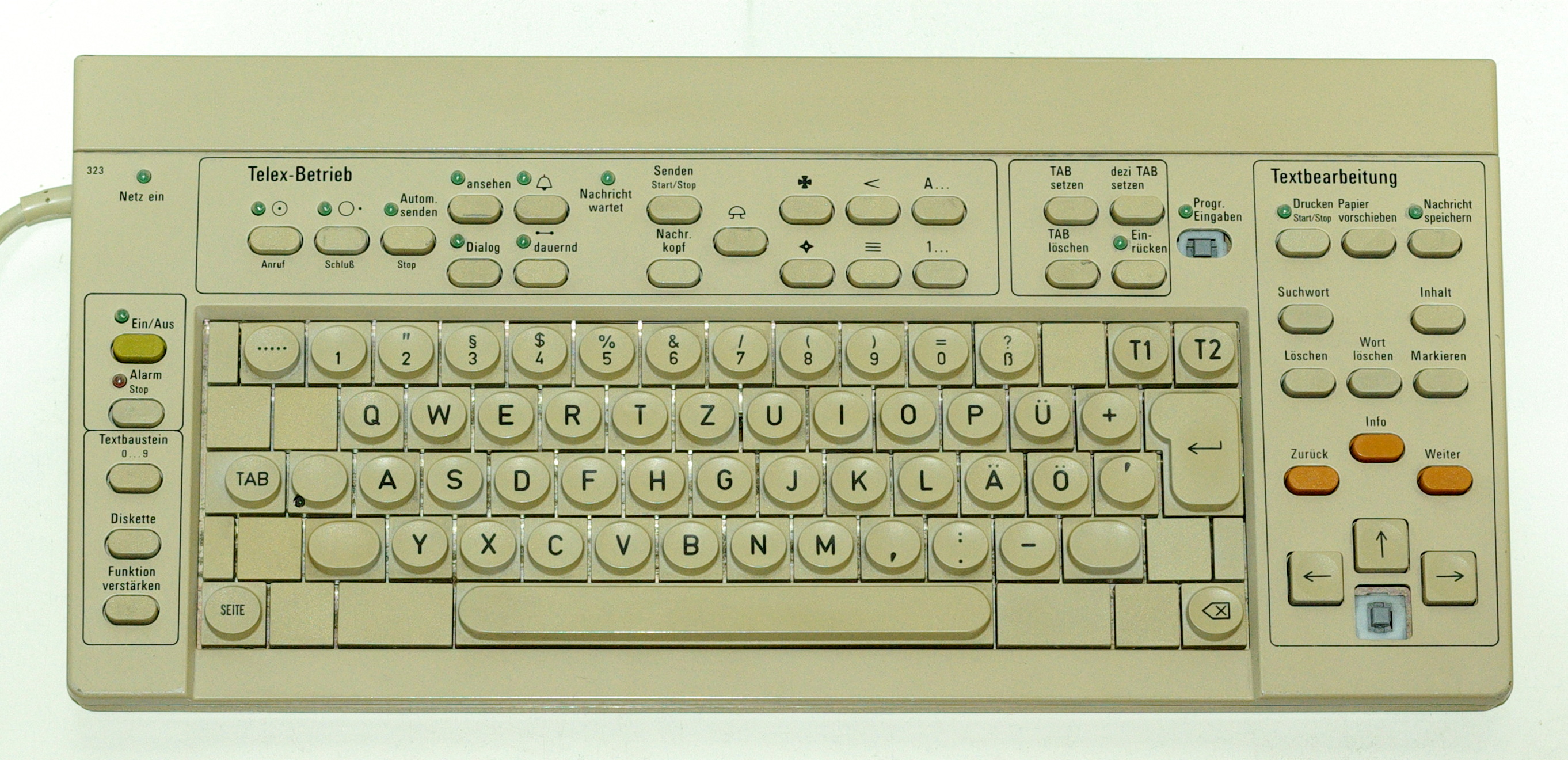

This is the keyboard for the Siemens T1200 Teleprinter although from what I have seen there were different versions not sure which mine is, notice that mine does not have the lock at the top left!
Siemens TABS1200 front.JPG (963.79 KiB) Viewed 4864 times

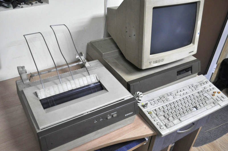

Not mine:

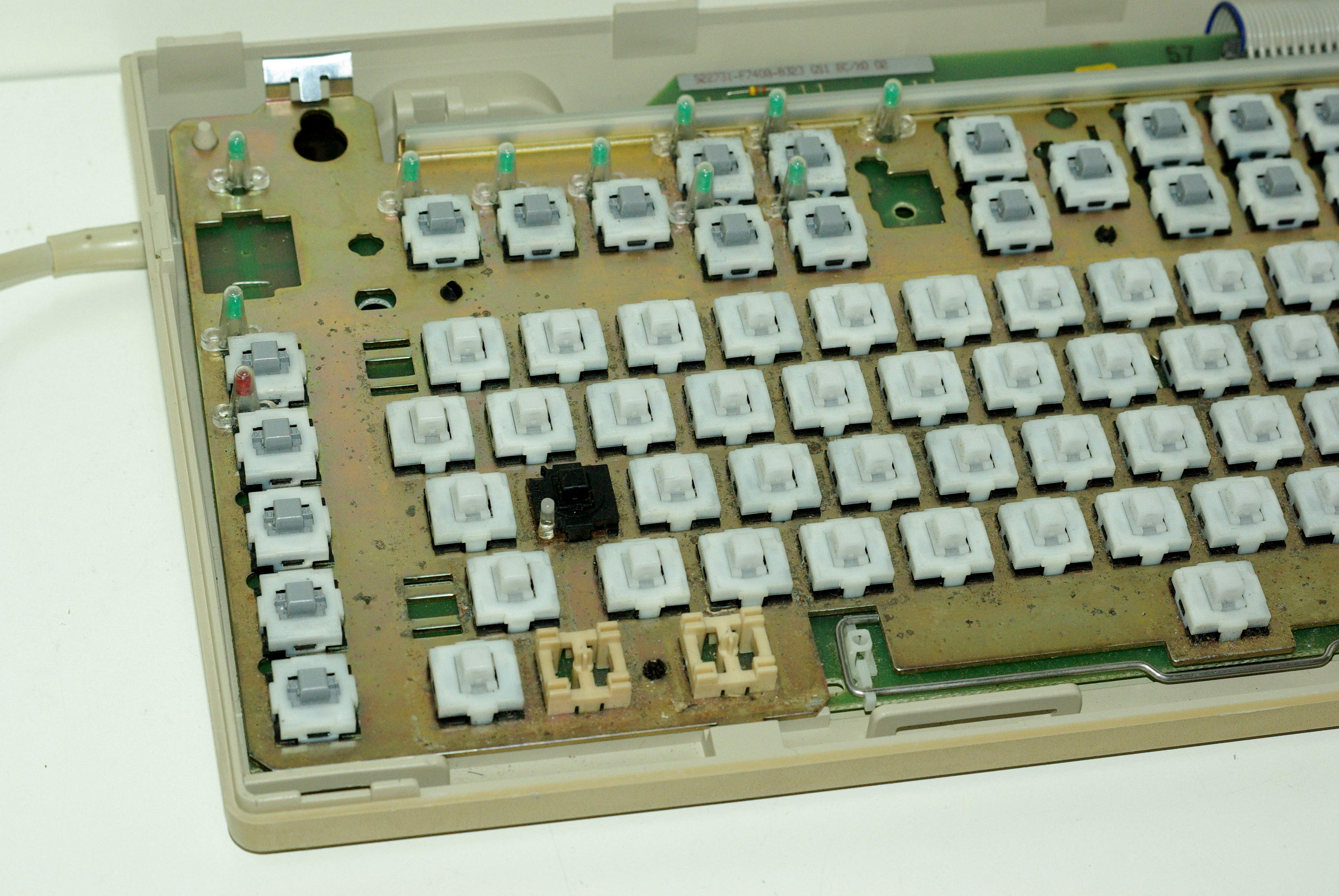

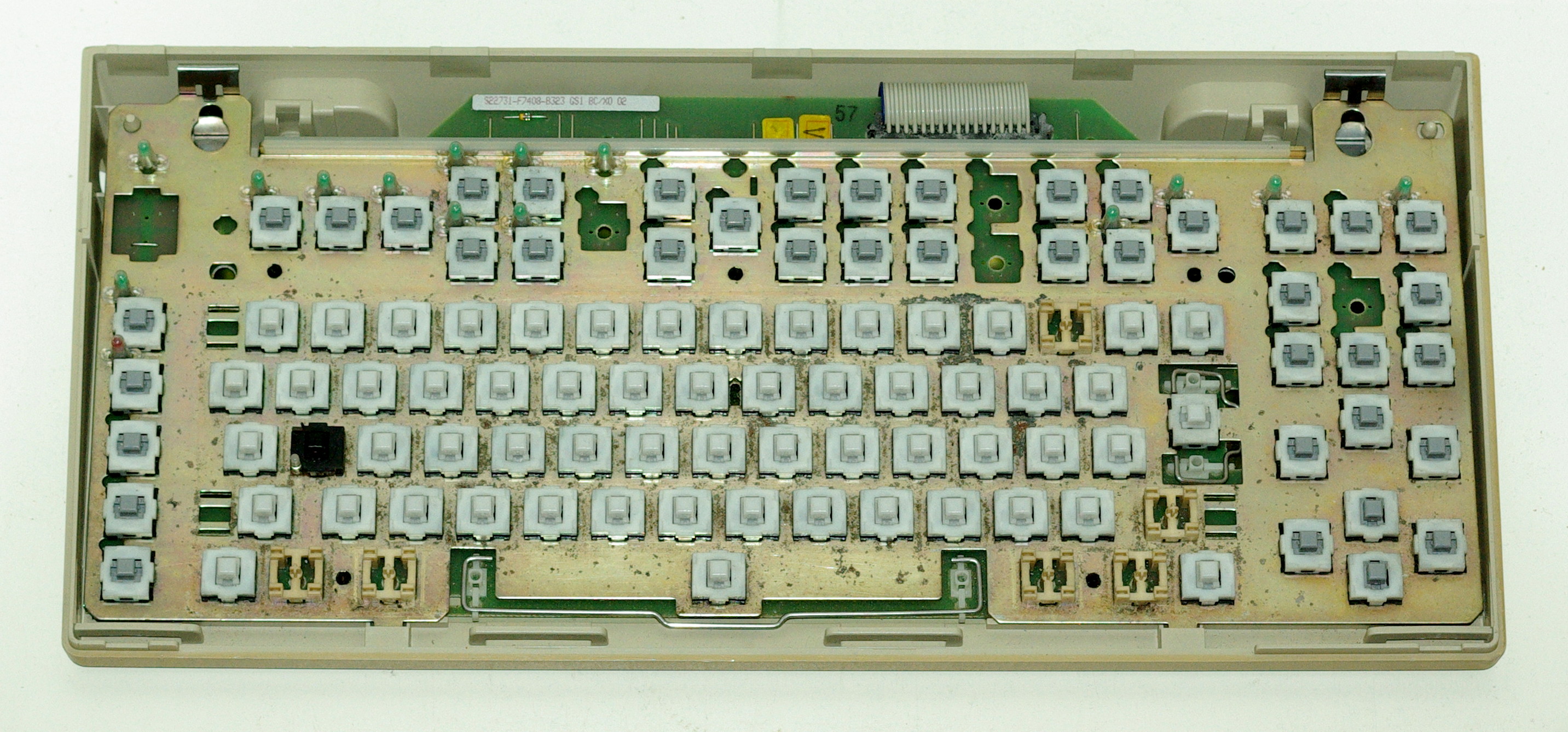

Siemens TABS1200 front open.JPG (950.18 KiB) Viewed 4864 times

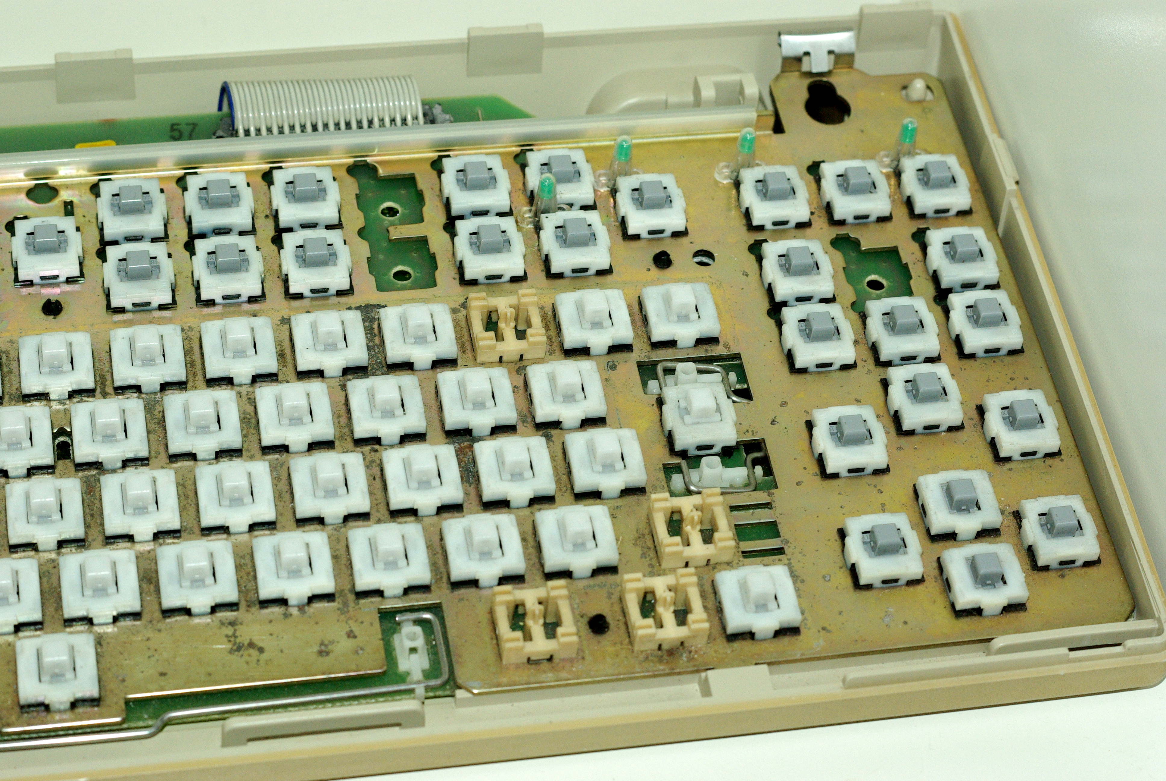

Siemens TABS1200 switches left.JPG (855.97 KiB) Viewed 4864 times
Siemens TABS1200 switches right.JPG (964.01 KiB) Viewed 4864 times

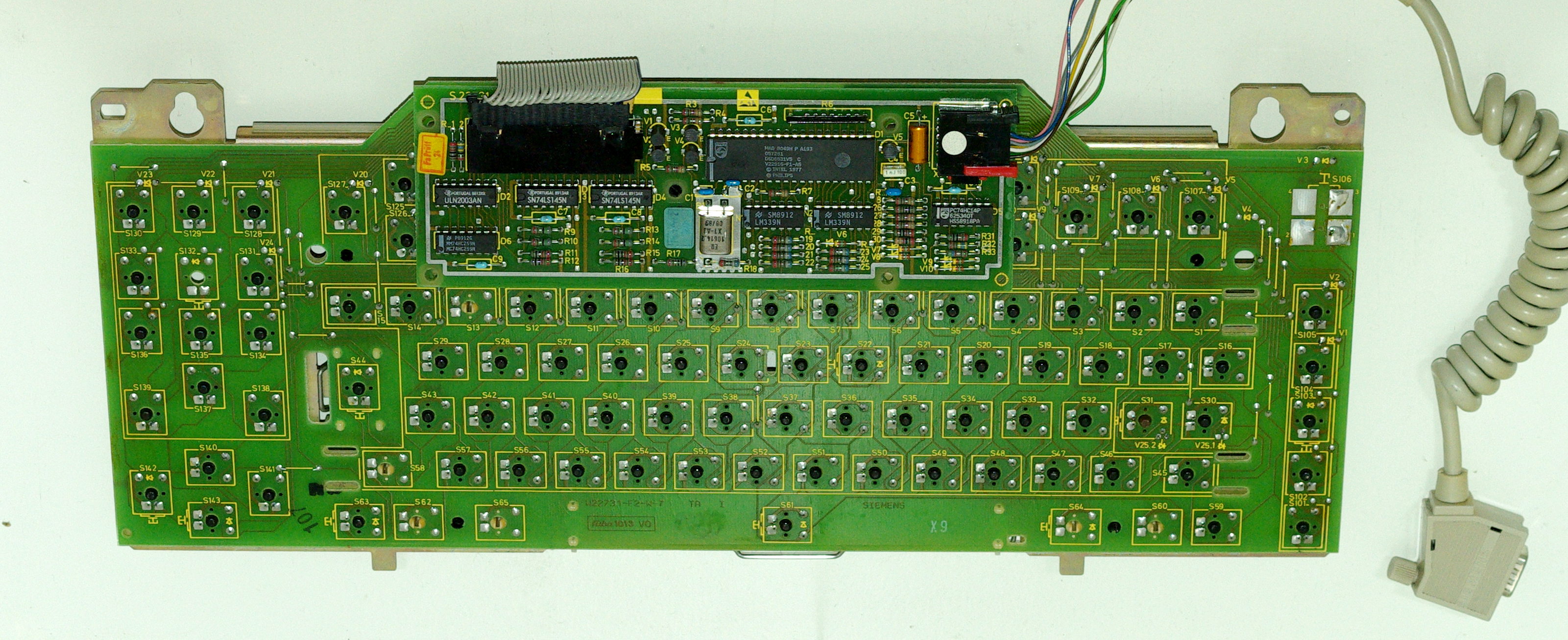

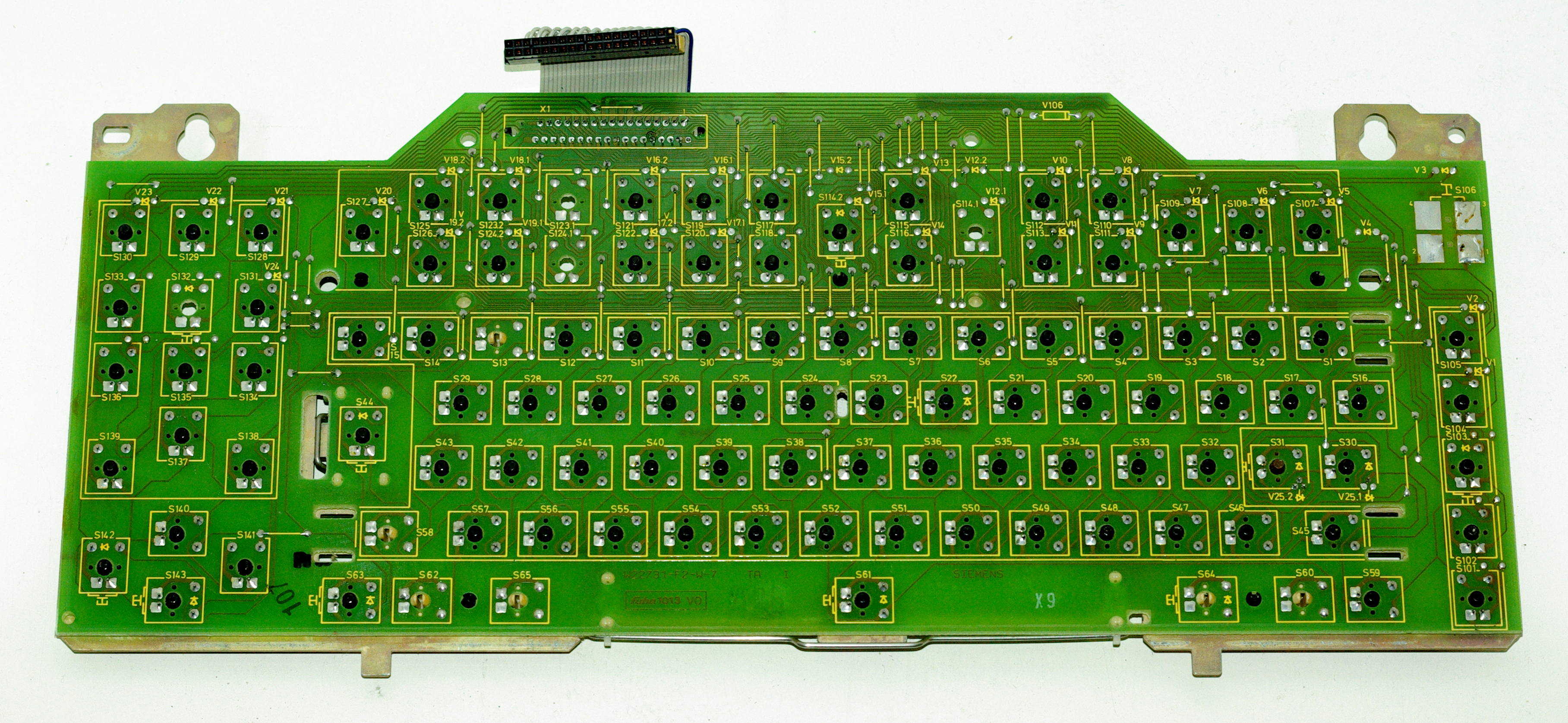

Siemens TABS1200 PCB.JPG (933.88 KiB) Viewed 4864 times

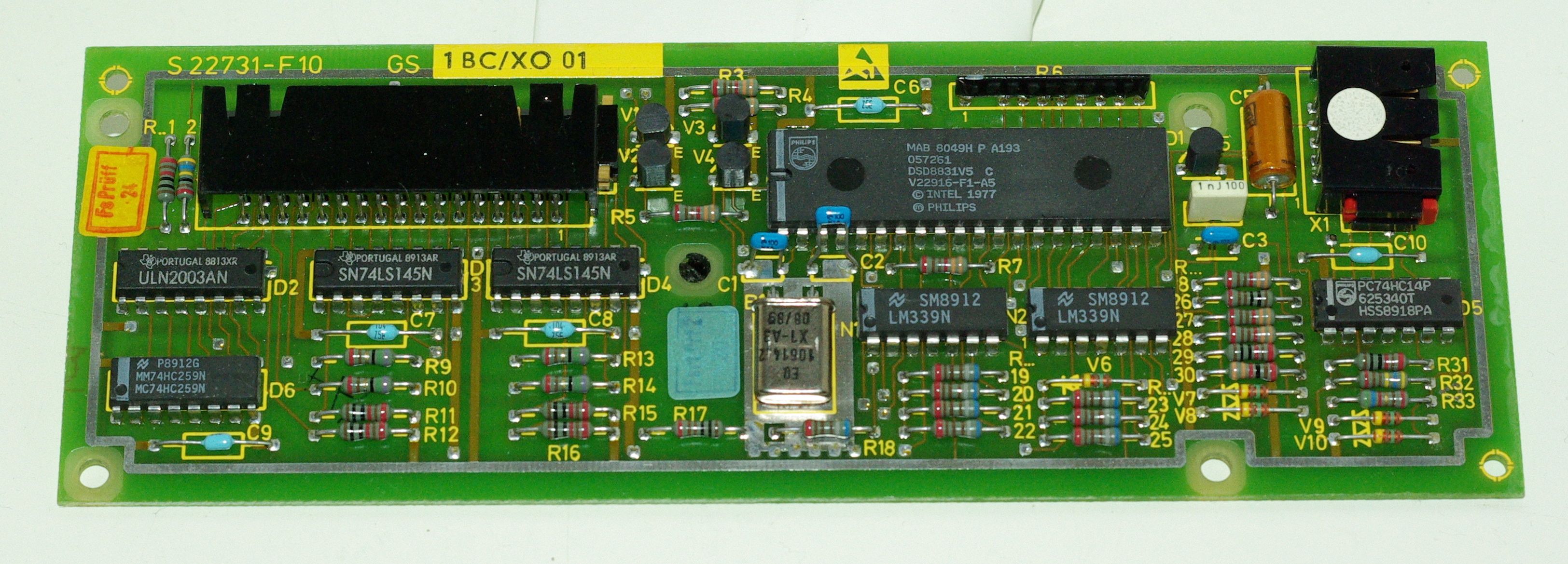

Siemens TABS1200 controller.JPG (809.17 KiB) Viewed 4864 times
The combination of short key travel, low profile keycaps and plate mount make for a pretty nice keyfeel, bottoming out feels good. The switches are almost silent making a minimal "thocking" noise on the plate, there is no ping whatsoever.

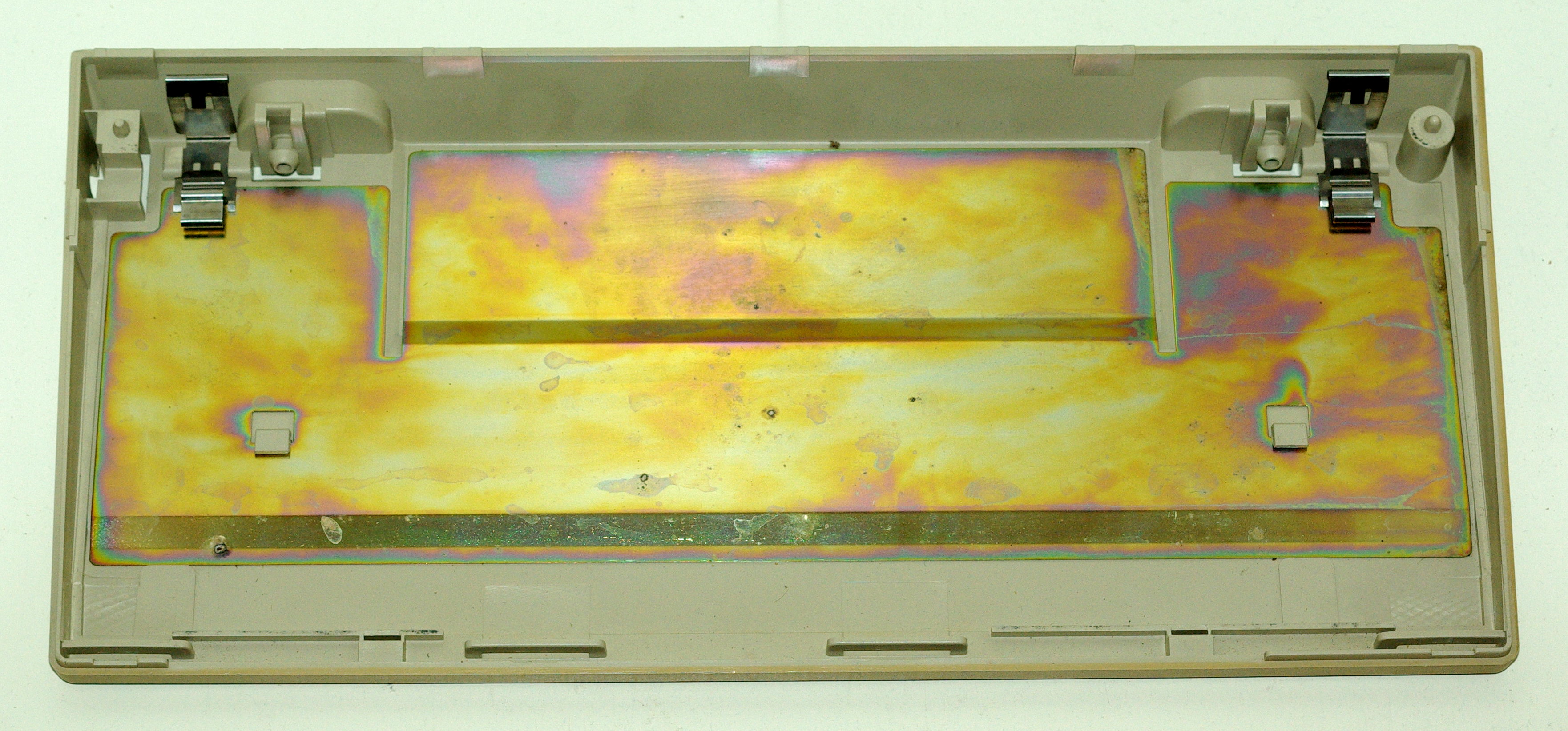

There is not one single screw used in all of the keyboard! The metal plate with the switches slides into the bottom part of the case at two hinges on the bottom and two metal snap-in hinges at the top.
The very thin top part of the case snaps-in to the very sturdy bottom case which is quite pesky to remove without breaking it, worse than Cherry snap-in cases.

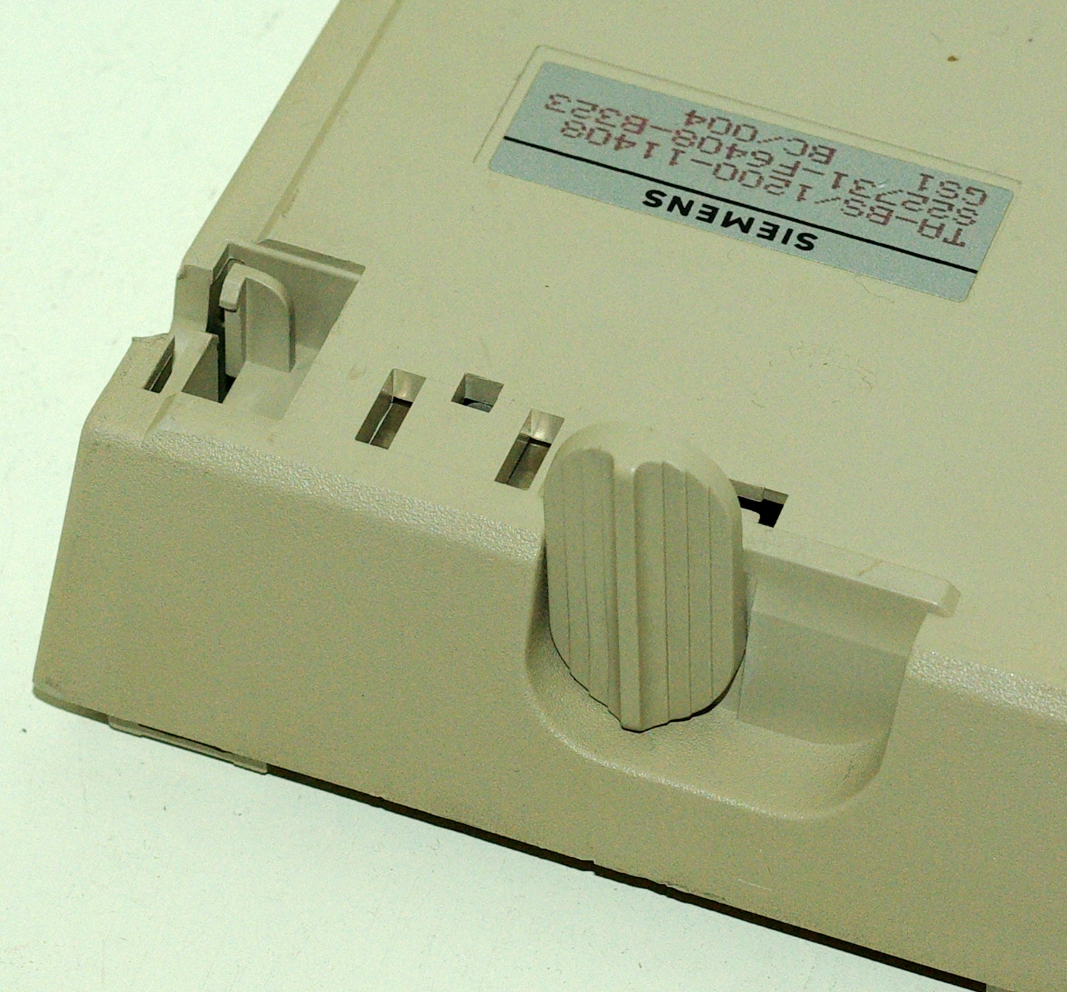

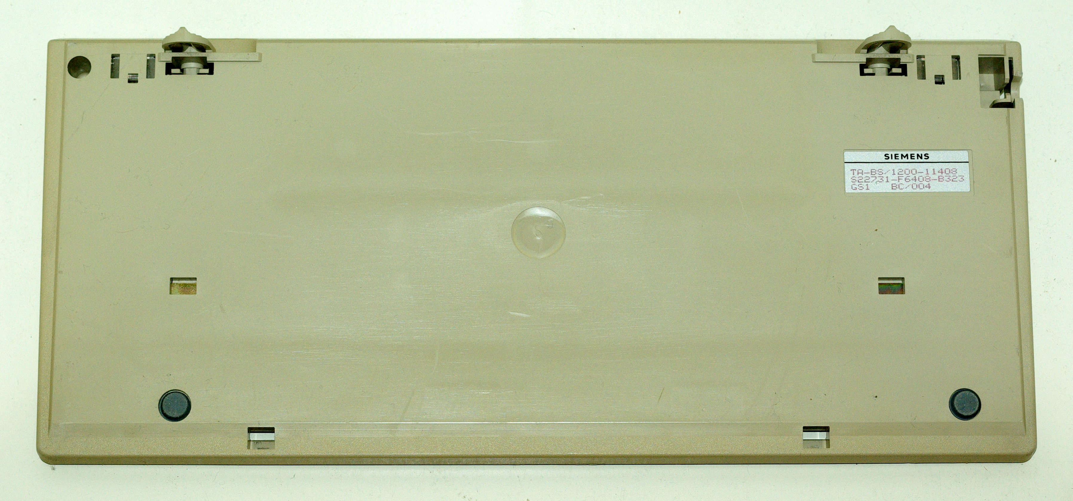

Siemens TABS1200 case back.JPG (902.69 KiB) Viewed 4864 times
Siemens TABS1200 case bottom.JPG (945.92 KiB) Viewed 4864 times

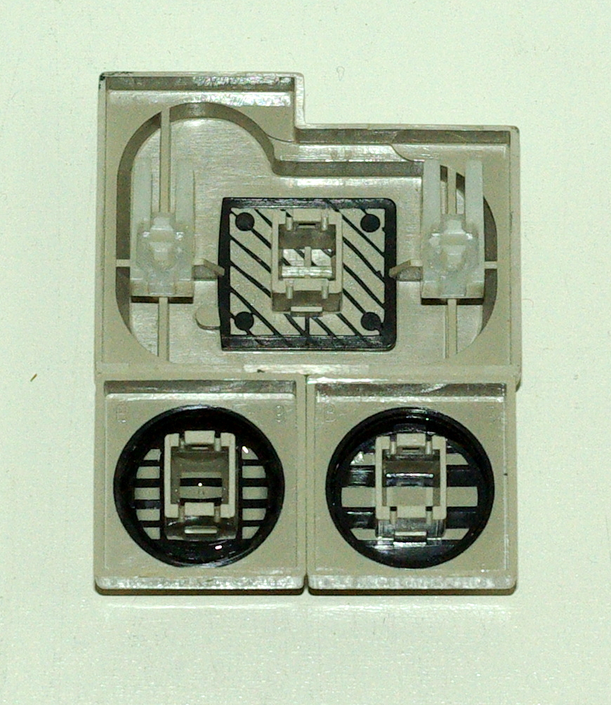

Siemens TABS1200 doubleshots.JPG (740.6 KiB) Viewed 4864 times

When you say "short key travel", surely not? The grey ones around the outside are the type I bought in bulk a while ago, which are 2.5 mm travel. The white ones are a full 4 mm travel. It's the first time that I have ever seen the 2.5 mm type used for anything, and since it's used for the cursor keys, that just about counts as proof that they really were used in a keyboard!
It's curious that integrated LED support was removed as of STB 21, hence the STB 11 switch for that. I don't yet understand the fundamental difference between STB 11 and 21.
Then we have all the oddities. Next to Q there are blanks over real keys, as opposed to the blanks over dummy keys. The frames that seem to support the blanks, have a cross mount, which is really odd. After that, you have the plain lazy blank keys, the ignoramus key, and the weird backspace position (which is not far off where the BBC Micro put its backspace key, labelled "Delete").

Here are some interesting links regarding these keyboards:
http://teleprinter.net/english/inhalt/t1_e.shtml
http://www.phantom.sannata.ru/forum/ind ... a=do_print
http://oldcomputer.info/pc/SiemensCT/index.htm

Nice board! Certainly distinctive looking, with a cool PCB - and I really like that back plate!
