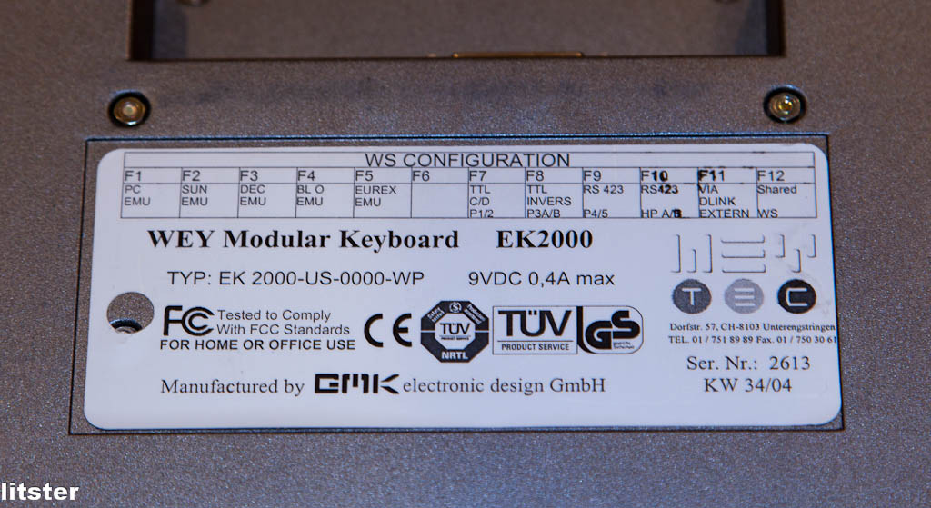

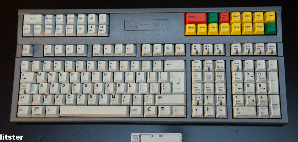

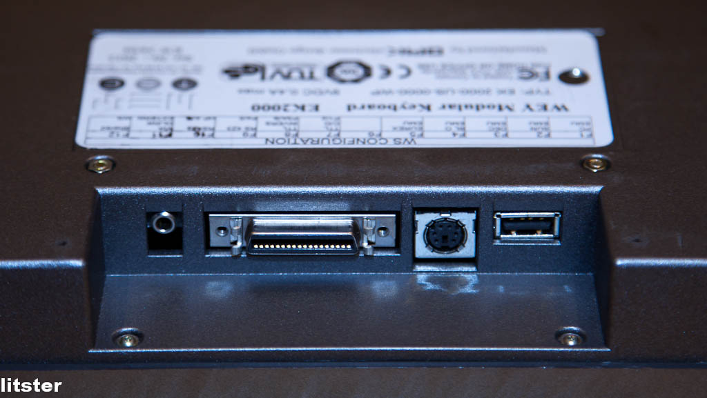

Bought this recently. It comes with a cable for that wide connector. But I don't have anything to connect the keyboard to. Connecting the keyboard to a computer through the PS/2 connector and the keyboard "boots" up, some LEDs come on and I can toggle between the WS LEDs on the right, but the keyboard doesn't act as a functional keyboard, capslock and scroll lock LEDs can't be toggled (computer was rebooted as PS/2 isn't plug and play). I don't have a male USB to male USB cable to try with. Anyone knows if this keyboard could be a standalone keyboard by itself? I haven't been able to find any manual for this keyboard on the web.
The keycaps are very nice though after a dental tablet bath. There a quite a few interesting keycaps, I especially like the Power icon keycap and the "PROPS" keycap.

They are pretty awesome. The keycaps are made by Cherry btw, genuine double shots (with some pad printed as usual). I never knew this company made them without LCD screens too. If you ever get this running on PC, be sure to let me know how you managed :D

I remember reading that the Wey boards are compatible to SUN systems as well, I think there should be a toggle somewhere internally to switch it to pc use. Or you might have to press the appropriate button while booting to select a mode, which the WS Configuration chart on the back seems to suggest.

I think that wide connector connects to a "Connector Box" that I don't have. I will have to play around with it to see if it is actually usable. It has Cherry clear switches by the way.

Male-to-male USB came. with the USB cable the keyboard "boots" up just like the PS/2 connection. I can toggle a few "workstation" keys, but not Scroll Lock or Capslock, so the keyboard never gets into "PC EMU" mode as noted on the label on the back of the keyboard. I would need the missing "Connection Box".

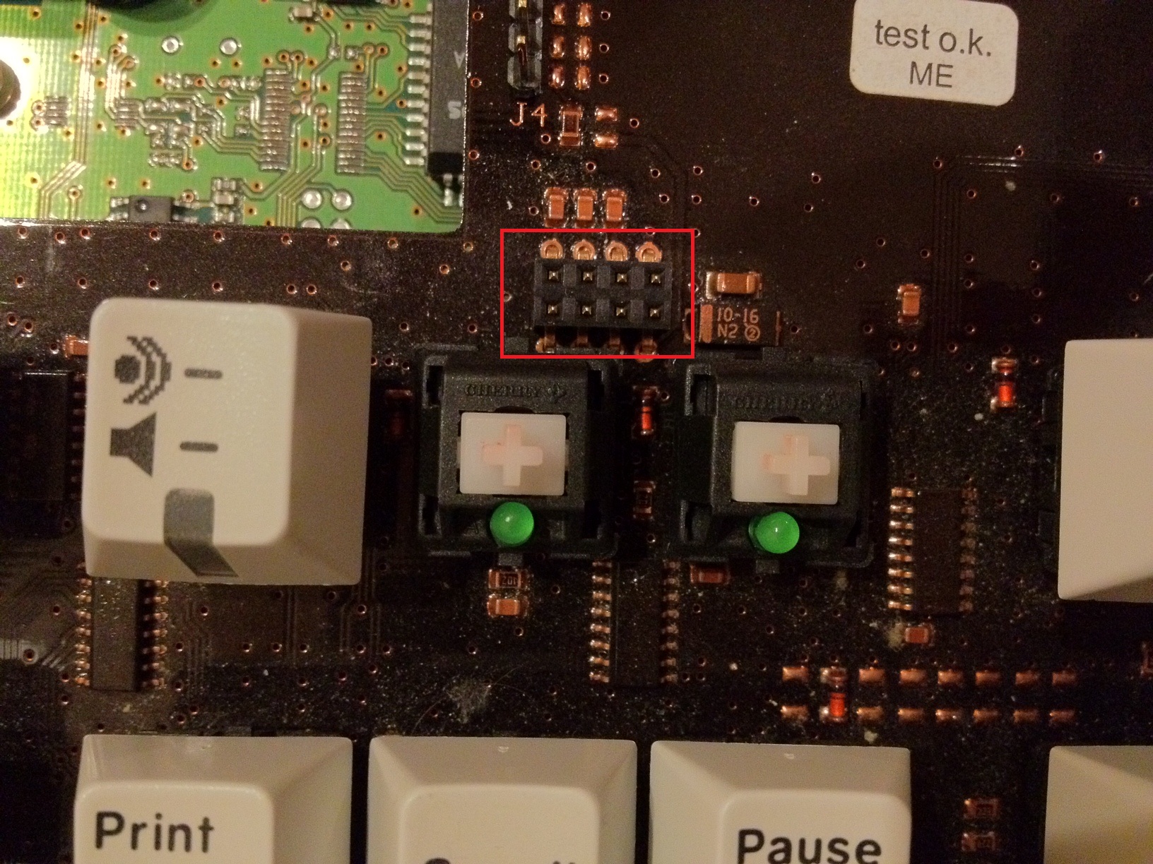

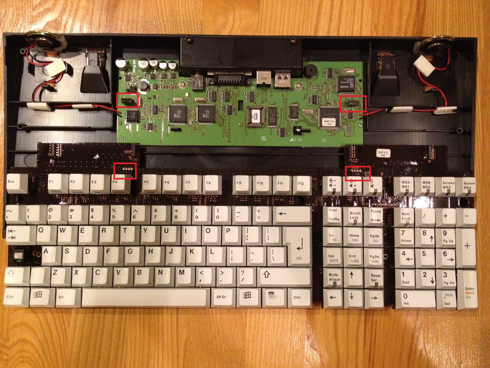

I opened up the case. And it is actually more complicated than regular keyboards. There are 2 PCBs. One at the bottom with all the chips and connectors to communicate with the "connector box". There are 2 8-pin headers on it (see highlight in pictures). The keyboard PCB has 2 8-pin holes to connect with the 2 pin headers on the main PCB. At first I thought, great! Those must be the pins for the matrix. But no. It has over 130 keys. 8x8 is not enough. Then I saw there are more tiny chips on the keyboard PCB. I think the chips convert the matrix into a different protocol to the main board and then communicate to the connector box.
