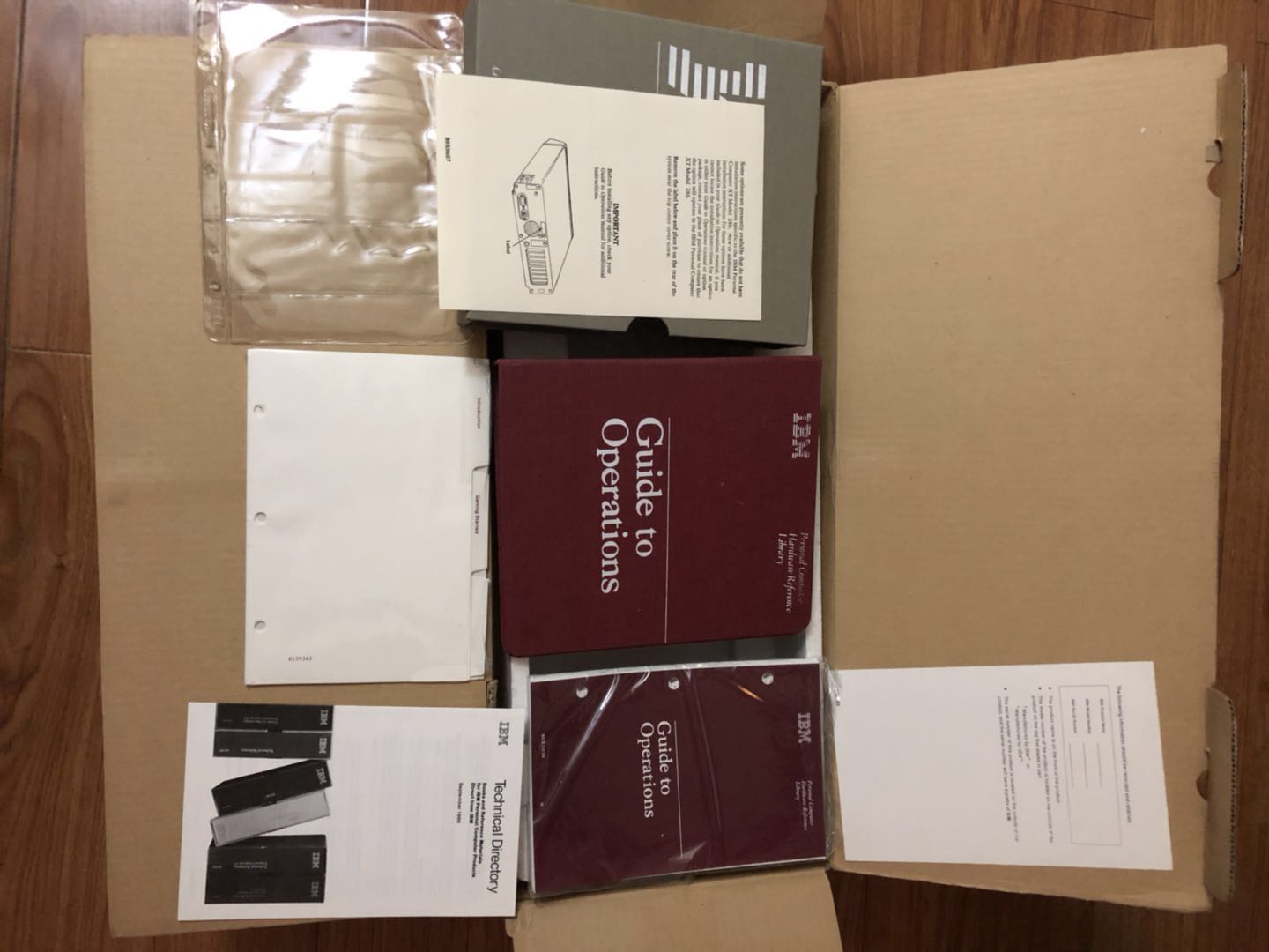

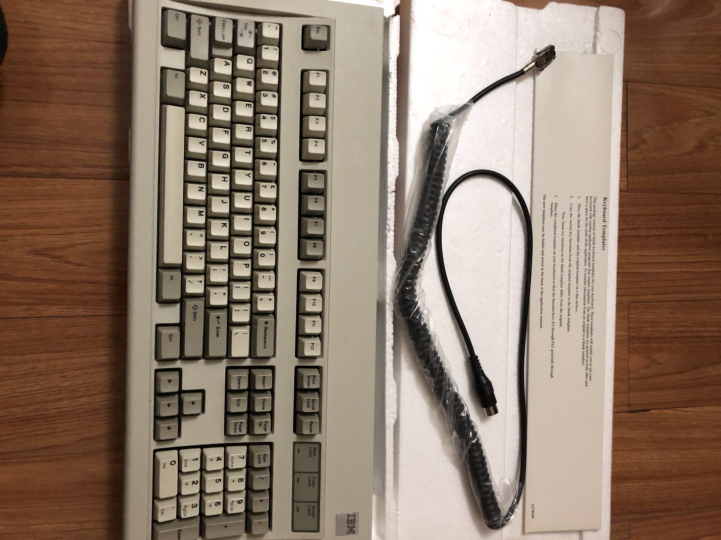

Due to its NIB condition, it comes with original box, accessories and documents which are almost the same as traditional IBM model M Buckling-spring keyboards built in 1986-1987.

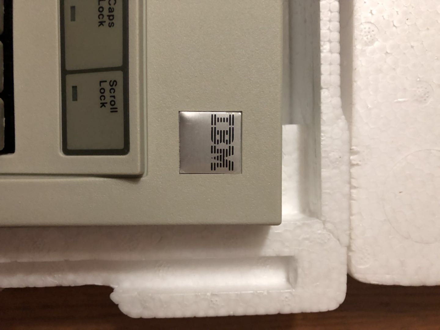

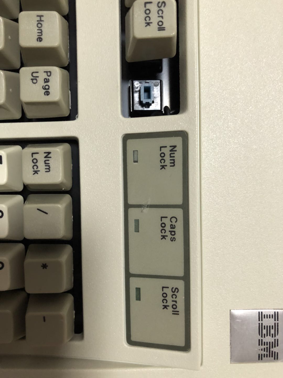

Look at the metal Black IBM badge

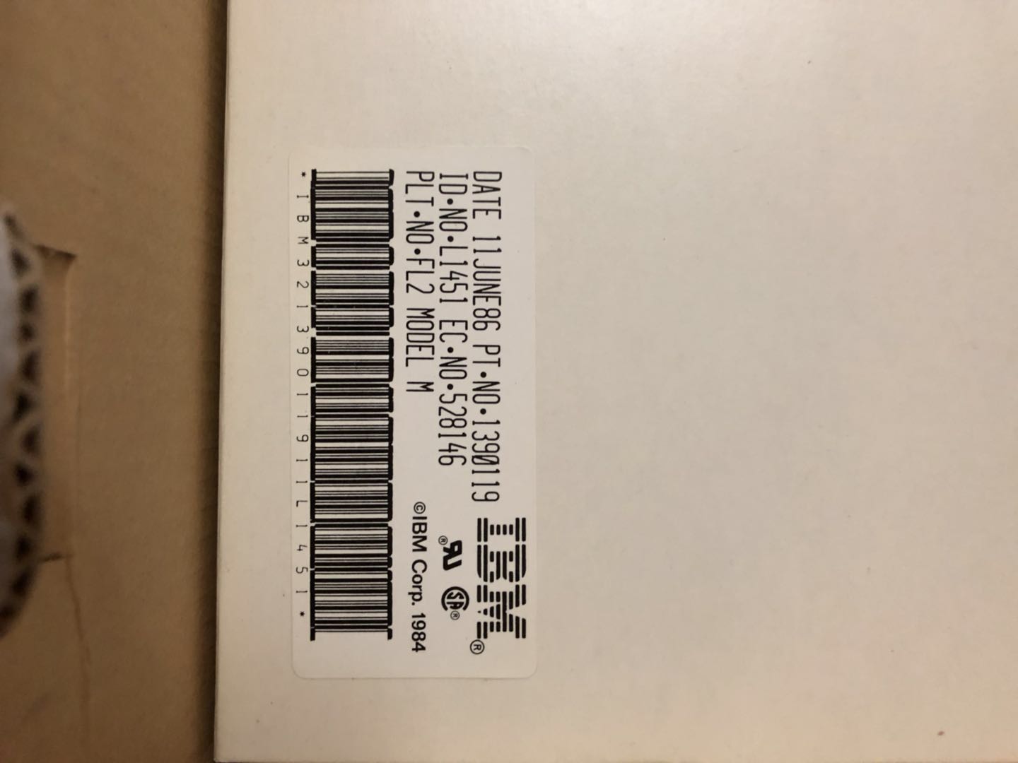

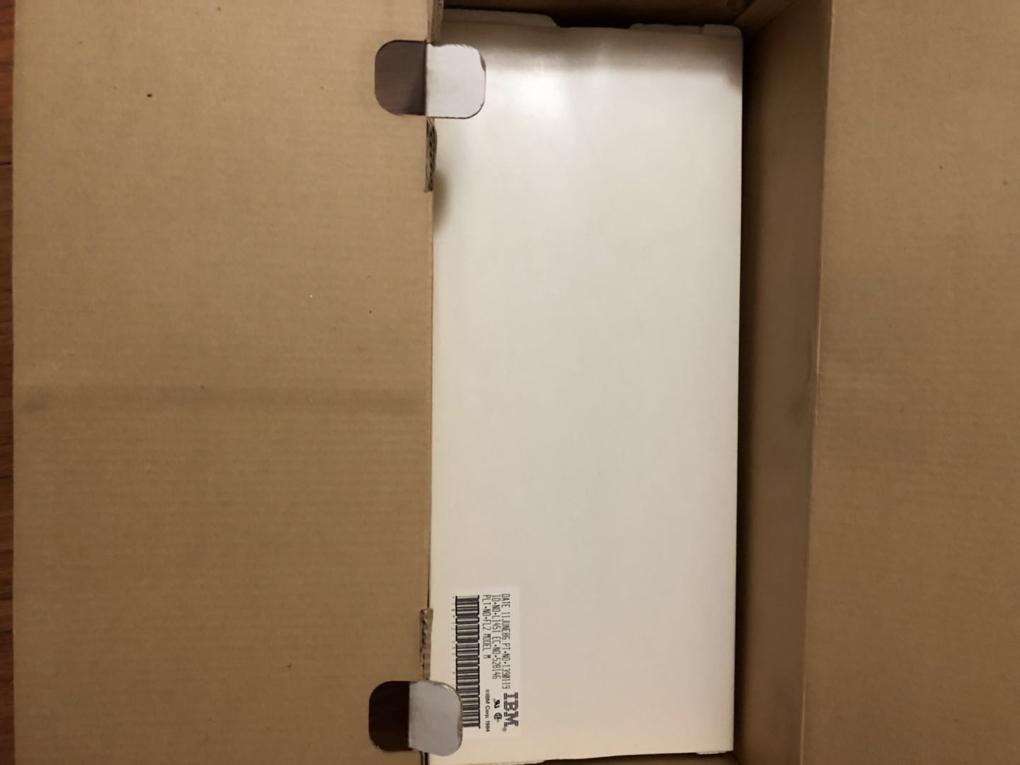

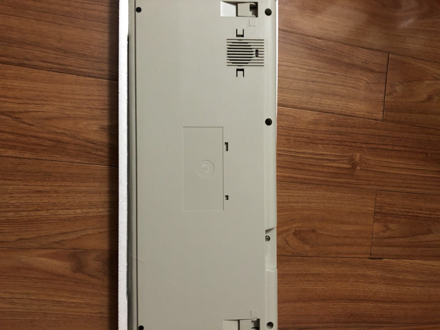

No label on the back, but I can see a label on the inner box, saying it is built in 11 June 86

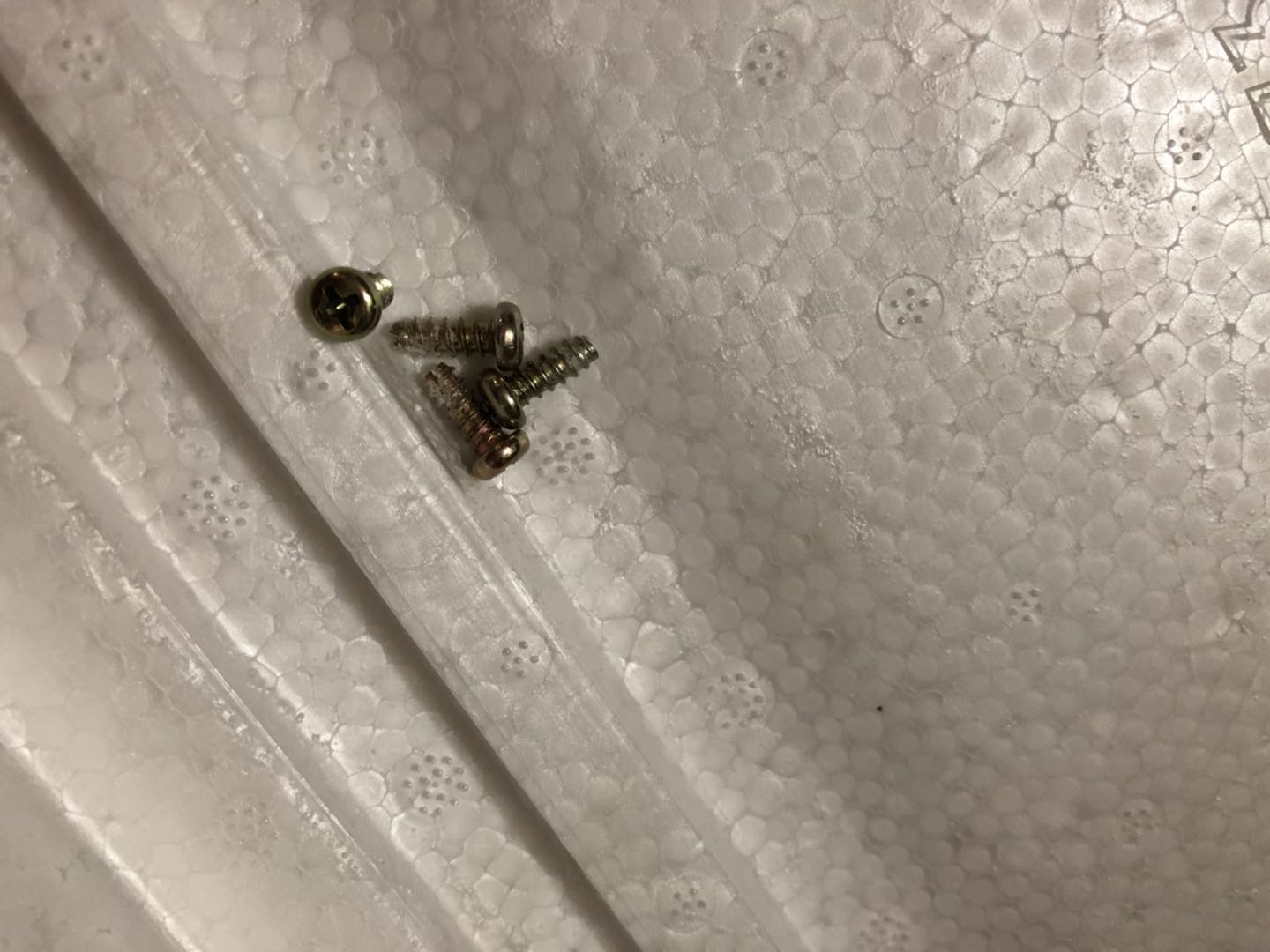

The screws are different with IBM model M Buckling-spring's

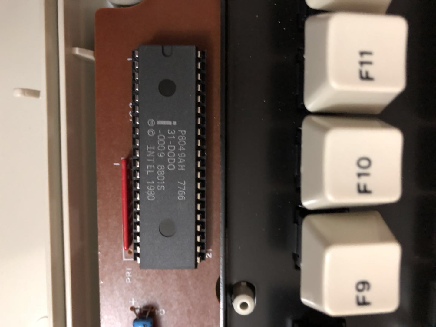

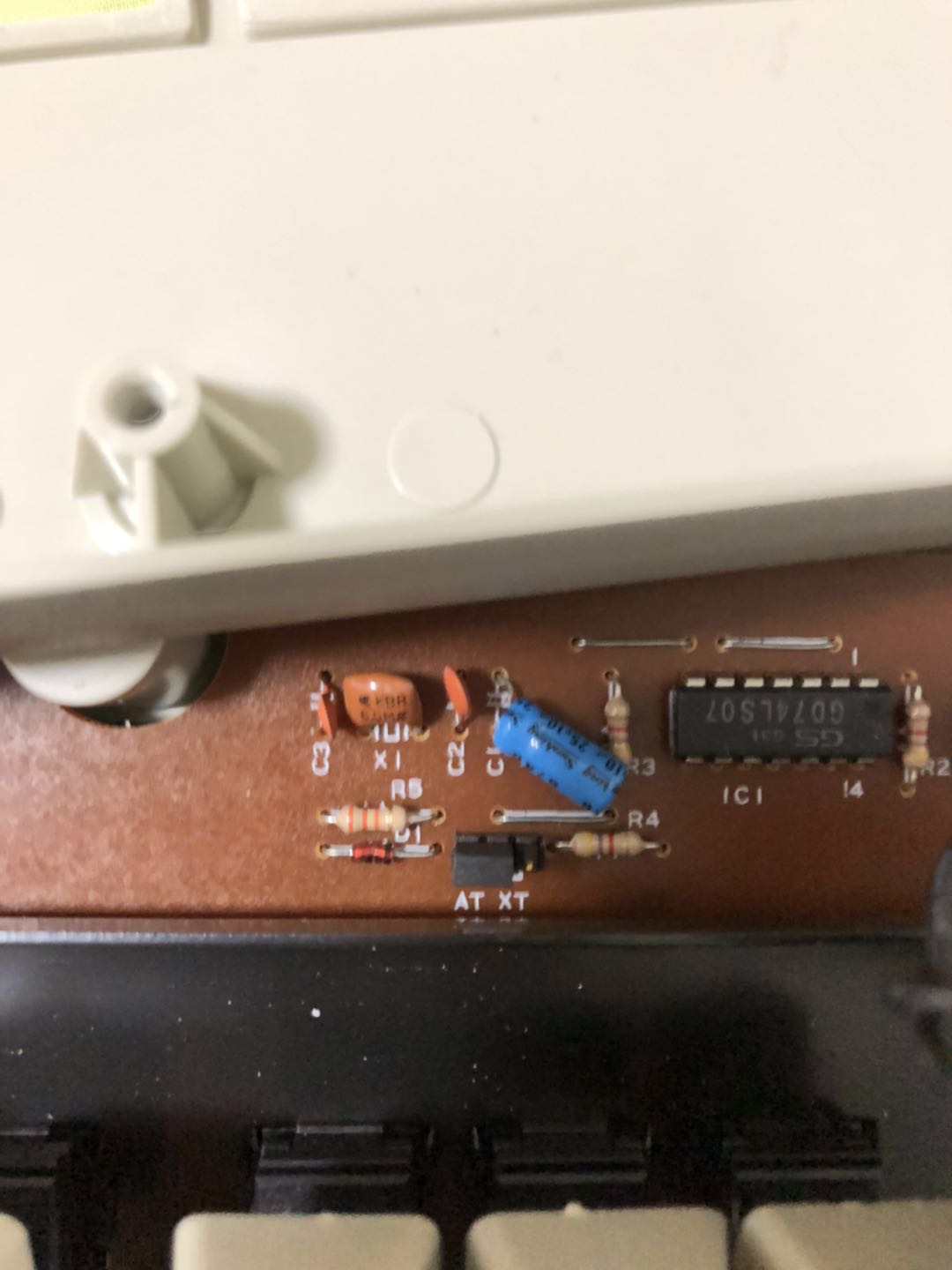

Have a close look at controller IC which says Intel 1980

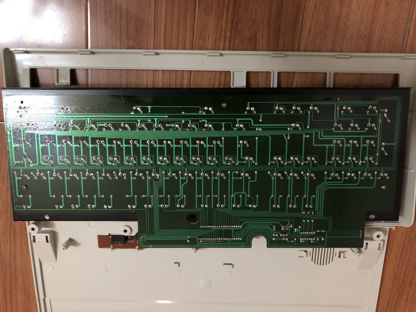

Unfortunately, I cannot see any other information useful on the pcb.

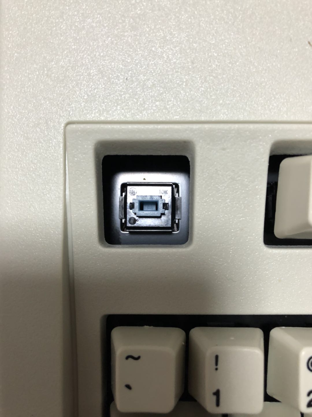

Could you take pictures of the switches ? The only Model M clone found that was this close to the original HAD Blue Alps. I don't know what you mean by Blue Alps like :/
IKSLM
05 Jan 2018, 12:44
Yes, so many pictures but none showing the switches....
neozhou
05 Jan 2018, 12:47
Myoth wrote: Could you take pictures of the switches ? The only Model M clone found that was this close to the original HAD Blue Alps. I don't know what you mean by Blue Alps like :/
Mate, check it out.
Myoth
05 Jan 2018, 12:52
Those are definitly Blue Alps, you've found one of those taobao clones in NIB condition, nice find !!!
With all the little font problems and the non-present IBM sticker, I think it's safe to say that it's a counterfeit, the other thread was skeptic about it, now I don't really know what could prove this wrong...
All of these informations-papers about it are impressive, so much effort into a fake !

"Compgeke" said " .....the back label says 1986 but the controller IC says 1989 as a copyright...."

Very interesting unicorn. Definitely the outer IBM box, the documentation, keyboard case plastics, IBM labels all look original for a 1986 model M keyboard that was packaged with an IBM PC. These pieces do not look like fakes.
Based on these, I would have expected there to be a 1390120 model M keyboard without LED lock lights inside the keyboard box like this old photos that I have from 2005. http://www.clickykeyboard.com/2005/1987 ... 20-002.jpg
http://www.clickykeyboard.com/2005/1987 ... 20-003.jpg
I have seen a couple early model M keyboards where the back label was missing, but normally there are other IBM stickers inside the keyboard assembly to help confirm and date the keyboard.

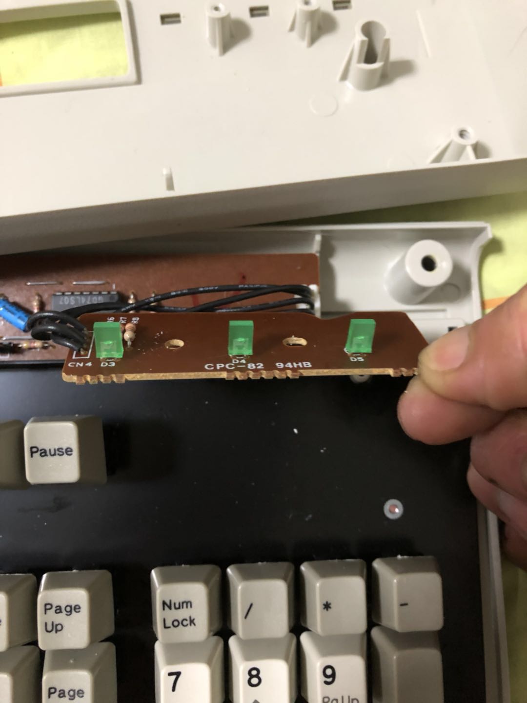

Looking at the OP's photos of the internal keyboard assembly and not using the typical 5.5mm nut screws found in all model M keyboards.
At first, I would say that a third-party just swapped in the internal keyboard assembly of an Alps keyboard that happened to fit. At the beginning of the PC revolution, many competitors in the early computer industry were making their computers to be "100% IBM clones". ..but the SDL internal connector and wiring looks well done.
Does the keyboard work when plugged in today?
Do the LEDs on the internal keyboard assembly line up exactly with the holes on the front of the IBM keyboard case?

Well, here's the thing — according to the box, it's US made and comes from plant FL2 (wherever that is).
Is that reasonable? Isn't that a plant that made buckling spring Ms? Would the same plant import Ms from Taiwan and use the same part number as regular Ms? That seems awfully odd to me.
I'd expect to see a whole new plant number and "Made in " some Asian country, either Taiwan, or maybe Japan if IBM Japan was involved.
That bowed-out badge looks really shifty, too.
06 Jan 2018, 00:03
I thought the same thing about the badge as well. Was this box completely sealed before you opened it?

From my point of view, the seal was perfect until I open it.

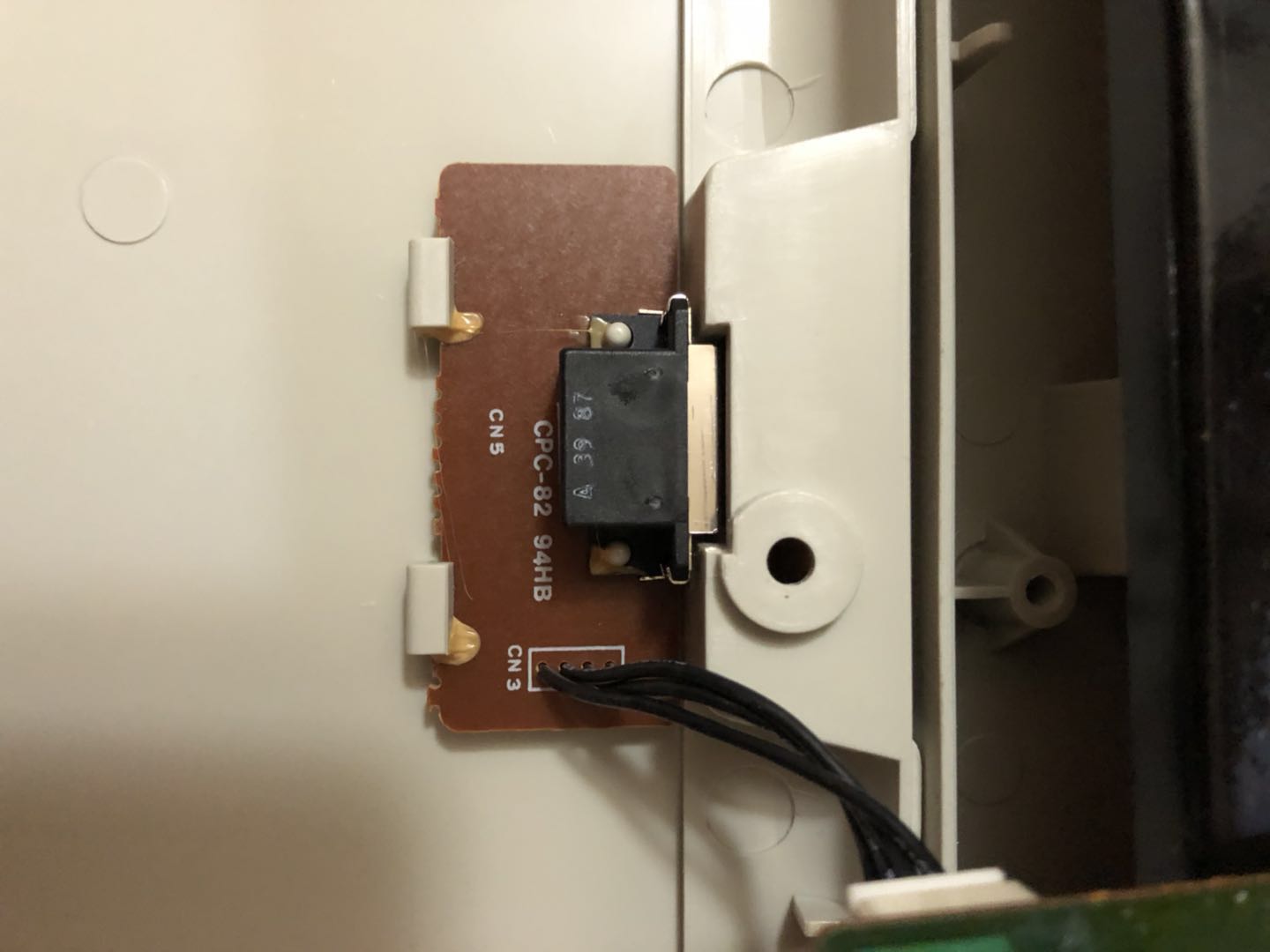

Two more pics here.
Perhaps there is information beneath the steel plate (maybe not certainly), but I don't plan to decompose the keyboard further because I have to remove all switches before doing so. However, I also think --- printing information on ether pcb or chips and making a nice metal badge are easy jobs for counterfeiters, in particular comparing with making top half and bottom half (both are blank unlike Model Ms), paperwork and accessories.

This is the exact same packaging as my NIB Model-M from 1986.
Same books and cable but your keyboard has the Alps addicts weak at the knees, from seeing their beloved Blue switch being used here. Very strange seeing this and of course goes straight into the category of "Believe it or Not".
I would like to see more pictures.. but this definitely looks like a interesting keyboard...
The keyboard is in working condition and there is a jumper with which user can switch the keyboard working in XT or AT mode.
The LEDs look cheaper than original Model Ms.
