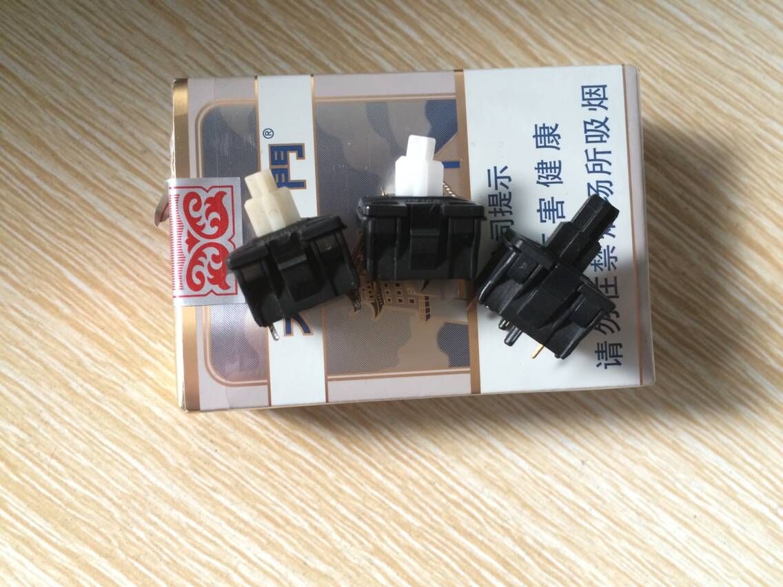

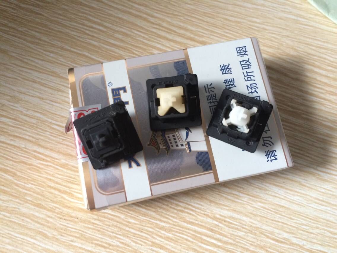

Hello! every one! Today I found a hard problem. :( I want to clean my switches.
some of them are dirty,dust and dirt. I think I can use detergents to clean them. but my clear switches are becomed yellow. This is a bad sign for me. I don't know how to make it back to the original...
Left M9 turns yellow
MY type2 in middle turns yellow
I soak them by 3 percent concentration of hydrogen peroxide.But no obvious effect.
Who had cleaned the siwtches and who know how to make "yellow" clear key-stem back to the original?
Thank you.

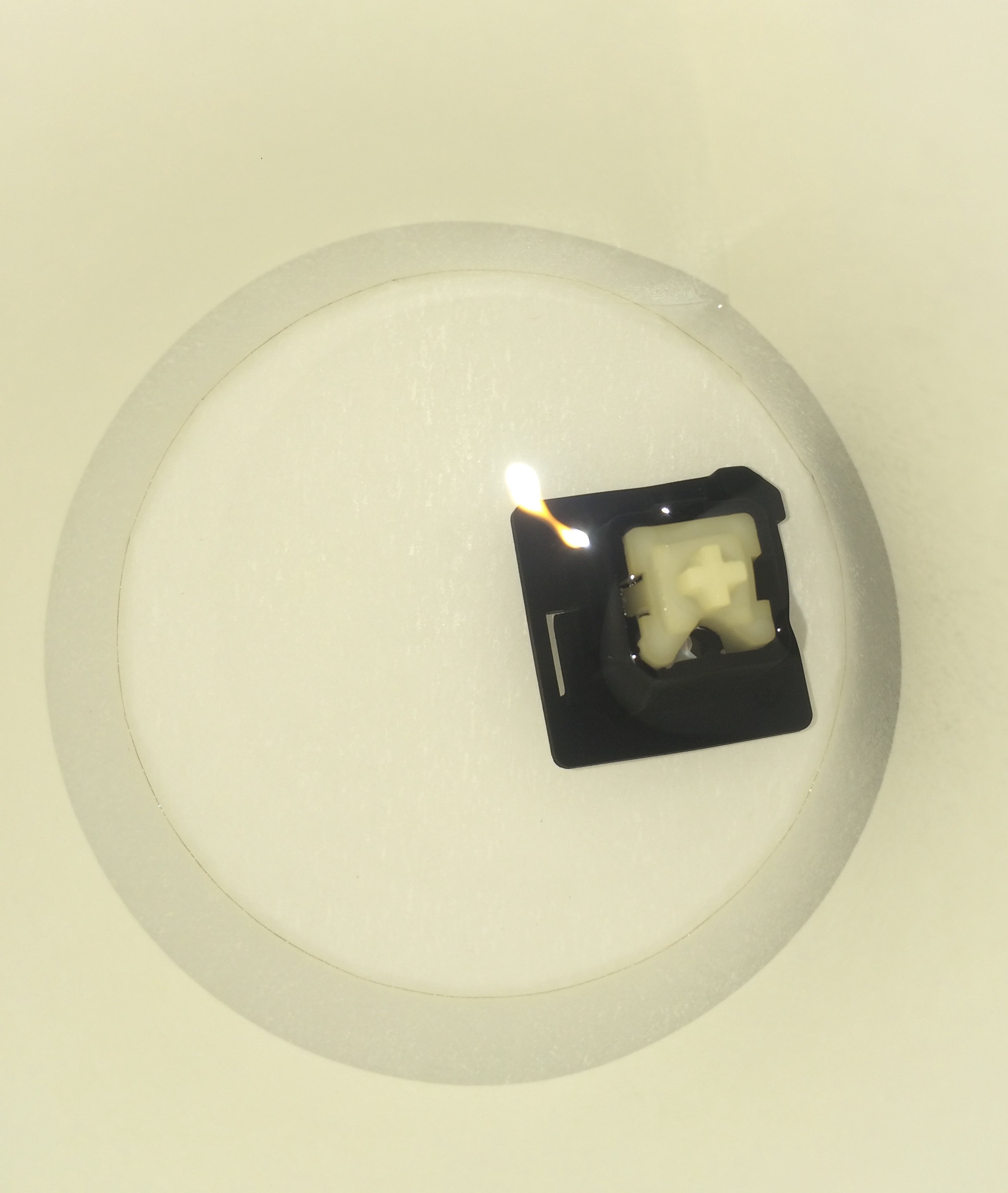

High concentrations of hydrogenperoxide do, indeed, work (hydrogenperoxide is also the most important ingredient in retrobrite), but people restoring old toys in this way have reported that the yellowing often returns within a few years. A few people have also stated that the yellowing ultimately got worse, although this does not seem to be a common effect of the treatment.
The ultimate cause appears to be a fire retardant used in plastics through most, if not all, of the 1980s. As it was mixed with the plastic, it cannot be removed, and thus will continue to react with the other components of which the material is composed.
UV radiation (such as that from the sun) will speed up the yellowing process, and there is evidence that certain components in other plastics (such as the transparent plastic used for ziplock bags) can have a similar effect.

Good answer! Thank you. But I only have medical hydrogen peroxide.It has only 3% concentration.Seems ineffective. Do you have a good idea to restore clear switches's key-stem?

With white plastic, it should work, albeit very slowly. Put it in a closed jar, and check on the plastic a few times every day. Interestingly, UV radiation seems to speed up the whitening process (!). There's a post on the process here.
Just to be sure, is that stem supposed to be transparent? I am not knowledgeable about these switches, but noticed your referring to them as 'clear'. I do not know what hydrogen peroxide does to transparent plastics. Such plastics are often more brittle than coloured ones, though. Also, please be careful with the black plastic. A few years ago, in an attempt to 'de-yellow' some red plastic I accidentally bleached it, causing it to turn pink.
Finally, hair products often contain higher concentrations of hydrogen peroxide, but make sure that that stuff doesn't touch your skin.

Hydrogen peroxide is a bleach, so it will make the stems white whether they ever were white or not. Also, UV is not required, and possibly will make them turn yellow again faster if they are exposed to heavy UV during the whitening process. All that is required to activate peroxide is heat. 120f-180f is ideal. Hotter and you will start concentrating the peroxide, and damage the plastic(and your hands if you touch it). Wear gloves either way, unless you want the outer layer of skin on your hands bleached. It itches, too.

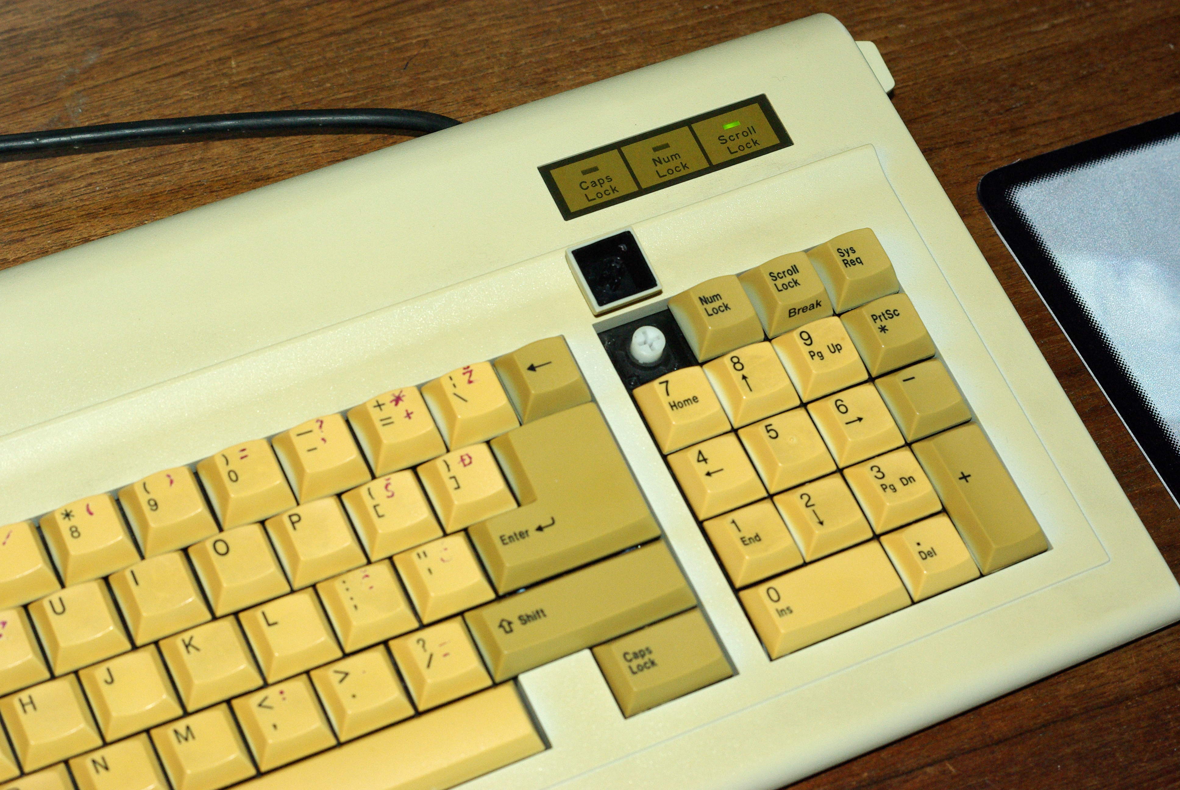

Be very careful with the peroxide / heat method. I tried this on keycaps and while I got great results it bent a 10u space bar and some of the printing on the alphas started to bleed so switches or even switch parts that move may not be usuable afterwards.

To add to what seebart said, you should also worry about actually not knowing what temperature the plastic can handle. Plastic is not an element or a pure compound and even if it was a pure substance its melting point is still amorphous. The plastic could swell, shrink, or warp.

Yeah I hear that all the time but that simply is not the case. I have a theory that this is the source of the theory that peroxide bleaching causes the plastic to re-yellow even faster. I think it isn't the peroxide at all, but the people actually activating the peroxide with UV.
UV is not required, I don't even think it does anything but serve as a heat source, but I could be wrong. Either way, since it isn't necessary, there is no reason to subject the plastic to it since UV IS what causes the flame retardant in plastic to brown. Seems quite counter productive, or at the very least, cancels itself out :)

The assumption is that both UV and Infrared serve as a catalyst for the retr0brite reaction. UV doesn't actually warm up the water all that much, give it a try. I did a retr0brite experiment with a small 6 watt CF bulb (probably was xenon-mercury but I digress) that emits a decent amount of short wave UV and not all that much heat and it did turn the yellow plastic white again. What exactly it is doing is not all that clear but it has to do something with Chlorinated additives.

Catalysis doesn't apply in this process. Peroxide bonds photolyse in UVB and shorter though, so yes, UV light will definitely accelerate the process. Heat will also work, but I'm pretty sure not as efficiently, and it should be noted that heat will concentrate the mixture which can lead to extremely hazardous situations.

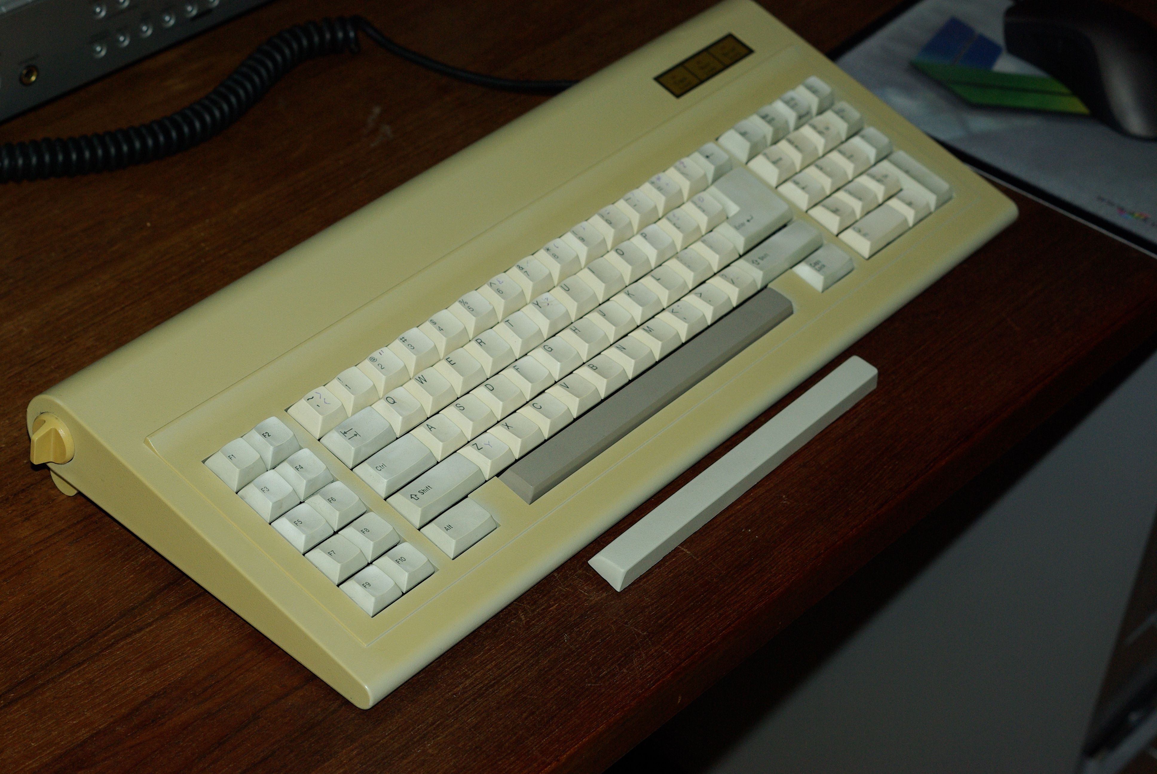

I got very good results with kbdfr's sunlight method for keyoboard cases but the downside is it's quite time consuming as the gel needs to be spread more than once every hour. I'll try the peroxide-heat method again sometime for keycaps with lower temps for a longer time. Check out the difference here on these keycaps:
