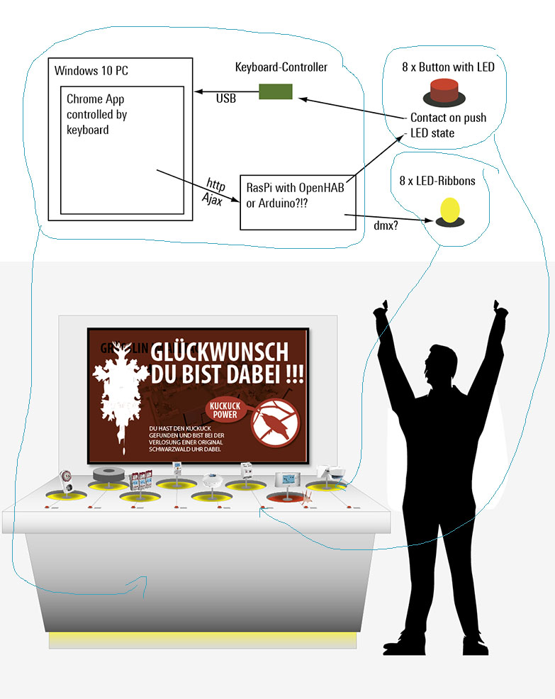

Next I'll try a sketch and a plan of my full installation.
mashborn
19 Jan 2018, 09:52
This is my planned setting:
The Browser-Application should work "in this device" and in a normal browser.
That's why I would prefer the keyboard-input...
