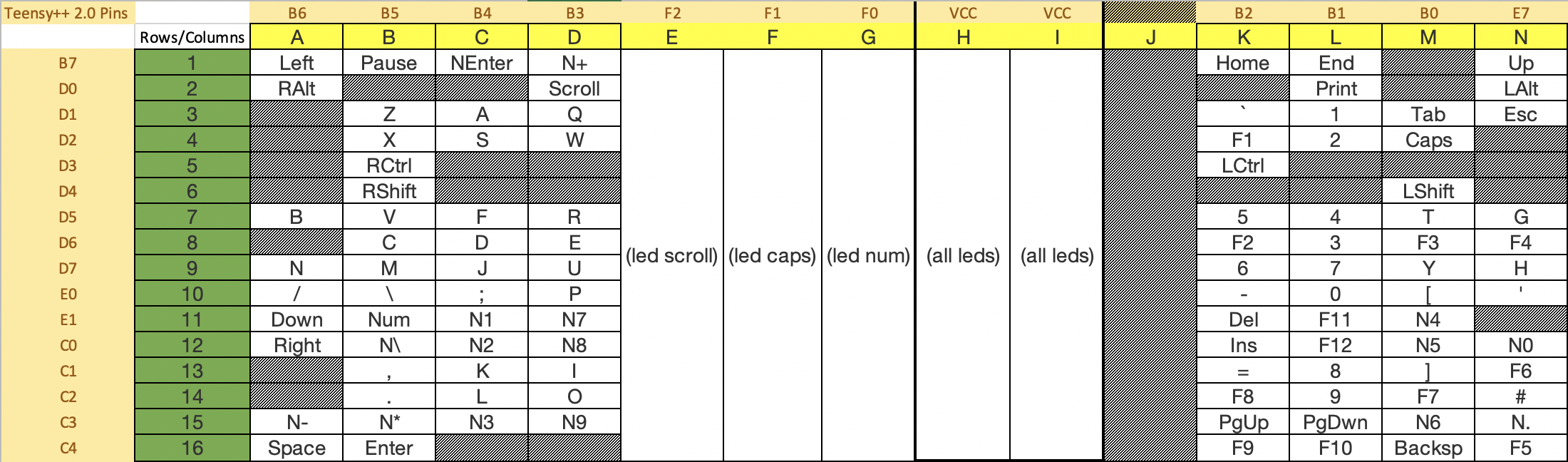

snacksthecat
02 Feb 2018, 21:39
Here's where I landed with the matrix.
I was able to program my Teensy++ 2.0 with QMK firmware and all of the keys work. :D
I haven't a clue how to get the num/scroll/caps lock LED indicators to work though. :cry:
A B C D E F G H/I J K L M N
1 Left Pause NEnter N+ (led scroll) (led caps) (led num) (leds ???) (???) Home End Up
2 RAlt Scroll (led scroll) (led caps) (led num) (leds ???) (???) Print LAlt
3 Z A Q (led scroll) (led caps) (led num) (leds ???) (???) ` 1 Tab Esc
4 X S W (led scroll) (led caps) (led num) (leds ???) (???) F1 2 Caps
5 RCtrl (led scroll) (led caps) (led num) (leds ???) (???) LCtrl
6 RShift (led scroll) (led caps) (led num) (leds ???) (???) LShift
7 B V F R (led scroll) (led caps) (led num) (leds ???) (???) 5 4 T G
8 C D E (led scroll) (led caps) (led num) (leds ???) (???) F2 3 F3 F4
9 N M J U (led scroll) (led caps) (led num) (leds ???) (???) 6 7 Y H
10 / \ ; P (led scroll) (led caps) (led num) (leds ???) (???) - 0 [ '
11 Down Num N1 N7 (led scroll) (led caps) (led num) (leds ???) (???) Del F11 N4
12 Right N\ N2 N8 (led scroll) (led caps) (led num) (leds ???) (???) Ins F12 N5 N0
13 , K I (led scroll) (led caps) (led num) (leds ???) (???) = 8 ] F6
14 . L O (led scroll) (led caps) (led num) (leds ???) (???) F8 9 F7 #
15 N* N3 N9 (led scroll) (led caps) (led num) (leds ???) (???) PgUp PgDwn N6 N.
16 Space Enter (led scroll) (led caps) (led num) (leds ???) (???) F9 F10 Backsp F5

Razerban
30 Mar 2021, 15:26
snacksthecat wrote: 02 Feb 2018, 21:39 Here's where I landed with the matrix.
I added the N- key (Numpad Minus) as it was missing in the matrix definition:
15 N- N* N3 N9 (led scroll) (led caps) (led num) (leds ???) (???) PgUp PgDwn N6 N.
