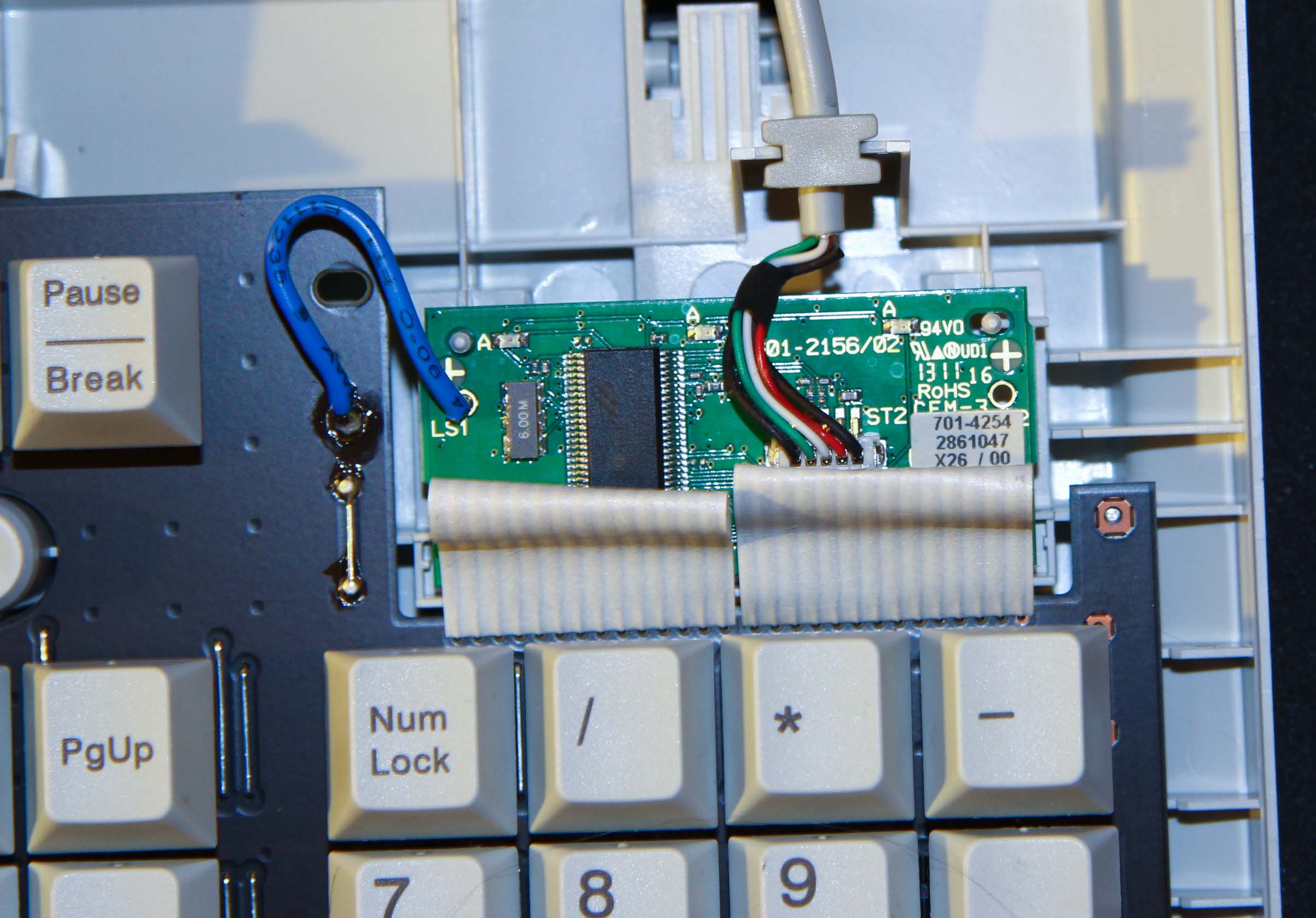

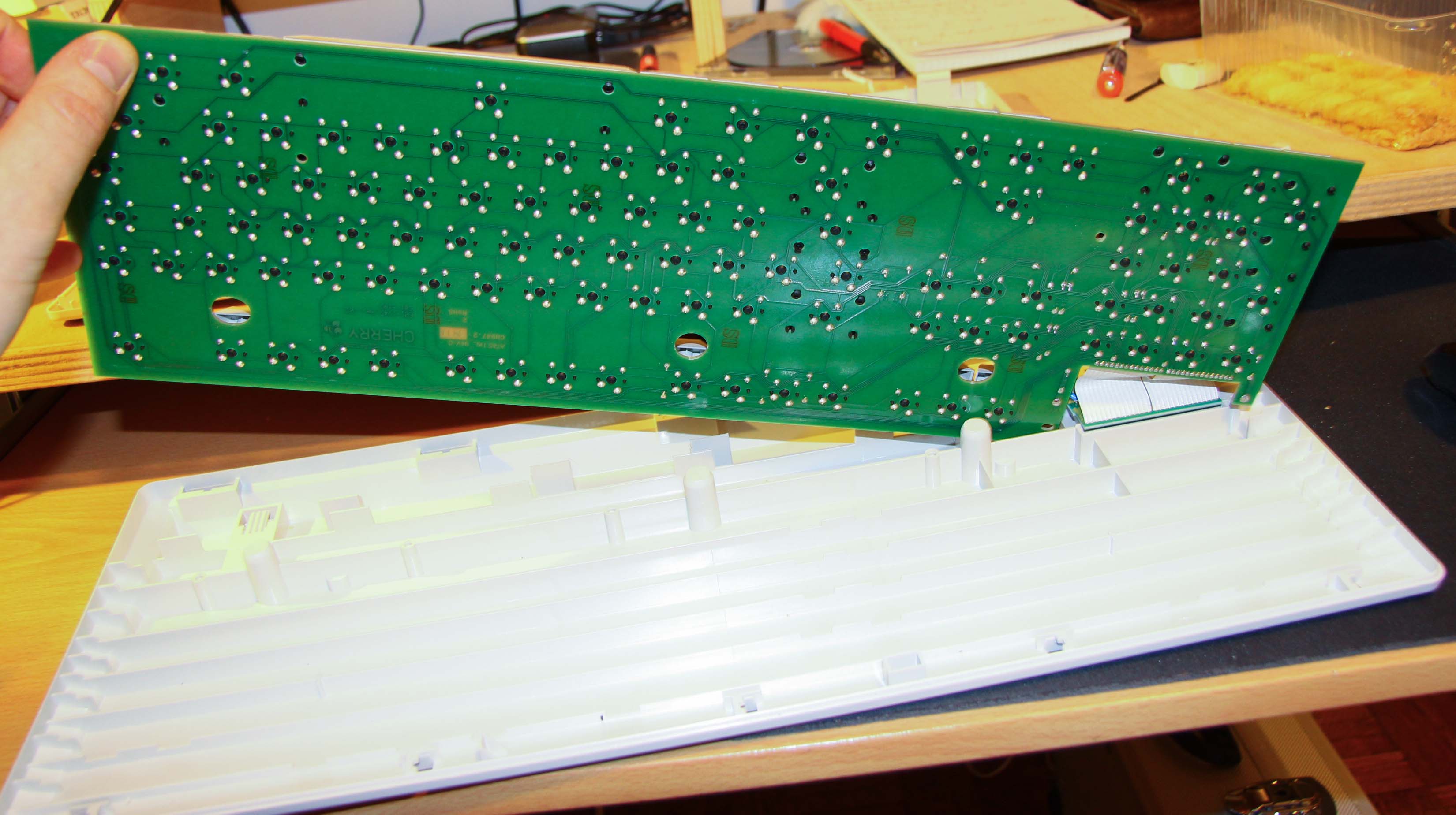

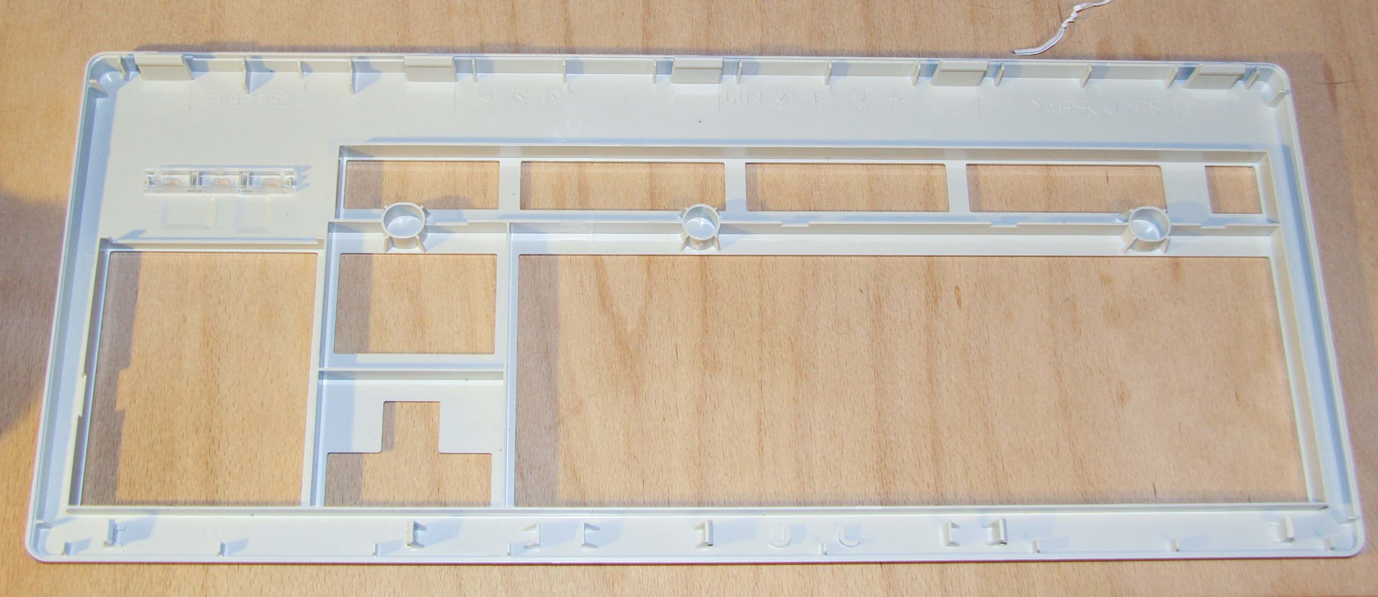

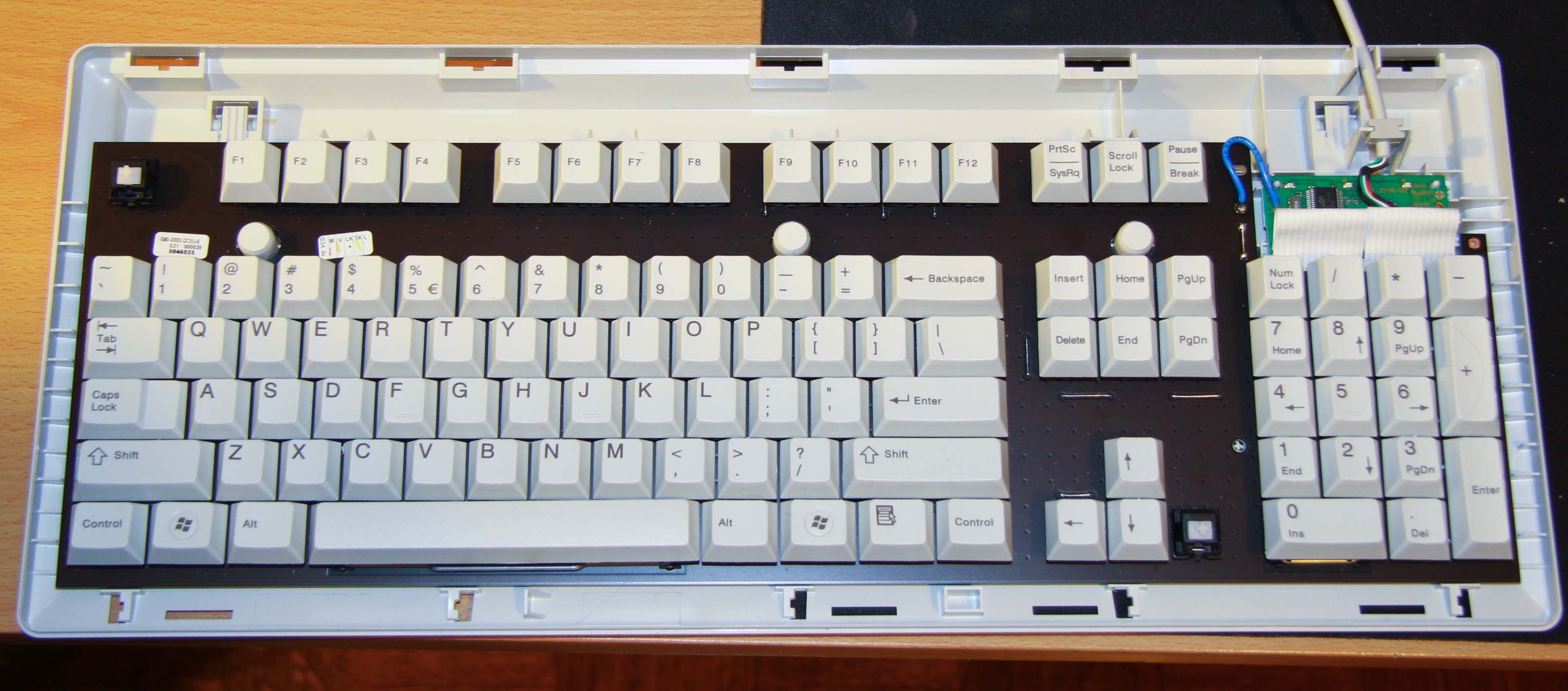

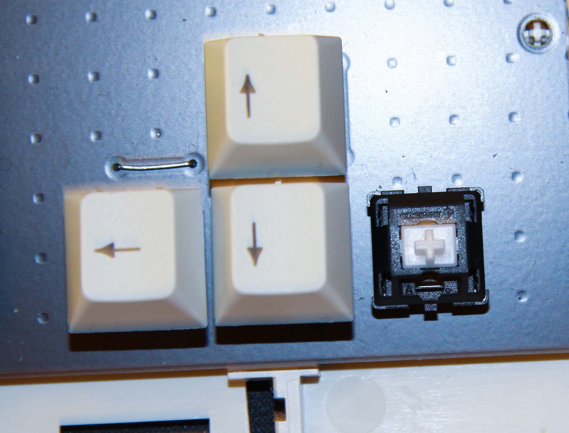

I tried to take some pictures with the inside of the board, just to have an idea of the switches, controller and the PCB board. And of course the construction of the keyboard.
The stripped keyboard.
The upper case of the keyboard. Note that there are no screws. The hole keyboard is kept in place by the clips that you see.
Here is the PCB mounted Cherry MX clear switch.
This is the PCB. No screws for that either. I think this makes it more MOD friendly.
I think this should be the controller of the board.

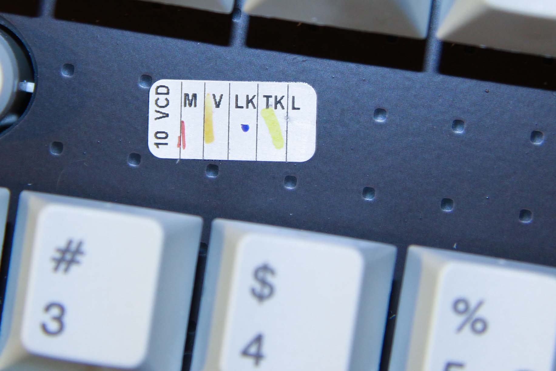

And this is something that I don't understand. I don't know what those colors and and letters mean. Someone can explain it to me?
Looks like the dots on IBM Model M labels (there are more markings inside the board). Simply seems to be a sticker used for the various stages of production and quality control. K probably stands for Kontrolle. So the people working around the production line wield markers of various colors. It is produced, someone marks it with red marker. Keycaps on top. Marked yellow. Quality control step 1. Marked blue. Etc. The last entry is probably checked when there's a fault in one of the earlier steps.
Blue, black and red dots...
filimonovici
15 Jan 2012, 19:08
You might be right, but only for the internal controls. Once you close the case, if you find some defects you'll have to open it again to mark it. This means time and of course money lost.
I have looked on the outside of the case and found no sticker for quality controls. So if you are right about the controlling, it is only for the switches and PCB controls.
And BTW we haven't found out what that 10VCD on the sticker means.
15 Jan 2012, 19:14
This seems like a board that snaps together as the last part of production. If it fails then, it will probably be tossed.
10 VCD is probably the production line code.

Reading the strip-down, I can see why the stupid thing is so flimsy :) If I have one hand resting on the keyboard and I hit a key with the other, I can feel the vibration from it, which is not a good thing. I've also seen all the keys dip inside the case when striking a function key (and not particularly hard, it's just bendy).
It does have a really good sound though: it flex takes the edge off the feel and the sound of the MX switches compared to a solid plate mount keyboard.
