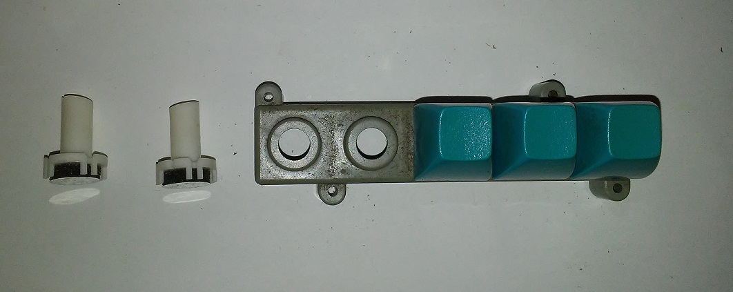

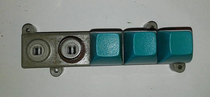

It's foam and foil, but different from the typical Key Tronics - I'm not sure who actually made them. There are no markings on the switches and no markings other than Data General on the PCB. The Switches are arranged in modules, one for the main keyboard section and each of the smaller sections. Although the seller packed the board pretty well a couple keys did snap off in transit and had to be repaired.

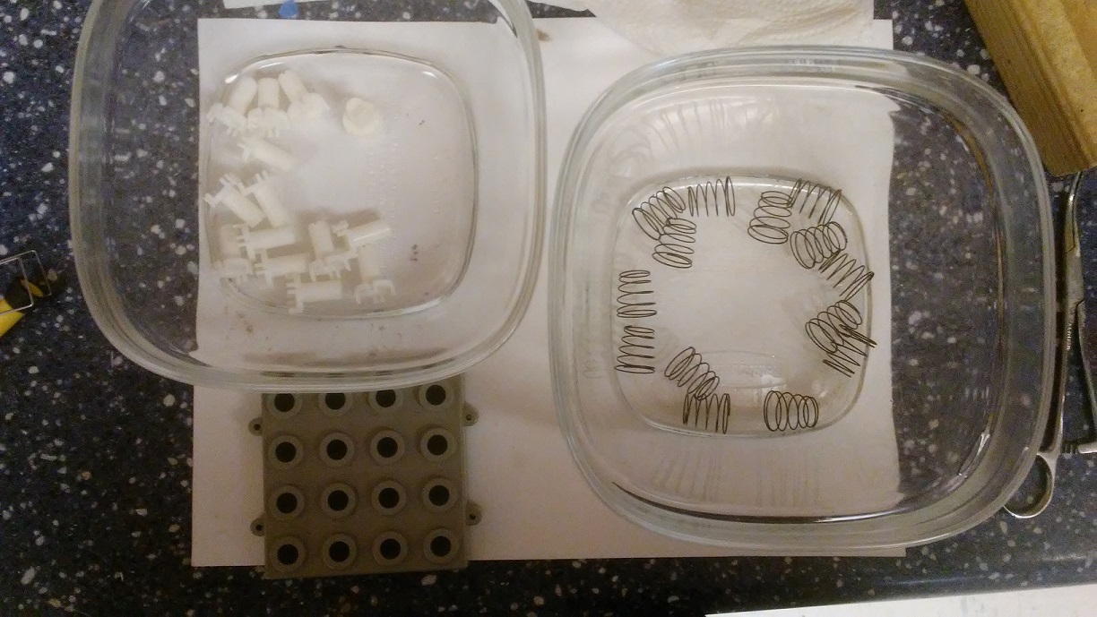

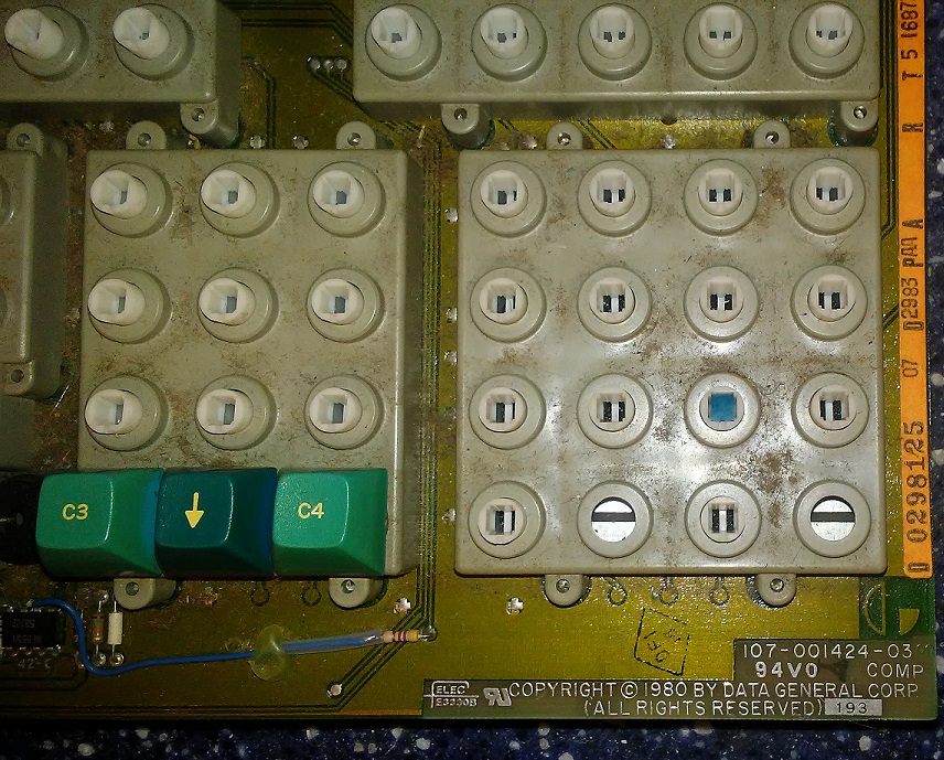

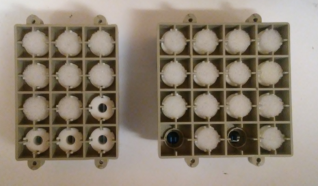

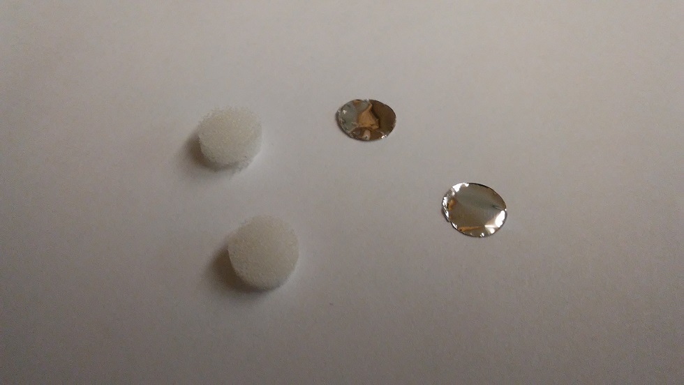

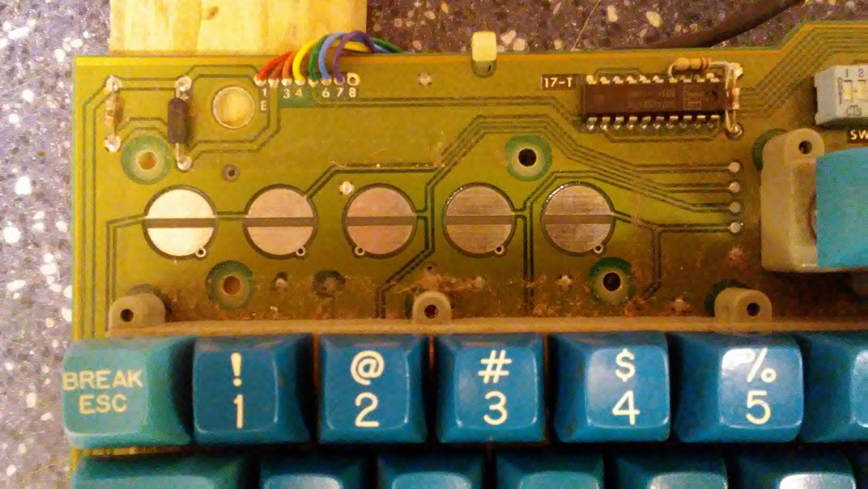

The foam and foil was shot, as usual, so I replaced it:

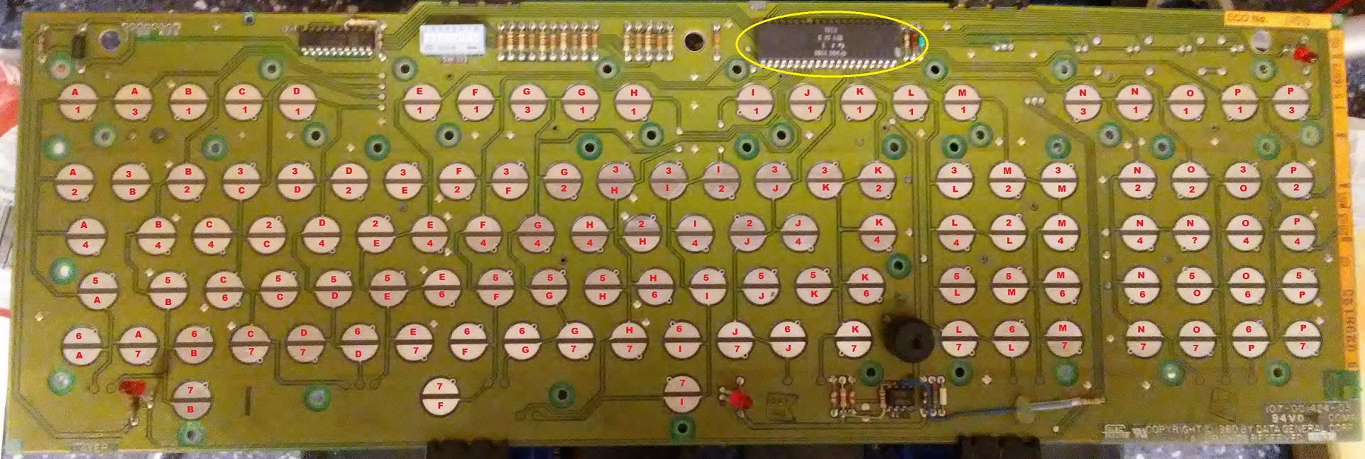

PCB Front
PCB Front

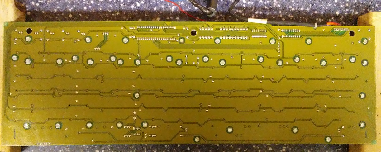

PCB Back
PCB Back

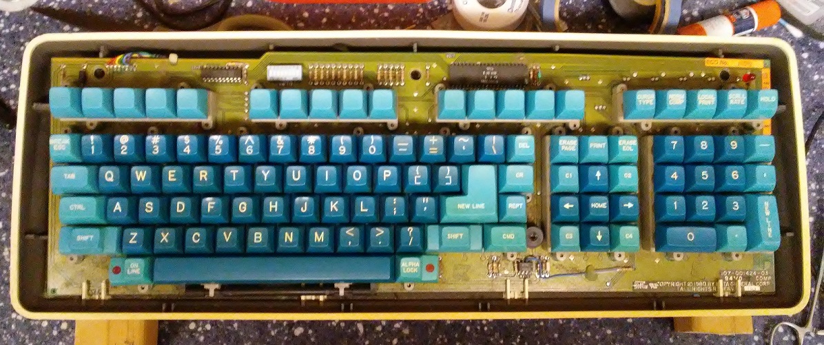

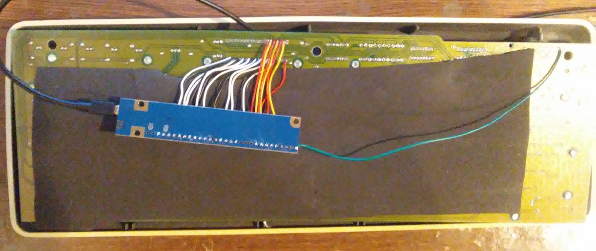

Then wired up the xwhatsit:

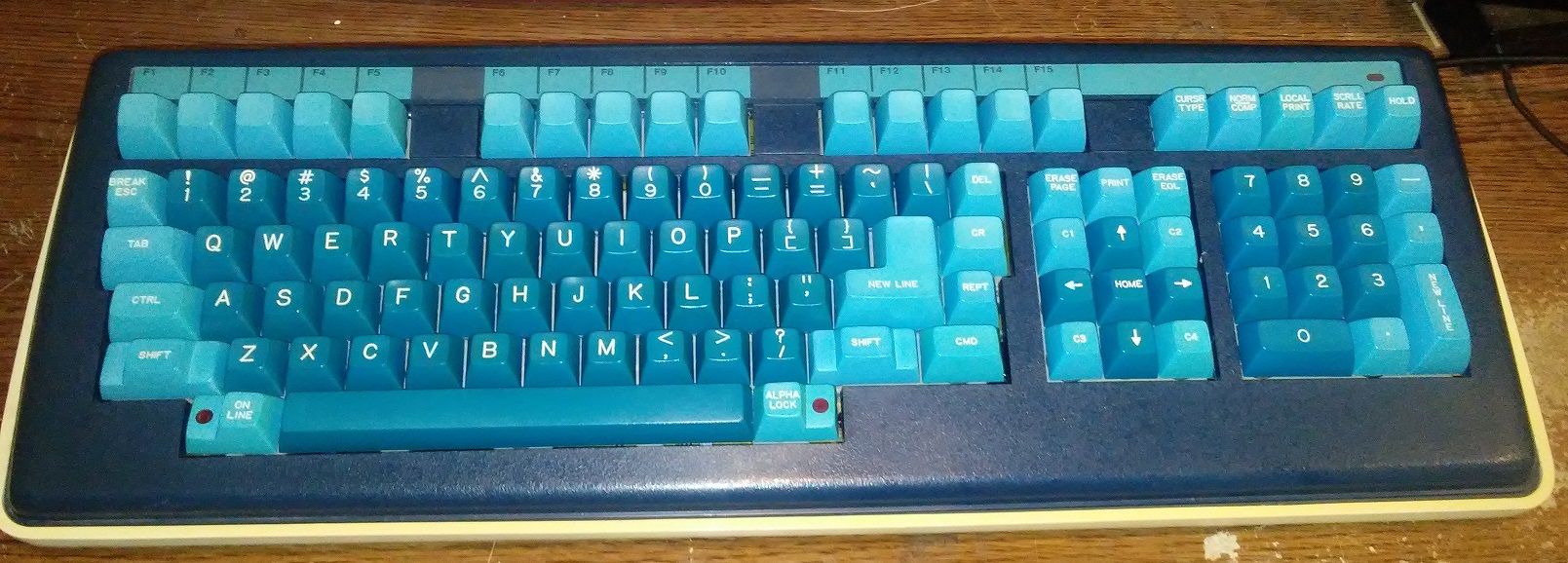

I retrobrited the keys since they were a little yellowed and they came out very nicely! Reassembled the board and typed this post with it.
The switches actually aren't bad once cleaned up and foam replaced, though I think I prefer "vintage" Key Tronic F&F.

Myoth wrote: What foam did you use ? I'm eyeing a vintage f&f keyboard and would like to know what to restore it with :)

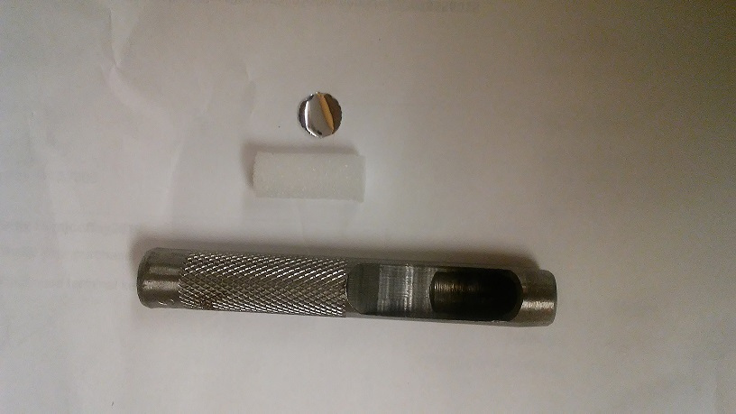

I've been using polyurethane cushion foam that I picked up at Michael's and a Mylar emergency blanket for the foil (conductive side away from PCB).
The foam was just what I could find locally and it's worked well. I've done I think 6 F&F boards now and they seem to be holding up well.
For the Key Tronic boards I found a 7/16" leather punch works very well for cutting the foam and foil:
Then I use an Exacto knife to cut the foam into 0.20" segments:
The Data General F&F was a bit larger diameter, very close to 0.5" but apparently not quite. I used a 1/2 in punch for it and it worked fine for the foam, but I did end up trimming the foil just a bit so the edges wouldn't catch.

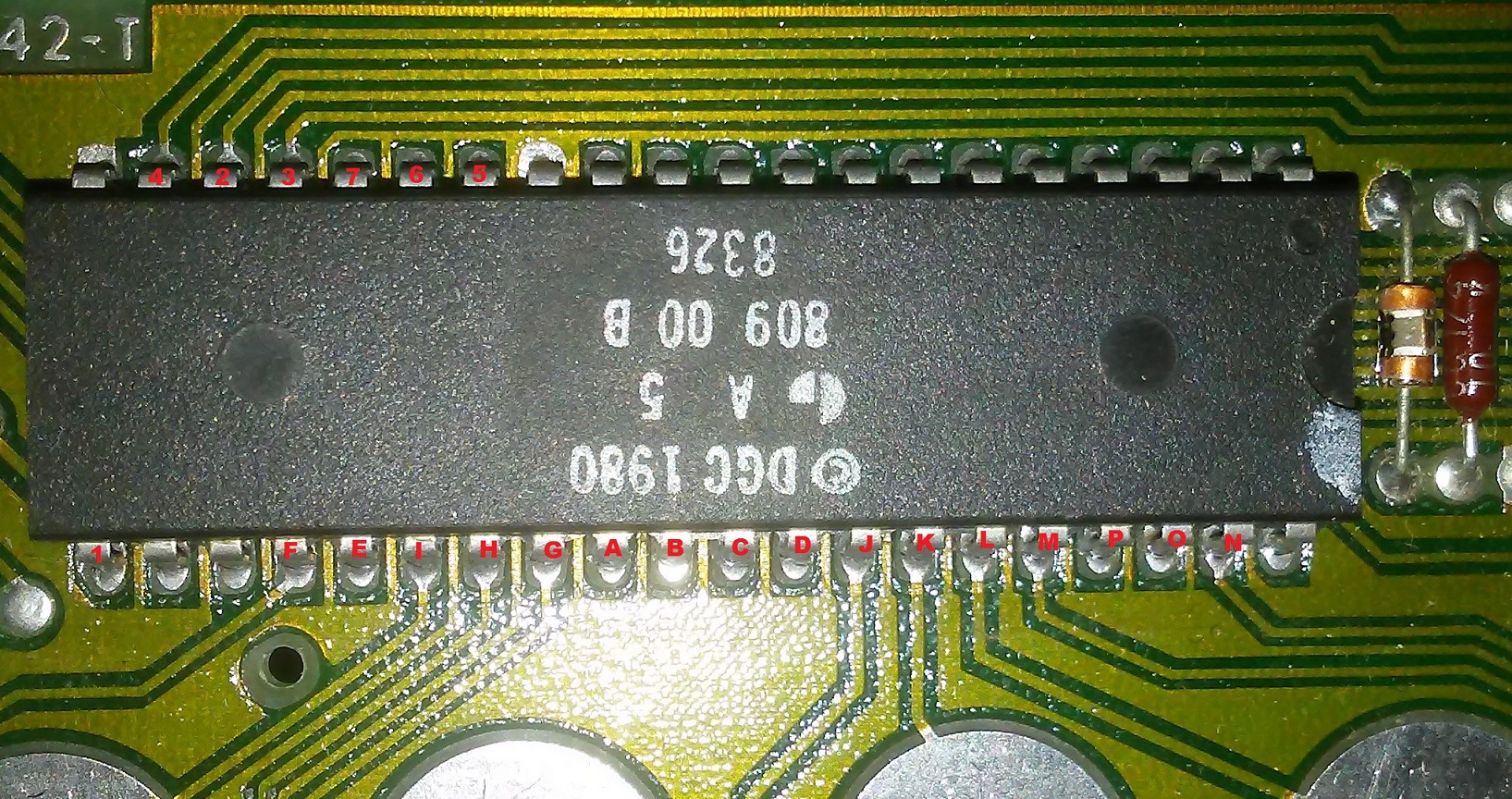

In case anyone is interested, here is the matrix and the main IC connections from my board. It's not hard to figure out but I figured I might as well post it, since it might be of some help to someone. The numbers and letters are, of course, completely arbitrary. If you notice, I forgot to label one row on one pad - but it doesn't matter with the xwhatsit - as long as you know all the rows and columns, the individual keys don't matter - the keys get assigned in the xwhatsit interface.
