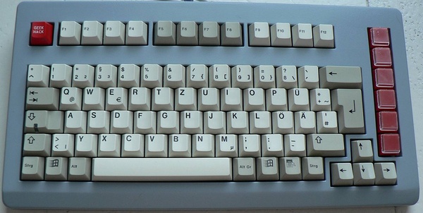

Hi all!
I'm thinking of butchering my newly acquired g80, but I have no idea of how to make a functional chopped PCB, any help is appreciated.
I've seen other posts here and on geekhack but the PCB part is always skipped.
Thanks and don't hate me for ruining such a nice board : )
Andre

Your pic is a mod made by CeeSA, you seem to have missed what he posted about this mod in another thread:
CeeSA wrote: this kind of board need 3 new lines to wire.
than every key is in original function.
if you would like to mod this model, i could send you a pic.

Thanks for the thread link kbdfr, those are very cool mods!
Mine has double shots, it's winkeyless and ansi layout, which in europe is not too easy to get by, that's why I'm a bit cautious with the mod.
I am still dubious about the rewiring.
I'm guessing, before to cut the pcb I have to follow the traces to understand what I'll need to rewire, probably shoot a good picture of the pcb.
But what if the traces on the pcb are covered? is it easy to expose them and solder some wires on?

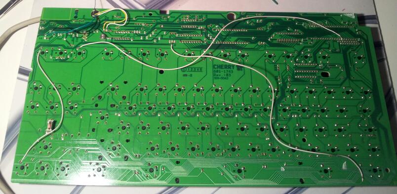

andrea-i
08 Feb 2018, 12:30
1501 pcb.jpg (66.02 KiB) Viewed 3509 times
Ok found what I was looking for in one of the threads kbdfr posted, thanks!
The solution was easy, I won't have to solder the wires to the pcb traces, simply to the pins : )
