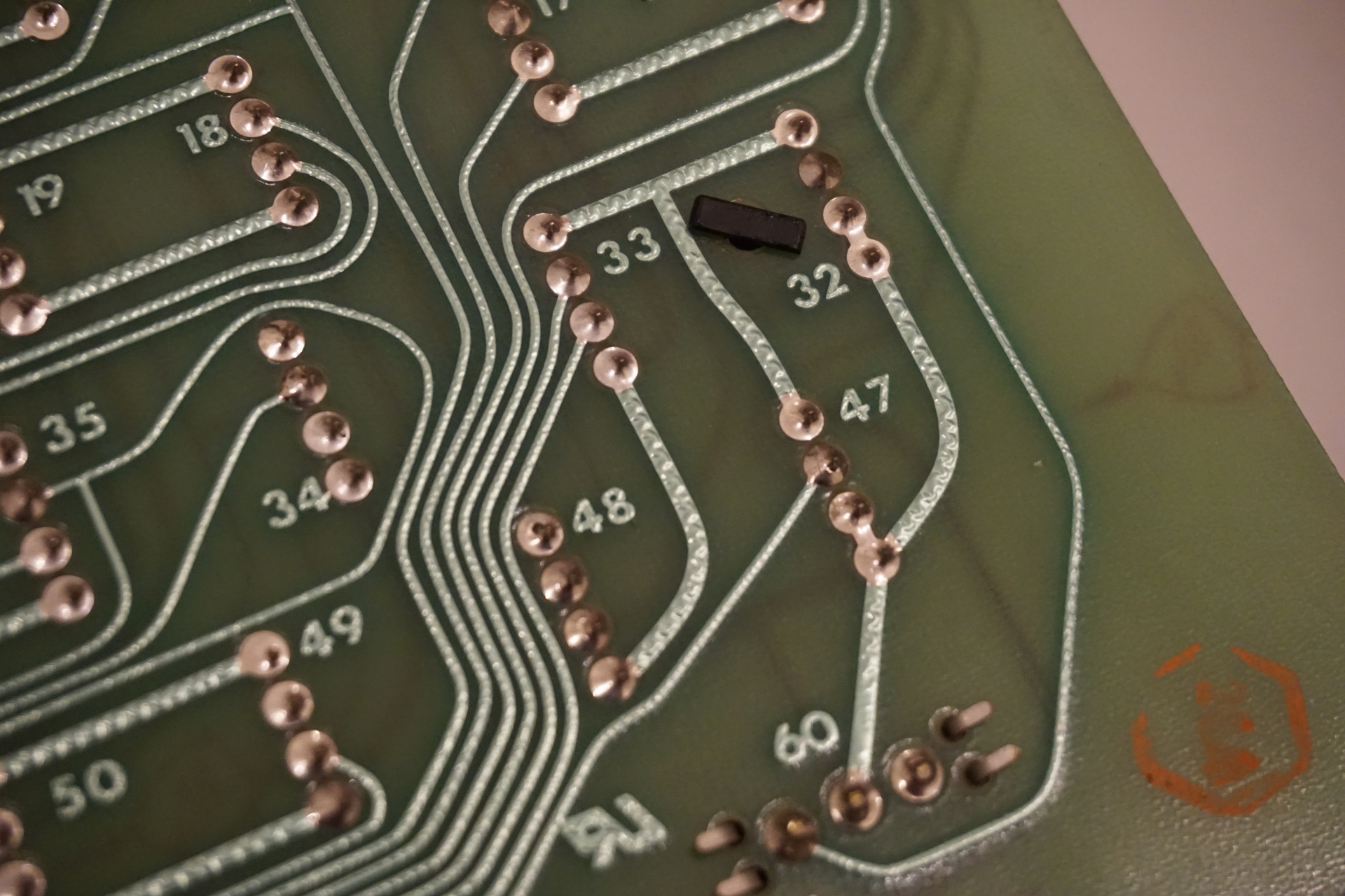

You will need a multimeter to trace the hall sensors of the switches to the connector of the keyboard. The switches will have 4 pins. The outer pins are +5V and GND, the inner pins are used to drive the matrix.
To differentiate between +5V and GND, have a look at the switches underneath the shift and control keys: two of the pins on these switches should be directly connected.
shift (47) and control (32) keys with directly connected input
The outer of these two pins is the GND pin. The pin next to GND is the input pin for the switch, and for the switches where it is not connected directly to GND, we will drive the pin low to activate the corrosponding switch.
The pin on the opposite site of GND is the +5V. The inner pin next to +5V is the output pin of the switch, and we will read it to determine if the key ispressed or not.

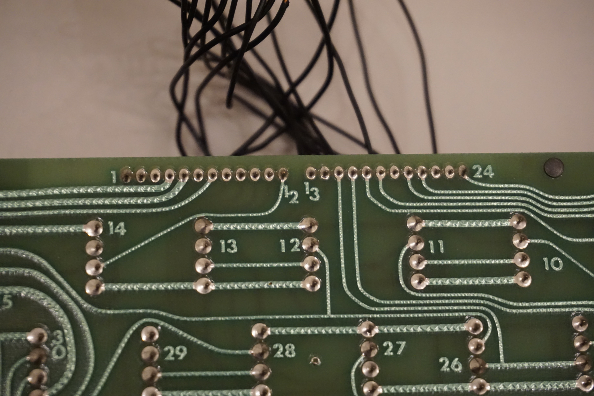

  1. Use the multimeter to determine which connections on the edge connector are connected to
    • GND and +5V.
    • the output pins of control and shift.
    • the input and output pins of the other switches. You should have 7 input connections and 8 output connections on the edge connector.
    connector with pin numbers (1 to 12 and 13 to 24)

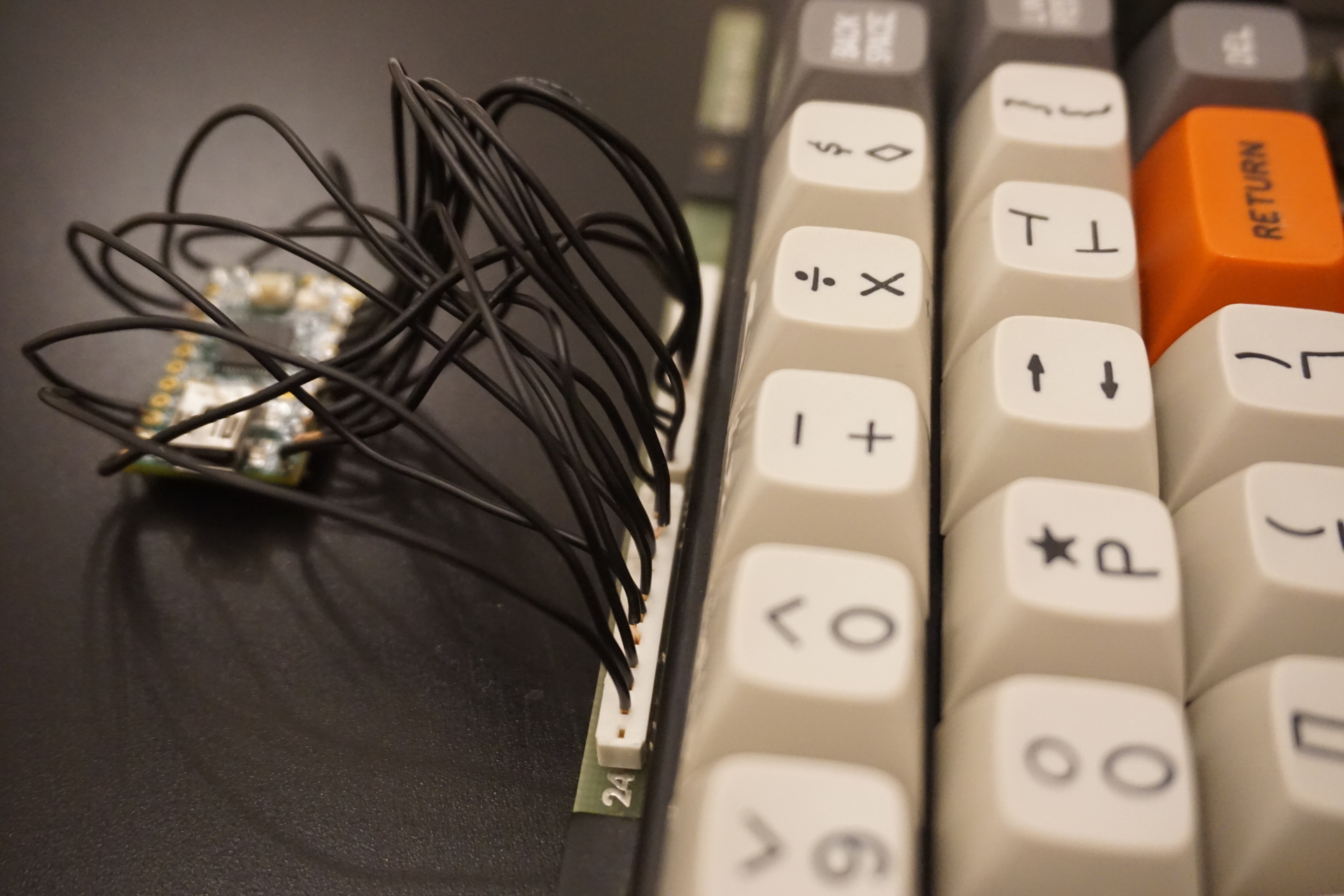

  2. Connect GND and +5V to the corrosponding pins on the teensy.
  3. Connect the input pins of the switches to pins D0 up to D6.
    (You might not want the LED to light up all the time. In that case use D7 instead of D6 and change the array 'outputPins' in the software accordingly )
  4. Connect the output pins of the switches to pins B0 to B7.
  5. Connect the output pin of shift to pin F0 and the output pin of control to pin F1.
Here are the resulting connections for my keyboard:
| PIN |  TEENSY  |    FUNCTION    |
| 1   |          |                |
| 2   |          |                |
| 3   |          |                |
| 4   |  VCC     |                |
| 5   |  GND     |                |
| 6   |          |                |
| 7   |  D0      |  matrix input  |
| 8   |  B0      |  matrix output |
| 9   |  B1      |  matrix output |
| 10  |  B2      |  matrix output |
| 11  |  B3      |  matrix output |
| 12  |  D1      |  matrix input  |
| 13  |  B4      |  matrix output |
| 14  |  D2      |  matrix input  |
| 15  |  D3      |  matrix input  |
| 16  |  D4      |  matrix input  |
| 17  |  B5      |  matrix output |
| 18  |  D5      |  matrix input  |
| 19  |  B6      |  matrix output |
| 20  |  D6      |  matrix input  |
| 21  |  B7      |  matrix output |
| 22  |  F1      |  ctrl output   |
| 23  |  F0      |  shift output  |
| 24  |          |                |

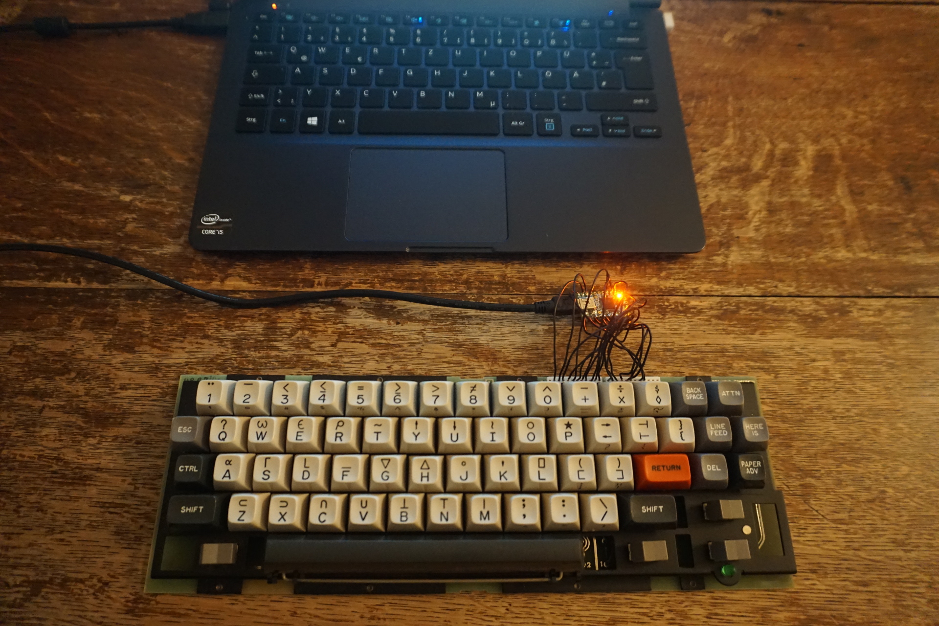

hardware ready
hardware ready

18 Feb 2018, 04:05
That is so cool! Fantastic work!
Sangdrax
18 Feb 2018, 10:50
Always super cool to see a hall effect conversion. This will be real helpful to folks I'm sure.

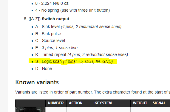

I thought that the inner pins were dual outputs, from what someone said here recently (and from prior information), but I guess I still don't understand how these things work.
Slom
19 Feb 2018, 18:24
Daniel Beardsmore wrote: I thought that the inner pins were dual outputs, from what someone said here recently (and from prior information), but I guess I still don't understand how these things work.
I even fixed the WIKI :ugeek:

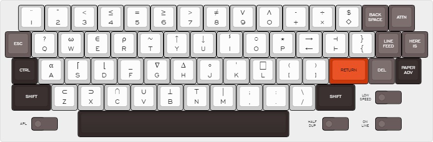

Spent the evening hunting unicode symbols. I am not sure if I got everything right yet (and the fronts are still missing), but I am running out of steam now
keyboard-layout (2).jpg (58.45 KiB) Viewed 2931 times
raw data for http://www.keyboard-layout-editor.com/
[{x:0.5,p:"SA",a:5,f:5},"&#168;\n1","&#175;\n2","<\n3","&#8804;\n4","=\n5","&#8805;\n6",">\n7","&#8800;\n8","&#8744;\n9","&#8743;\n0","-\n+","&#247;\n&#215;","$\n&#9671;",{c:"#695b5b",t:"#cccccc",a:7,f:3,fa:[2]},"BACK<br>SPACE","ATTN"],
["ESC",{c:"#cccccc",t:"#000000",a:5,f:5},"?\nQ","&#9077;\nW","&#8712;\nE","&#9076;\nR","&#8764;\nT","&#8593;\nY","&#8595;\nU",{fa:[9]},"&#11823;\nI",{f:5},"&#9675;\nO",{f:5},"&#8902;\nP",{f:5},"&#8594;\n&#8592;",{f:5},"&#8867;\n&#8866;",{f:5},"}\n{",{c:"#695b5b",t:"#cccccc",a:7,f:3,fa:[2]},"LINE<br>FEED","HERE<br>IS"],
[{x:0.25,c:"#332929"},"CTRL",{c:"#cccccc",t:"#000000",a:5,f:5},"&#9082;\nA","&#8968;\nS","&#8970;\nD","_\nF","&#8711;\nG","&#8710;\nH","&#8728;\nJ","'\nK","&#9109;\nL","(\n[",")\n]",{c:"#ca380a",a:7,f:3,fa:[2],w:1.5},"RETURN",{c:"#695b5b",t:"#cccccc"},"DEL",{c:"#332929"},"PAPER<br>ADV"],
[{x:0.25,w:1.5},"SHIFT",{c:"#cccccc",t:"#000000",a:5,f:5},"&#8834;\nZ","&#8835;\nX","&#8745;\nC","&#8746;\nV","&#8869;\nB","&#8868;\nN","|\nM",";\n,",":\n.","\\\n/",{c:"#332929",t:"#cccccc",a:7,f:3,fa:[2],w:1.5},"SHIFT",{c:"#cccccc",t:"#000000",p:"DSA",f:1,w:0.75,d:true},"LOW<br>SPEED"],
[{y:-0.75,x:14,c:"#695b5b",f:3,w:0.5,h:0.5,w2:1,l:true},""],
[{y:-0.25,x:0.25,c:"#cccccc",a:6,f:1,w:0.75,d:true},"\n\nAPL",{x:1.75,c:"#332929",t:"#cccccc",p:"SA SPACE",a:7,w:8},"",{x:0.5,c:"#cccccc",t:"#000000",p:"DSA",w:0.75,d:true},"HALF<br>DUP",{x:1.25,w:0.75,d:true},"ON<br>LINE"],
[{y:-0.75,x:1,c:"#695b5b",f:3,w:0.5,h:0.5,w2:1,l:true},"",{x:10.5,w:0.5,h:0.5,w2:1,l:true},"",{x:1.5,w:0.5,h:0.5,w2:1,l:true},""]
