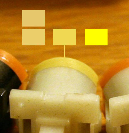

I took a photo of that yellow switch under natural light and the RGB values look like this.
I guess I just don't like calling it yellow since it's not a nice bright chromium base dye. If I was painting that color, I'd make it by starting with white and adding a drop of brown and a drop of yellow. Which to me is a very light warm brown rather than a dirty yellow, but obviously not the standard.
What I called white is just the natural undyed color of the plastic, whatever the standard is.
20 Feb 2018, 02:52
In your photos, and everyone else's, it's clearly pale yellow. I have no idea where you got that golden sand from.

All I did was use the eyedrop tool to get the RGB values from a natural light photo with proper white balance. Look for yourself. There's red/orange/white etc on the background paper for other color comparison.
20 Feb 2018, 09:48
This is the picture you posted (without any colour balance applied), with golden sand and pure yellow for comparison:
Another set of photos of the base: [wiki]STM Pied Piper[/wiki] — although it's possible to argue that this is "cream", it's best to avoid it all the same due to confusion with the ivory shade used for the shell and slider. (They are definitely ivory, as opposed to [wiki]colourless[/wiki], although whether they are pigmented ivory or whether that is the natural plastic colour, is not known.)
To be certain, you need a camera with good white balance adjustment and/or use of the flash to control the lighting.

That first picture is under a yellow indoor light at night. And I can't fully correct for that without everything getting washed out with glare because the relative light is so low. The second is color accurate though.
But like I said, you guys know how to name things, not me. I do have some real ivory laying around from an antique piano that got scrapped a couple years ago if you want some comparison photos if that might help too. It's not particularly translucent and more white than the sliders IMO.

The worst one is "white" vs "clear": with Cherry, "white" means pigmented white and "clear" means "colourless" (Cherry's own terminology), but for any other brand, we use "white" for both colourless and pigmented white! Alps used "ivory" for what we call SKCM Cream Damped (per the 1994 catalogue), whereas I'd use "ivory" for the older, non-damped tactile switches (SKCM Cream) that are a different shade (be that intentional or otherwise).
The problem with using "cream" for the base, is that the shell is closer to real cream colour, although the base in some cases looks the colour that Wikipedia calls cream (which is pale yellow, and nothing like the colour of actual cream).
Those Futaba shells are a really weird translucent cream or ivory shade that looks like it might be some kind of raw plastic with a natural tint (called "natural" by Siemens), as opposed to naturally colourless "white" plastic. It's definitely not something that falls under either of our conflicting definitions of "white". Cream or ivory, I guess, but it's hard to tell as it seems not to be consistent; in your colour-accurate image, though, the shell comes out blue :)
