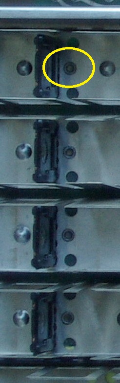

What metal plate? There should be only the PCB and the cage for the switches.
This one Image
This one Image
Image does not load. If you are talking about this: ...
... that is what I called the cage above. I just checked two of my board and, like in the picture above, there are small rivets that hold the PCB and the cage construction together:

Maybe the rivets can be replaced with very small bolts (I have some switch modules that are screwed to the pcb with the most thin bolts I've ever seen)

PlacaFromHell wrote: Are the hall effect sensors directly soldered on the PCB? This starts to be promising
They are soldered to the PCB. You will have to remove the sensor and the rivets to separate PCB and cage construction.
