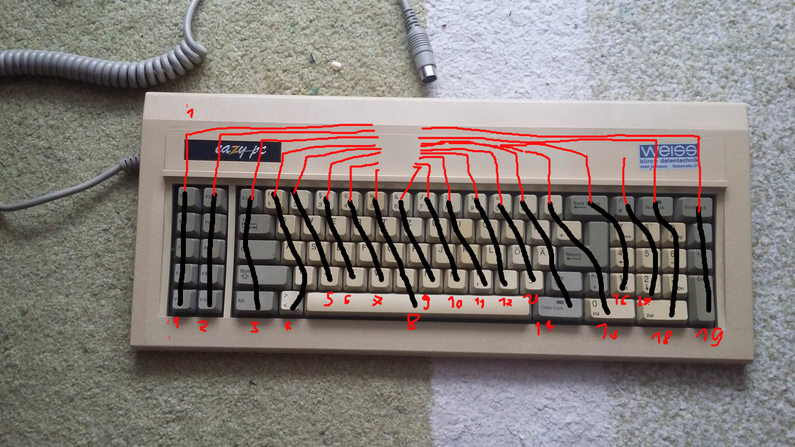

Here is the matrix
Artist's rendition :)
green-squid
28 Mar 2018, 16:44
Is this how you do a matrix?

green-squid wrote: Is this how you do a matrix?
yes and you will need also a pin for each row, so you would need 24 pins (19 columns and 5 rows) on you controller board assuming no lock lights

Thank you! That link is not for handwiring though.
Matt3o made some handwiring tutorials, but he didn't go into great detail about how to really wire it up (if I recall correctly).

ummmm that isnt how it works... not at all.
read this. workshop-f7/brownfox-step-by-step-t6050.html
No, not at all
