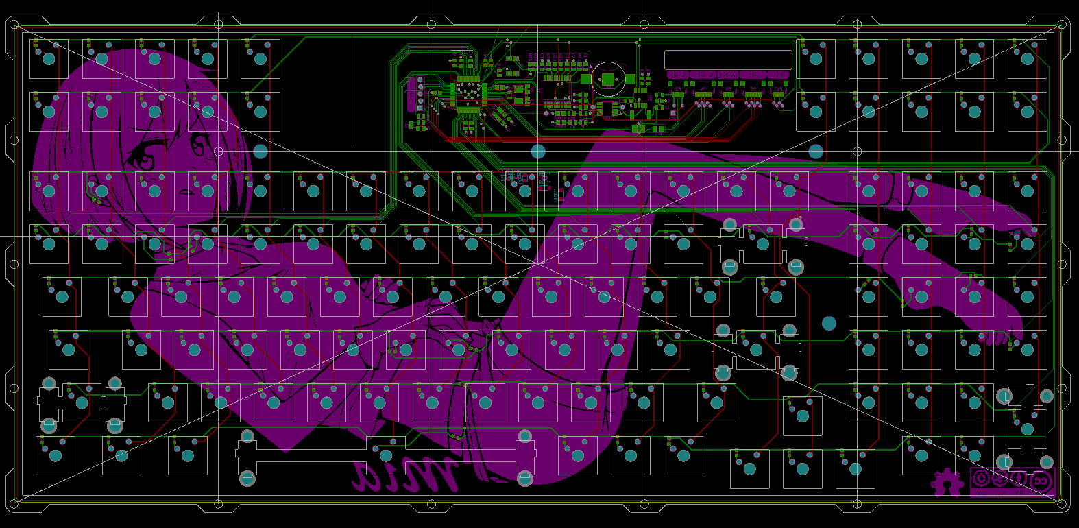

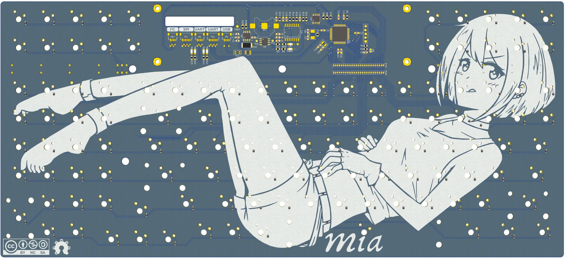

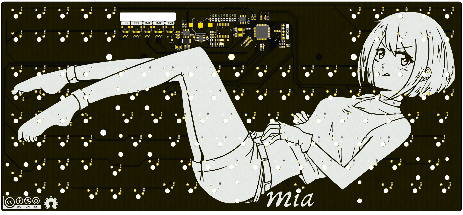

This is Mia, a keyboard design of mine that I'm building a couple off and preparing package for open source.
Just wanted to see what people thought before I sent it off for fab? And if anyone had any good tips on how to package an open hardware design(as this will be my first open hardware project)?
My main goal is to have a portable RS232 terminal and password manager that will fit in 19" rack tray.
PCB Back.
PCB Back.
PCB
PCB

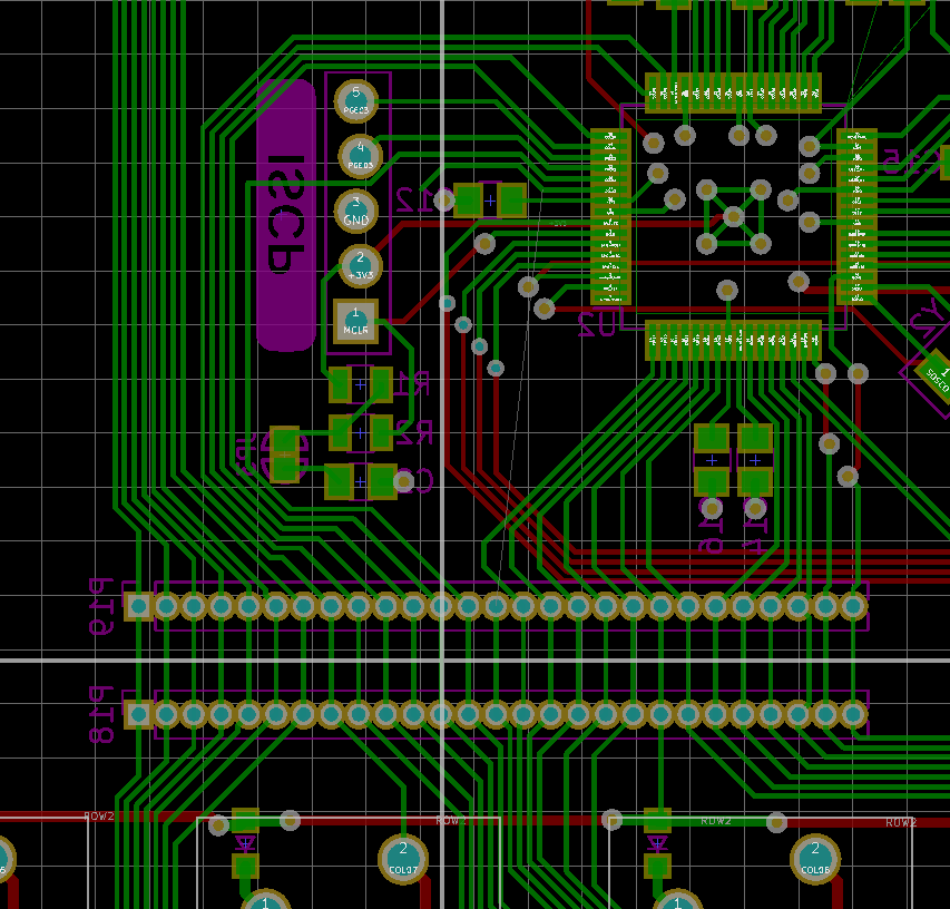

micro is pic32mx470, If your curious about the layout, I guess I am too and I have no idea if the ideas will play well to a general audience, but the general idea is that the top two rows will be for controlling the terminal and some of the ways the keyboard behaves. Putting the screen on gave me a bunch of empty space so I just put some extra switches there. I'm open to ideas.
31 Mar 2018, 13:07
Looks interesting, but the PCB art is not for me :lol: I love when people design big keyboards with different unnecessary extra hardware to fill the gaps.
zool
31 Mar 2018, 14:21
:) Undoubtedly the art is/will not be to every ones taste, but it is to mine. :) I really can't see anyone else wanting to build this exact board, so practically its just for me and a couple of other friends. In general though I would like to see more art on pcb's, I mean you don't really need to see designators for all the diodes and keyboard pcb's have lots of space to tell a story. It just adds a little character and personality imo.

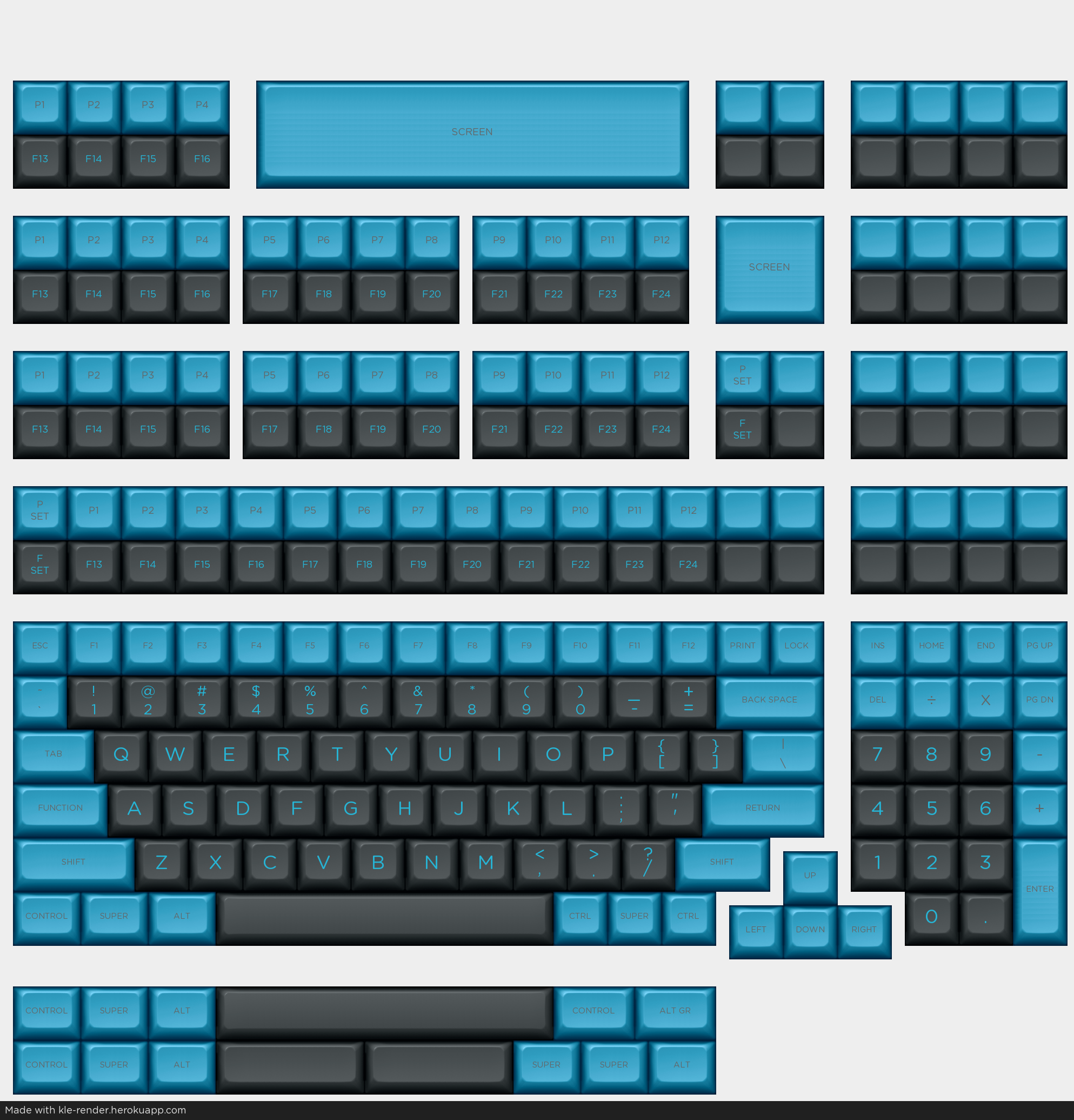

My original idea had a pencil/trinket space, but I added the extra 10 keys to the top left of the pcb for "options", I don't know what those options would be. Macros I guess, I don't really have a lot of use for macros. Its hard enough to get caps for this kinda layout as it is without the top two rows, so blanking plates will definitely be a design option for the case.
Myoth
31 Mar 2018, 14:25
It would be nice to add holes for switches where the screen is, for exemple, I could be more interested by a lot more keys than a screen...
by the way, your pcb doesn't support pcb-mounted switches ?

zool
31 Mar 2018, 14:51
Myoth wrote: It would be nice to add holes for switches where the screen is, for exemple, I could be more interested by a lot more keys than a screen...
More switches? Here I was thinking 122 keys was already a lot. :lol: Dropping the screen is not something that works for me. In a lot of ways the screen is the required for what I want.
But an extra header could be added for a key expansion. If I add some 0.1" pins you could saw the top two rows with the controller off and have a more std 1800 layout with separate controller, would bulk up the stack up a little, but might be ok.
I don't use pcb mount switches, a simple footprint swap you get you there though.

zool
31 Mar 2018, 17:05
cutoff header expansion header like this:?

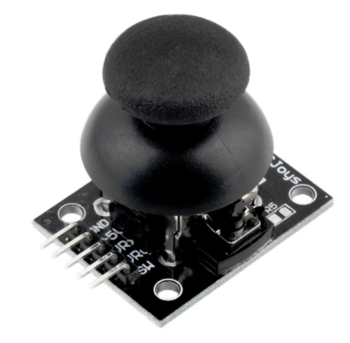

31 Mar 2018, 18:23

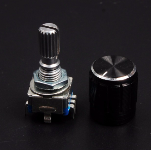

I've recently been thinking about extra add-on hardware I could add to large keyboards like this and specifically thought of:
A rotary encoder, maybe to send vol/brightness up/down keypresses?
Screen Shot 2018-03-31 at 12.06.32.png (254.55 KiB) Viewed 10786 times
A joystick, maybe as a pointing device with extra mouse buttons?

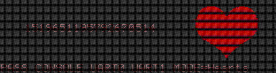

Tell me about the display you're planning on using. Doesn't looks like it'll do 80x24?

zool
01 Apr 2018, 02:21
__red__ wrote: Tell me about the display you're planning on using. Doesn't looks like it'll do 80x24?
I'm using a generic spi 256x64 graphics 4 bit mono oled (ssd1322), so not an 80 col, only 40x7 with 5x7 font.
It's a compromise, between readability, cost, space and power.
zool
01 Apr 2018, 02:51
scottc wrote: I've recently been thinking about extra add-on hardware I could add to large keyboards like this and specifically thought of:
They seem most appropriate on such a huge board.
With the i2c bus header you could certainly do something. I came to the conclusion that using USB HID to control system volume is a bit coarse to warrant an encoder. I do enjoy a good encoder indent tho. :D
My current solution (not this design) is to have media volume keys for -/+5% volume and then with super + volume up/down for -/+1%, but that I pretty sure is OS dependent.
For this design the default keymap:, func + pageUp,pageDown or numpad+/- is media volume +/-.

01 Apr 2018, 03:35
here is a rendering of a frame to give you an idea of the resolution:

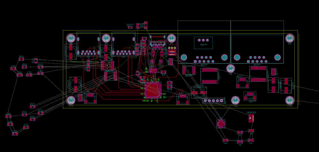

DiodeHead

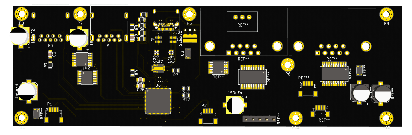

zool
01 Apr 2018, 13:29

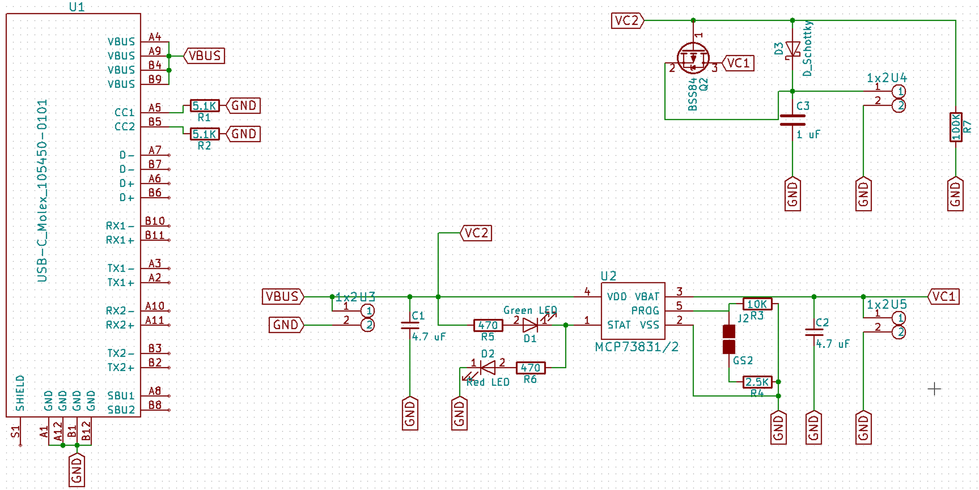

thanks, It is very unclear as I'm still struggling with a decision to USB C or not to USB C, So for the sake of finding bad/good choices/idea I'm just running with with the keyboard layout and controller for the moment. Get the all the password and ui standing on it legs and work from there.
The other component to the design is an unfinished usb 3 hub and RS232 board. I got some of the parts and am designing one up, but there is no way I can get anyone to build that as a kit from src, the 0.4mm pitch qfn and 0402/0201 is just too fine for most DIYers.
So as a companion there will be some other usb micro/mini/C/B to the 4pin JST1.0 mm pitch connector, similar to the quickfire where I think they have a separate board for the usb connector. I always liked that design of the usb connection being secure by cable way under the board. and as long as the connection is short, the less than perfect 4pin JST cable should be ok, and you can pick up premade 1.0mm JST to JST cables from sparkfun. It is also why there is extra esd protection on the controllers usb line, a redriver might also be needed, but probably not.
Battery is for the RTC, I like clocks and normally put a footprint for a good txco/rtc on most of my designs needed or not. but also has some use for syncing, but it is optional build option, I have no real immediate use for it and at ~$4.00 it is pretty pricey component wise.
anyway here is the state of the hub.
DiodeHead
01 Apr 2018, 14:10
ok now i completly get the connector situation, very cool i can't wait to see it in action.
I know is provably too early to ask but, what are your thought on the case design and construction?.
__red__
01 Apr 2018, 15:44
zool wrote:there is no way I can get anyone to build that as a kit from src, the 0.4mm pitch qfn and 0402/0201 is just too fine for most DIYers.
So I'm curious. What aspect of the design requires a .4 qfn and such small passives?
I don't see anything in your design (yet) that's that high speed...
Incidentally, I love those displays and I use them a lot. If I can give you a supplier recommendation take a look at buy-display.com.
I've bought around 600 of them from this supplier for my various projects without a single failure.

__red__
01 Apr 2018, 15:48
Nm, spotted it. It's the USB3 circuit.
My advice, unless you have a compelling reason to do USB3 I'd avoid it. It's tough to get that right without 4-6 layer boards from companies that do capacitance control and certification.
Also, if you do decide to do PnP, to get a reasonable yield from a third party they're going to insist on X-ray inspection which is $$$ in low quantities.
Sent from my SM-N920V using Tapatalk
__red__
01 Apr 2018, 15:50
Of course, you may already have experience of building high speed boards like this. If so, you'll know better (And almost certainly know first hand why I'm so cautious).

zool
01 Apr 2018, 16:52
__red__ wrote: Of course, you may already have experience of building high speed boards like this. If so, you'll know better (And almost certainly know first hand why I'm so cautious).
Not quite usb 3.1/2 speed. The usb C(especially) 3.X hub has so many subtleties, and tangential to the keyboard, it as you say is quite costly which is why I split it off for a future personal project, but leaving myself the option to slot it in to the case. It would be nice to have, but... to much for an open project, I suppose I could do a run but who would really want them? I only really mentioned it to explain the reason why the JST connectors and not a usb connector.
At the moment I happy with a simple single port usb connection modules, ie: just use which ever usb variant that you like and put it where ever you like etc. I know people have preferences for different conns and locations. I'm partial to C and B myself.

zool
02 Apr 2018, 19:14
final v1 art, I included some ideas from here.
zool
04 Apr 2018, 13:43

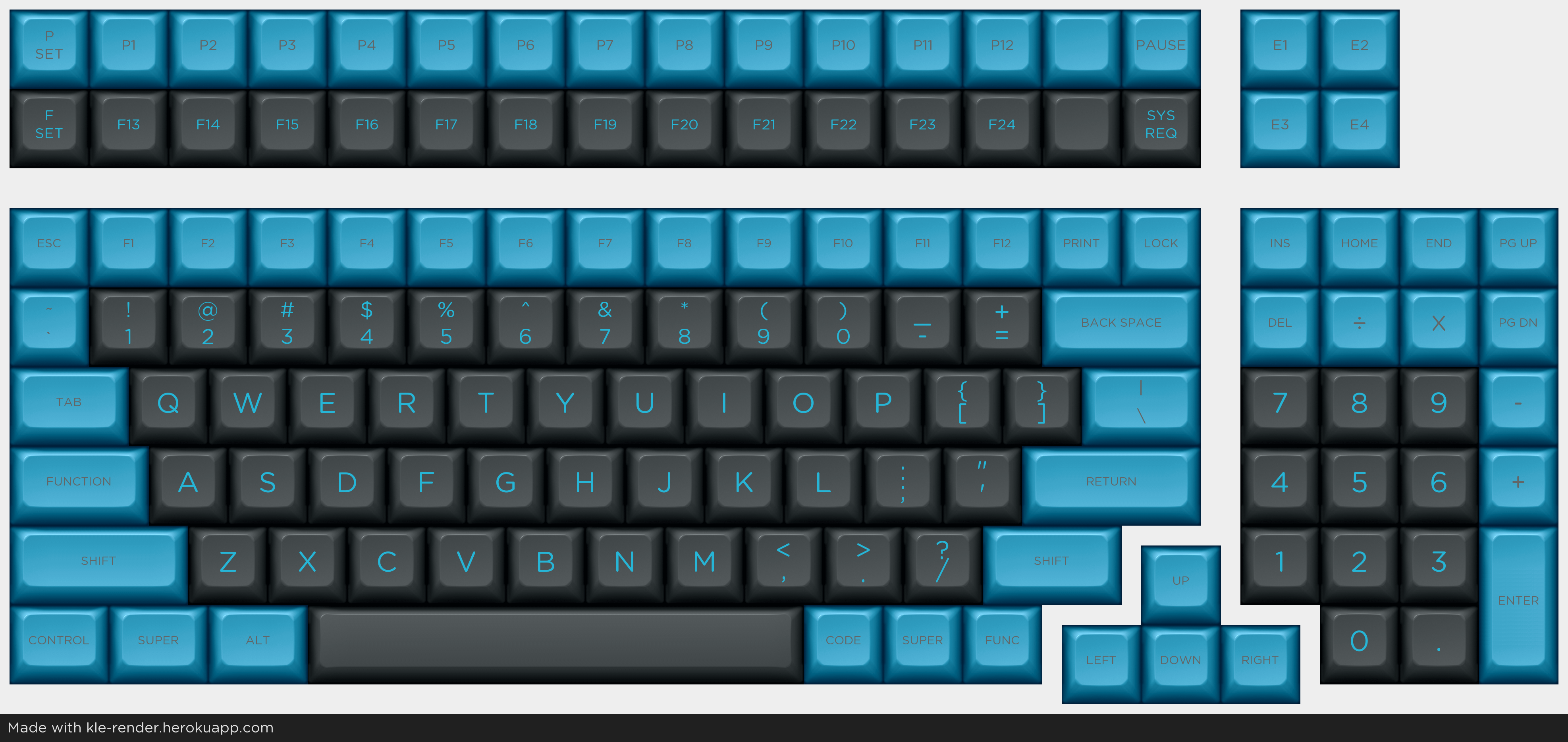

while waiting for boards to arrive thinking about some of your ideas a bit more:
replace E keys with encoders: top right blank, space for one of the cheap oled/tft square 1.69" screens.
I would have to drop one of the uarts, but thats ok.
thokir
04 Apr 2018, 13:55
Hmm... I prefer the design with the bigger screen, as it could be really useful.
Would it be an option to put some of the F keys to the left of the alphas to have more space for the screen?
I'm really interested in how this board is gonna turn out in its final version! :)
zool
04 Apr 2018, 15:12
If I have not messed up the design I'm not going to change anything till I get a working board.
I like the screen too(but kinda pricey in low qnty), but If I design it as a split pcb it could be designed so that people could do what they want with the top rows. It could be both or neither depending. some things are up in the air.
Here are some of the other possible ideas for the top two rows which make sense to me. once again some the keys above the numpad could be encoders.
