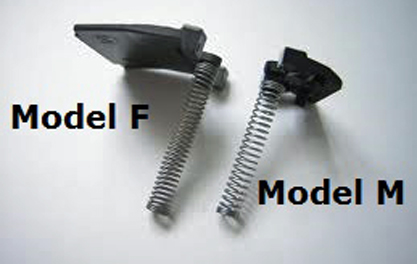

So I just received the Model F 5155 that has probably been left outside for decades considering the amount of rust. Are Model M/M2 springs compatible with F and if so is there a major difference in feel?
- fohat
- Elder Messenger
- DT Pro Member: 0158
I think that they are pretty close, and I know that they can be interchanged.
If the M/F project ever comes back, I know that lot_lizard had a bunch of new springs made. He was going to send me some of the light ones to try out, but never did.
- IBM-M-F-spring-hammer.jpg (64.32 KiB) Viewed 4032 times
