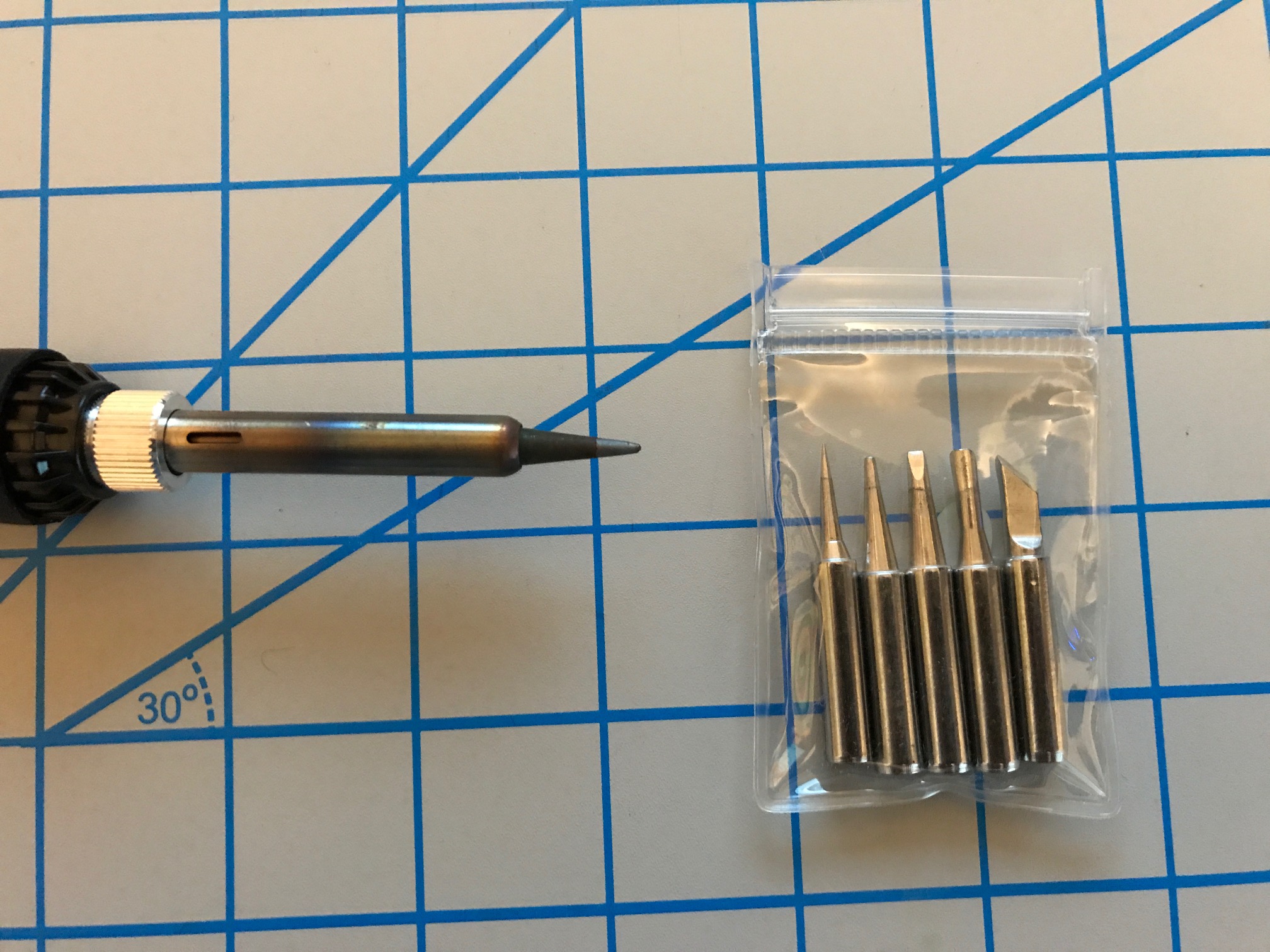

Thanks, guys. I've attached a photo of the cheesy soldering iron I got from Amazon as well as the replacement tips. I should also try using a higher temperature.

In general I recommend a chisel tip for keyboard related soldering. It's the perfect combination of heat transfer and size in my opinion.

Sounds like the pads aren't getting hot enough to me. The other guys are right. Swap out to a tip with a flat surface for heat transfer and make sure you can get a little solder to stick on the pads before you try to attach the capacitors.
