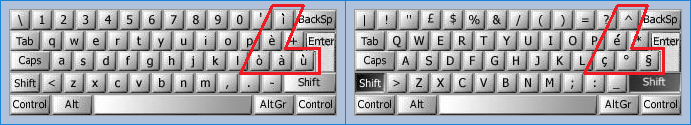

As you know, I like to tinker with the logical layouts that exist on top of the keyboards' physical layouts, and I've made several custom ones for different needs. After doing a revamp of the French national layout, I focused my attention on the Italian one, with which it shares one of its most notorious design defects — the mixing of different accented letters on the base and Shift layers of a single key, making it impossible to type them in uppercase.
Problematic key asssignments in the Italian layout.
I figured I could make an improved version of the Italian national layout that corrected this flaw and would better serve the modern needs of the country. The design had to fulfill the following criteria:

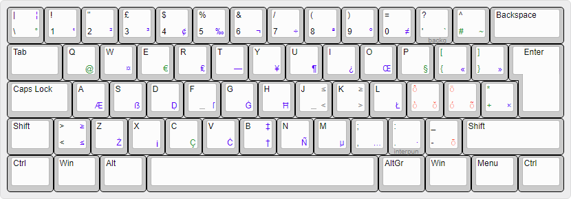

New Italian layout.
New Italian layout.
The symbols in green are those that already exist in the Italian layout but have been moved elsewhere; the symbols in blue are newly added in this layout; the dead keys are marked in red. The euro symbol (€) is marked in green to make note that now it's present ONLY on AltGr-E.
The main features are:
  • Besides Ç and the accented vowels, eight symbols have been moved elsewhere (°, @, §, `, #, ^, + and *); square brackets and braces remain in the same keys but have been moved out of the AltGr layers. All other extant assignments remain untouched.
  • The grave and acute accents are available as dead keys on the base layer in the home row. The same keys on the Shift layer sport the circumflex and the diaeresis diacritics, and breve and tilde on the AltGr layer. AltGr-minus contains a dead key for the macron diacritic.
  • Ç is now on AltGr-C.
  • All the vowel/diacritic combinations that some languages and dialects require are covered by the five main diacritic keys (the breve and the macron diacritics were included for writing in Latin). The extra consonants, ligatures and typographic symbols that are needed have assignments on the AltGr layer: Ḍ (Sicilian), Ł (Venetian), Æ (Franco-Provençal, French), Ċ, Ġ, Ħ and Ż (Maltese), ẞ (German), Ñ (Spanish), · (Catalan), etcetera. Note the presence of a long S as well.
  • This is an ISO layout, but a provision is made for ANSI keyboards, by having a secondary assignment for the characters <, >, ≤ and ≥.
Using MSKLC, I created the software driver to install this layout on a Windows-based PC; I've been testing it on my own and already have an Italian friend getting acquainted with it as well. Of course, it will be for the best if more Italians (and Maltese, too! And Swiss people as well!) try out this layout and give feedback.

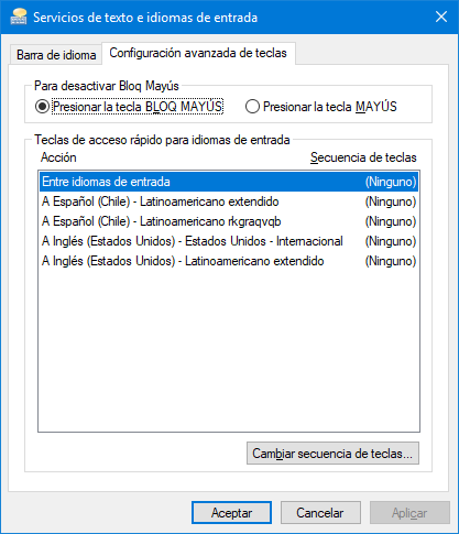

I'm continuing to use this: I find a bit hard to adapt to the dead keys, but that's only because I never used them before (and because both my Windows installation keep randomly defaulting back to the standard Italian layout for some weird reasons. Well, it's Windows after all.)

DustGod wrote: (and because both my Windows installation keep randomly defaulting back to the standard Italian layout for some weird reasons. Well, it's Windows after all.)
Make sure that in the Control Panel you have UNset all "quick access" key sequences. Windows is unsufferable otherwise.
Couldn't find this specific setting, it must be hidden somewhere else on my version of Windows. I solved the problem by violently removing the default Italian layout.

I've made a couple small adjustments to this layout and have declared it complete (for now, of course) and I've updated the initial post accordingly.
For those that are interested, you may now download it from its official page at http://www.farah.cl/DistribucionesDeTec ... al_en.html (a version of the page translated to Italian will be uploaded very soon).
