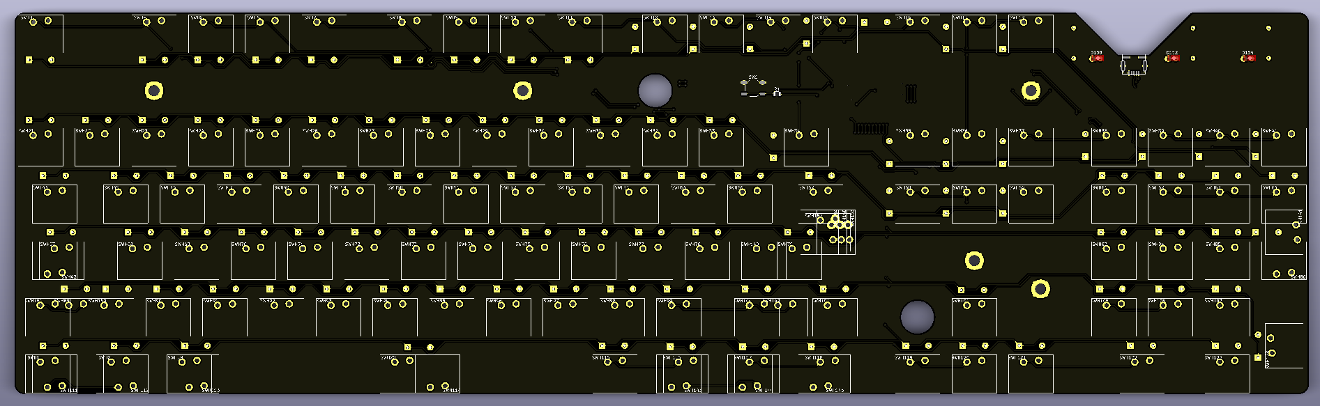

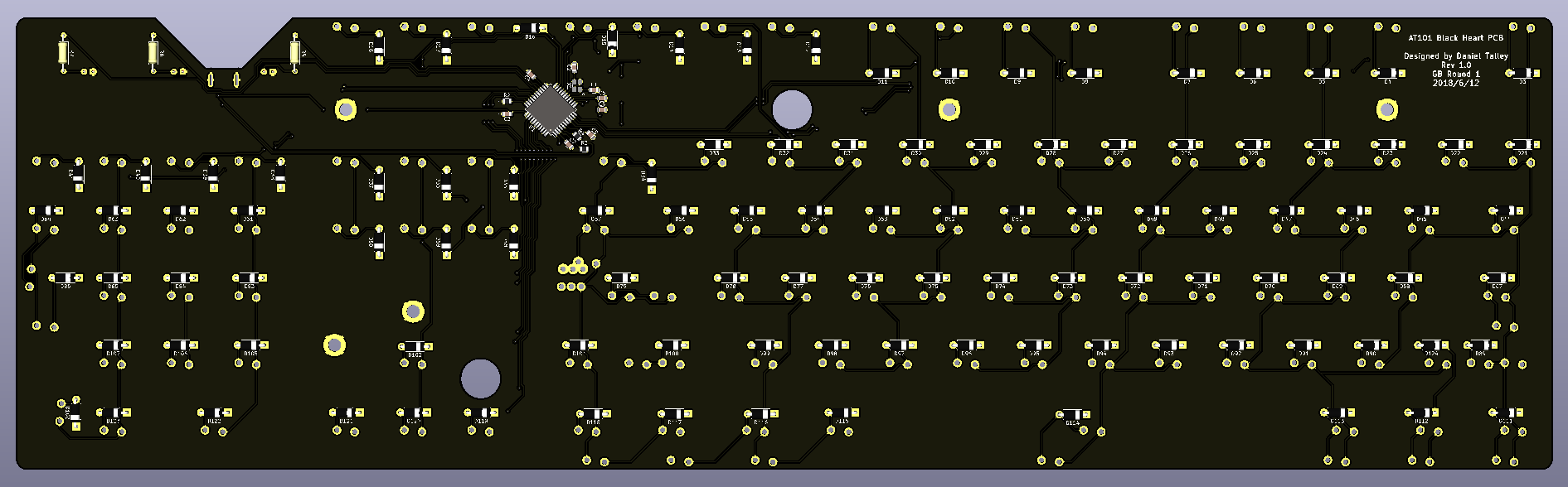

Okay, so I recently started to design a PCB to replace the one in the AT101's after being asked a couple times in my omnikey replacement PCB GB.
My main issue at the moment is how to do the microcontroller, I can either use a Teensy 2.0++ and try and figure out how to fit that in the case as I can't use the Teensy 2.0 without using pin PD6 which has an LED on it and that is known for causing issues, unless if I put scroll lock on there(which I don't know if that will be trouble free as it just needs to supply current to the scroll lock LED). These two solutions have an issue with how much space is available in the case and due to the plate, and I am not sure if the 2.0 can fit, let alone the 2.0++.
I can integrate the mc onto the PCB and have it assembled like that but the price goes up quite a bit compared to a separate mc. But total cost should go down from what I can see by maybe $5 per PCB, not including the shipping of the teensy. The downside is programming isn't nearly as easy as a teensy is, but I will leave that up to everyone.
Board will support the similar to my omnikey PCB, but will include support for different bottom rows:
Top:
Bottom:
Tentative Pricing:(not including final shipping: $10 - $15 in US, more for international)
  • 10 - $65
    15 - $55
    20 - $50
    30 - $45
    40 - $40
PCB's will be black with ENIG(Gold) plating and white silkscreen.
Form:
https://goo.gl/forms/N0euoAjKdjnDqDcR2
Only other questions I have is do the cases for the AT101, AT101W and SGI granite all have the same mounting? Would a PCB from one fit into the other two? Or is there slightly different mounting between them? I only have access to AT101W's at the moment.

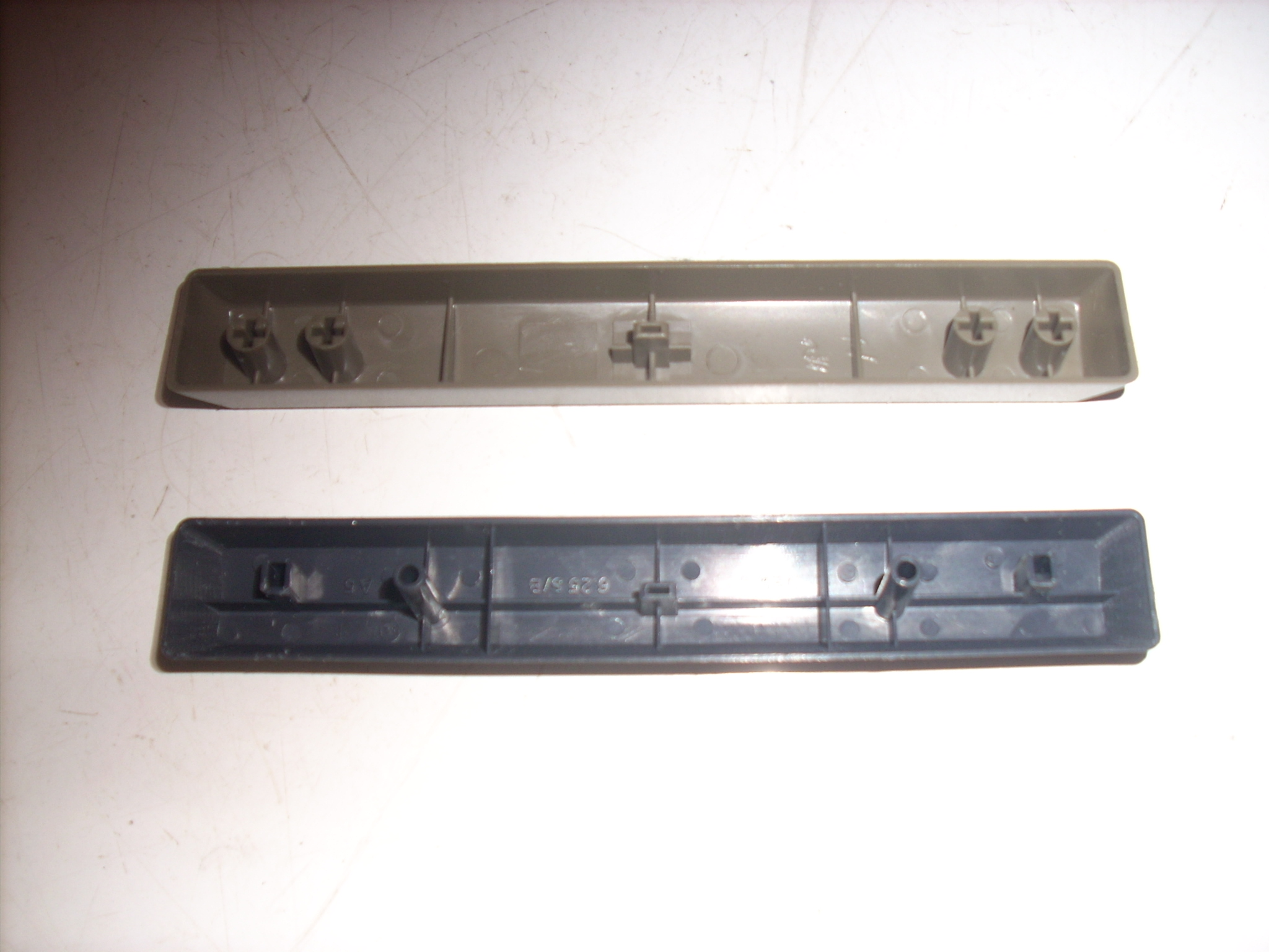

From what I've heard from multiple people, the Tai Hao set does not fit on an AT101W, I think it has to do with spacing.
codemonkeymike
30 May 2018, 22:40
My last comment didn't make sense, I have a set of Tai Hao keycaps. Let me take a picture of the spacebar when I get home.
Polecat
31 May 2018, 05:30
Blaise170 wrote: From what I've heard from multiple people, the Tai Hao set does not fit on an AT101W, I think it has to do with spacing.
Tai Hao (Dolch) spacebar top, AT101W (black) bottom.
Caps lock on Tai Hao has the stem centered; on AT101W it's off-center and the cap is stepped. Won't help to offset the pads on the PC board unless you make a custom plate to match.
Not sure it's a safe assumption that all AT101Ws are the same; I only have the one which is a cap donor. Like new, but the black Alps switches are so bad they practically squeak.
BlindAssassin111
31 May 2018, 06:28
Ahh so they do use cherry stab mounts. Can you tell if the center stem is on the same plane as the stab mounts? Or if the switch stem is recessed by about 0.8mm? I designed stab inserts for the nexus slider GB that will solve this issue, but need to know this info to make sure they don't sit too low.

01 Jun 2018, 05:39
Not sure you should trust any of my measurements. ;) The center stem is shorter than the stab mounts by *approximately* 1/32 inch. I don't have a more precise way to measure it, but definitely not on the same plane.
BlindAssassin111
01 Jun 2018, 07:05
lol, well I know that from measuring all of my alps spacebars that that is the case. And 1/32" is 0.794mm so basically 0.8mm, which is what I was getting. So it is indeed the same. The make them as alps specified even though they use different stab mounts, I can quickly modify my inserts for the to work on these type of caps, and if people want them along with the board then they can order for cheap.

Polecat
02 Jun 2018, 06:46
I'm not sure how the Cherry stabs work, but as with the caps lock the plate would have to match the spacebar for the stabilizer to work.
A few months back I got creative (or desperate) and made a Tai Hao spacebar work on a Focus FK-2001 by carefully rebending the stabilizer wire from another board to fit the bar, and using the cross-type inserts from a different set of caps (don't remember which...but I think I posted it here at the time). With no posts the spacebar wanted to wobble, but the custom bent wire prevented that with the bar in the released position. Not suite as stable as the original Focus one with the posts, but fully functional and you'd never notice the difference when typing unless you were looking for it.
edit: found the old post...the inserts I used were from a Monterey K104 Enter key.
post387690.html?hilit=fk%202001%20dolch#p387690
BlindAssassin111
02 Jun 2018, 18:09
Polecat wrote: I'm not sure how the Cherry stabs work, but as with the caps lock the plate would have to match the spacebar for the stabilizer to work.
My inserts are designed to use the alps wire and just fit into the cherry style cap. Nothing special needs to be done to use them, just put in cap and mount on wire like any alps cap, and they work.
Polecat
02 Jun 2018, 18:45
Does that keep the spacebar from wobbling? That was the problem I had with the Tai Hao spacebar on the Focus since it was missing the two posts.
BlindAssassin111
02 Jun 2018, 19:27
I had no issue with wobble. I had an AEKII that had no issue with the stock cap and no post even.
The thing that really affects wobble is the insert, as the insert stops to cap from rotating past a certain point by hitting the wire. If the insert has a wire slot that is too long, the wire won't help keep the spacebar still, I designed my inserts after my Omnikey, AT101W, and AEKII. By doing that I was able to make the slots the correct length for the most common spacebar sizes 6.25, 6.5 and 7, and have the correct slot size to hold the wire when the switch is at resting height.
Polecat
02 Jun 2018, 20:04
Nice, exactly the same idea as what I did on the Focus, but I did it by using Monterey inserts and custom bending the wire to match at resting height.
