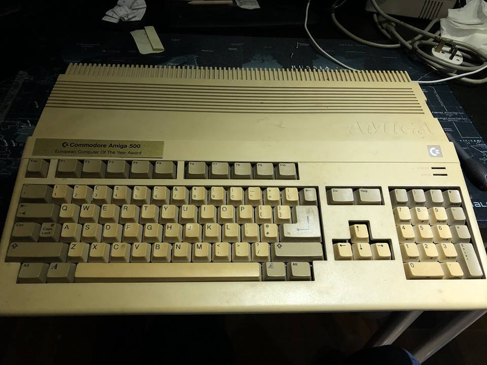

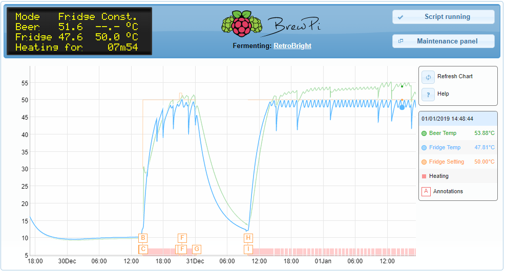

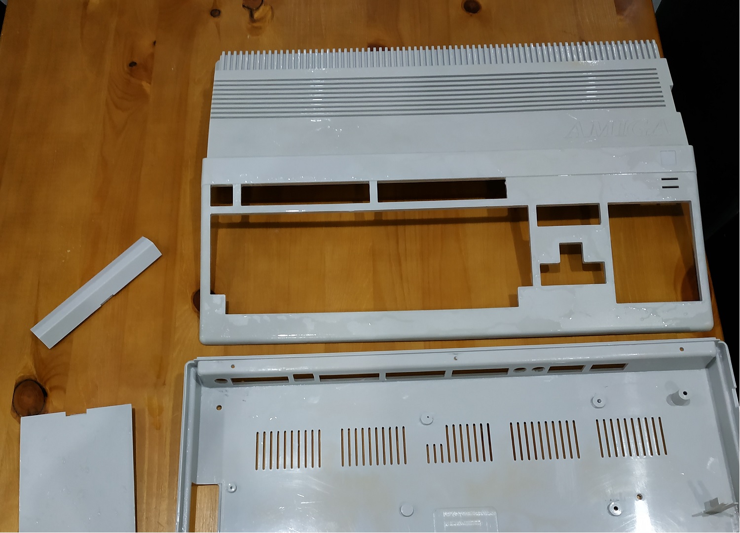

Just to add some feedback about larger items such as computer cases. I have a brewpi setup https://www.brewpi.com/fridge-hacking-guide/
and used it to restore an amiga 500 case.
Amiga 500 p1.jpg (81.21 KiB) Viewed 118865 times
Hope this helps anyone with larger items.
