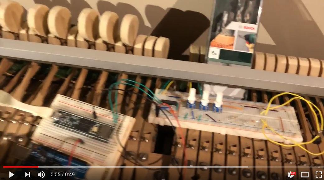

EDIT- Photo attached with one optical sensor on the right side of the picture key hanging by 4 yellow wires...

In the photo above, the optical sensor is dangling from the yellow wires (it is cut off but if you click the photo you can see it). There should be say a good white surface on the key on the final version to optimise performance of the sensor.
In the photo, you also see three pots on the breadboard; those are for CyberGene's manual calibration. For 88 keys that gets expensive and unwieldy to build. Also difficult to calibrate and recalibrate hundreds of pots manually. So a software solution would be much easier.

One of the most important parts of my project is that I don't rely on ADC because it is slow, even though the ADC on the Teensy board is pretty fast. I mean it is fast by itself but I need to be able to measure 88 keys and, as you will see further, I also need to measure three separate distance points per key and all that makes it unacceptable for real time piano playing. The sensors I use are CNY70 which is basically a LED and phototransistor. The latter changes its collector-emitter current based on proximity of objects. Basically it is an analog output sensors. I need to have three separate distance points measured by the sensors: strike point (I don't have strings, just a rail which hammers hist) which is the closest distance to the sensor. Another one which is close to the strike point (it's a point after escapement, which in piano mechanics means the point where the hammer detaches from the key mechanism and moves by the momentum). I need to measure the time hammer travels between these two points to calculate its velocity. The third distance is used to determine whether the key is still being held (hammer is raised which on the piano keeps the string vibrating freely; when released the dampers will stop it). So, since I can't used ADC, I need to somehow translate the analog output of the sensor into three binary signals corresponding to each distance. They are "high" at rest and become "low" when the hammer is at a closer distance that the corresponding distance-point (e.g. when the hammer is at the strike point all three binary outputs will be "low").
So, how to do that? Here comes the great suggestion by the other PW member who recommended using a LM339N comparator. Each comparator has 4 pairs of voltage inputs and 4 binary outputs. On each pair you provide a reference voltage and the voltage from the CNY70. If the voltage becomes higher than the reference, then the output changes. And so the output of each CNY 70 is fed to three comparator inputs, there are also three trimpots providing three reference voltages. The big advantage is the comparator is extremely fast! The disadvantage is I need many comparators and so many trimpots... But at lease I solve the problem of speed.
Now, in order to read all the keys, I've grouped the keys into 18 groups of 5 keys each (the last group is of 3 keys, not 5). Each group produces 5 * 3 = 15 binary values that I feed into Teensy digital inputs. In order to select groups, I use octal-bus transceivers SN74LVC245AN (those are chips with 8 inputs, 8 outputs, a direction pin and an on/off pin). Basically a transceiver will repeat the inputs to the outputs in the selected direction (input to the output in my case) and what's important here is that by using the on/off pin I can select which transceivers are active at that moment. Furthermore, the switching is also extremely fast! So, for each group of 5 keys (15 binary values) I use two transceivers (16 inputs, 1 unused). In each scanning pass I have only two transceivers active.
So, I use 18 digital outputs from Teensy to select a pair of transceivers at a time, and I read 15 inputs from the selected pair. That's 33 digital pins of Teensy used. It has 52. I will use some of them to read the triple pedal in a similar fashion.

what is he calibrating with the pots?? that would be helpful to know to help him find a software solution.In the photo, you also see three pots on the breadboard; those are for CyberGene's manual calibration. For 88 keys that gets expensive and unwieldy to build. Also difficult to calibrate and recalibrate hundreds of pots manually. So a software solution would be much easier.

There's no velocity data. Velocity is calculated.
There is poor man's 2-bit ADC made from 3 comparators on every key. No velocity, only key positions. Positions are "key in flight", "key hit the string" and "key is resting on the sustain bar". Lack of signals means "key is released".
Then there is an 18-input MUX which reads outputs of those ADCs, 5 at a time.
What is the clock frequency of the MUX? How often "key in flight" and "key hit the string" events are detected in a single measuring pass?
Simpler question is "how fast is the fastest keystroke?"
What is the shortest time between "key left escapement" and "key hit the string"?

Anyway, here's some answers. The hammer velocity should be measured at string strike point, i.e. a terminal velocity. Since I have decided on optical sensors and not pressure/strain sensors, I have to measure time between two points instead. Due to piano specifics, the only reliable velocity should be measured after escapement point. The hammer usually has about 1mm travel after that point until it hits the string. In my measurements that equates to a duration close to 1ms, maybe a bit less, maybe more... But approximately a velocity of 1m/s. I've read somewhere that velocities up to 2-3m/s can be reached by a piano hammer, depends on how heavy someone bangs, I didn't thrash my action a lot. Furthermore, the 1mm is just a reference point but I haven't regulated the action yet, so it's only visually, might be 0.5mm, might be 1.5mm.
Anyway, the three points I measure are:
1. Key is being depressed at least to some degree (I don't use that for any calculation, only to know when to send key off. On a real piano there are string dampers which are lifted when the key is being pressed halfway, allowing the string to vibrate freely. If you keep the key pressed beyond that point, the string will vibrate until released. Once released I will send key-off). Which is why I need that point. The proper way is to measure the key. I am actually measuring that point at the hammer instead but it doesn't matter since the hammer angle will follow the key press depth in exact fashion for at least half of the way, i.e. until that damper release point. Just for information, after the hammer rebounds from the string, it will hit a spring loaded escapement lever, so the hammer will drop and thus won't follow the key angle but it's still enough and above the damper release point I am interested in, so I am OK. Kawai also do that. Yamaha measure keys separately to know key on/off but I think that's rather overkill.
2. Hammer reached escapement point. I start measuring at that point.
3. Hammer hit the string (in my case the stop rail)
As I said, velocity needs to be measured between 2 and 3. I can't afford measuring below escapement because just for example one can press the key very slowly until it just reaches the escapement point and then very forcefully press the key and be able to throw the hammer. If I started measuring before that, that would have screwed my measurements since a lot of time would have elapsed while the hammer was just being held jut before escapement.

Let me first start by saying that I am first of all a high-level programmer by profession, I mostly write in Java which isn't helping me a lot besides the basic coding skills
That all is the reason why I am still deciding how to finish the project because I am not very confident at that stuff.
Now, you offer various other solutions and I am totally open to any of them. As I said, I am a total newbie in electronics and controllers, etc. so any help would be appreciated
Why I need the trimpots. Because I need to set those three points. Since those are optical sensors that just hanging above a wooden surface of the hammer, this is very unpredictable in terms of precision. Also, the piano regulation although a fine work isn't an exact science so hammer blow/strike distances can vary. I will use software calibration, but I also need the trimpots to calibrate my poor-man ADC-s. If I use fast ADC instead, then I can rely only on software calibration.
I haven't even ordered the transceivers nor measured any sequential reading to be able to know how fast I can scan. I've only tested POC of a single key
BTW, I have a 10-month daughter so the spare time I have for the project is almost close to zero. But I am in no hurry either.
So any help is appreciated, I'll try to answer when/if I can
Cheers!
(Sorry for my English which isn't probably very good)
P.S. Edited my wording a little

So, since I don't see any further replies. Let's assume the highest possible terminal velocity is 2m/s. Escapement to string distance is 1mm. That equates to shortest duration of 0.5ms. In order to detect something like that I should scan at least twice as fast, meaning 4000 times a second. Multiply that by 88 keys so it's 352ksps. Meaning even a poor Arduino can do the task. Am I right? If so, no need for my complicated schematic with so many trimpots, comparators and transceivers.
If all that's true, then the problem I need to solve is how I can feed 88 analog inputs into a limited number of analog pins on my Teensy or Arduino? Maybe I can use that MUX thing (I need to read more about that) but isn't that supposed to work only for digital signal and not analog ones?

Don't think arduino is up to the task - kinetis ADC is shitty. Also you're applying Kotelnikov's theorem wrong - you'll be able to detect max. speed, but you won't be able to discern it from lower speeds. So you'll need oversampling.
Problem of feeding 91 inputs is not actually a problem - just have 3 PSoCs. Forget about arduino and teensy - their ADCs are shitty, there's too little analog inputs. If you're sticking to arduino - your solution is probably optimal. A bit expensive - but for a single device cost doesn't matter much.

just a few brief ideas:
- you could go acoustic and put a tiny microphone capsule to be hit by the hammer; potentially behind some individual damping or blocking to prevent capsule damage; and measure hammer speed indirectly from the loudness of the sound/vibration it generates - just like it happens in the real piano
- serial midi (5-pin DIN connector) has a baud rate of 31250, uses 8 bit bytes, I guess 1 start bit and 1 stop bit, so max byte rate is 3125 Hz, one note down message requires 3 bytes (release 2 bytes - average 5 bytes), so that gives you a 625 Hz aggregate note rate. USB 2.0 MIDI will have an 1 kHz frame rate (or theoretically 8 kHz if using USB 2.0 Hi-Speed), however look at the USB MIDI specification to see whether they allow more than one byte per USB frame per MIDI channel - if they do, then you can win some latency here. if not, you can still go multi-MIDI-channel to send notes in parallel. PITA in MIDI organ keyboards where - due to organs being often played in multiple layered voices (registers) - they would have to send several notes per keypress. for even lower latency you could do an Ethernet-based MIDI implementation
- 180 BPM music (not usually played on a piano as it is very fast) is 3 Hz when playing quarter notes, sixteenth (1/16) notes are 12 Hz, (1/32) notes are 24 Hz - but you probably cannot hit keys that fast; the Guiness world record in 2012 was 765 notes per minute which is 12,75 Hz. assuming you have 10 fingers, and hit a separate key with each of them, and repeat that with 12,75 Hz that is a note rate of 127,5 Hz. (it is left as an exercise to the interested reader to ponder what happens when one hits multiple keys with each finger - for a realistic estimate do consider hand size/reach though) finally, you should also consider the case of 4 handed play.
- more on the topic from the very informative Colin Pykett
- if you consider aftertouch - which you should since you have a felt pad under the keys allowing the keys to move slightly in response to varying pressure, and a separate sensor for the position of each key - then that quickly explodes the number of potential MIDI messages sent per second, so you probably will need Ethernet MIDI in that case.
- since you have a position sensor on each key, you should also do key position detection and reporting, for those synthesizers which do take into account the position of the key/dampener; it also enables lovely proportional action organ playingfor upcoming organ synthesizers (most modern - wired/electric action - pipe organs cannot do this and lack this subtlety in their play; only a few can); apologies, I do not know the MIDI details for this - maybe there are none yet, in which case feel free to invent your own, working together with the synthesizer developers
- some midrange microcontrollers offer 10 million 12 bit samples per second, with 50 input channels; for a full 88-key keyboard you could reach about 113 kHz sampling rate _per key_, if you have three sensors per key, you could have a 37 kHz sampling rate _per sensor_ (and maybe you only need two since now you have quite precise position sensing); very conservatively let's halve that (to allow timing for multiplexing, etc.) to reach 18 kHz sampling rate _per sensor_. with your half millisecond hammer travel time that is a minimum of 9-10 samples per hammer travel, and each one of those samples is a 12 bit position value, to which you could fit a linear regression to get a quite precise velocity value (way better than the 7 bit/128 velocity values traditional MIDI allows - luckily recently there is a MIDI extension to 14 bits for velocity values so you won't lose date); and that is only for the fastest/loudest notes - softer notes will have many more samples, offering even more precision.
- do consider that your hammers, after (and probably even before) hitting the target, will do non-trivial mechanical things (compress, bounce back, oscillate sideways, etc.) so prepare for a thorough analysis and modelling of hammer-sensor system behaviour (and multiple redesigns of your sensor arrangement); I recommed max speed sampling of single hammers during development; remember, you have 10 million samples per second; that will allow you to learn a very great deal about the dynamic behaviour of your system, and to develop a pretty accurate model. since your mechanical system is not rigid, and will very slightly change after playing every note, you most certainly will want to prepare for various auto-calibration scenarios.
- you will also want to allow for the player (or the tuner) to calibrate the keys, e.g. in terms of evening out the force/velocity response across the keyboard, etc. interactively (that is, by hitting keys)
- adding configuration possibilities for velocity curves, aftertouch behaviour, etc. are left as an exercise for the software developer
- do consider adding proportional sensing for all three pedals as well (if your mechanism includes pedals)

I just saw there are videos. My further recommendations:
- measure velocity at the original position: the hammer
- ditch the rail (unless it is part of the original mechanism)
- mount a strip of (IR) transparent plastic or glass above the hammers where the strings would be hit; thick enough to get its lower surface (on which the hammers will hit) to your sensor optimal (= highest signal) distance (which is often not zero distance); rigid enough that it does not get bent by the hammers hitting on it from below
- mount the optical sensors on top of that strip, looking down onto the hammer tops
- the sensors will see the approaching hammer tops and continuously measure the distance as they approach and bounce back
- you only need one or at most two sensors per note (resulting higher sampling rate from my example above): one for the hammer, another for the key position; alternatively, depending on the hammer travel and your sensor range, you could be fine with just one sensor, if it sees "deep enough" to the bottom position of the hammer; you might consider a sensor that "sees farther" than your current 5 mm one; measure, calculate, think, ask
