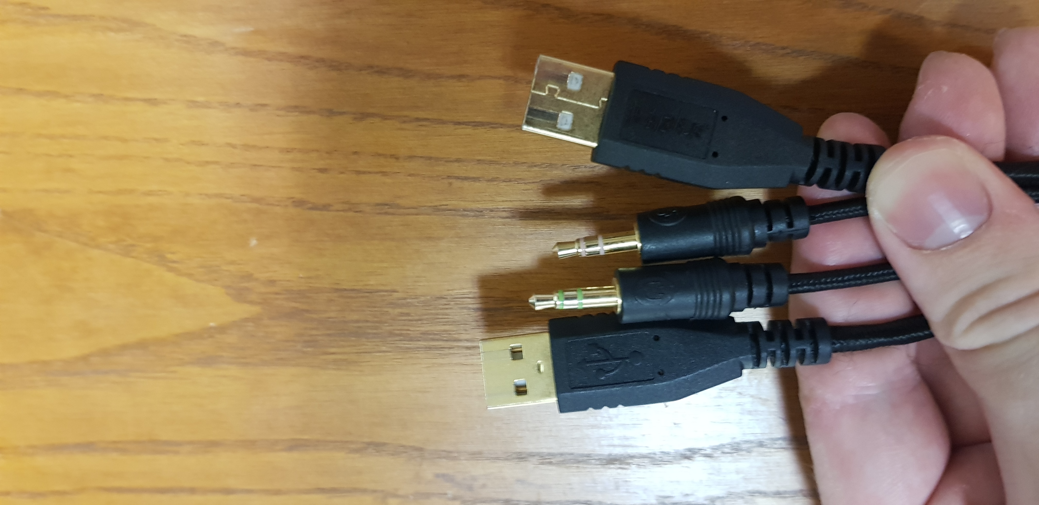

The other customization I want to add is replacing the braided hard wired USBs with a removable USB C connector.
Essentially the idea is to maintain the Razer Synapse support for lighting control, and to create a more portable keyboard that could still function as a full size keyboard if need be. The other side of this project is to do some customizations to the case to both support the modular function and a RGB underglow.

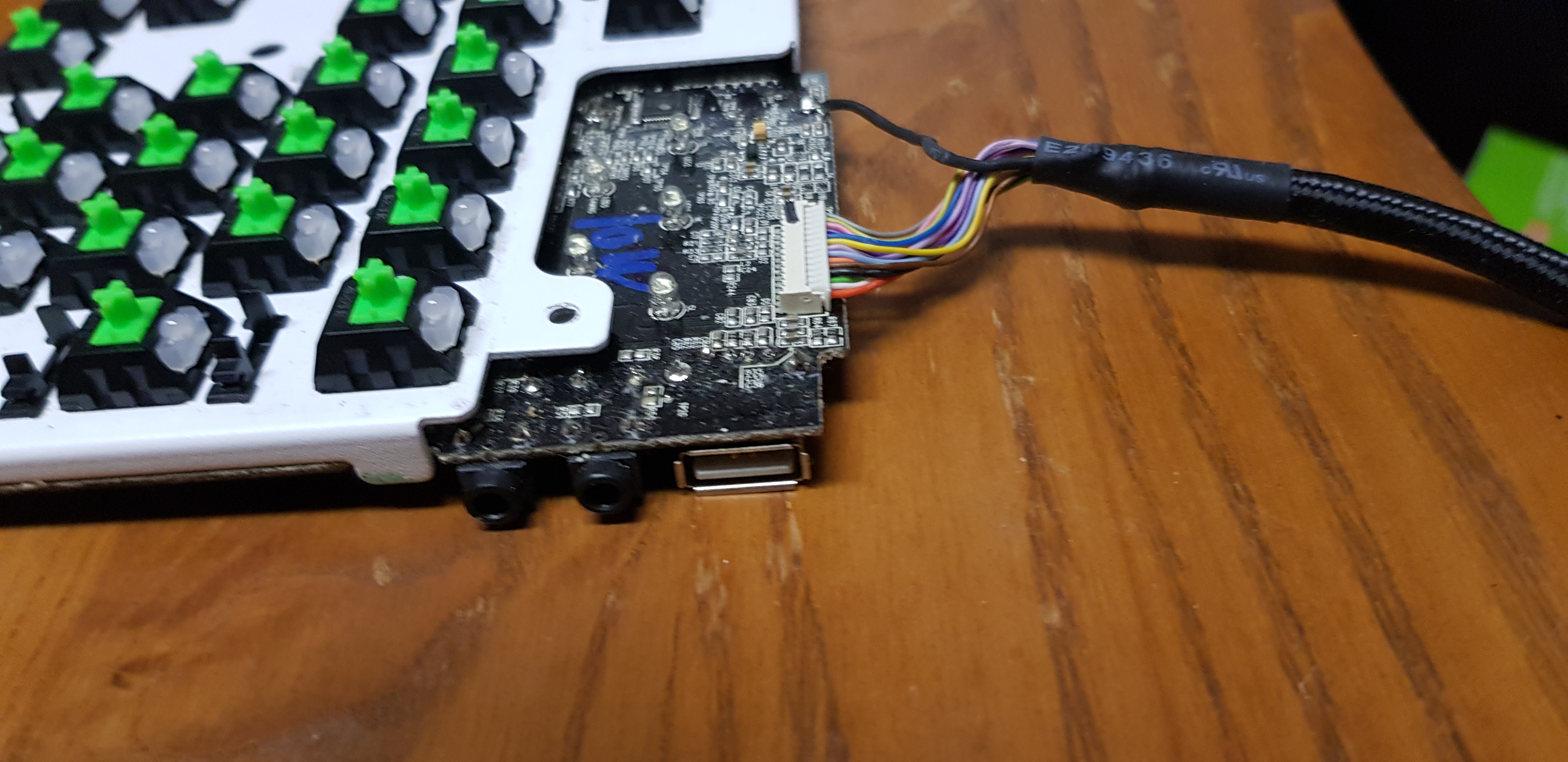

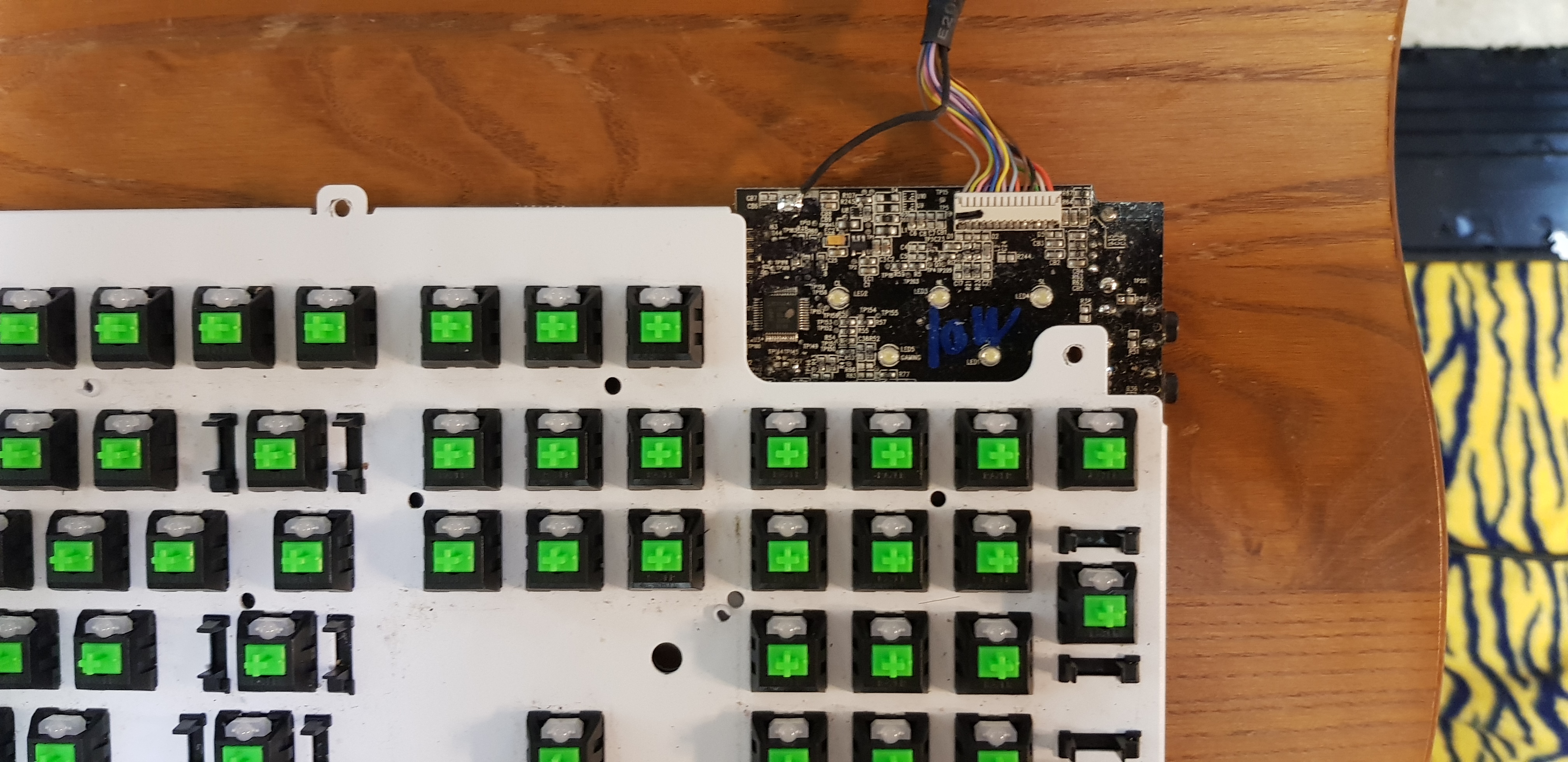

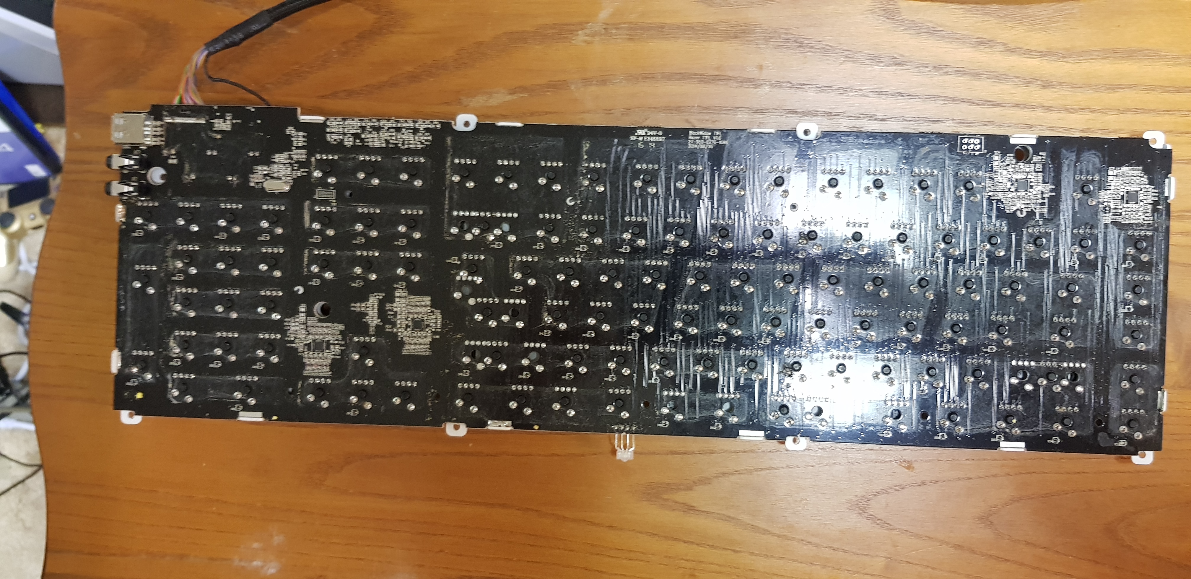

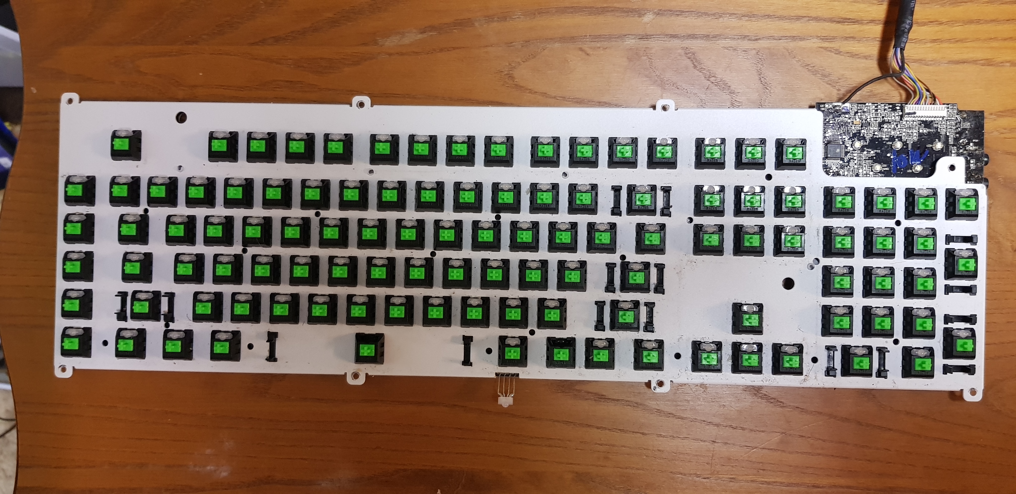

So a couple things I noticed that could complicate this process, and the reason I'm coming here for assistance, is mainly the layout of the PCB. Attached are a few pictures of the PCB.
The first problem is the white metal shield, I think this is soldered on in some spots but I can't actually tell. I know there are plastic mounts that clip to the metal shield from the PCB, but the shield doesn't budge and these plastic mounts wouldn't be holding the shield in place as much as it is.
The second problem is where the cable comes in/out of the PCB. It's at the top right corner, right above the number pad. This means in order to properly cut down the size to a ten keyless, then add modularity as a feature to the keyboard, I would need to take this one PCB and split it into three, there would be one with the LEDs, audio & USB pass through, and cable connector (that will become a USB C port instead of hard wired), one for the main keyboard, and one for the number pad.

- picture of the connectors
- 20180709_033332.jpg (1.88 MiB) Viewed 4421 times
- picture of the bottom of the PCB
- 20180709_032839.jpg (2.7 MiB) Viewed 4421 times

- picture up close of the top right of the PCB
- 20180709_032749.jpg (2.3 MiB) Viewed 4421 times
- picture of the top of the keyboard PCB with the white aluminium shield
- 20180709_032738.jpg (2.53 MiB) Viewed 4421 times

Your plan is a bold one.
I see several problems that may be show stoppers.
As you say, the cable goes in by the numberpad and the controller chip is also on the PCB in this area.
The white "shield" as you call it is the plate. The plate holds the switches so that is needed you would also have to cut that.
The only way your going to do this is to replace the whole PCB and program your own controller for the keyboard and for the RGB, same for the number pad.
If you have a modern motherboard that has RGB control you could use that to control and power the LEDs so that is not a problem.
As for snapping on the numberpad you could do this in two ways.
You could have some external contacts on the side of the case that wire intro the controller of the main section and have some sort of logic that detects that its been connected but this would require allot of custom controller programming. Or more simply you could have a USB hub inside the keyboard and have the pins on the side just be USB and have a second controller for the number pad( thats how i would do it)
As for the case you could hold the number pad on with strong magnets i think that's best.
