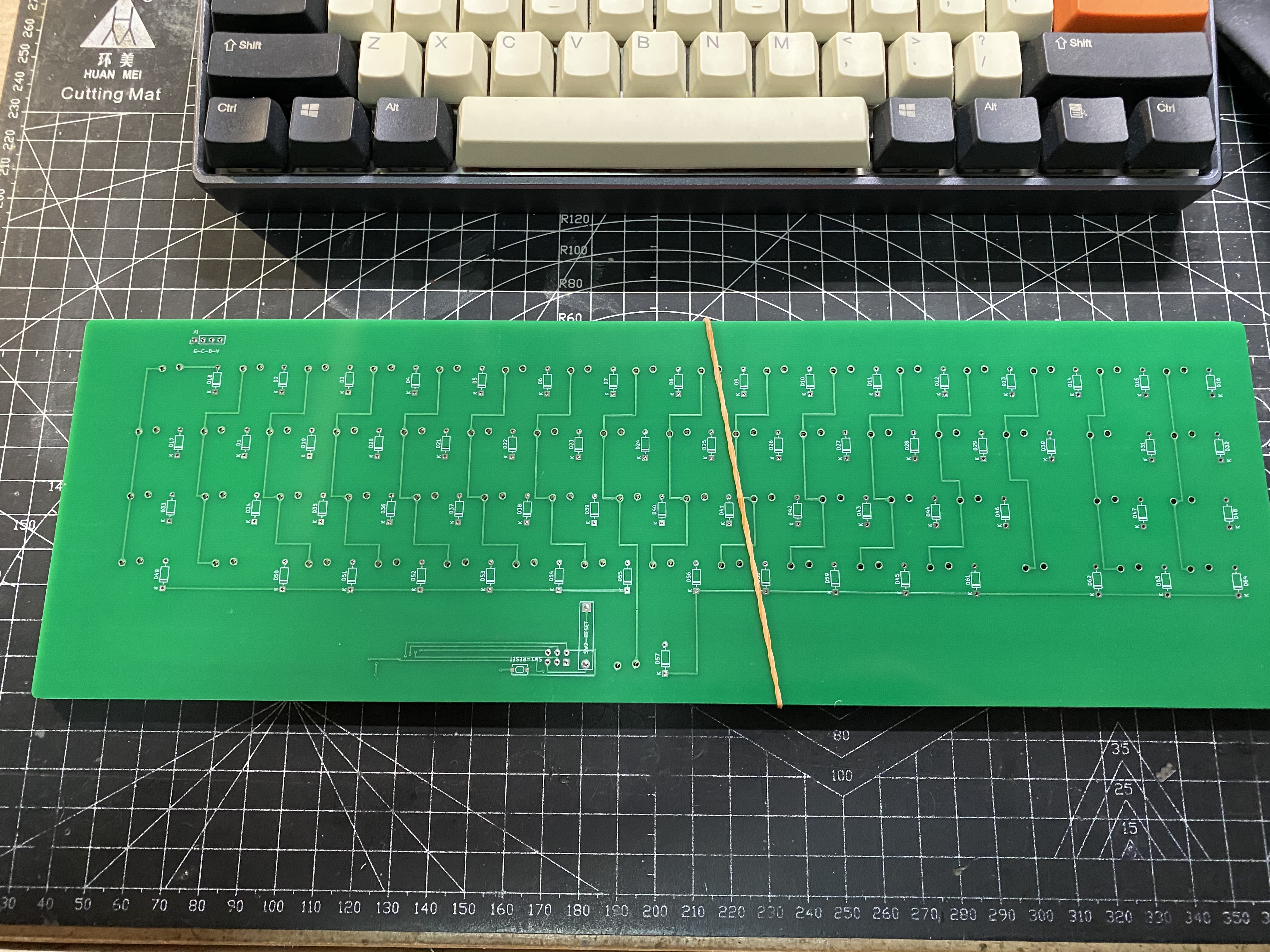

anthonymak
09 Apr 2021, 13:38
I mod this keyboard with a custom pcb and is VIA /QMK compatible.
https://youtu.be/dbqh6UQ3lTY
09 Apr 2021, 14:33
You didn't show the good stuff in the video! Let's see the PCB.
anthonymak
09 Apr 2021, 15:05
Muirium wrote: 09 Apr 2021, 14:33 You didn't show the good stuff in the video! Let's see the PCB.
It is a prototype and there are a few amendments on it. but will not make a final one so just leave it as it is as the keyboard is working now.
see the photo of the pcb below.
