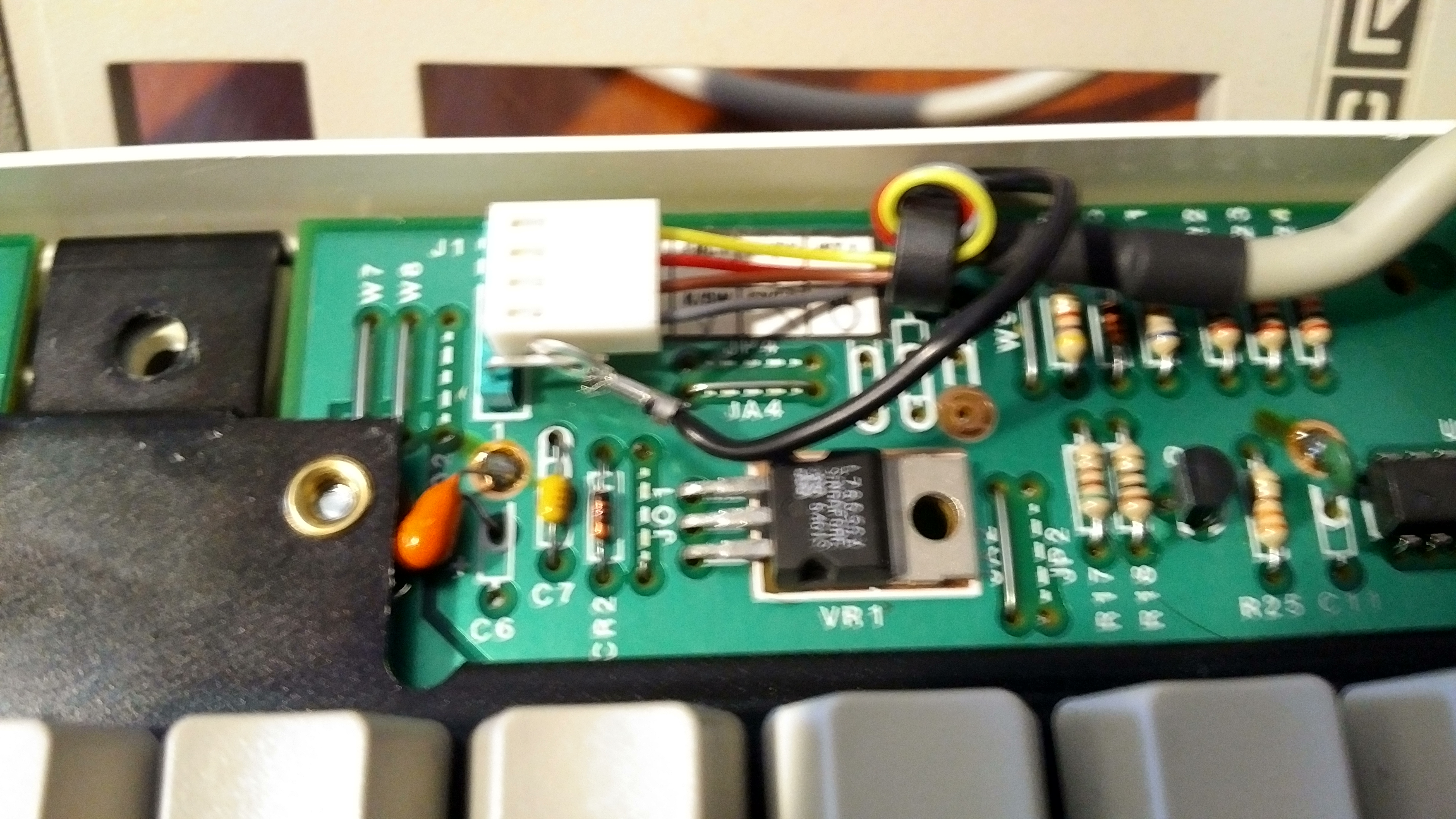

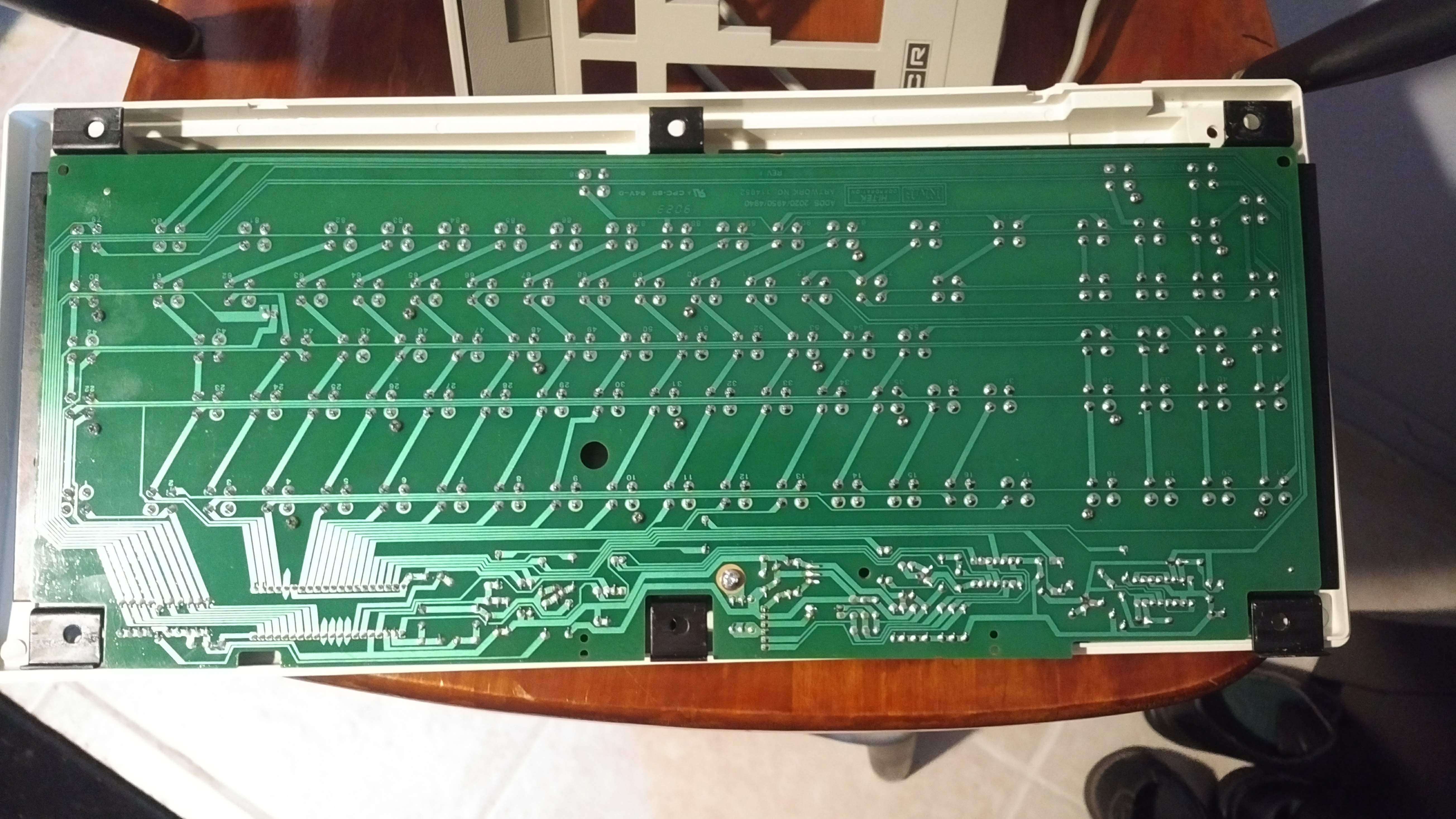

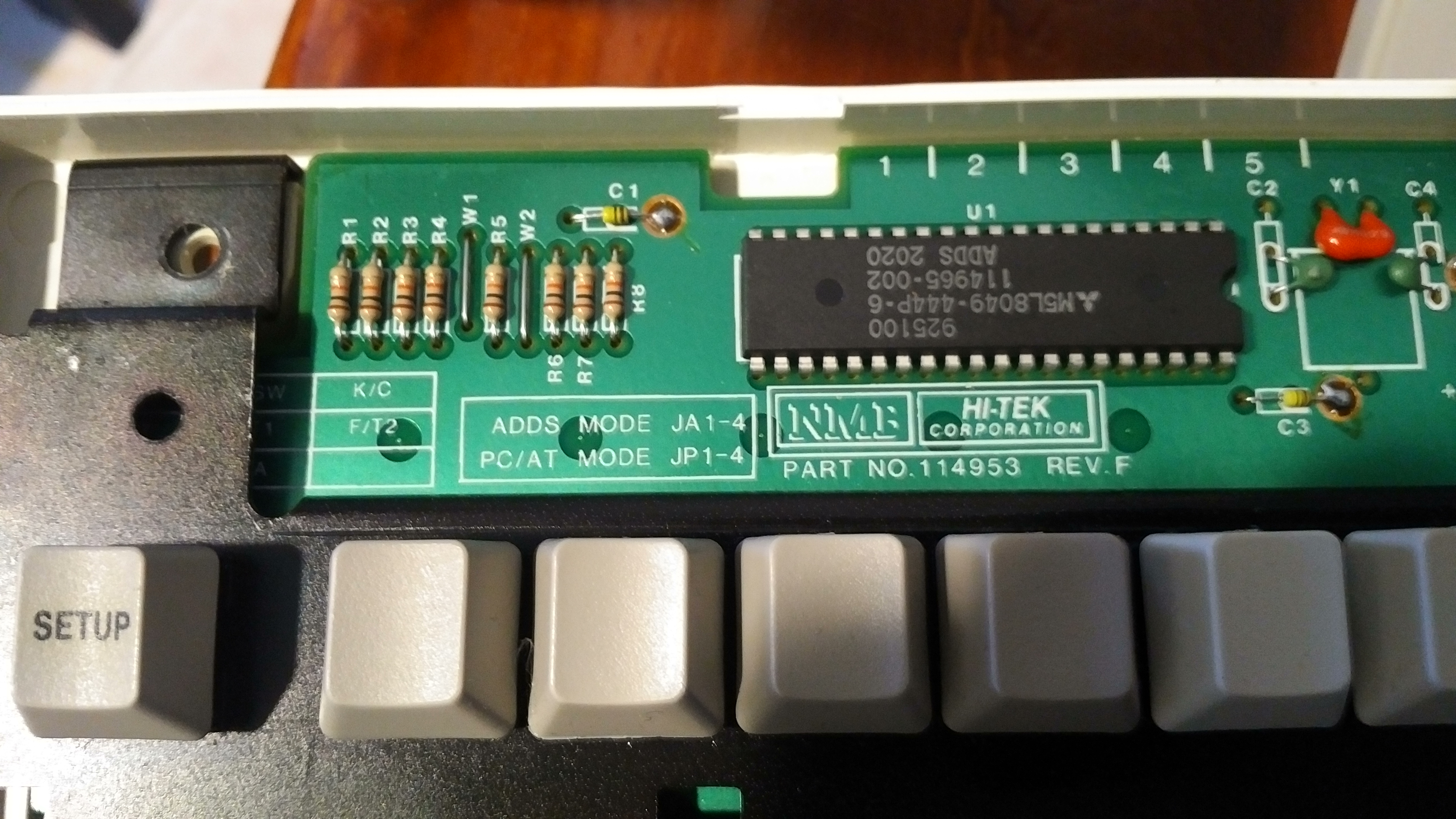

So I took some extra photos. The ps2 cable I wanted to use is from a Dell quietkey. I spoke to a redditor on this and he gave me a pinout. He said he knew how to adapt my particular version and would tell me for a price. Anywho, attached are some photos I took. I have a cu on the ps2 jerry rigged in at some point. Don't want to plug in random configs for fear of frying
- IMG_20180713_1626562.jpg (3.98 MiB) Viewed 11875 times
- IMG_20180713_1626443.jpg (3.95 MiB) Viewed 11875 times

Seeing that voltage regulator makes me think maybe this isn't a 5V board. Do you have a multimeter to test?consideringquiet wrote: So I took some extra photos. The ps2 cable I wanted to use is from a Dell quietkey. I spoke to a redditor on this and he gave me a pinout. He said he knew how to adapt my particular version and would tell me for a price. Anywho, attached are some photos I took. I have a cu on the ps2 jerry rigged in at some point. Don't want to plug in random configs for fear of frying

I'm going to guess that it was built expecting 12V but also may work with 9V. If you share some pictures of the reverse side of the PCB (the one where you can see all the traces), someone should be able to confirm if that guy gave you the right pinout.
The first thing you want to figure out is which line is Gnd and Vcc
Then figure out what voltage it requires. Since you don't have a multimeter, one hint might be whether the lights come on when hooked up to 5V, or whether they stay dark (or some in between dim).
Then we need to figure out which are the signal line(s) (e.g. data/clock or serial)
Finally figure out what protocol it uses.
When you put it all together you get a nice little game plan.

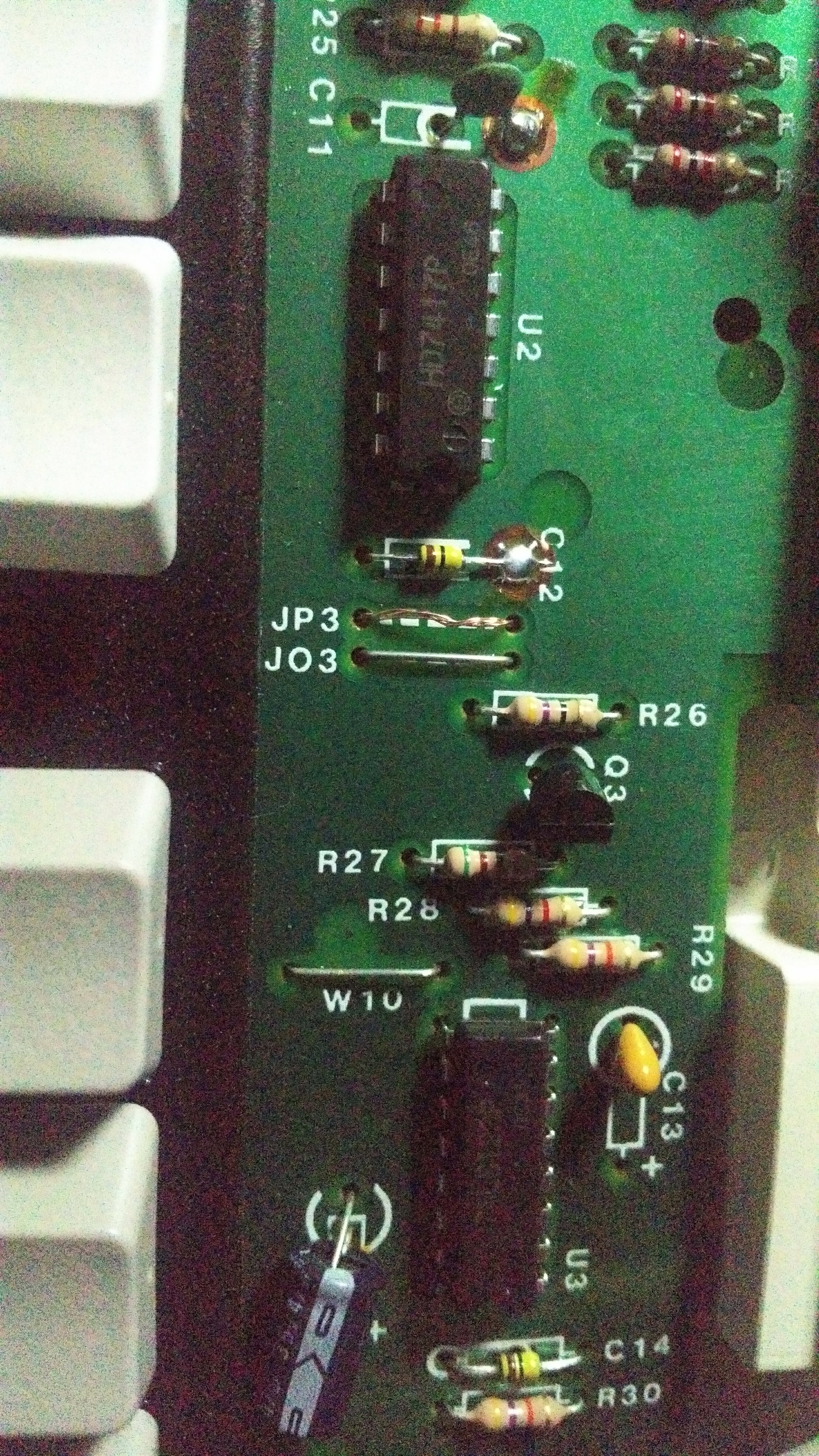

There should also be some parts of that board with some connections that are missing and have the following letter combo:
JUP
This is for the jumpers and I think last time I checked they were on the right side of the board on the front facing up. If you can post a picture of the whole top of the PCB then I can help you out more.
consideringquiet
- Main keyboard: AEK II Mitsumi (rotating)
- Main mouse: G203
- Favorite switch: Orange Alps

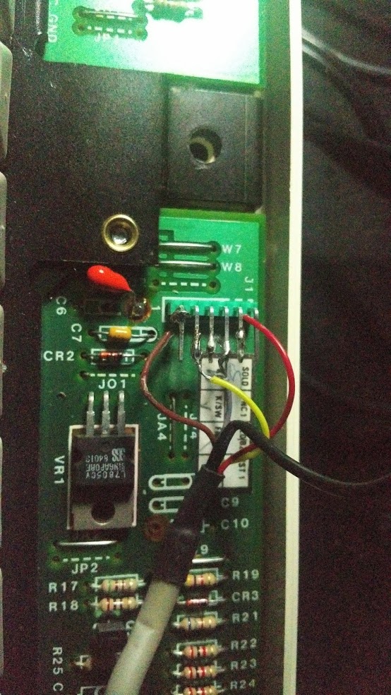

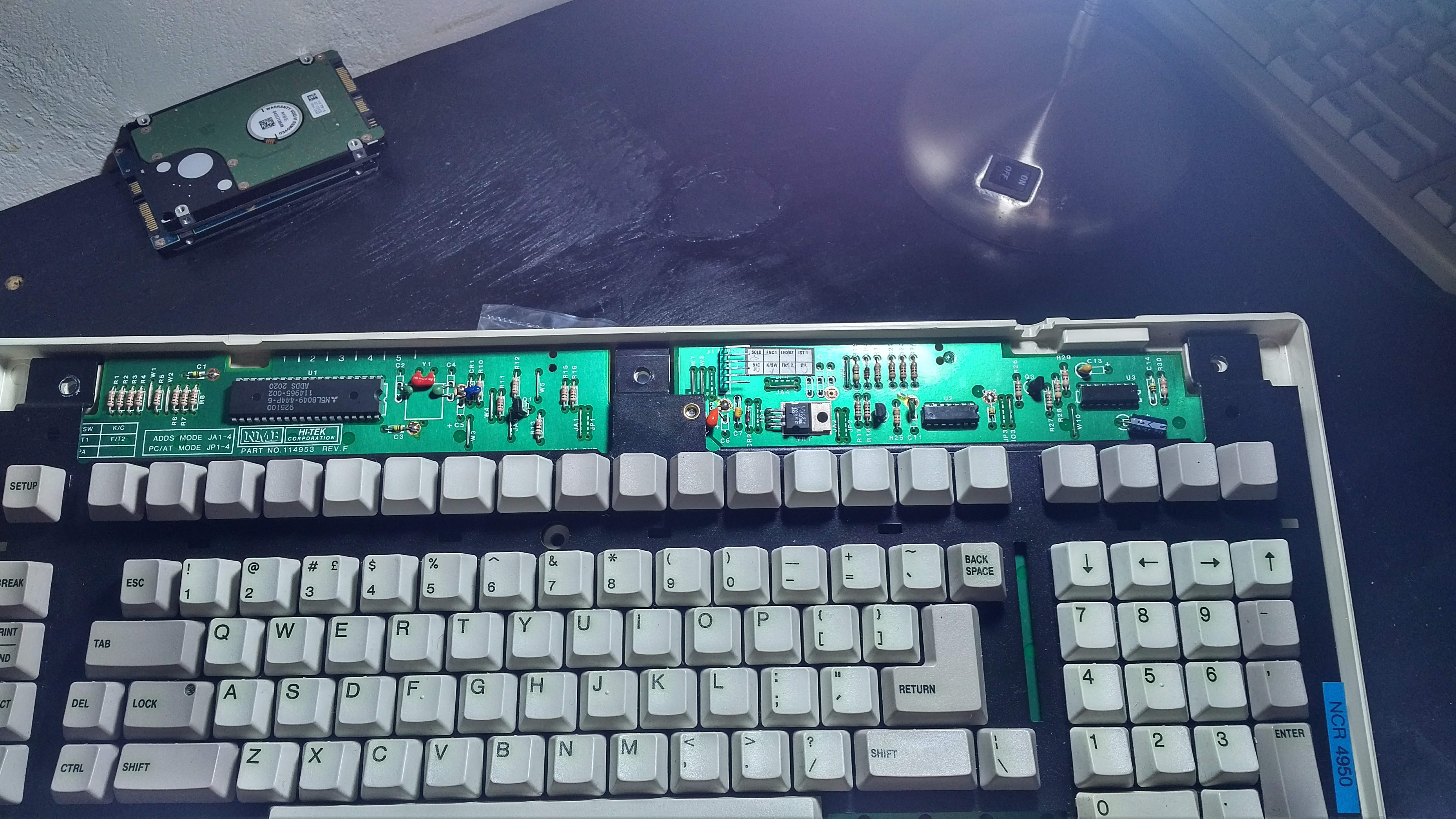

Heres some photos, sorry for iffy camera quality.TheInverseKey wrote:consideringquiet wrote: So I took some extra photos. The ps2 cable I wanted to use is from a Dell quietkey. I spoke to a redditor on this and he gave me a pinout. He said he knew how to adapt my particular version and would tell me for a price. Anywho, attached are some photos I took. I have a cu on the ps2 jerry rigged in at some point. Don't want to plug in random configs for fear of frying
JUP
- IMG_20180713_1858422.jpg (1.31 MiB) Viewed 11812 times
- IMG_20180713_1858125.jpg (855.28 KiB) Viewed 11812 times
- IMG_20180713_1859047.jpg (1.09 MiB) Viewed 11812 times
- IMG_20180713_2048104.jpg (1.39 MiB) Viewed 11812 times

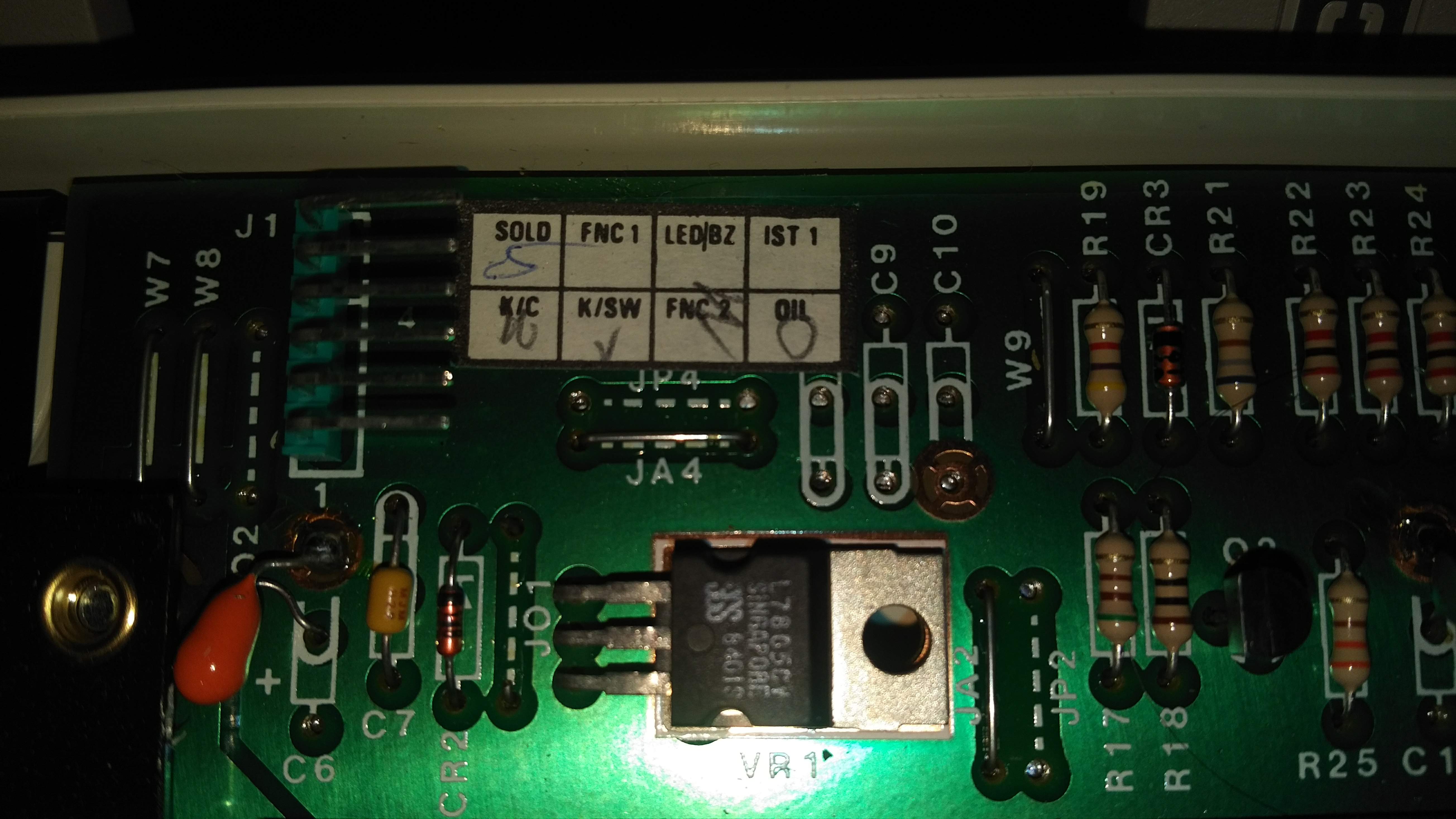

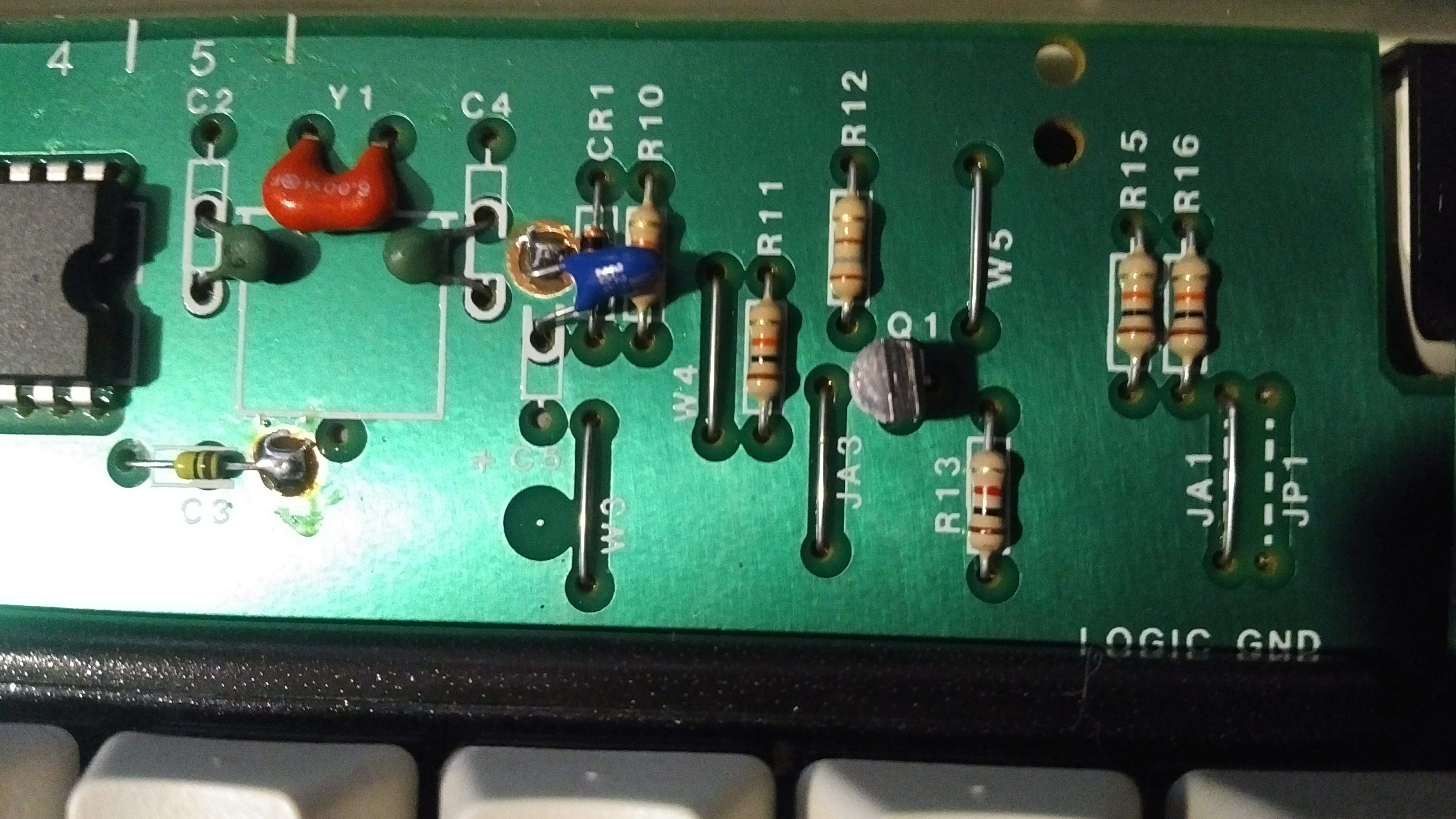

Here is a photo of the jumpers that need to be added so that it can be converted. They are the ones that have been done in copper wire that doesn't have a silver plating on them.

Don't clip the the other jumpers and you should only solder the new ones on.

Oh so just leave the JA jumps? I'll make sure not to. Any tips on getting the wires to stay put while soldering? Just pray?

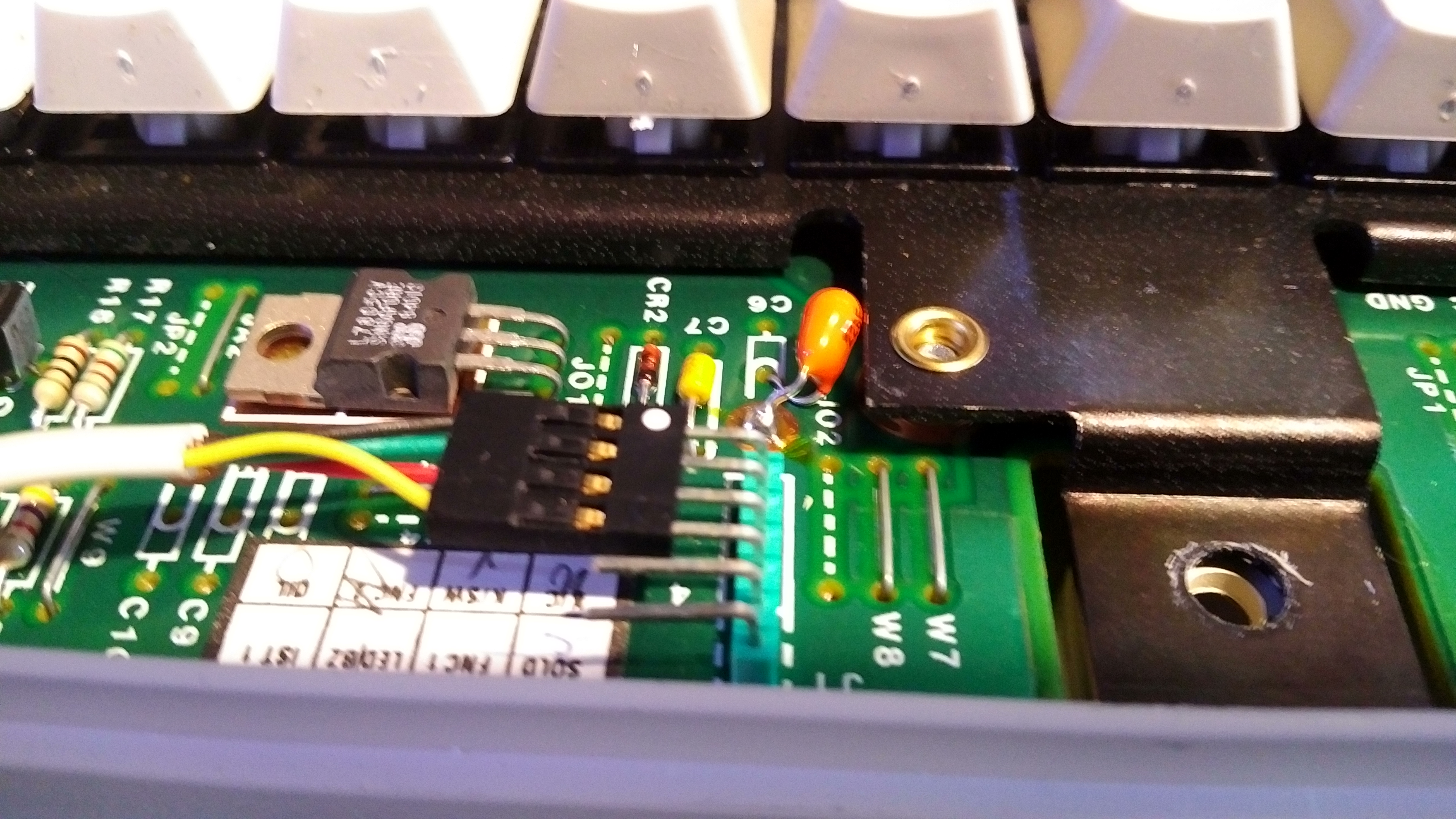

There's a 7805 in the middle of those pics which is going to throw a wrench into easy PS/2 conversion. It's not going to work without at least 7V input, of which PS/2 only provides 5. Unless modifying the jumpers will bypass the voltage regulation section, you won't get any signs of life from the board on PS/2.
consideringquiet
- Main mouse: G203
From my understanding it enables the AT protocol on the board.

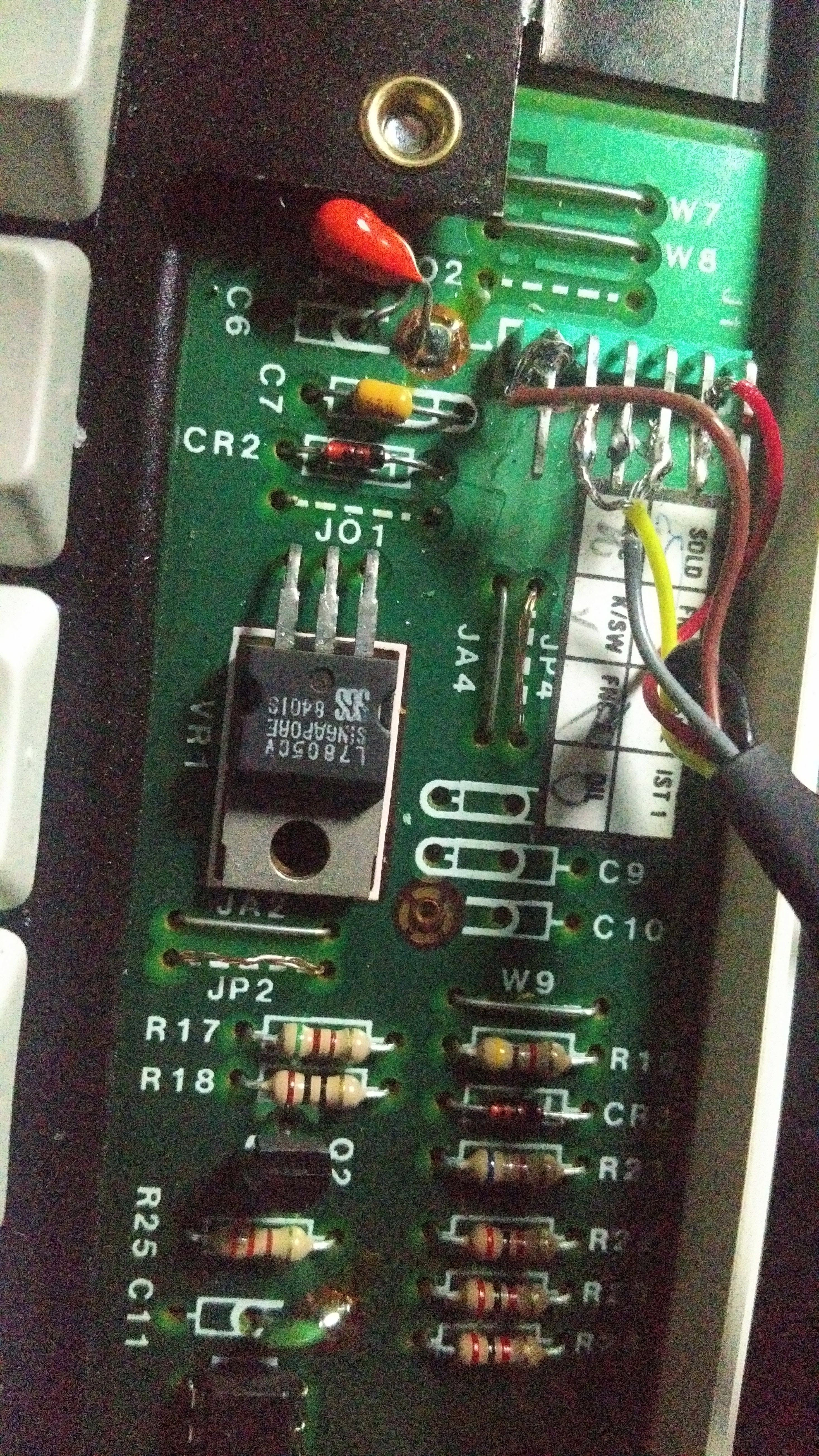

Seems like it. I wired up the board to a PS2 cable, I haven't done the jumpers yet. But whenever I plugged it in to see if I'd get any lights, I got zip. Of course, it could also be my awful solder job but I digress.Compgeke wrote:There's a 7805 in the middle of those pics which is going to throw a wrench into easy PS/2 conversion. It's not going to work without at least 7V input, of which PS/2 only provides 5. Unless modifying the jumpers will bypass the voltage regulation section, you won't get any signs of life from the board on PS/2.
Heres the mess I made:
- I know its awful. But I'm working with a chisel tip and no extra flux. It definitely sucked soldering this small bit together.
- IMG_20180715_1242222.jpg (175.67 KiB) Viewed 11746 times

Quick tip on soldering: the chisel tip is fine (it's what I use), it's more on method. For joining the wires to pins with solder, I'd tin the wire lead, tin the pin lead then heat them together to reflow the joints into one. Same process one would use for something like soldering leads on LEDs.
When tinning the leads, apply heat from the bottom and solder from the top. This helps make sure the solder flows throughout and not just a blob on one side.

So tinning is preapplying solder right? Thanks for the advice though, I'll hopefully remember it next time I need itCompgeke wrote: Quick tip on soldering: the chisel tip is fine (it's what I use), it's more on method. For joining the wires to pins with solder, I'd tin the wire lead, tin the pin lead then heat them together to reflow the joints into one. Same process one would use for something like soldering leads on LEDs.
So I put all the jumpers in, and still, nada. I think I'll definitely have to figure out the power issue.

All soldered in. Now I gotta figure out this power issue. The guy I spoke to over reddit didn't mention this to adapt but I'll try to contact him again.
- IMG_20180715_1317381.jpg (5 MiB) Viewed 11724 times
- IMG_20180715_1317348.jpg (5.42 MiB) Viewed 11724 times
