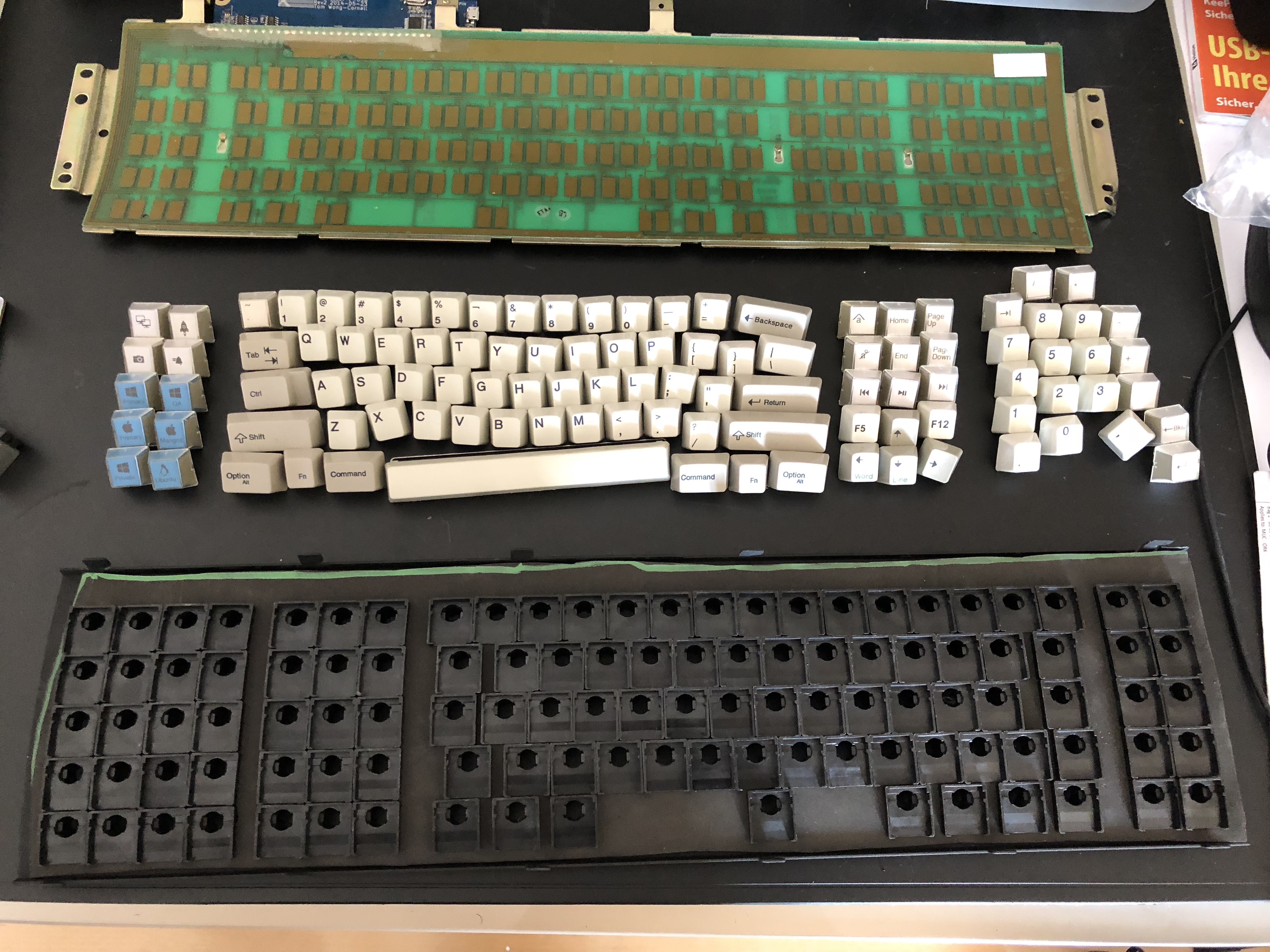

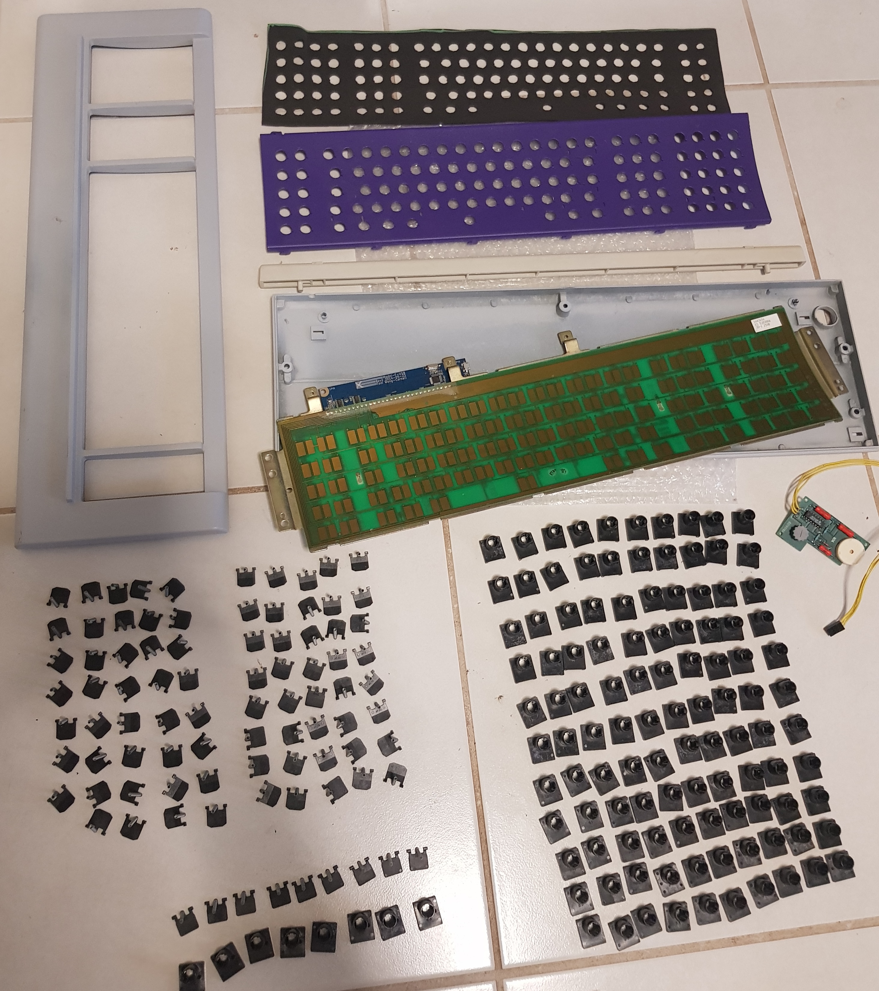

I received the engineering masterpiece of all keyboards a week ago from fanpeople over at gh. Nearly 5 kilos of pure pleasure. It was in a half-restored state and needed some work. Here’s how it arrived, after it traveled around the world from Australia to Germany:

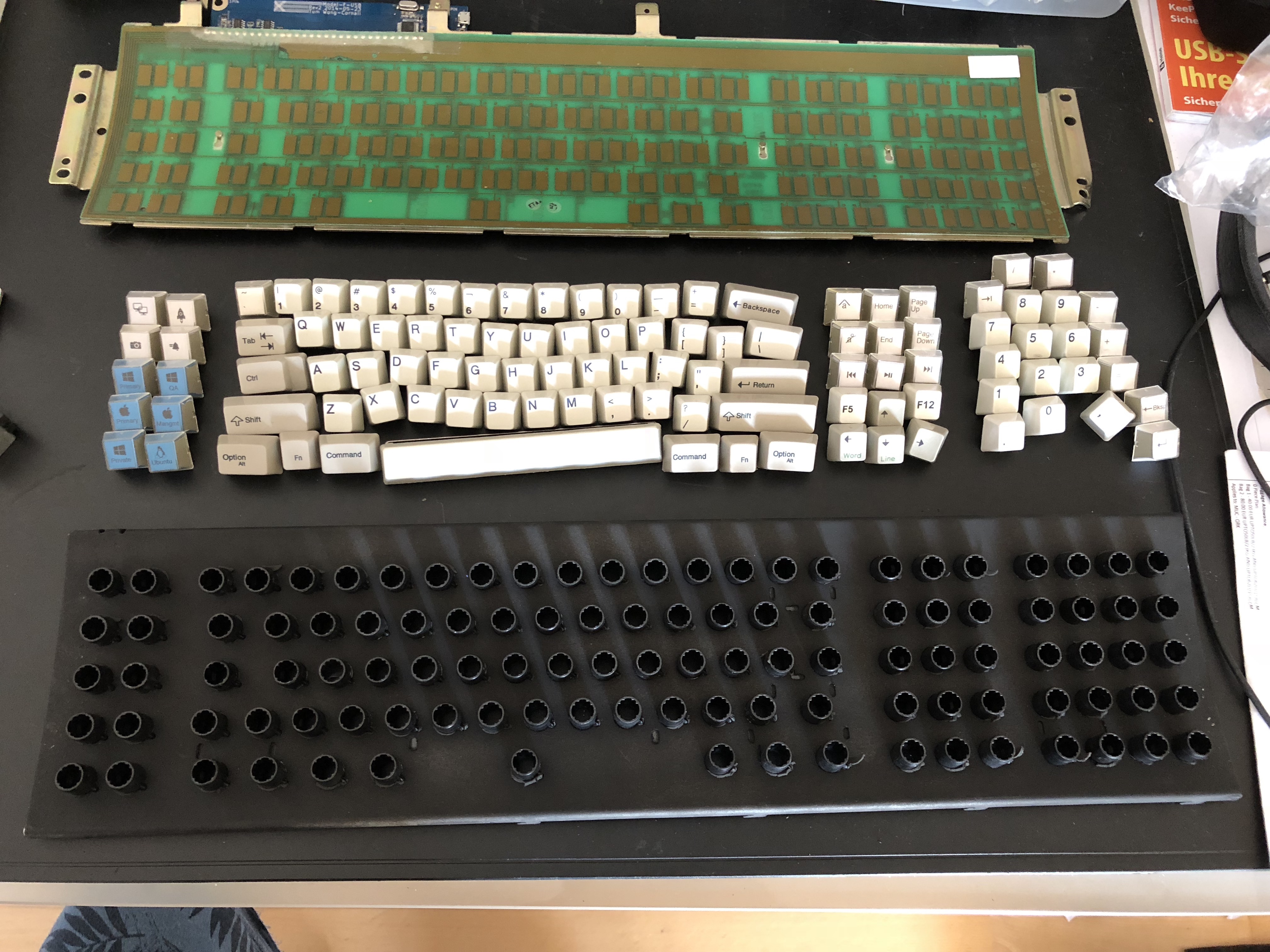

Step 1: Lining up the PCB, Keycaps and new foam, while the barrel plate was drying (I removed the slightly to thick purple paint and replaced it with a thin layer of standard black)

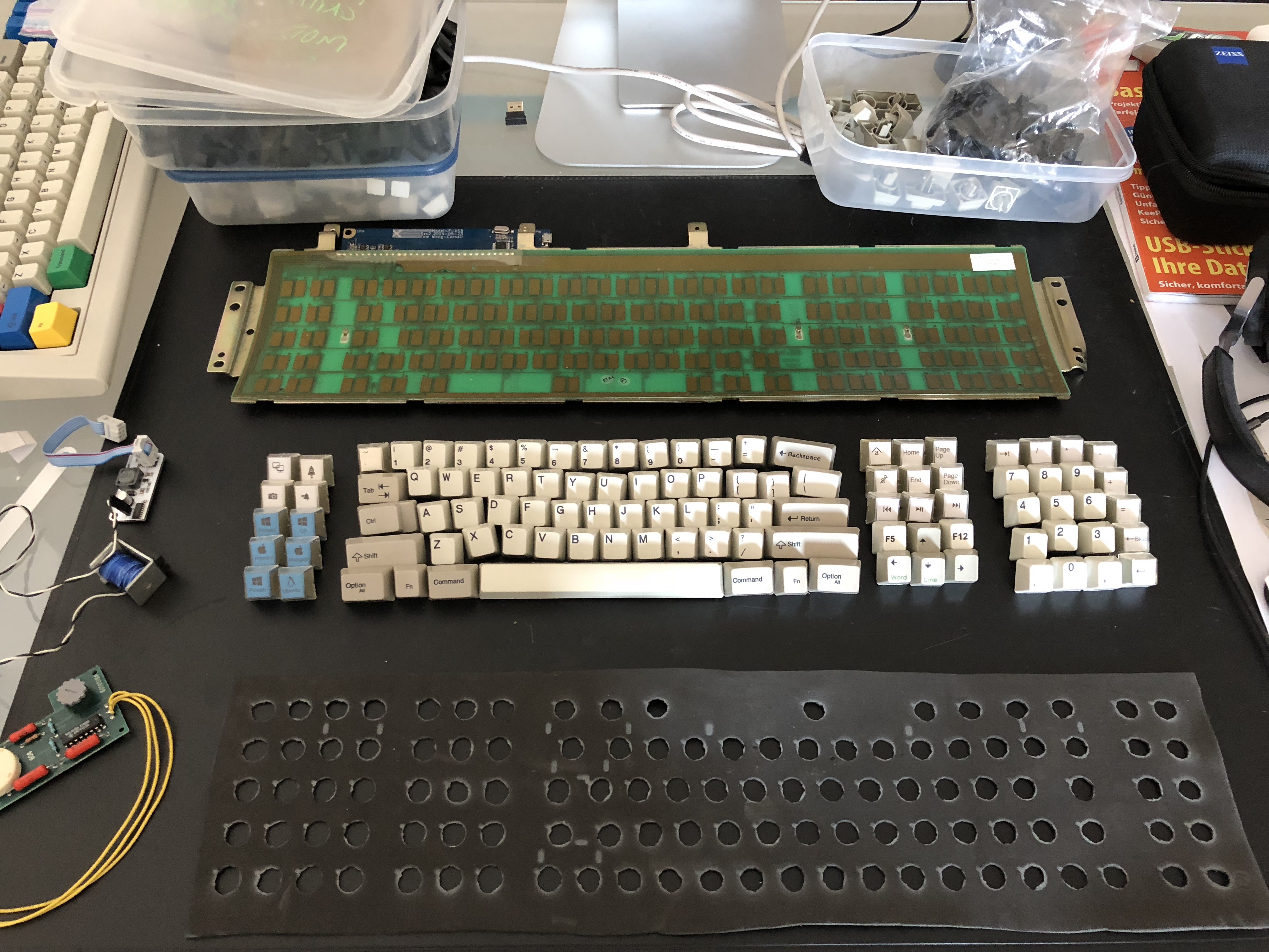

Step 2: Fitted the barrels in the fresh painted barrel plate with the foam matt in between – see front and back:

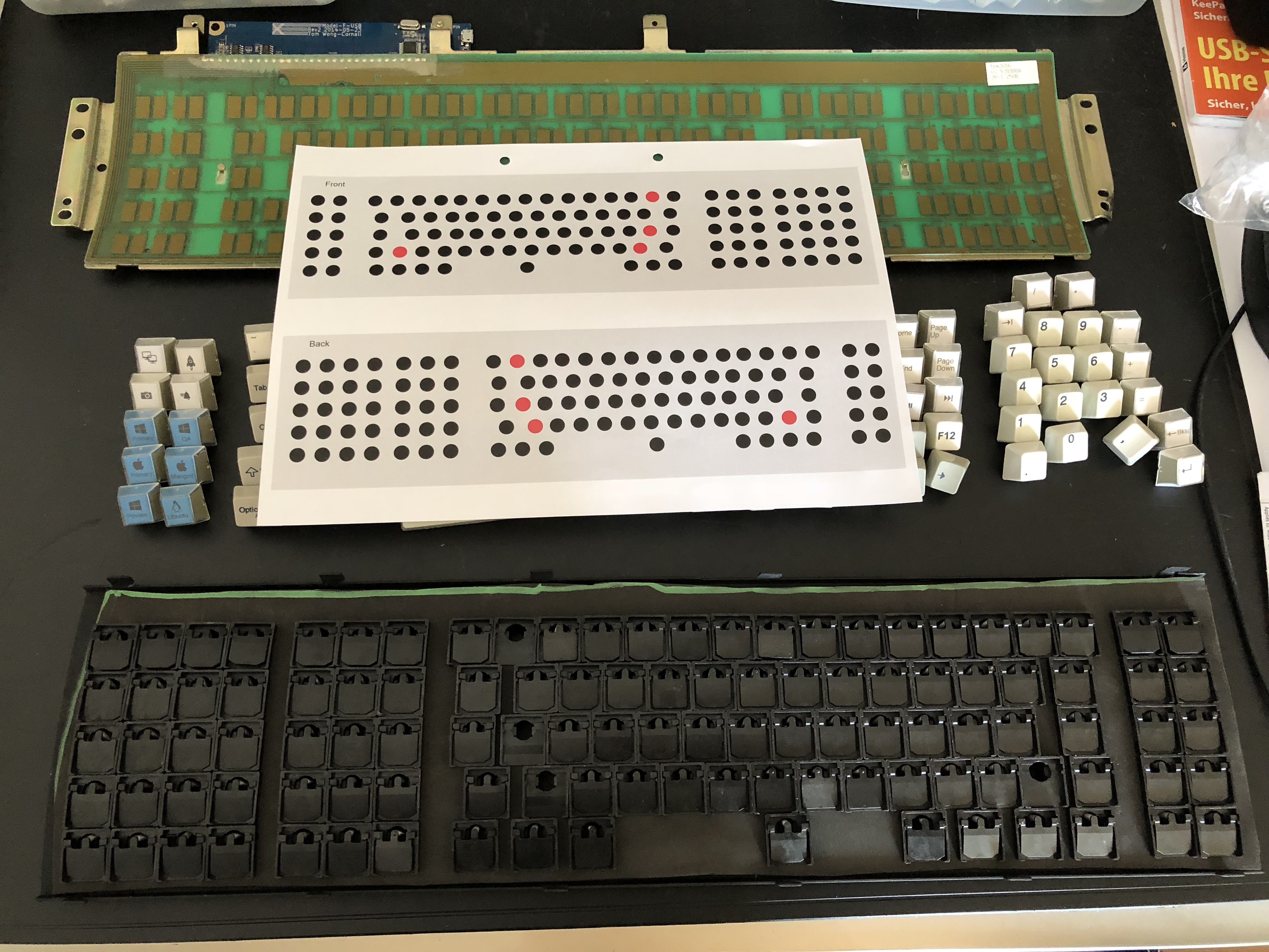

Step 3: Adding the springs and flippers according my ANSI conversion plan (red spots will not get a flipper added):

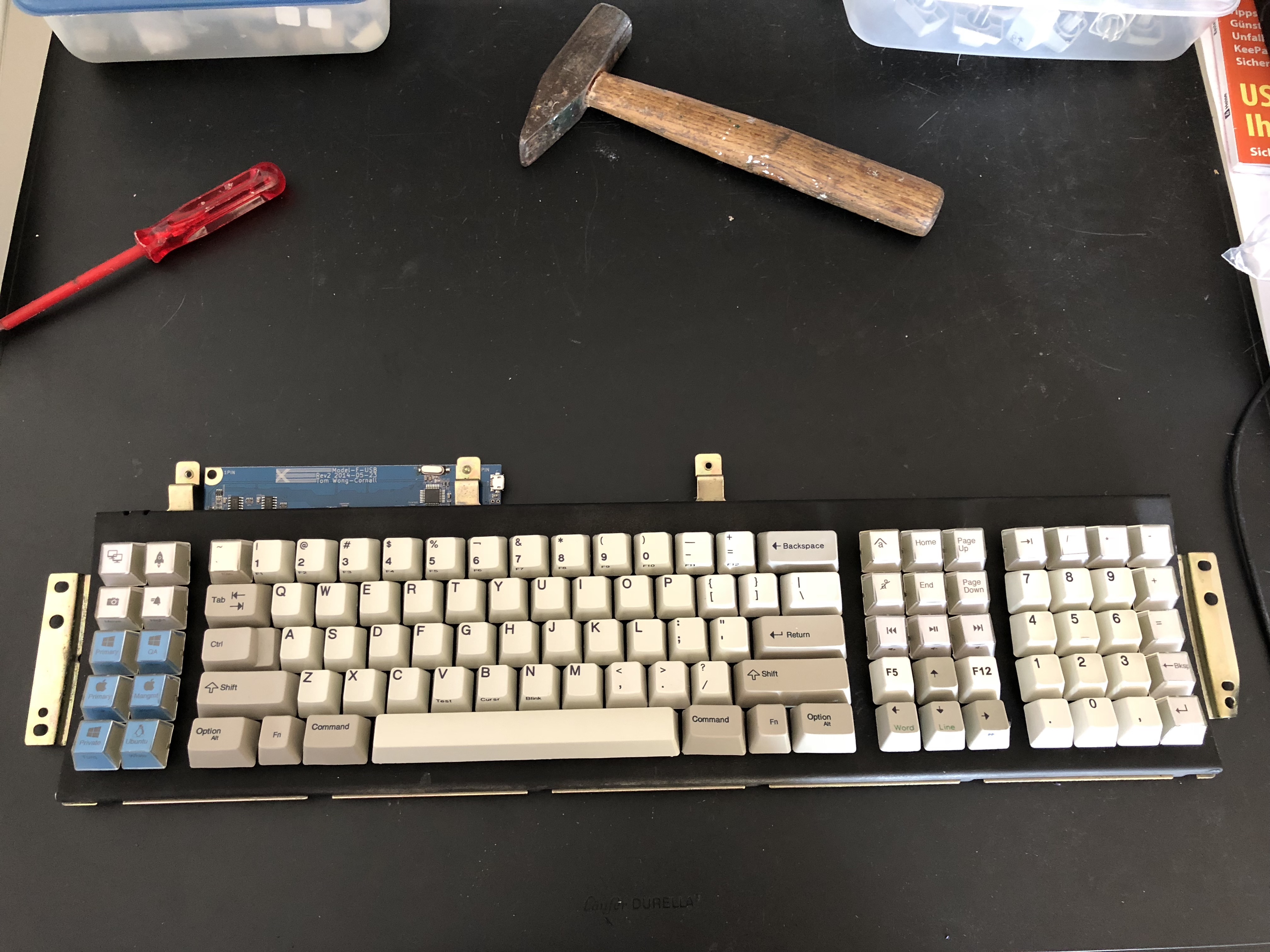

Step 4: It is always a fine line of force and gentle push to get the PCB, backplate, foam and barrel plate together – hence the hammer:
Step 5: Test of the keys. In the past I had it at times, where a flipper got stuck in a barrel and I had to get the pieces apart multiple times. This time – all went very well. This all, while I had to wait for my case to dry, which was painted in RAL-7030.

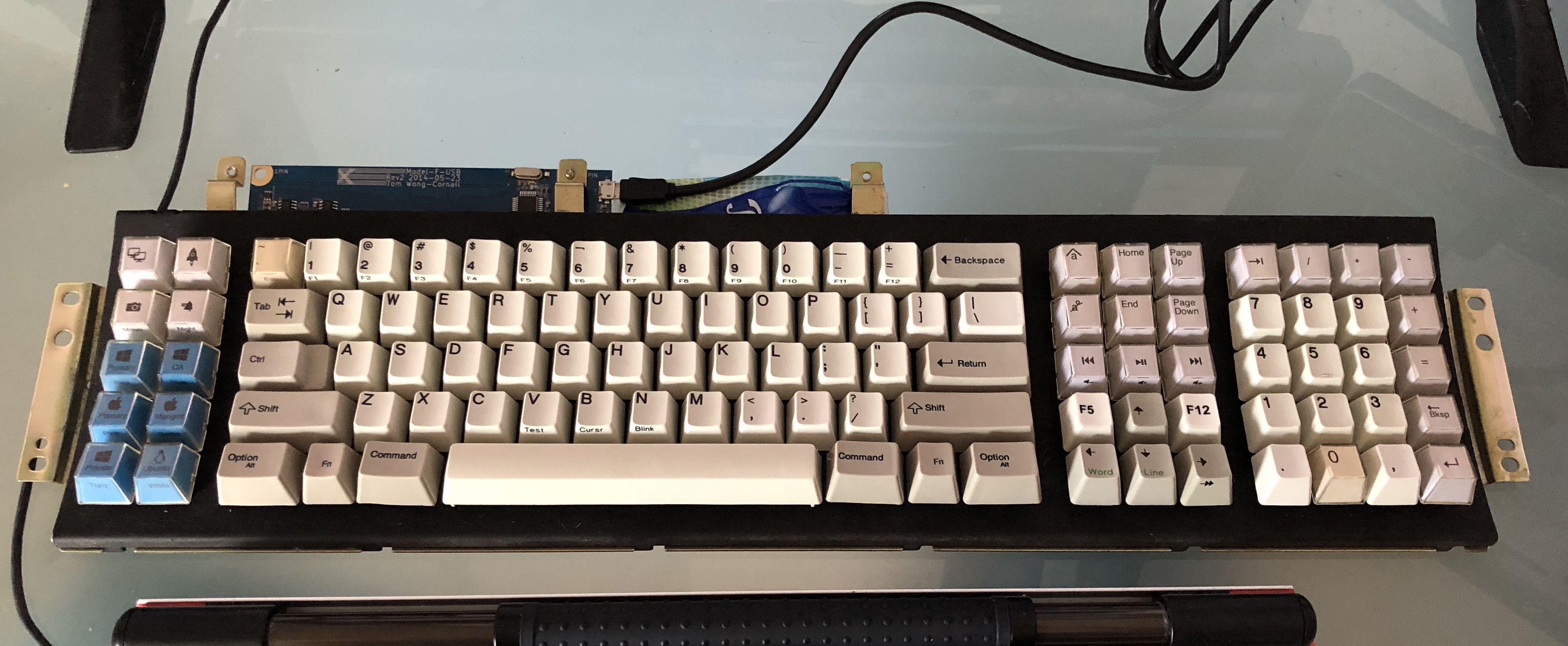

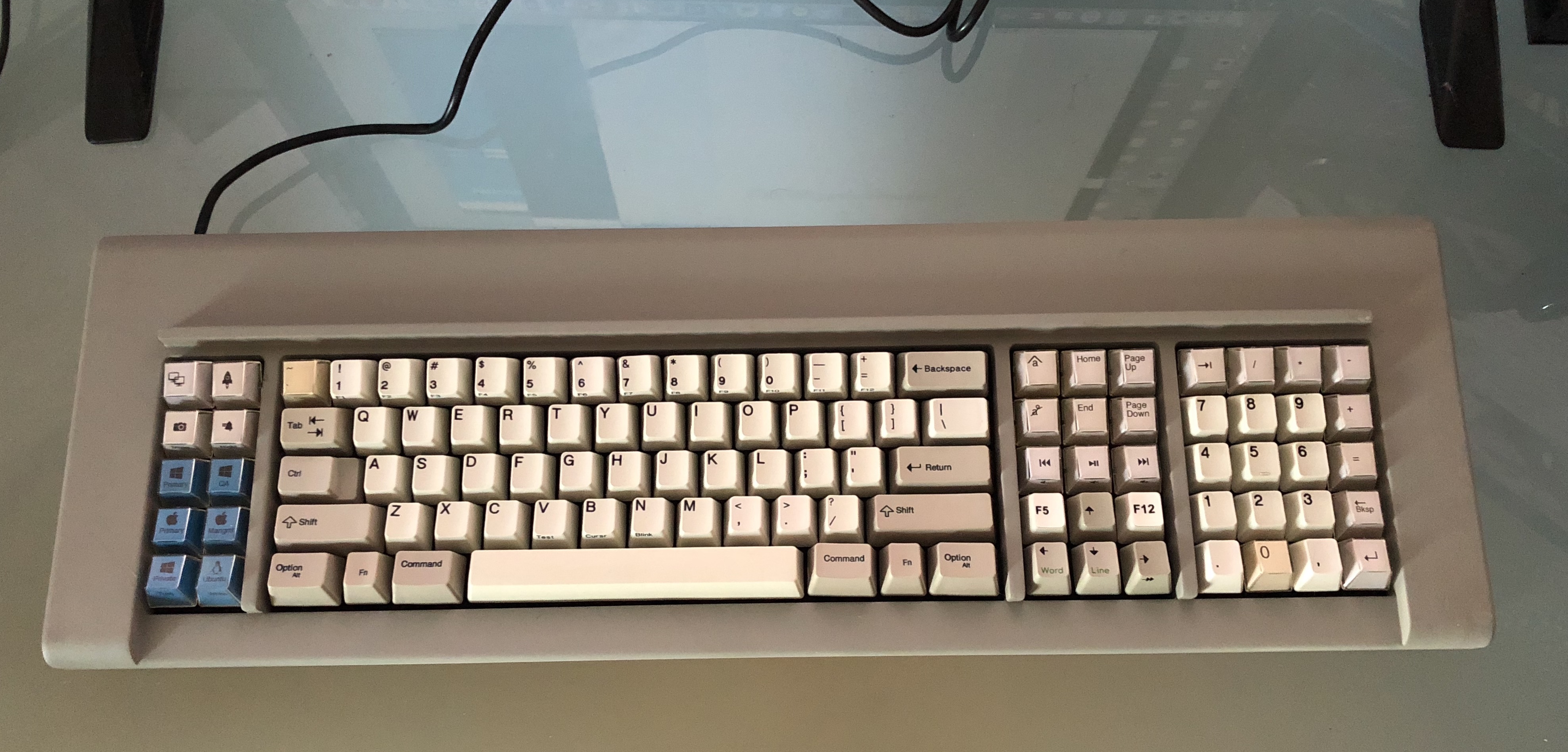

Step 6: Test of the assembled F107

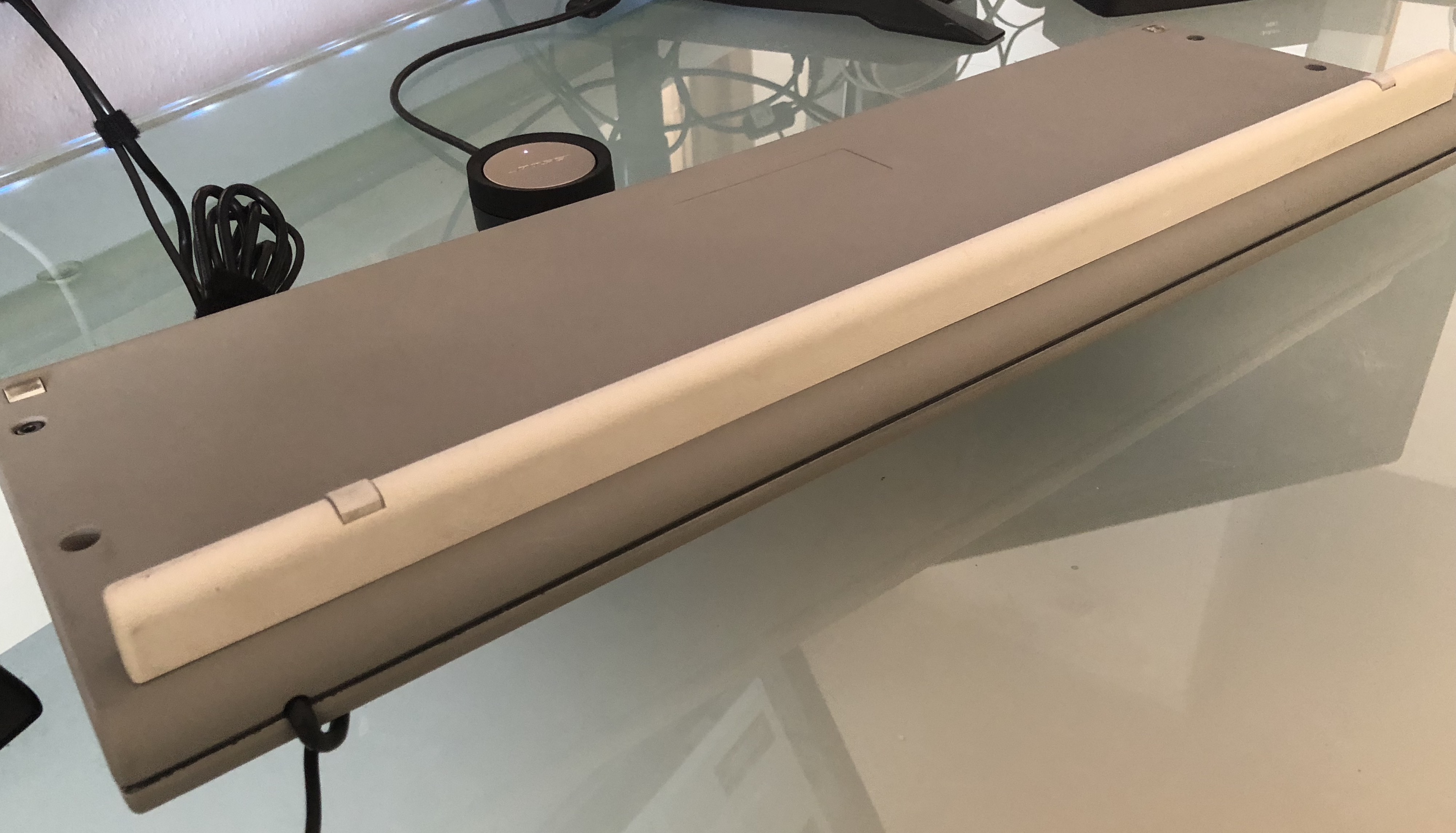

Step 7: Raising bar of the F107 – something I haven’t seen very often so far. It is raising the keyboard to my optimal height:

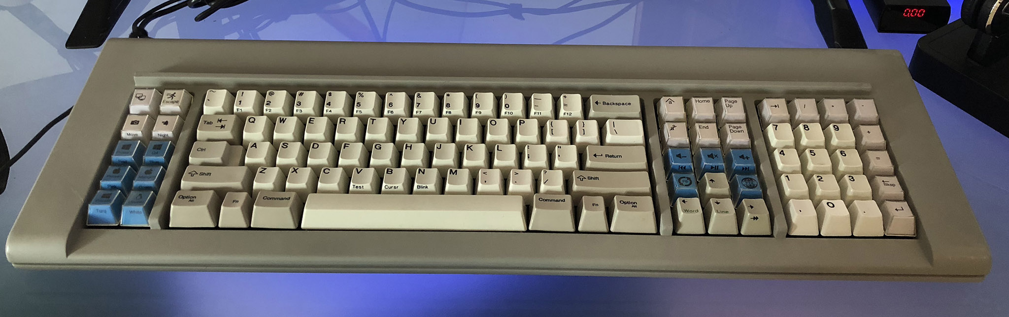

Quick update:
I had to replace the firmware of the keyboard with one that has a more aggressive de-bounce filter implemented, as I had a ton of ghosting going on. With the new firmware it just works perfectly.
f-o-r-s-a-l-e-f58/xwhatsit-s-grand-unif ... 20debounce
Latest configuration of the F107:
