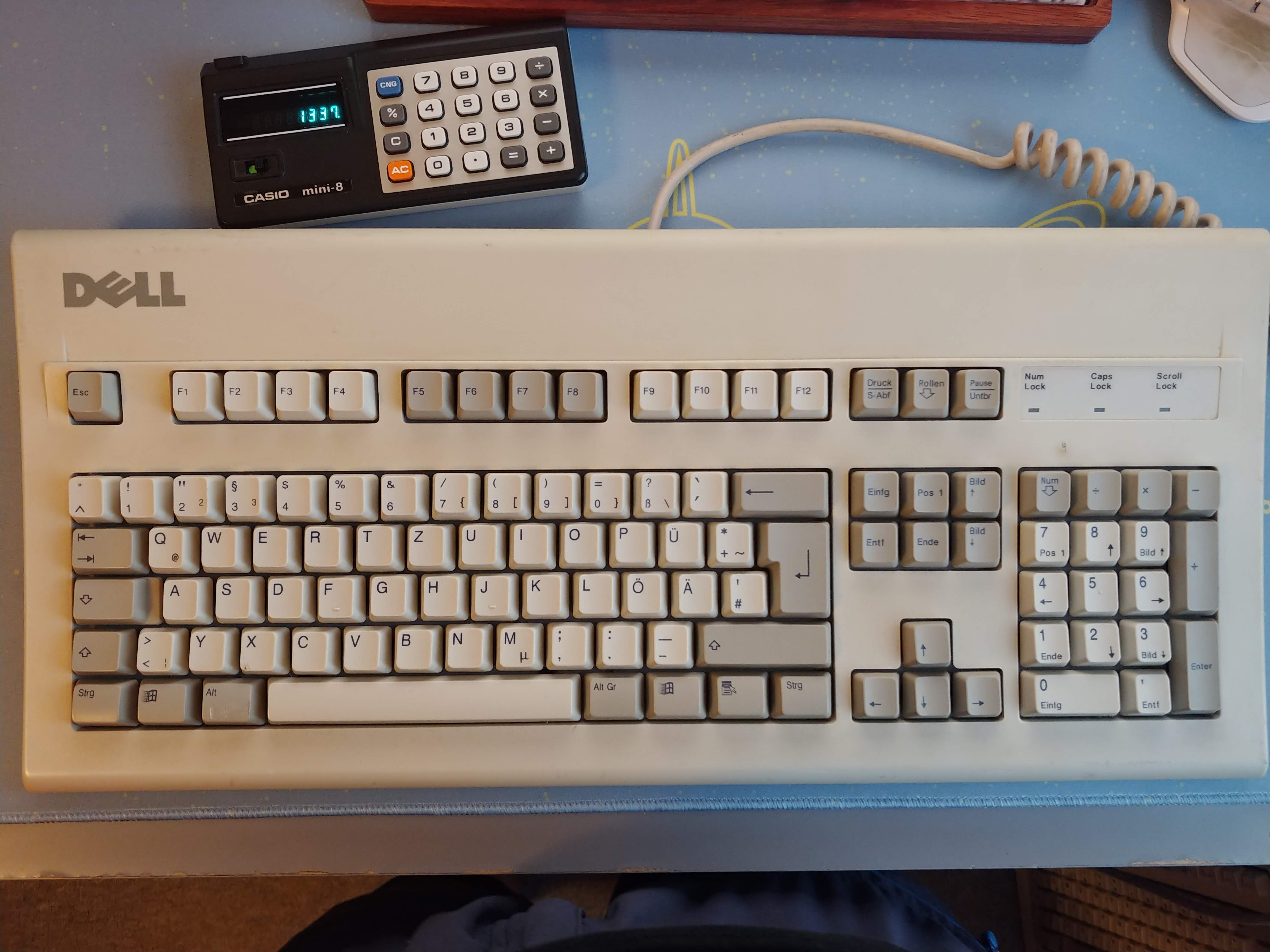

Dell AT102DW
The AT102DW was the first keyboard I started restoring. I started with taking the key caps off and cleaned them off with soap. I then got to the switches. Black ALPS. I disassembled them and put the sliders and switch tops in soapy water. While they were drying I swabbed the inside of the board and bottom switch housings with isopropyl, and cleaned the top of the board with soapy water.
I started assembling a dew switches and I quickly realized that I didn't like them tactile, so I tried the linear mod for them, and quickly decided for that. I also wanted to lube the switches, so I ordered some Super Lube oil and grease, and some Victorinox oil. I used a mix of 2/3 Super Lube grease and 1/3 oil. I had read that Victorinox oil is good for the springs, so I dipped the ends in it. The switches definitely feel a little scratchy still, but they are fairly smooth.
Unfortunately I didn't take any pictures of the process, but here's the final result:

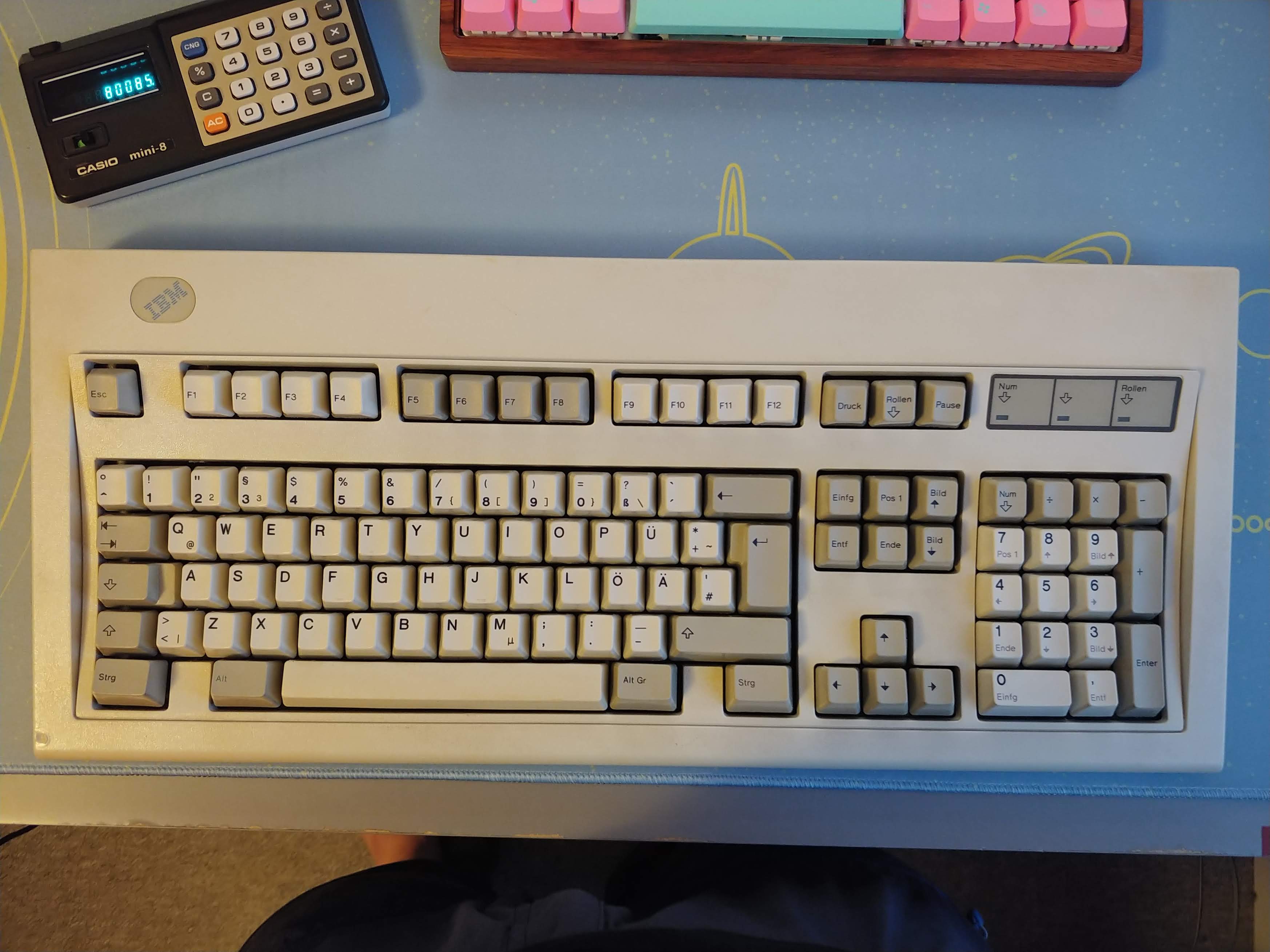

IBM Model M
The Model M is part of the reason why it took me so damn long to get this up. I couldn't find any store close to me that sold the 5.5 mm screwdriver necessary to open it.
The caps were clean

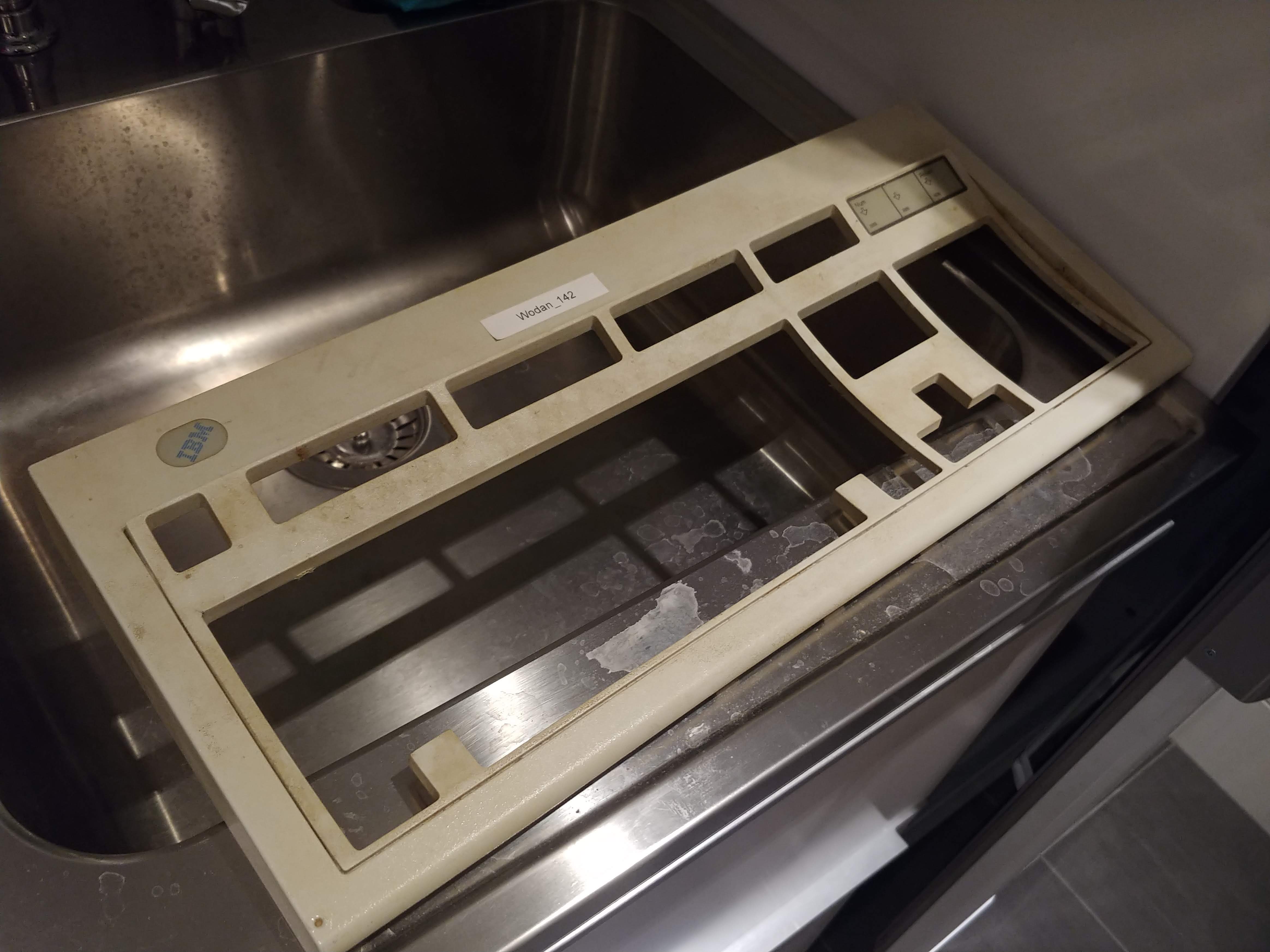

This is how the top case looked before cleaning:

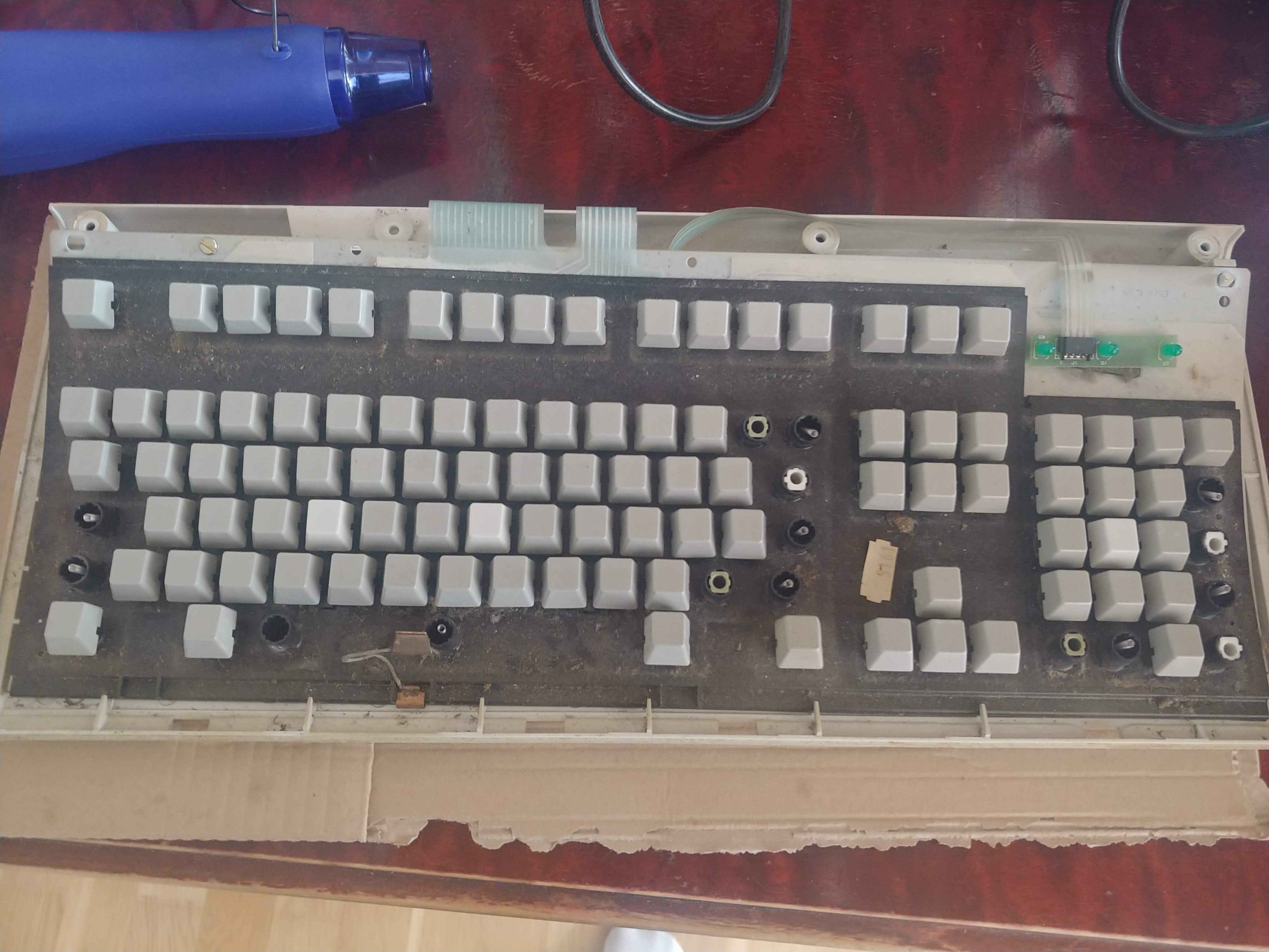

Under the case, after vacuuming it:

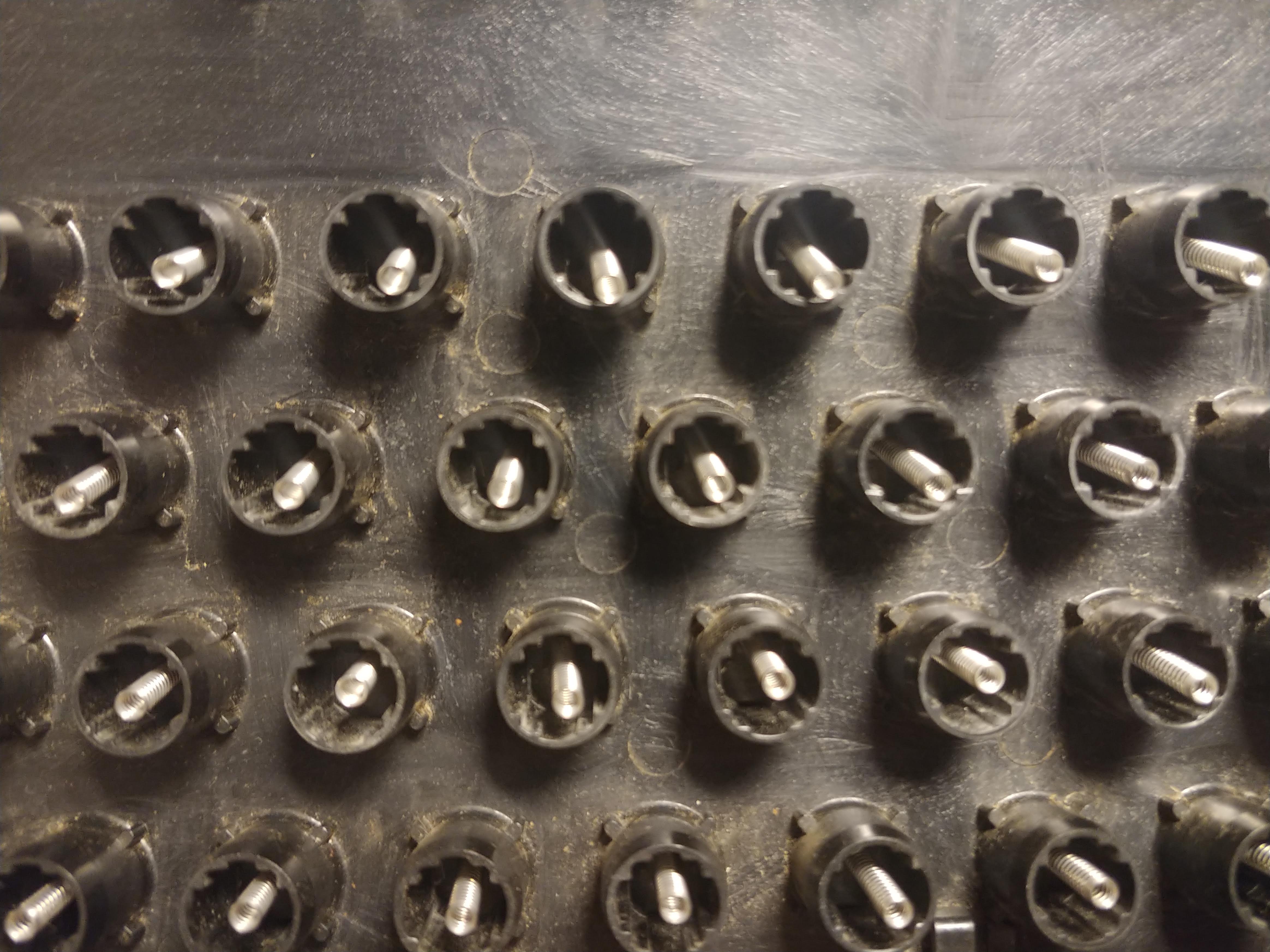

The barrel plate was still pretty dirty after swabbing it with isopropyl. I could have done a much better job. The inside of the barrels were cleaned after this photo was taken.
Final result:

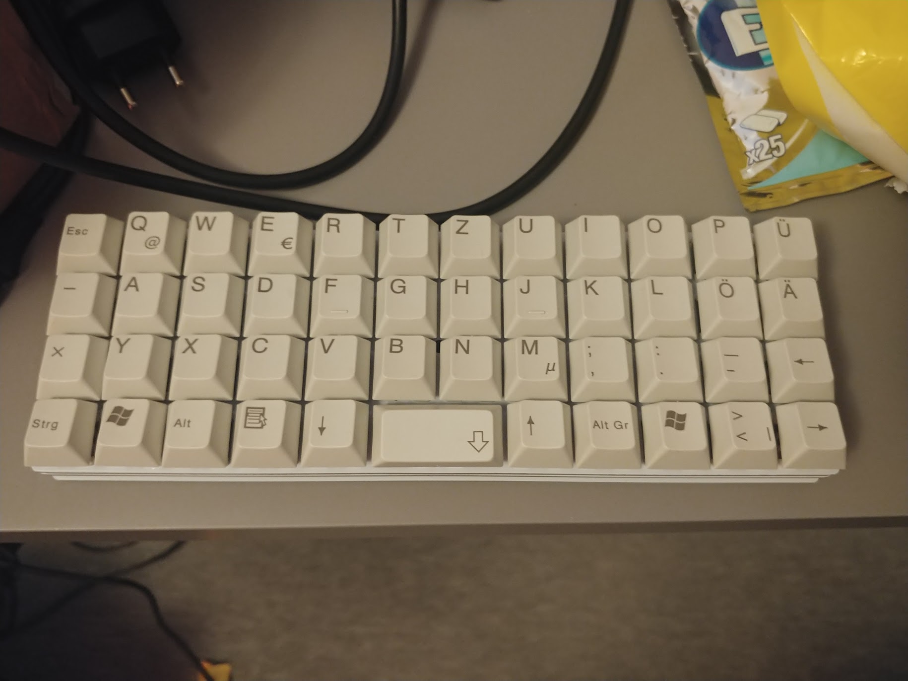

The caps from the G80-11900 looks great on my Contra!
(I know the switch alignment is pretty bad. Plz don't hate <3)
