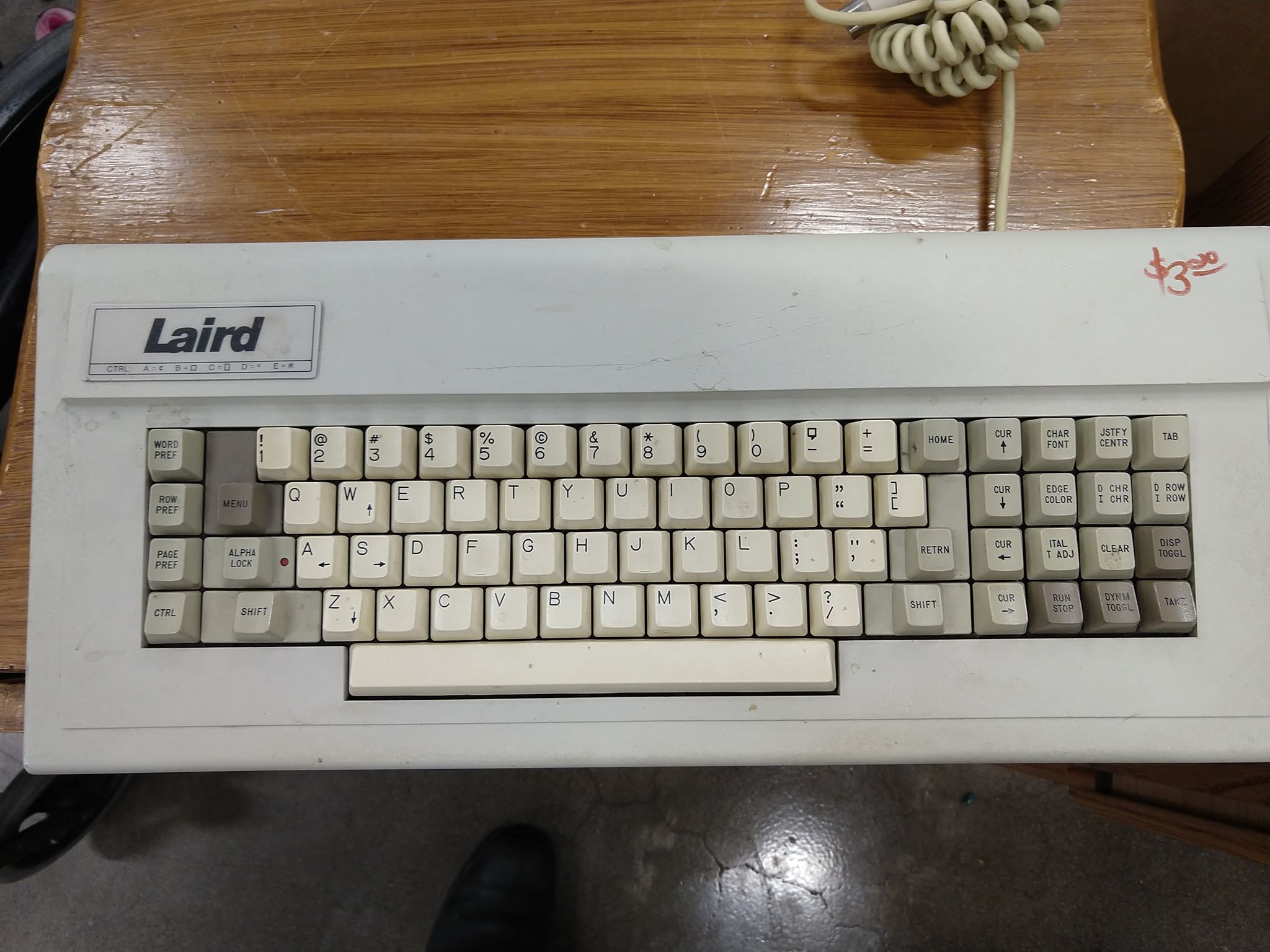

Hey everyone so I am very new to this forum, but I am glad to have found a community that seems to love old keyboards as much as I do. I have been slowly collecting over the past few years and don't plan on stopping. Just got this one today and it seems to be the oldest one I have obtained yet. Anyway I plugged this bad boy in and it seems to get power but nothing else seems to be working. Now I am running this on windows 10 so I won't be surprised if it won't work due to the OS or the keyboard itself may just not work. But I figured I would come to you guys to get some input. From what I have found out so far, it may have been for a old word processor but I haven't got a clue. Please excuse me if I do not use the proper terminology but I was thinking it may have no input due to the key scan codes. When it comes to key scan codes, is there a program that can detect that, which then allows me to direct them to the proper function (if that makes sense)?
- 37668094_10213213379629103_2433768558585446400_n.jpg (24.29 KiB) Viewed 2140 times
- 37626300_10213212385924261_4607521515057971200_n.jpg (319.72 KiB) Viewed 2140 times

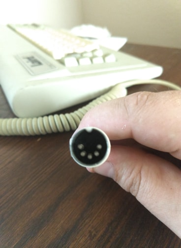

But first thing first: what connector is that on your cable? Big 5 pin DIN? Little PS/2? A non-PC looking board like this was indeed likely designed for a word processing system or some such. In which case it may speak a foreign protocol. Some of those are translated, but not all of them.

It's a 5 pin, and I use a converter to PS/2 to plug it in.

There’s more than you might think:
http://www.kbdbabel.org/conn/index.html
If the board were simply AT protocol, it should work with your adapter just fine. But it doesn’t. And the keyboard itself looks quite different from a regular IBM compatible layout.

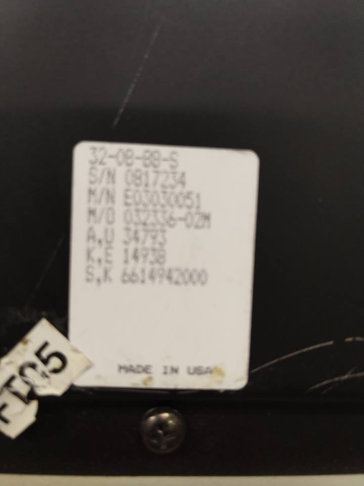

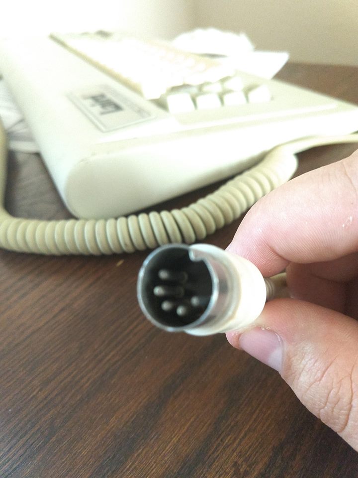

Holy, that's a lot of different variants. Well I certainly can't pinpoint which is mine on the list so here's a picture of it if that helps at all.
- 37606747_10213215823330194_7818309202916409344_n.jpg (75.47 KiB) Viewed 2053 times
- 37631618_10213215822970185_8746054926632747008_n.jpg (27.13 KiB) Viewed 2053 times
- scottc
Looks like a standard DIN5 - might be XT protocol? You should try to build the Soarer's converter that Mu mentioned. If it's XT, it'll work right away with it.
