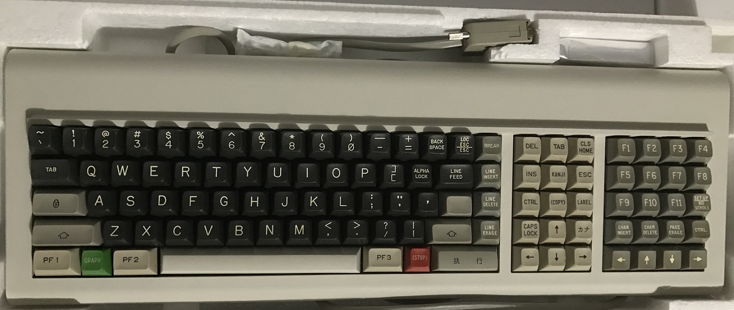

Well, there have been hundreds of Pingmasters sold over the last few years, but I've only ever seen six or seven where people have posted their custom layouts. So I figured I'd post mine at least.
For anybody else making a Hasu convertor from a Chinese pro-micro clone and a DB9 connector, you need to bridge the J11 slot. (I think it's supposed to be occupied by a fuse in the BOM?) to get +5VDC from USB VCC to board VCC. I'm sure this has been posted a few places but I never ran into it except once when I was digging around the geekhack thread on it. Never hurts to say it again.

Sandrax, how did you make your key labels for the relegendable keys? Those look sharp.
Here is mine...except most of the Japanese keys have been swapped.

Those Futaba caps? They look nice.
For the labels I just used http://keyboard-layout-editor.com/ to save the trouble of hunting down fonts and symbols and adjusting key sizes and things. Since it displays in vector despite png downloads being pretty compressed, you can take a high res screenshot and then just make the center the right size (11mmx11mm on relegendables) then print. I just used my color laser printer and some glossy white cardstock so the white and colors would be vivid.
