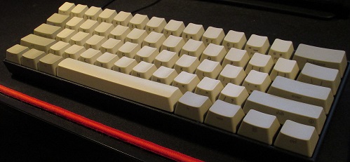

Form Factor and Layout
As shown in the images below, the V60 is a 60% keyboard that includes only the alpha keys and modifiers found in the main typing area of a full-size keyboard. F-keys and navigation keys are accessed via the Fn key. A recessed mini-USB connector is located in the left rear of the case. The case is a durable plastic shell provided with four rubber strips to keep the board from sliding on the desk. I like the KBP cases -- the design provides a resonant chamber that sounds much better to me than aluminum tray-style cases.
The layout is the standard 61-key US ANSI version as found in the Pok3r and various other 60% keyboards. The configuration can be changed to some extent by various settings of the six DIP switches located on the underside of the keyboard.

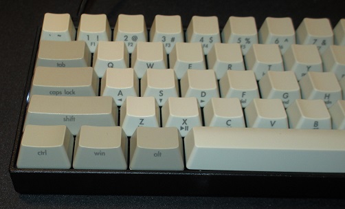

Keycaps and LEDs
This version of the keyboard came with two-tone front-printed ABS keycaps as shown in the two images. The close-up view of the left side of the board shows the sole LED to indicate activation of the Caps Lock key.

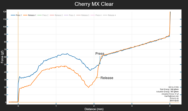

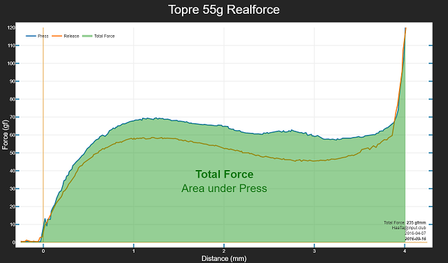

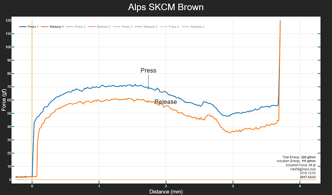

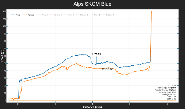

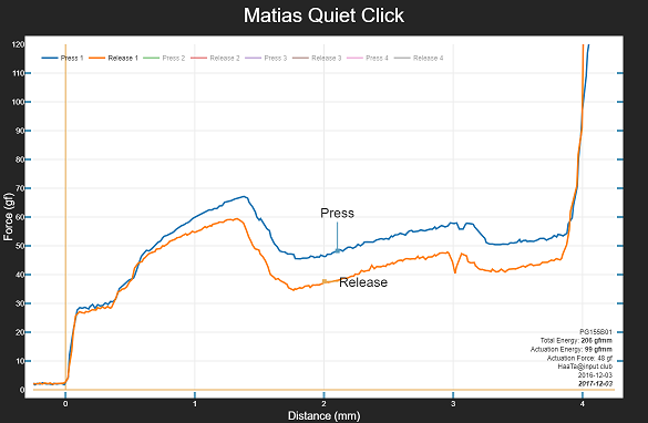

@Muirium: I should always remember that you might be reading my posts and take greater care in refining my language! Now I realize it was a poor choice of words to say that SKCM Brown Alps were the "supreme tactile switch". I had intended to say that SKCM Brown Alps offered perhaps the most pronounced tactily of any switch I have tried.
I agree about the sensation of drawn-out tactility with Topre. It's related to the shape of the force-displacement curve. However, our sensation of tactility is also related to the physical concept of impulse, which is force x time. Although force-displacement curves by definition display only force and distance and not time, it is nonetheless instructive to look at these curves for different keyboard switches, preferably determined under the same conditions.
These curves help me to understand why I find mx clears so tiring -- although the actuation energy is comparatively low, the total energy under the "press" curve is the highest of the switches sampled here. My style is to bottom-out each keystroke, so I am pressing clears throughout the steeply rising end-portion of the curve.

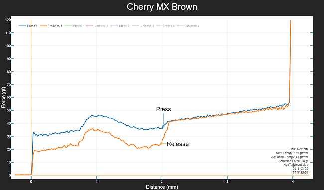

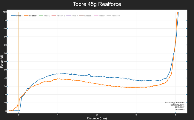

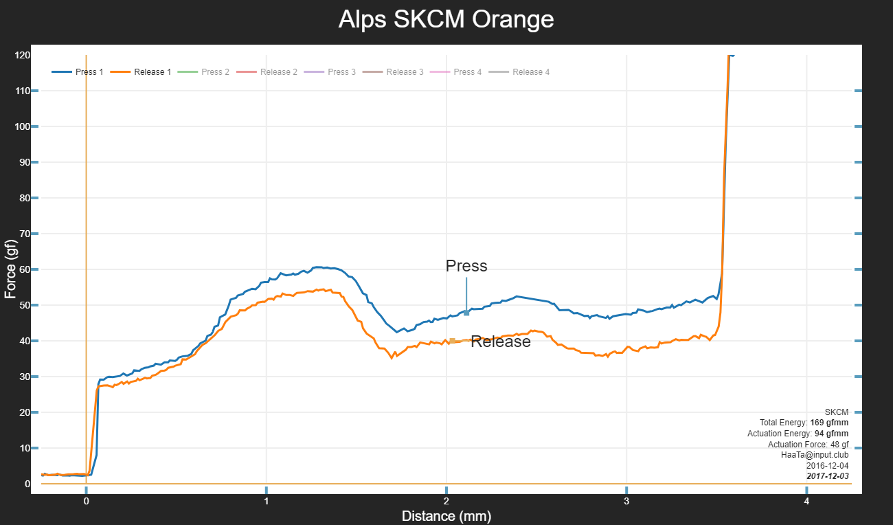

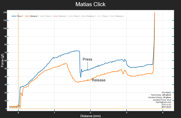

Here is a sample of such curves generated by HaaTa (see, for example, https://plot.ly/~haata/171.embed):
Topre 45g, "Total energy" = 161 gfmm, nominal actuation force = 45gf, actuation energy = ?
Topre 55g, Total energy = 235 gfmm, nominal actuation force = 69 gf, actuation energy = ?
Cherry mx Brown, Total energy = 166 gfmm, actuation force = 38 gf, actuation energy = 73 gfmm
Cherry mx Clear, Total energy = 242 gfmm, actuation force = 51gf, actuation energy = 107 gfmm
Alps SKCM Orange, Total energy = 168 gfmm, actuation force = 48 gf, actuation energy = 94 gfmm
Alps SMCM Brown, Total energy = 222 gfmm, actuation force = 69 gf, actuation energy = 111 gfmm
Alps SKCM Blue, Total energy = 167 gfmm, actuation force = 49gf, actuation energy = 96 gfmm
Matias Click, Total energy = 200gfmm, actuation force = 48gf, actuation energy = 99 gfmm
Matias Quiet, Total energy = 206 gfmm, actuation force = 48 gf, actuation energy = 99 gfmm
