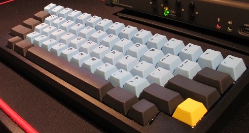

Finished Product
An image of my assembled keyboard is shown below:
The spacebar and modifiers are blank black PBT in Cherry profile from Imsto. The alpha keys are black on blue dye-sublimated PBT from Imsto. The Fn key is a blank yellow PBT keycap from Originative.
Originally, I had installed 65g purple Zealios, but I decided to remove these and install 67g blue Zilent switches (also from Zeal PC).

My first impressions of the Tokyo60 v1 kit were negative. However, in retrospect, this was due in part to my not taking sufficient care when installing the switches. During my first attempt, I had a number of seemingly dead switches owing to the fact that I had bent the metal legs during installation. However, after replacing the damaged purple Zealio 65g switches with Cherry mx clear switches that I had on hand, I was able to get all the keys operating correctly.
Initially, I also did not particularly like the sound or feel of the keyboard. These attributes improved markedly after removing all the switches and replacing them with blue Zilent 67g switches. The keyboard is now extremely quiet. Moreover, the feel of the board is quite refined – a pleasant surprise after negative experiences with most Cherry mx or mx-clone keyboards.
There are still a few minor glitches and some concerns. For example, during normal typing, I get occasional unwanted spaces – this is probably due to having the same weight of switch in the spacebar as in all the other switches. I might go back and install a heavier switch under the spacebar or change my typing habits to avoid resting my thumbs too heavily on the spacebar.
In addition, although the keys are largely quiet during normal operation, an exception is the Return key – the keycap seems to contact the plate only on this key. I might try filing down the Return keycap or installing a different brand in this location.
Finally, during the first two rounds of switch replacements, removing a switch from the top sometimes resulted in pulling off the top housing, and removing a keycap sometimes pulled the switch out of its socket. However, these problems can be circumvented by removing the switches by pushing them out from the bottom, although of course this entails removing the bottom part of the case.
Overall, after a rocky beginning and two rounds of changing switches, I am now quite pleased with the Tokyo60 keyboard. It has many of the features I prefer, including a 60% form factor, HHKB layout, dye-sublimated PBT keycaps, and a hefty attractive case. I am also an advocate of complete programmability, although I did not need this feature, because the default configuration was already my preferred HHKB layout. The hot-swappable PCB in this kit affords a good way for a novice to build a keyboard and to be able to swap out switches without desoldering and resoldering. My former reservations about the Tokyo60 keyboard kit have been largely addressed, and I am now able to give it a high recommendation.
On the other hand, the Tokyo60 keyboard kit is rather expensive, and the cost escalates depending on extras such as replacement keycaps and switches. Although the kit can result in a highly serviceable HHKB-like keyboard, its final cost can exceed that of a genuine HHKB Pro 2, and it will not likely replace the Fujitsu Topre-switch model as my daily driver.
