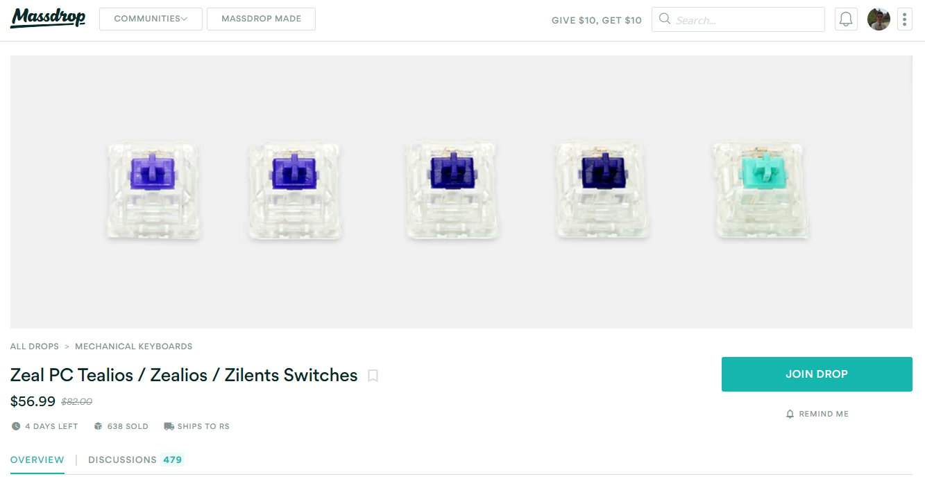

Findecanor wrote: Zealios come in a silenced variety, but any Zealio are very expensive.
Well well, lucky me I guess, look at this :D
12 Sep 2018, 11:52
Can’t. MassDrop account wall.

Muirium wrote: Can’t. MassDrop account wall.
12 Sep 2018, 12:00
That price for 100 switches? Pretty expensive. I was looking at around the same for silenced MX blacks for my Bluetooth 60% project when I had to pack it in on costs.

12 Sep 2018, 12:03
That price of $56.99 is for 70 Tealios or Zealios switches, though. If you want 110 of the Zilents switches you are at $106.99 already! Not exactly cheap, but I've seen worse prices for Zeals switches. No comparison to Cherry switches, though, you can get those at around 0.50-0.60€ per piece here in Germany.

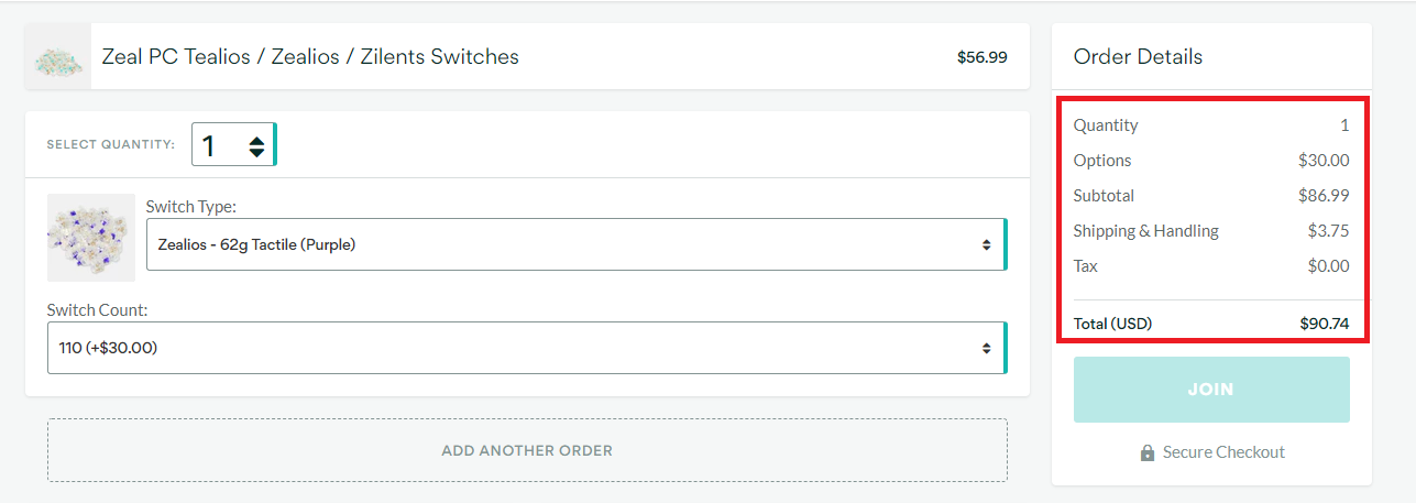

12 Sep 2018, 12:03
Muirium wrote: That price for 100 switches? Pretty expensive. I was looking at around the same for silenced MX blacks for my Bluetooth 60% project when I had to pack it in on costs.
Nope this is the actual price for 110 switches:
