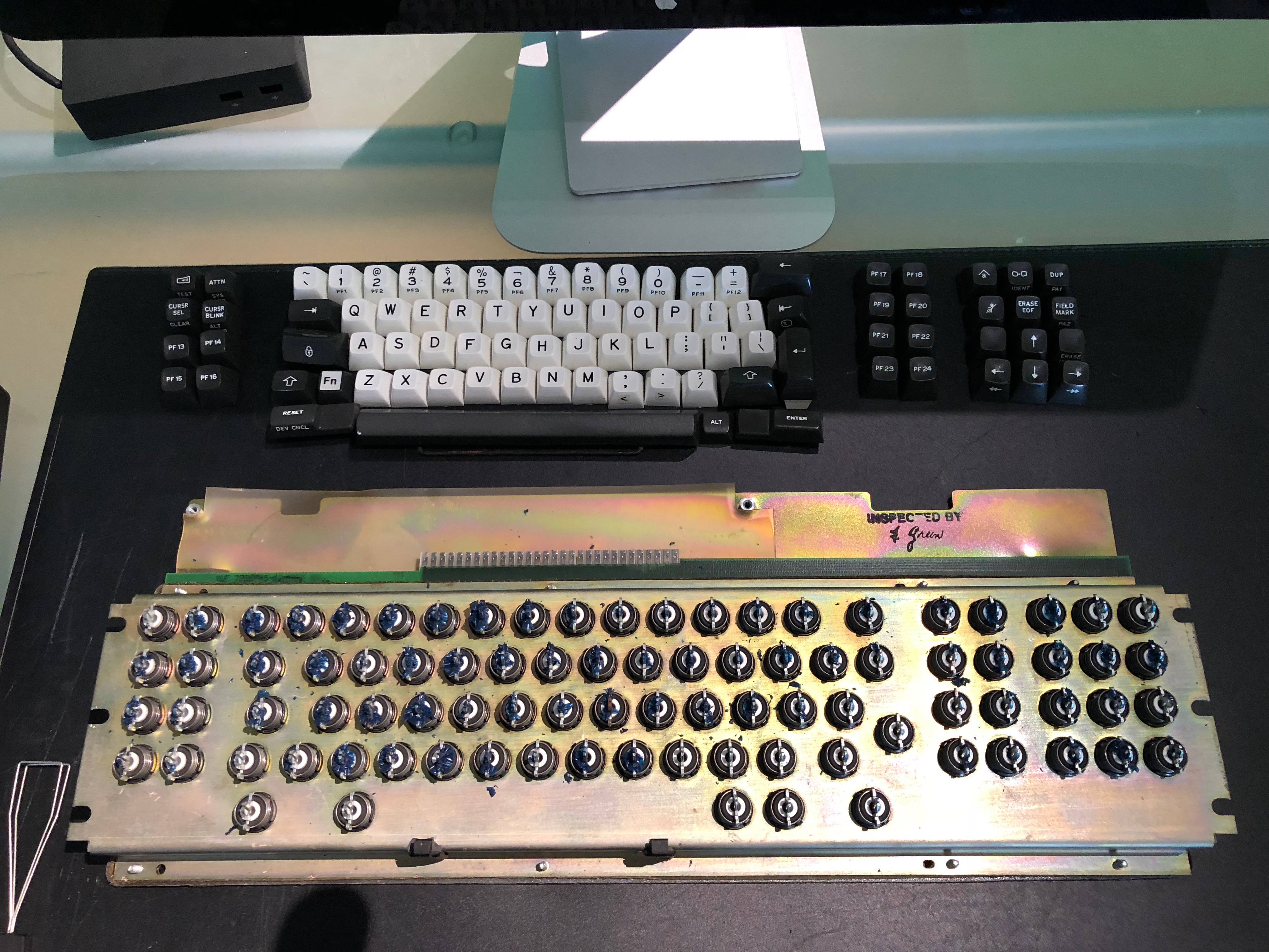

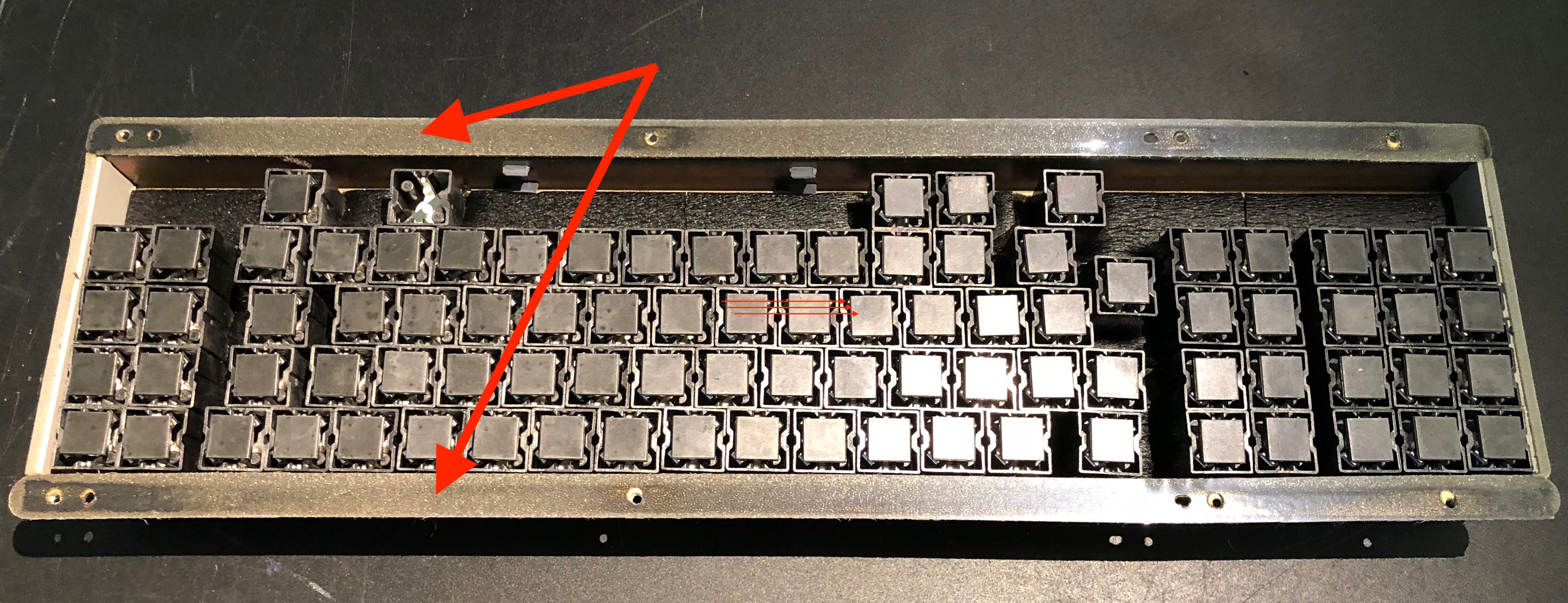

This is what I started with; an IBM 3278 full size board from 1977 or 1978 in the original un-restored state.
After functionality tests (including a xwhatsit modification), I recognized wobbling keys and that the typing sound wasn’t as great as I have heard them in some videos. So, I decided to restore it properly…
What is needed to restore the keyboard fully (including the key-switch-cleanup and foam replacement)?

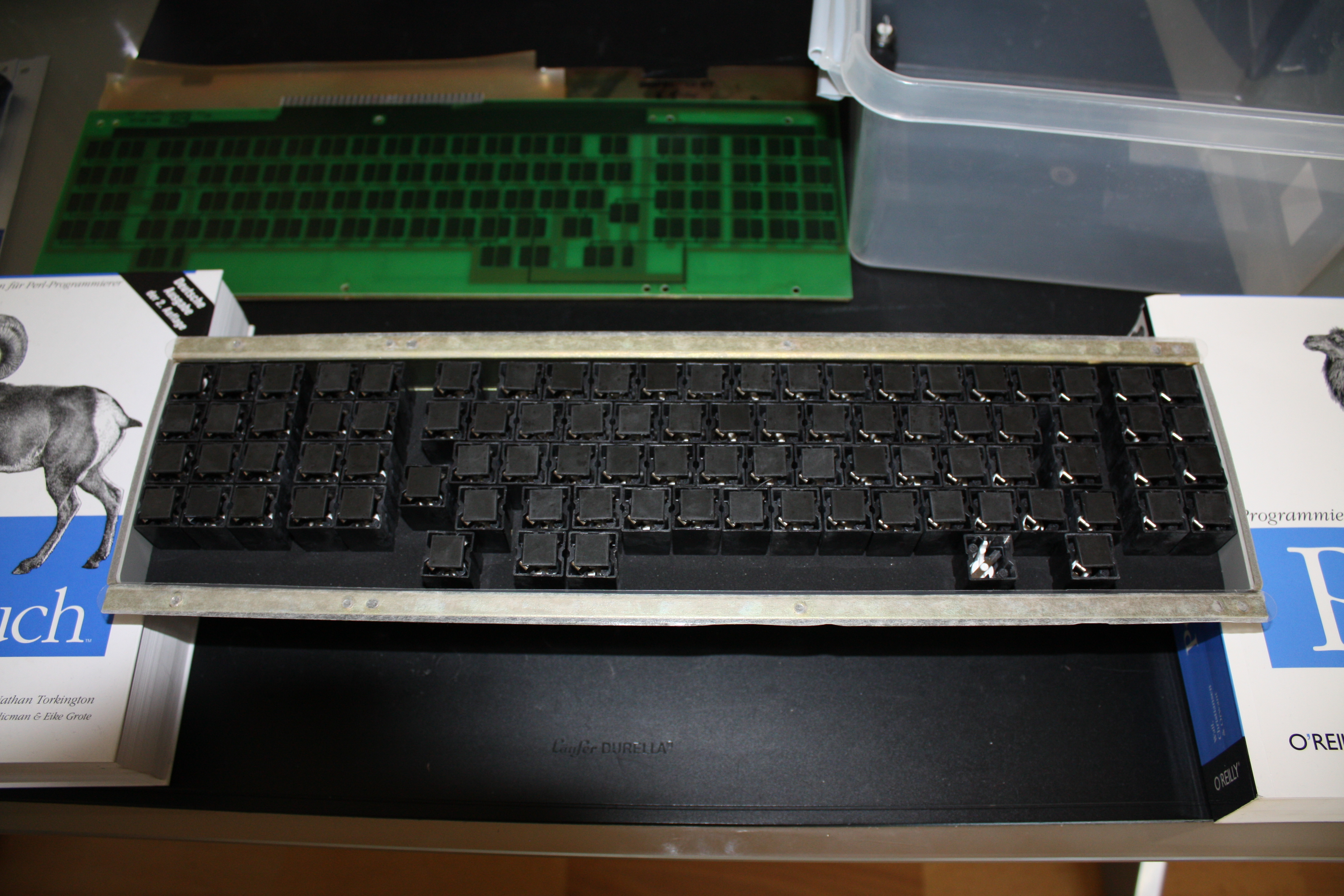

Get two thicker books, place them so far apart that edges of the keyboard plate will fit. Turn the keyboard (plate with key switches) upside down and look at the underside. There are 6 screws you have to remove.
Be careful when removing those screws. The keyboard might be slipping off the books and switches can dislodge. Once you have it open, you will see something like this:

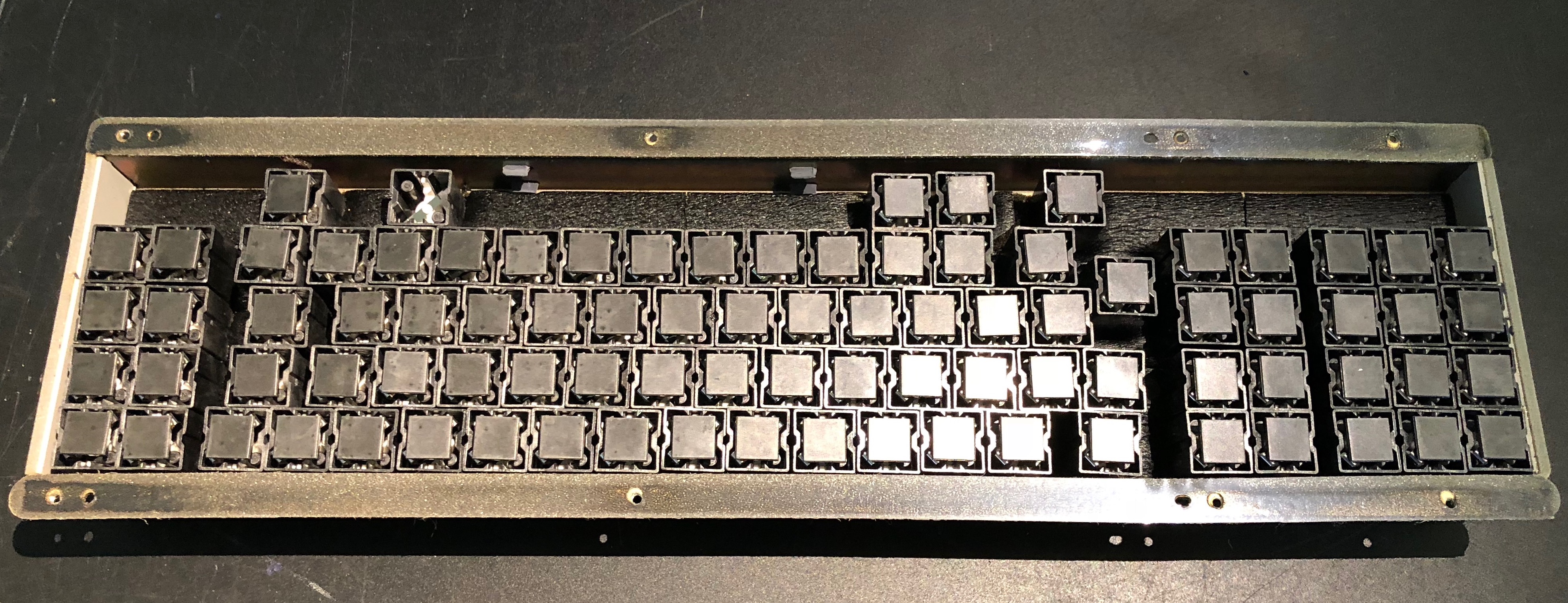

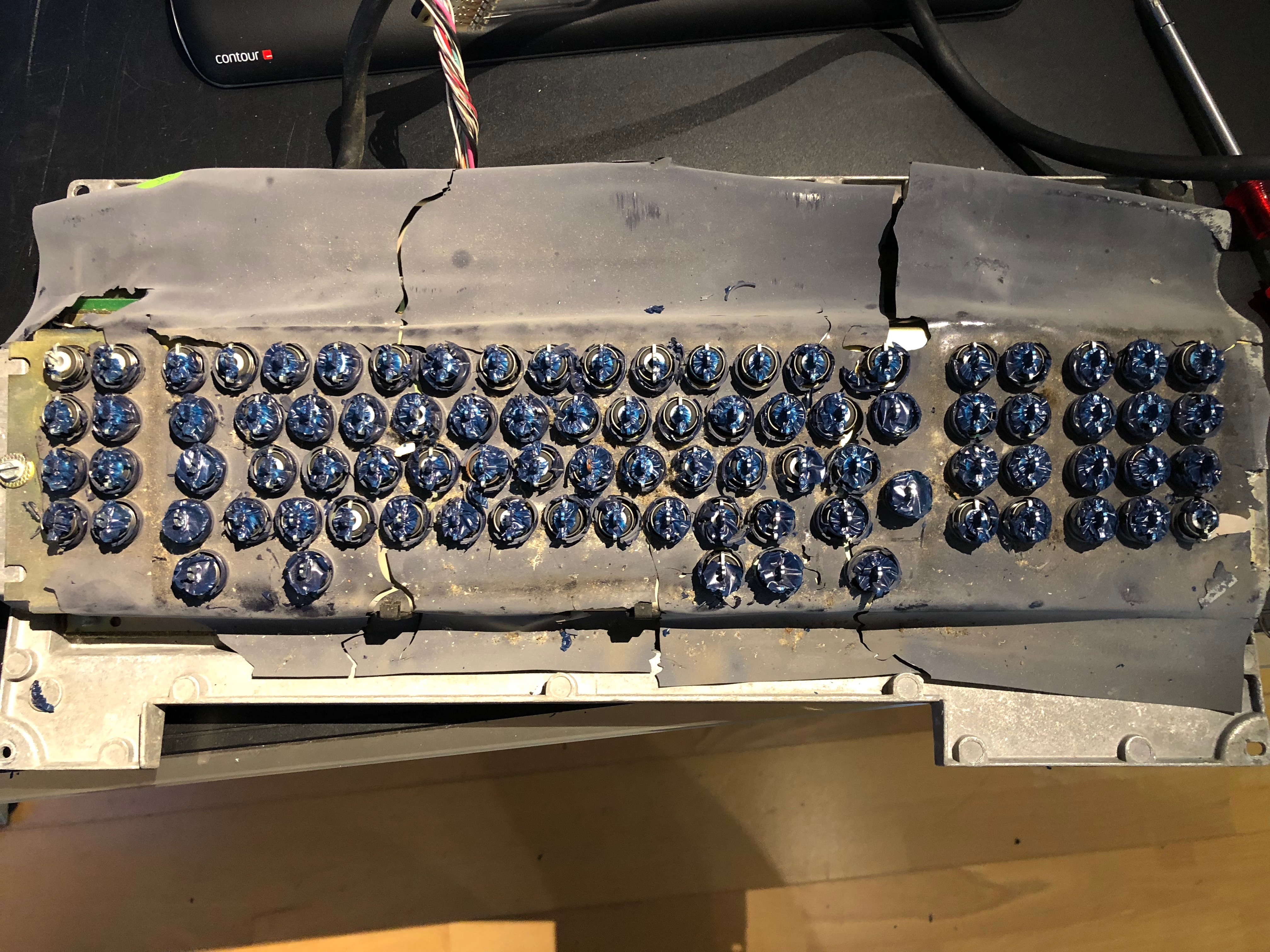

Remove all individual key switches by carefully wiggling them out. They should get out fairly easy. Place the switches on a cardboard or box and try to keep them in one piece (not a big thing if they fall apart, we will dis-assemble them anyway later on).
If you’re as “lucky” as I am, you will have a completely rotten foam that is looking like this:
Put the switches away (we will come back to them later), as we have to concentrate on the sad situation in the switch-plate first.

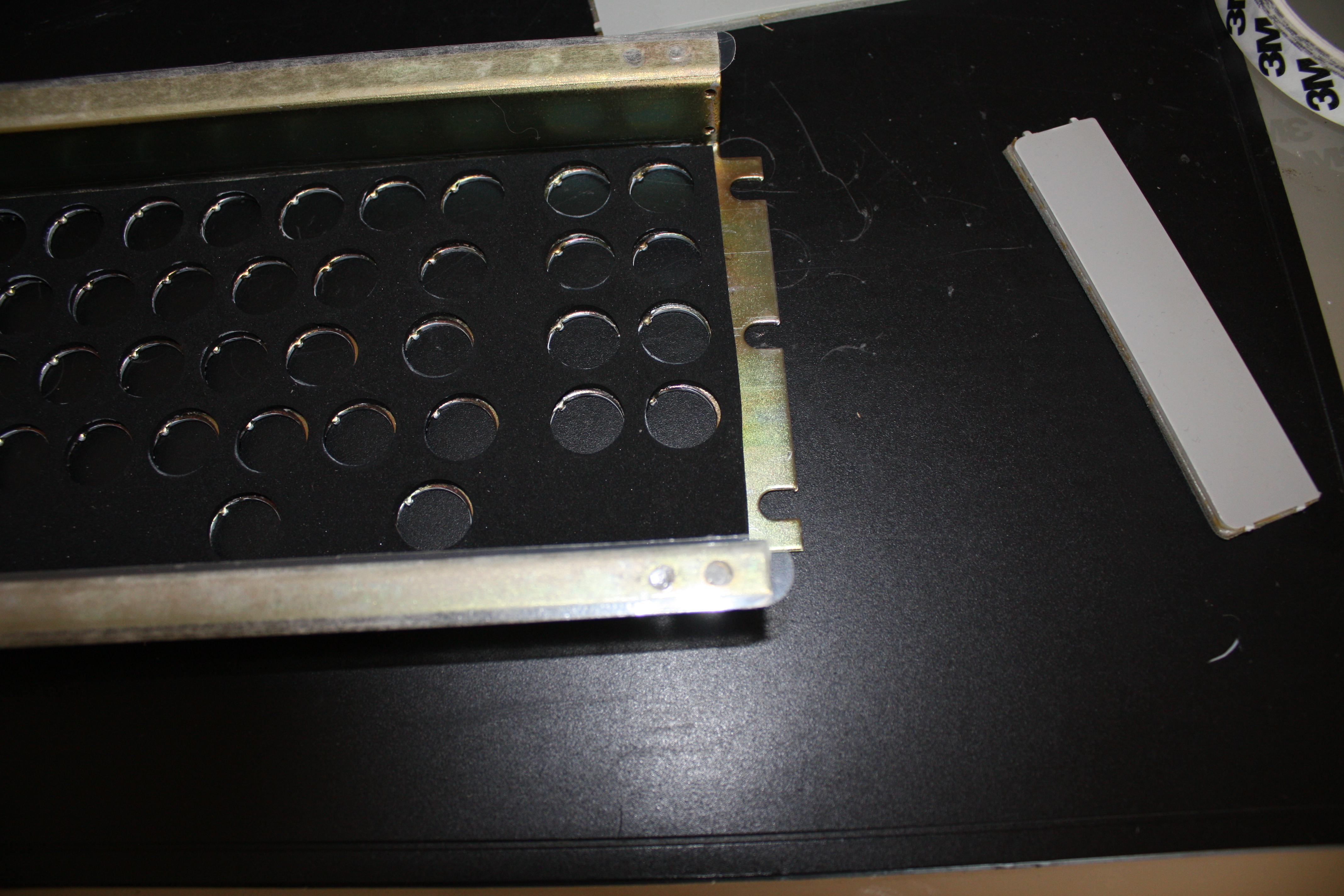

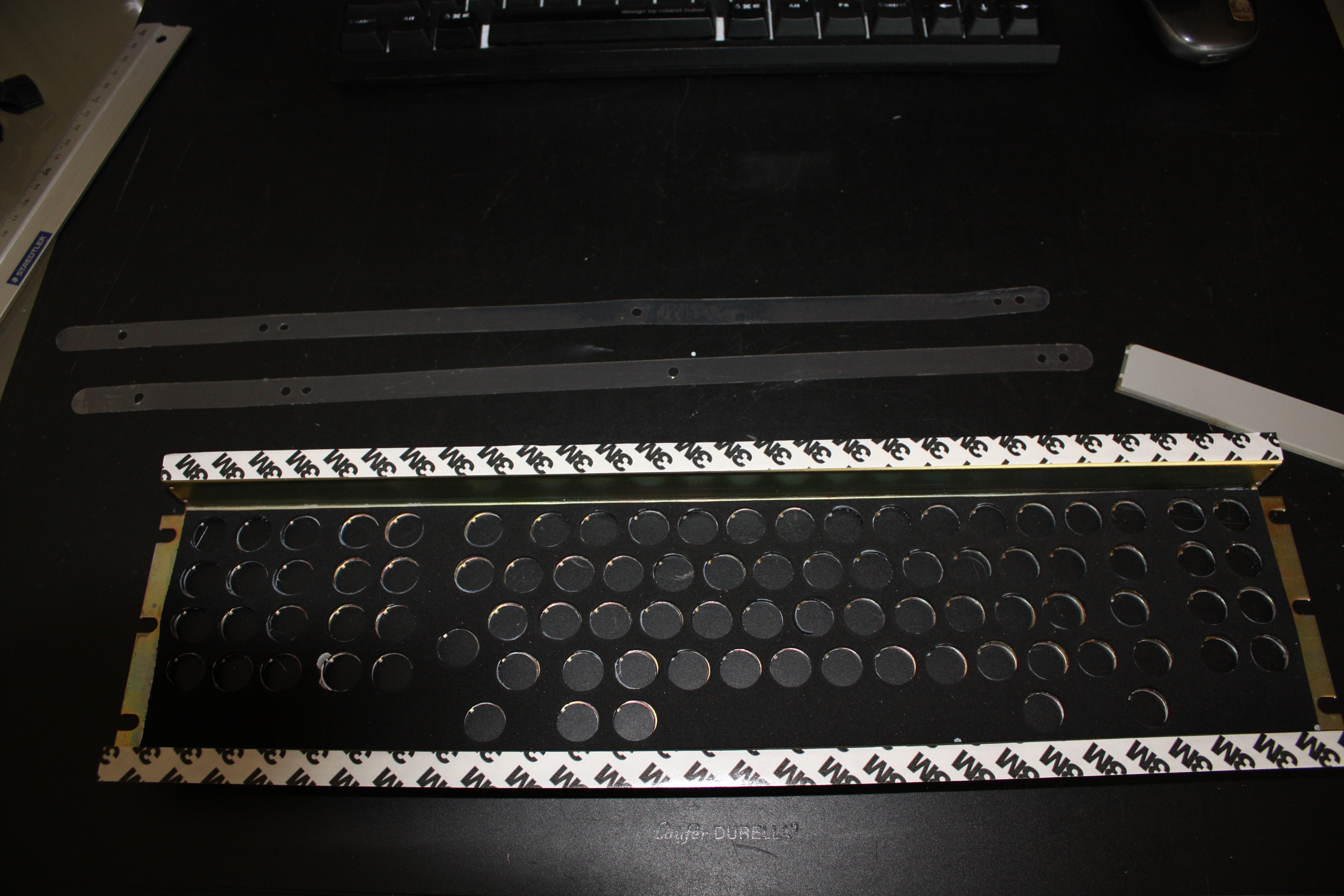

Step 1: Remove the plastic gasket strips
The plastic gasket strips are the ones which have holes for the screws in on each top ridge. I could easily remove them by slowly pull on them. Make sure you don’t rip them apart, but if they contain a ton of goo – don’t worry. Put them aside for now.

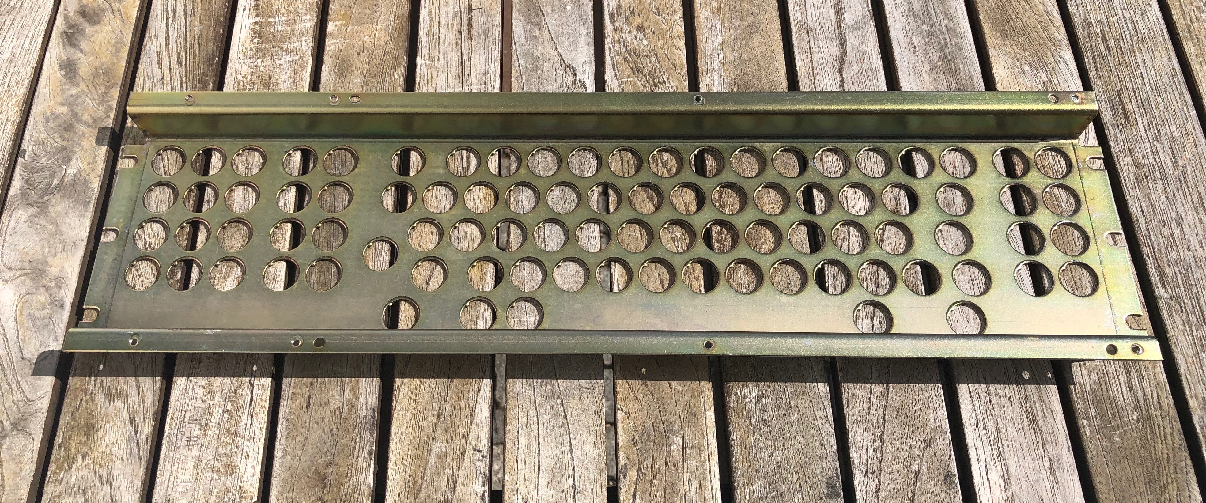

Step 2: Remove the two plastic separators on each side of the switch-plate. They are only clipped in and can be pulled away easily.

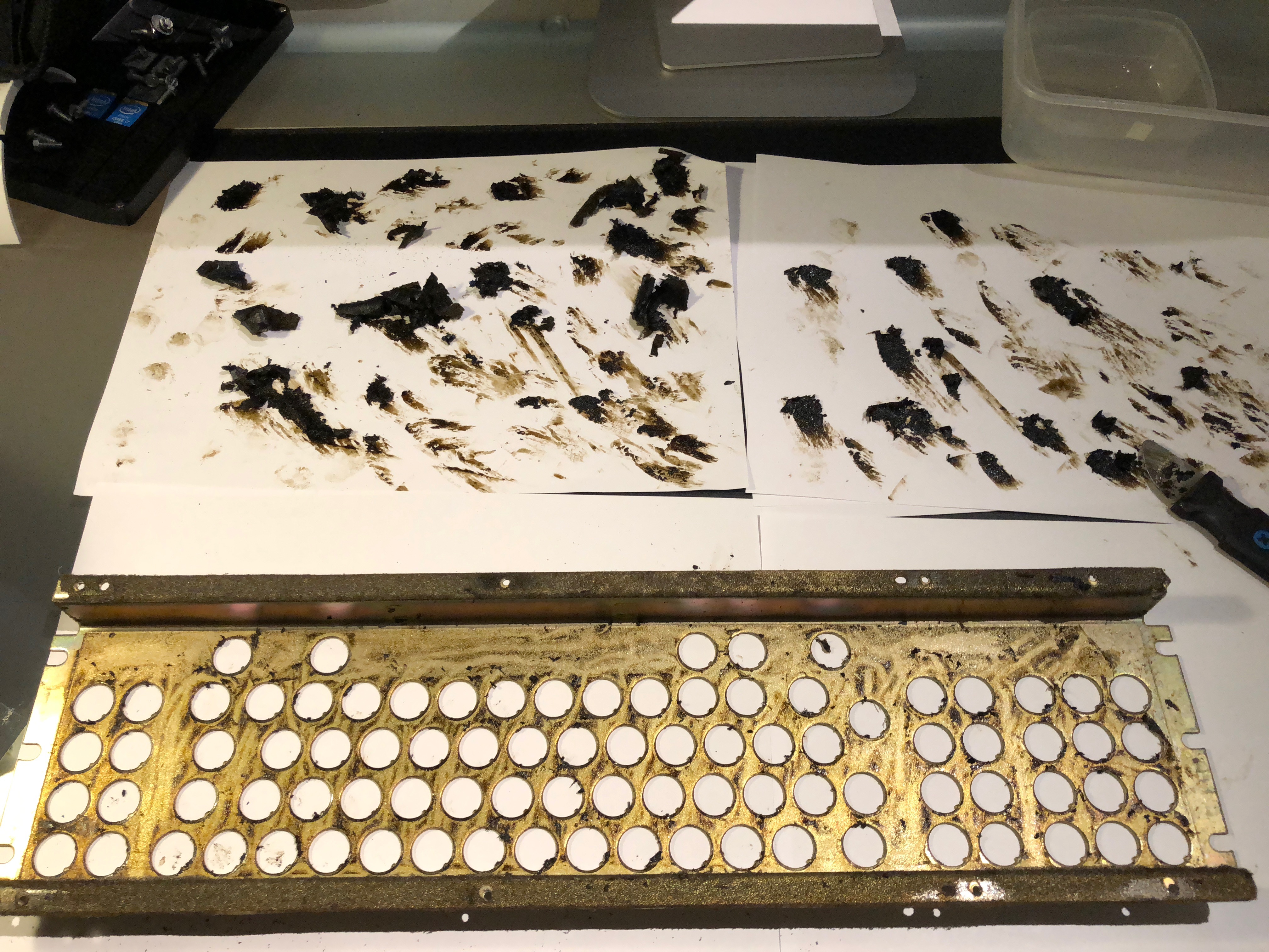

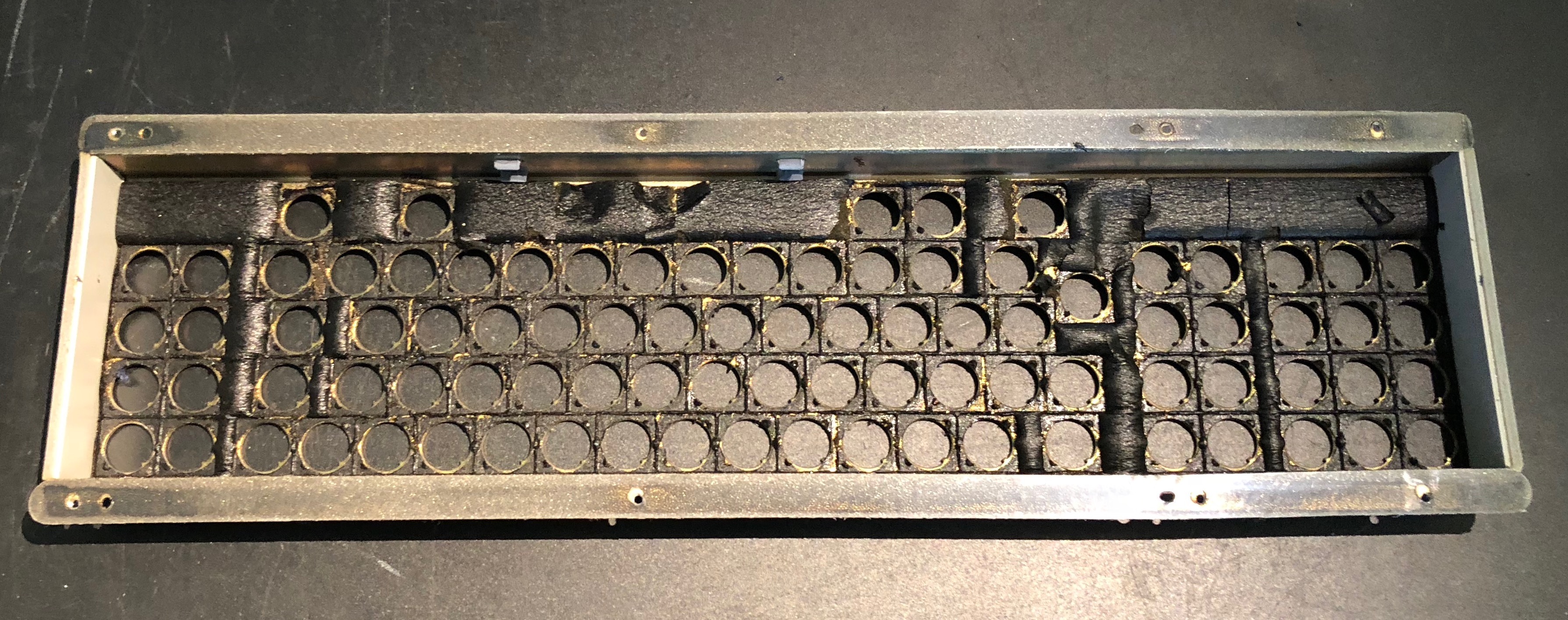

Step 3: Clean the switch plate (get rid of the foam)
The foam originally was on top of an adhesive plastic strip. There are two ways to remove the foam and strip. Either way, get gloves on first (believe me).
Either you use a heat gun and remove the plastic strip together with the rest of the foam (which would be the preferred method) or you do it like I had to do it (the foam was too much dissolved already).
I first removed the foam using a small palette-knife. Look at the picture and get disgusted. This was not funny. After I removed the black foam, I went with a heat gun. With the same palette-knife, I could remove most parts of the plastic strip underneath. Even when I was finished, the switch-plate was still full of goo.
Use Goo-Gone and apply it for 30 minutes. Let it sit and yes, get new gloves before doing so. I had to apply Goo-Gone two times. Do the finishing touches with alcohol and rinse it finally with a lot of water. At the end you should have a switch plate that looks as shiny as this:
Step 4: Back to the plastic gaskets
To get rid of all the glue and dirt from the two strips, place them in a bath of Isopropyl Alcohol. Make sure they are completely soaked for at least 20 minutes. After that, take a cloth and spend a lot of time and effort to make them as clean as possible.

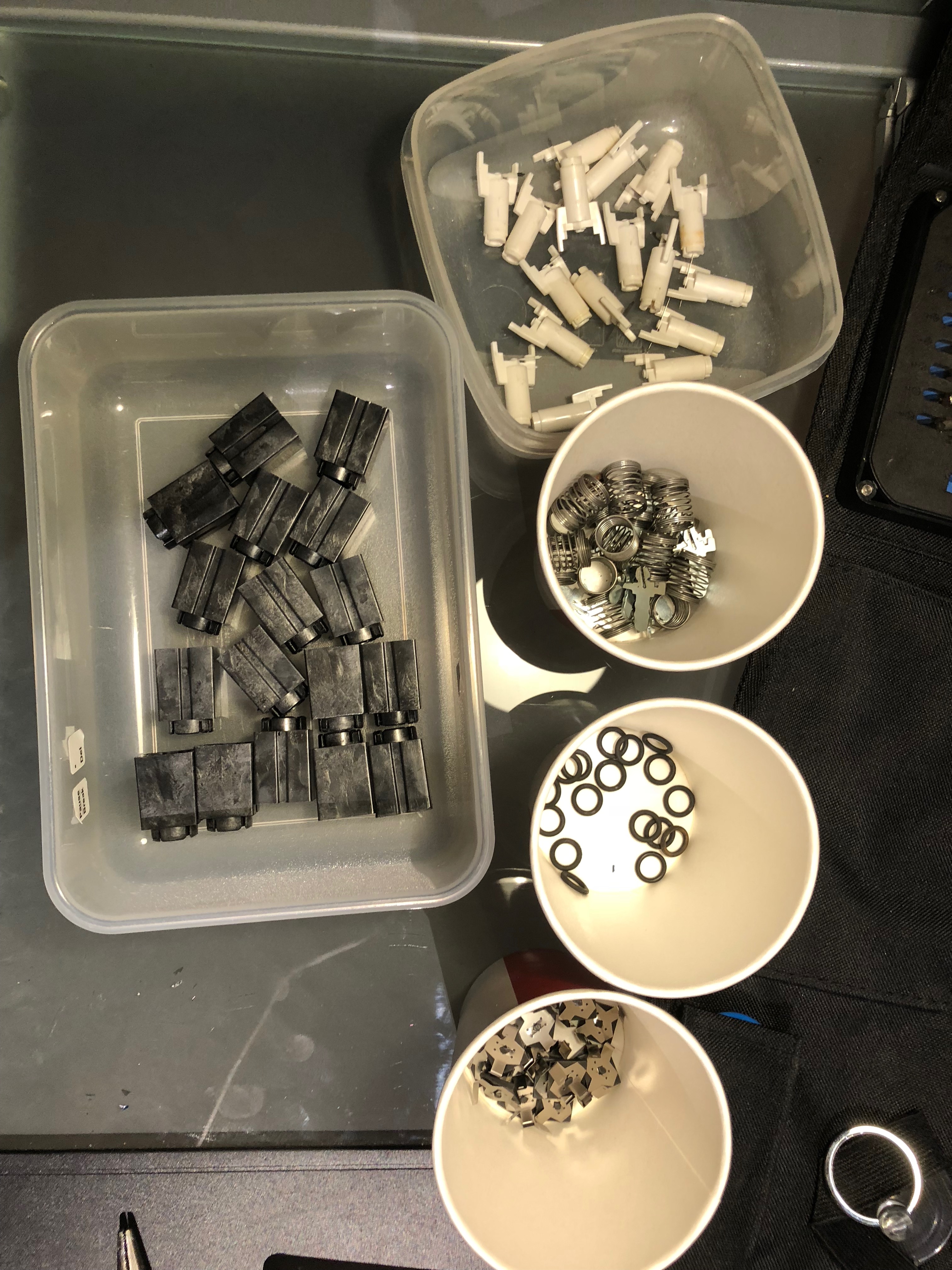

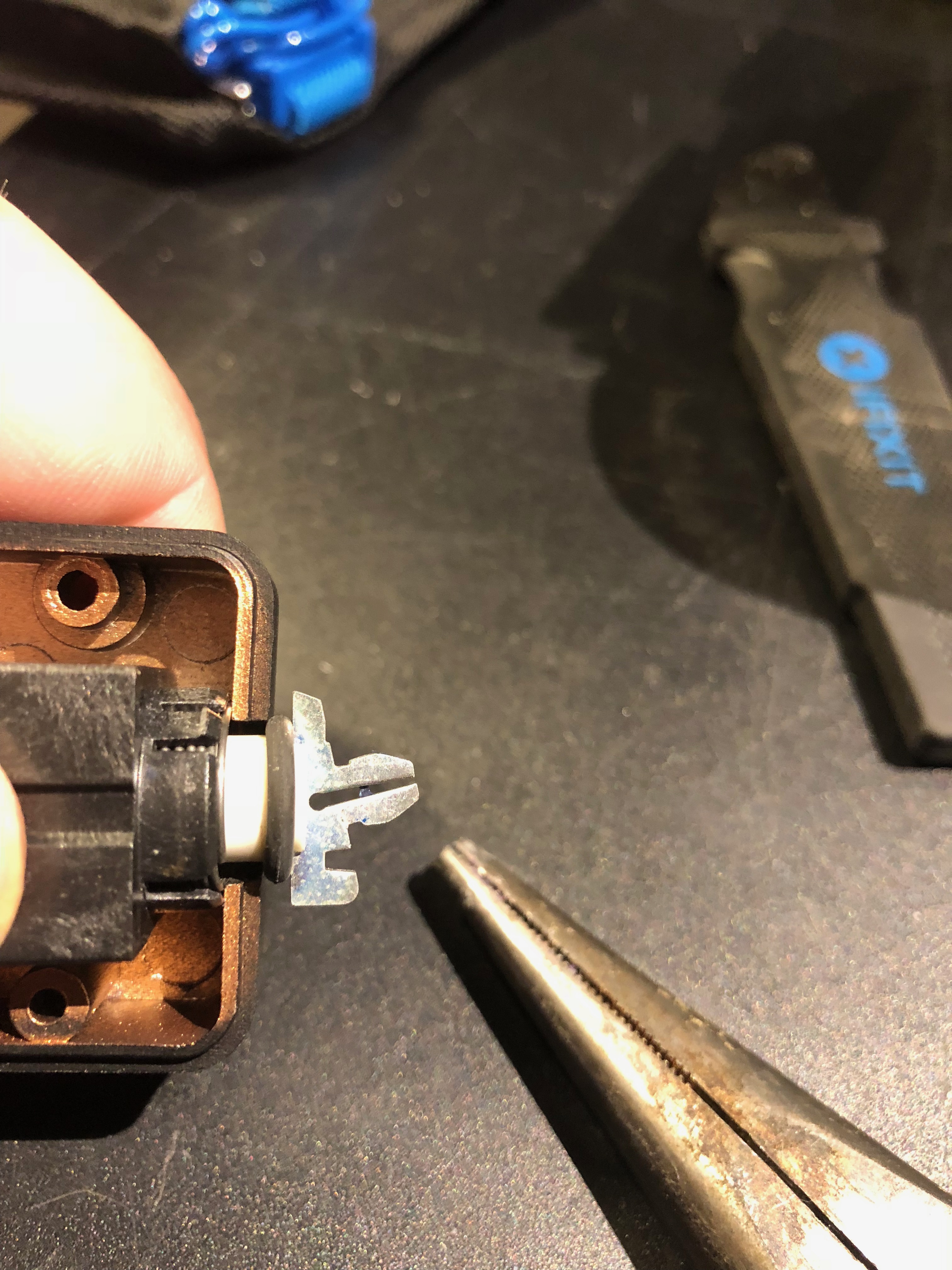

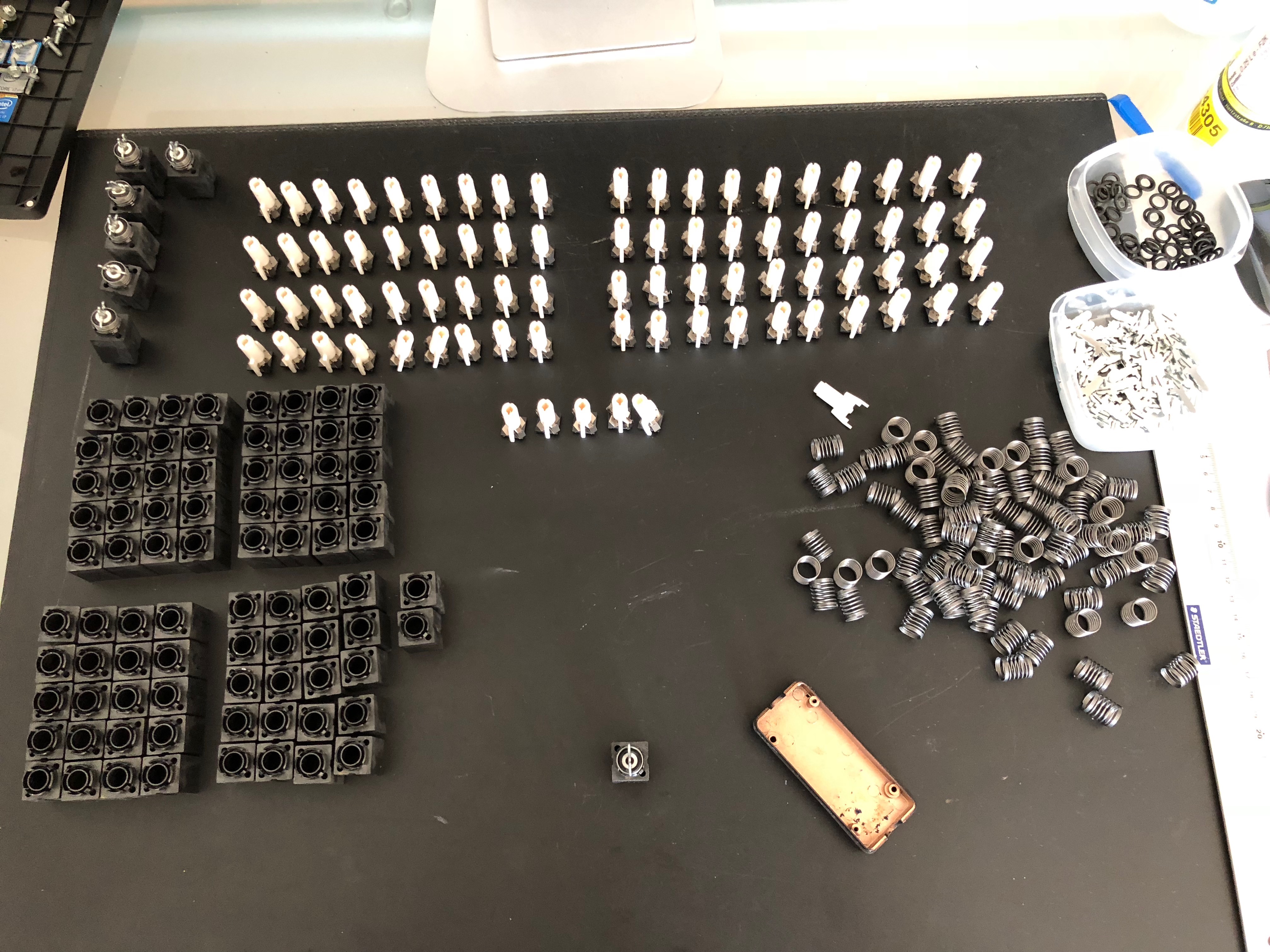

Get 5 or 6 boxes ready for the parts of the switches. Switch housing, white slider with beam spring, coil and metal stem, O-ring, Fly-Plate.
Below is a picture on the different parts of the switches. I will explain how to take them apart properly.
Taking the Switches apart:
There are multiple ways described to take the switches apart. For me, the easiest method was a plastic box which could be taken apart. I drilled a hole into one end that had the diameter of 10mm. This box is only to get a better grip and limit the possibility of damage to the switch (yes, they are expensive).
Now, place the switch in the one half of the box, so that the metal stem and O-Ring are on the outside and the rest of the switch on the inside. Then take pliers, grab the metal stem and pull on it (sometimes as hard as you can). The stem will slide out and the whole switch can be disassembled. As I had to do this about 90 times, I spent half a night on this task. Next, put all the different parts into the various boxes above.

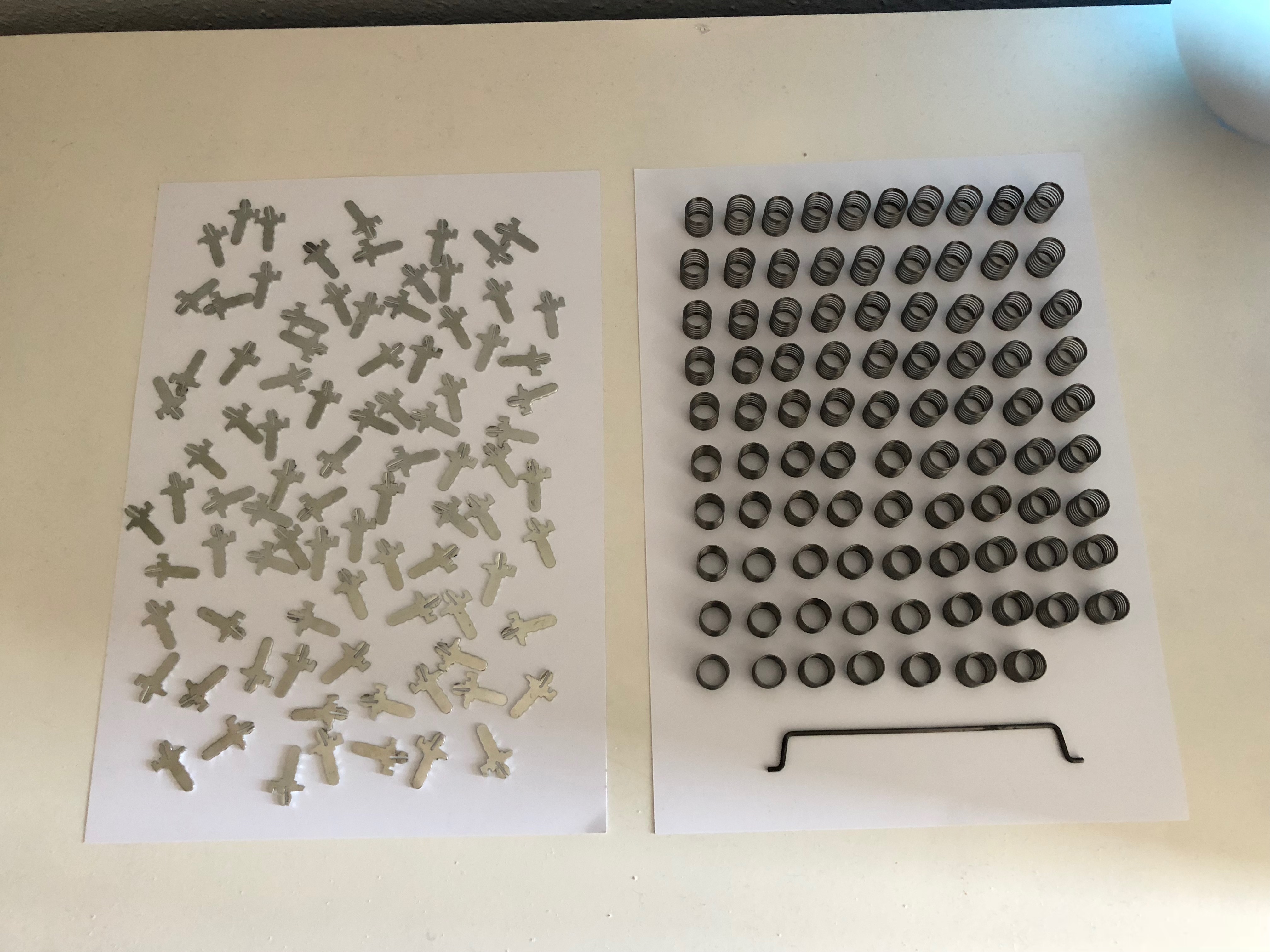

Coil de-rusting and cleaning (+Metal Stems):
Some of my coils have not only been dirty, they also have accumulated rust. Even, if you don’t see rust on your coils at first sight, the de-rusting is super important.
First, clean the coils in mild soap water and make sure that they are dried right after the bath. I cleaned the metal stems at the same time but also used a brush to get rid of the plastic shield sticking to it.
Put about 25mm or 1 inch of Evapo-Rust fluid in a plastic box. Add the coils, stems and space bar wire to the bath and leave them in there for at least 30 minutes. I left them in for several hours. I was amazed how much the coils did change during that time (for the better).
After the evapo-rust procedure, I cleaned them with demineralized water and let them dry in the sun.
After they have been dry, I put a layer of Ballistol on the parts and let them sit for a day before I used a paper towel to get rid of excessive oil.

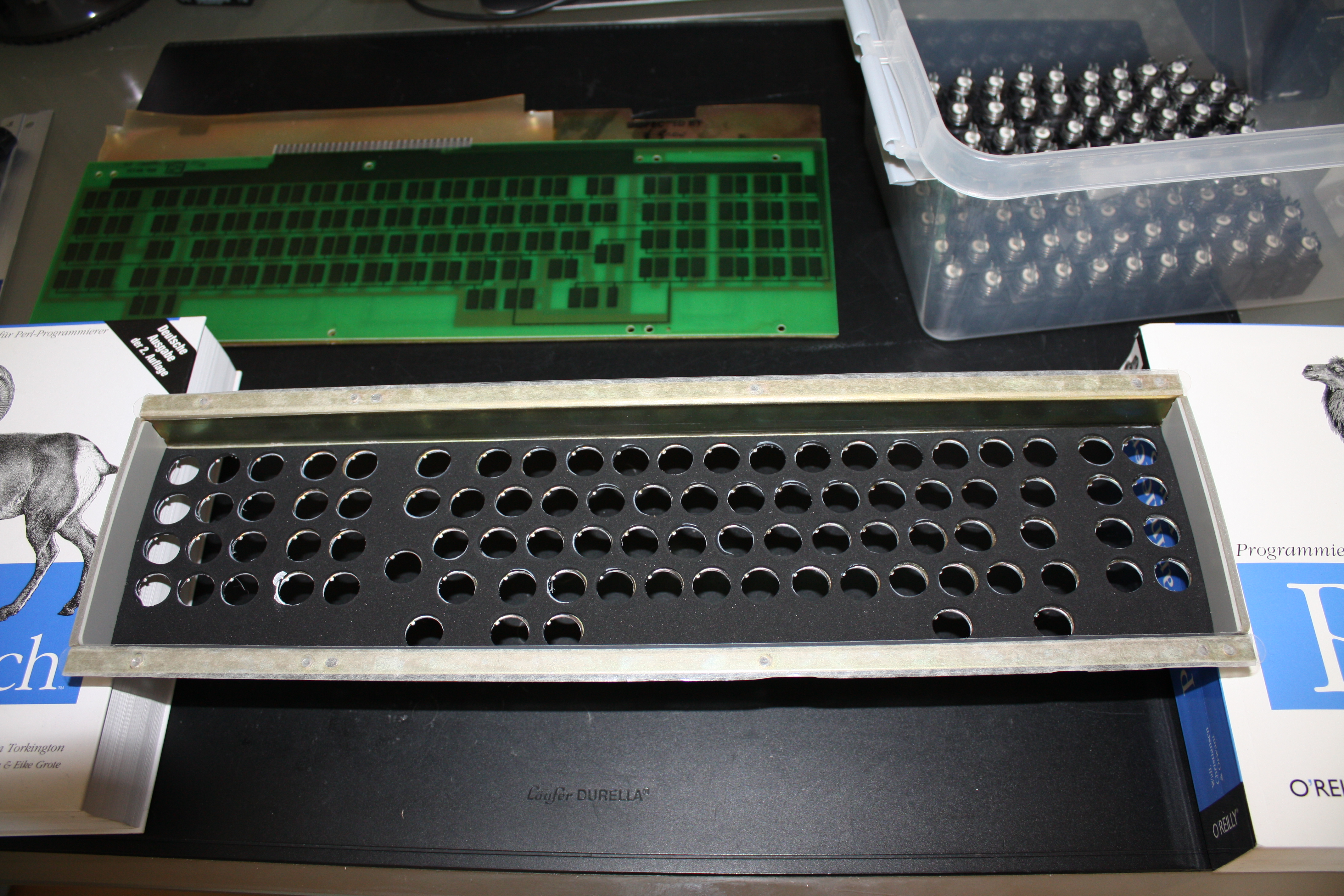

Replacing the foam
Replacing the foam is one of the most important tasks that you need to do. Especially, if the keys are wobbling around. I also found out that the sound is very much dependent on a proper fitting of the switches.

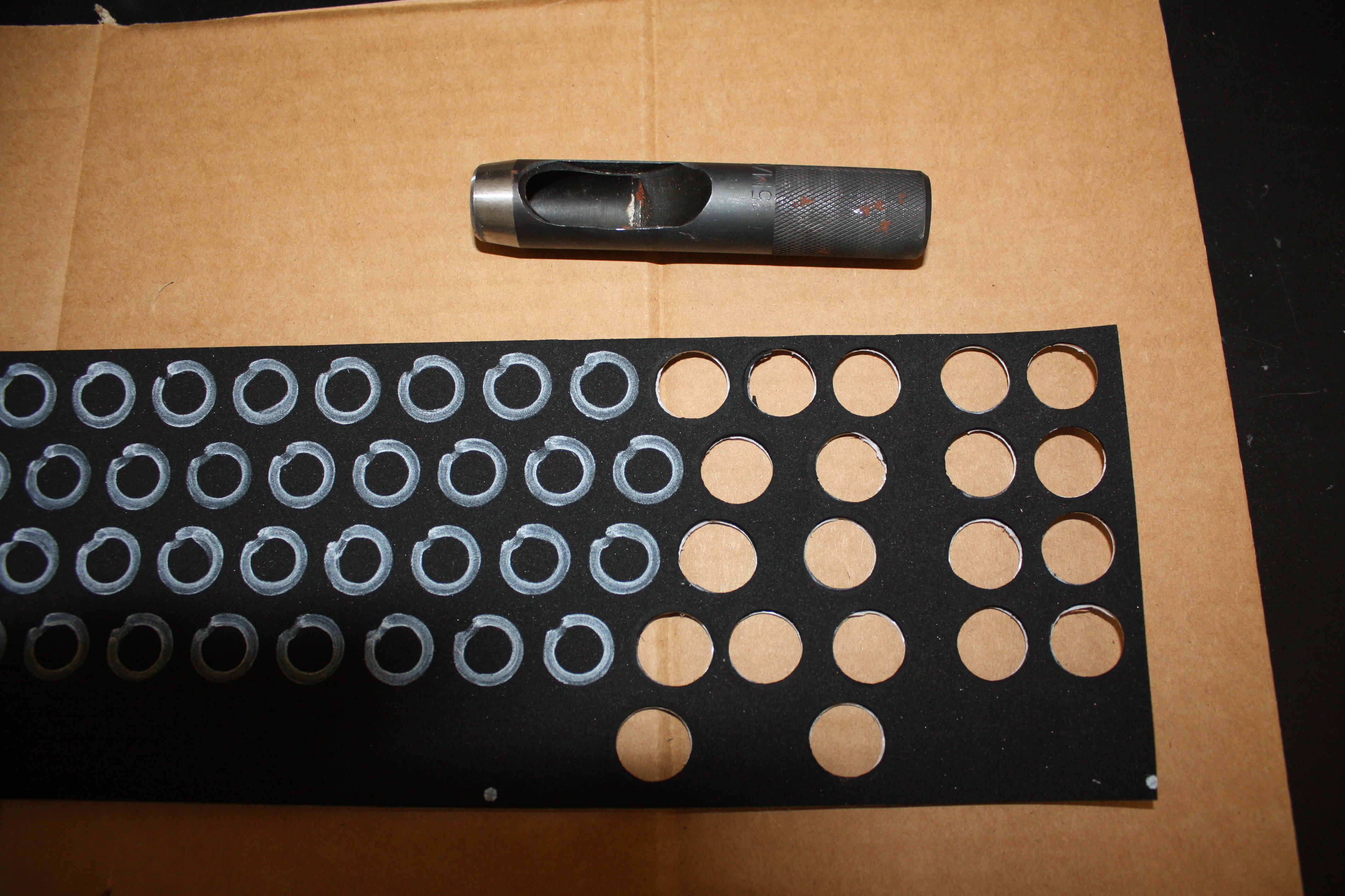

First of all, you need a foam that is cut to a size of 435mm by 100mm (2mm thickness). In my case this was simple, as I already had a 100mm wide band that I only had to cut at 435mm. I used a Guillotine cutter for this to get a very straight cut.
Next, I placed the foam underneath the switch plate so that the side of the foam was looking towards me. You need to align the foam perfectly at this point and I used glue strips to hold it in place.

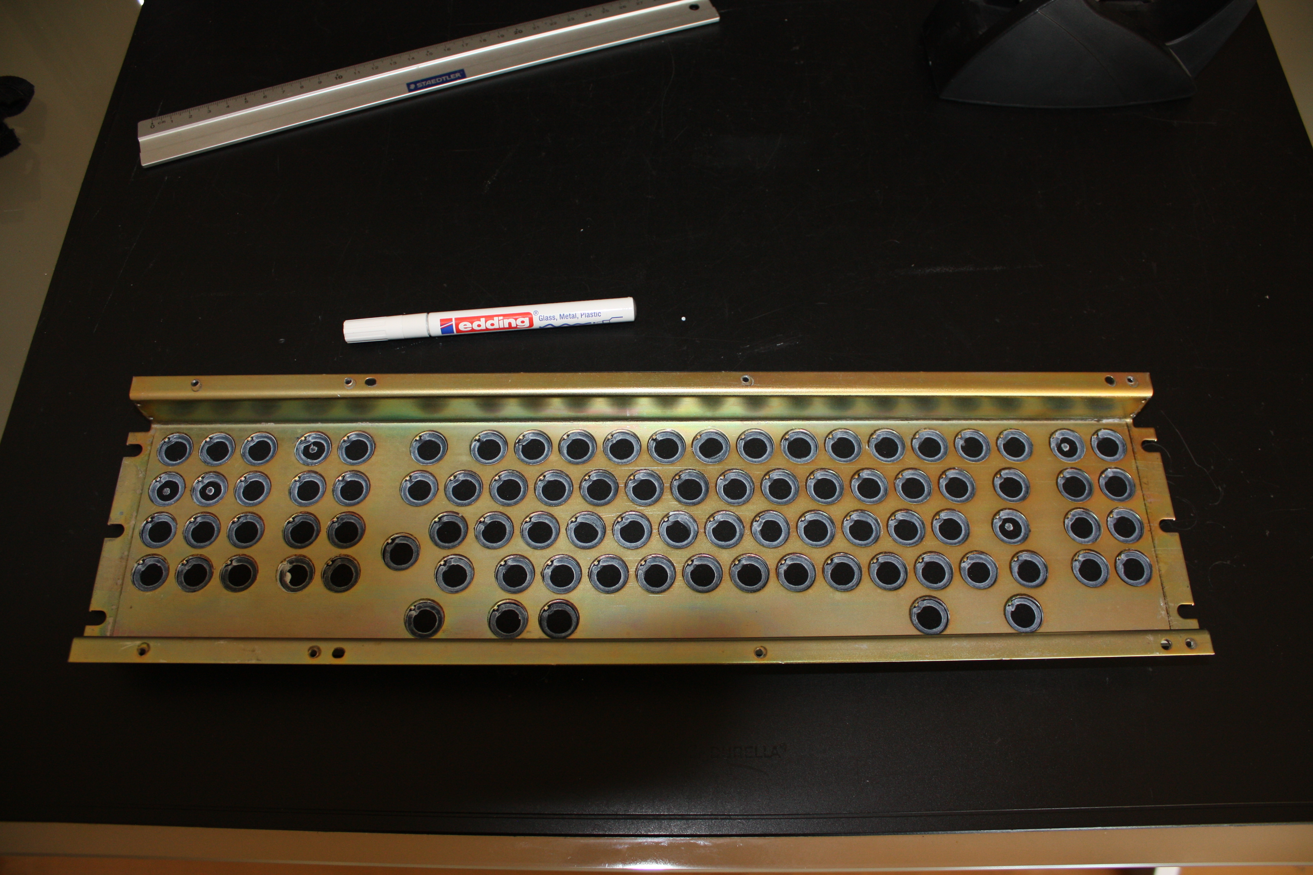

Next, I turned the switch plate around and started to mark every hole with a white marker on the foam:
Once every hole is marked, the switch plate (template) can be put away and we can concentrate on the foam.

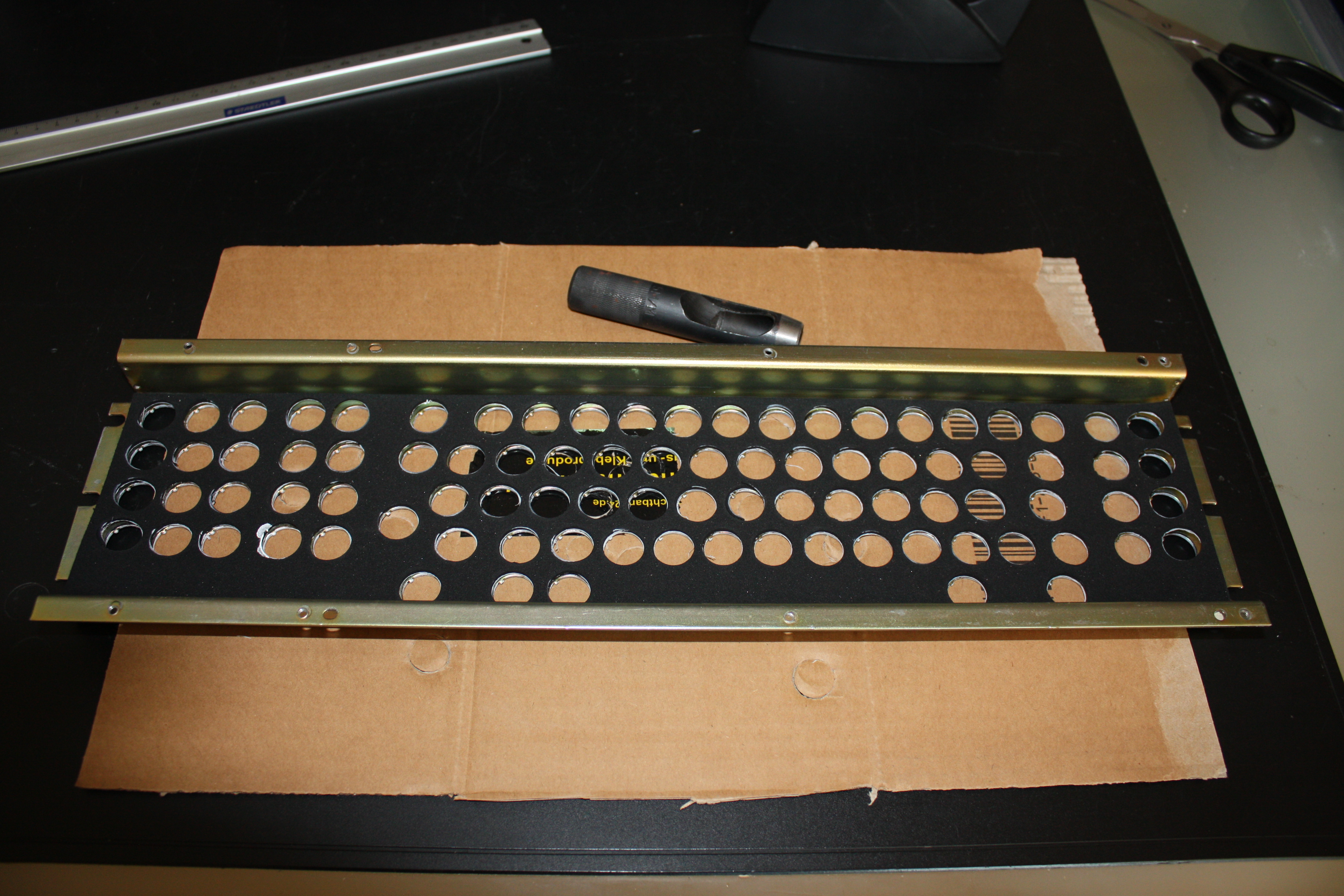

Use the 15mm Steel Hole Punch, place it on top of each marked circle and punch out the hole. In my case, I only had to put some slight pressure on it and wiggle it a bit to punch the holes into the foam:
Once all holes are punched, I removed the adhesive protection and glued the foam to the switch plate like shown below.
Attach back the plastic gaskets
I used double-sided adhesive strips to glue them back on. First, I placed the double-sided strips on the edges like shown below:
I removed the adhesive protection and placed the gaskets so they line up with the holes (at this time I also added back the plastic side panels):

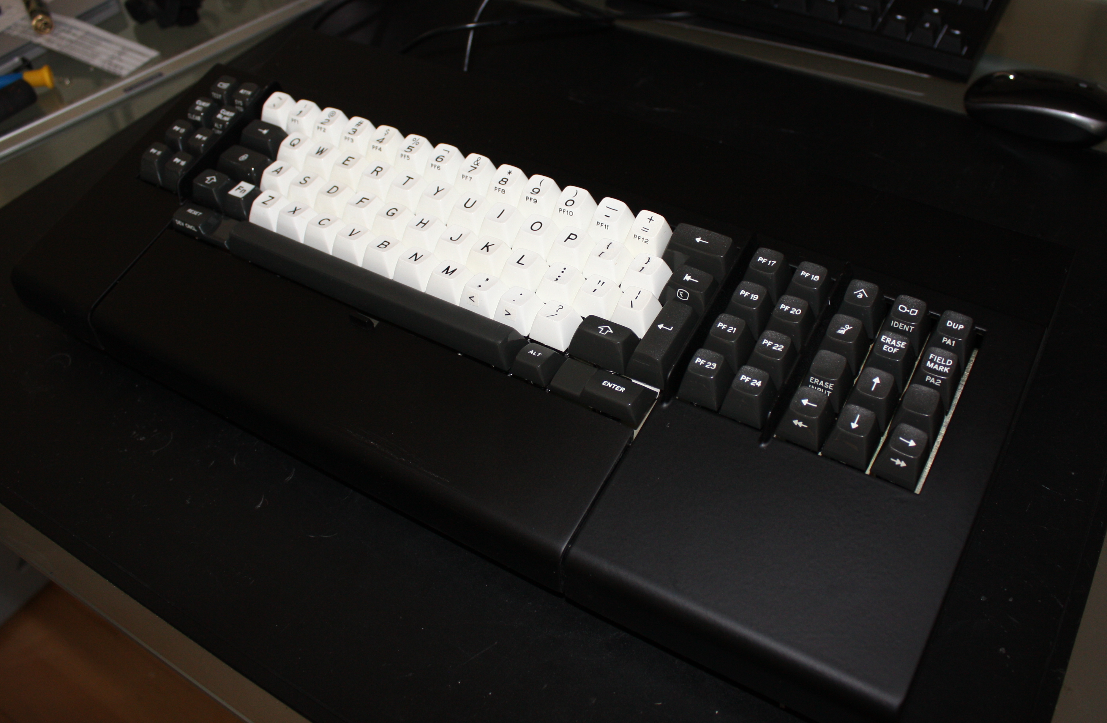

The re-assembling of the keyboard should be straight forward at this point. Add the keycaps back and you might want to give the case itself a nice paint job as well.

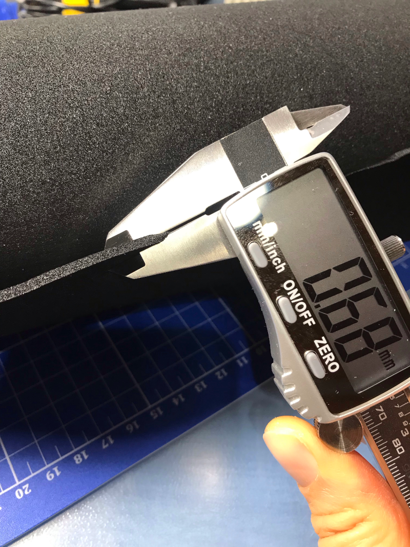

Can you link me the foam you used? I am having trouble finding 2mm thick. I have thin adhesive tape if you can't get the adhesive version anymore.
I did get a sample of 3mm EPDM locally to try, and it's very tough and not very compressible. Is this expected?

This is the 3mm thick stuff, compresses to less than 1mm easily. I think that I really ordered 2mm thick, they messed up the order and received 3mm thick but it is really OK anyway.
