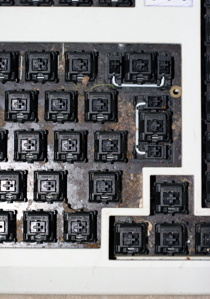

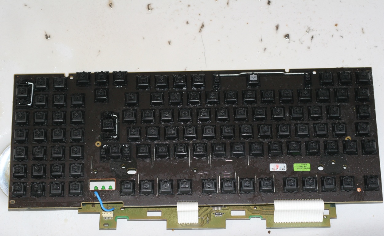

Hi,
I have got a problem with a really dirty G80-1800: I don't have a clue on how to get this thing clean. I already cleaned two boards, but the dirt there was mostly dust, but this time it is way more nasty. I suspect dust + coffee/coke or something, which somehow transformed into a cement-like substance in some places on the PCB. It could also be something else entirely, since the board is from a pharmacy, I suppose, but I somehow feel more comfortable in believing it's just some beverage that was spilled there...
Below is a picture of the PCB with the switches. The caps are already experiencing their 4th (or 5th) hour-long bath in washing-up liquid and will spend the night with some lovely dental cleaning tabs, but I don't have a clue concerning the cleaning of the PCB and the switches. Any suggestions?
Btw: I already vacuumed it before I took the photo, so some of the big chunks are already gone. Oh, and if Ascaii happens to see this thread: That is the white G80-1800 you sent me, you already warned me about. :mrgreen:
The board in question. It's just nasty, really.

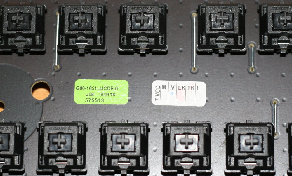

Below are the pictures that somehow document how I cleaned the board in question. I added some explanations directly to the attachments.
I, by the way, only did one cleaning session, as the PCB was really clean after the first run, which I could only really see after the PCB was completely dry, which didn't take very long, as the whole process did not involve a lot of water.
The steam cleaner I used looked very similar to the one you can see in this picture, although mine (or better: my parents') is red. The vapour stream the steam cleaner produced really was rather dry, because the steam was so hot and was released under a rather high pressure, I think. Nonetheless, I could regulate the steam pretty well, simply by varying the distance from the nozzle (I didn't use any kind of attached brush, only the steam) to the parts I wanted to clean. Keeping a high distance, I could easily blow off the remaining dust (yes, the steam was dry and fast enough to blow off the dust and did not moisten the dust in a way that it stuck to the PCB), while at a low distance, the steam cleaner almost behaved as some kind of high-pressure water blaster, although it only released a bit of liquid water when I didn't pay enough attention (after a couple of seconds of not using the steam cleaner, some water gathered at/in the tip of the nozzle due to steam cooling down).
After the first run of steam cleaning and after letting the whole thing dry for about 3 days, I detected some dirt that didn't come off. The dirt stuck to the switches, but only in a very loose way, so it could be brushed off by a paintbrush. That there still was some dirt left was (I'm almost certain of that) the result of the cleaning method itself. As I could only blow the dirt around on the PCB, some dirt naturally managed to hide in some gaps, but since this dirt didn't have this cement-like consistence any more, that was not really a problem. I could have probably got rid of it with the steam cleaner, as well, but I simply oversaw some dirt due to poor lighting conditions and the dirt transforming into some kind of dark jelly when it was unloosened by the steam.

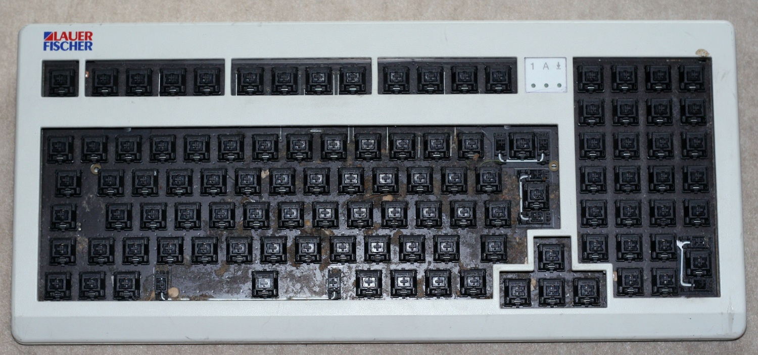

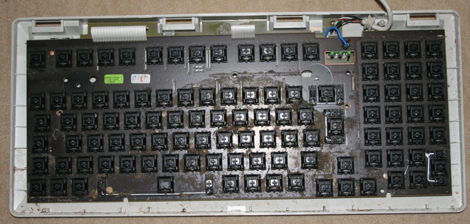

A picture of the complete keyboard without caps, before steam cleaning, after vacuuming.

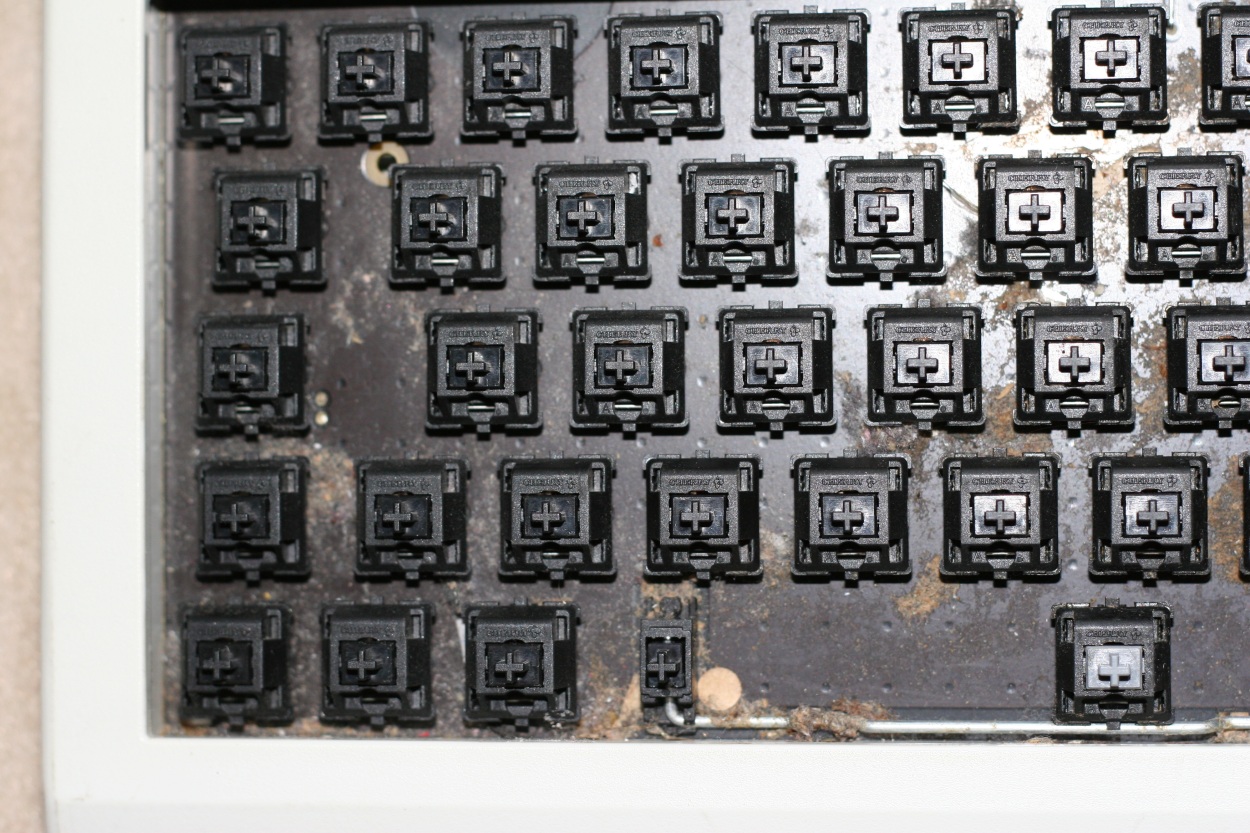

A detailed picture (01) of the dirt on the PCB, before steam cleaning, after vacuuming.
A detailed picture (02) of the dirt on the PCB, before steam cleaning, after vacuuming.

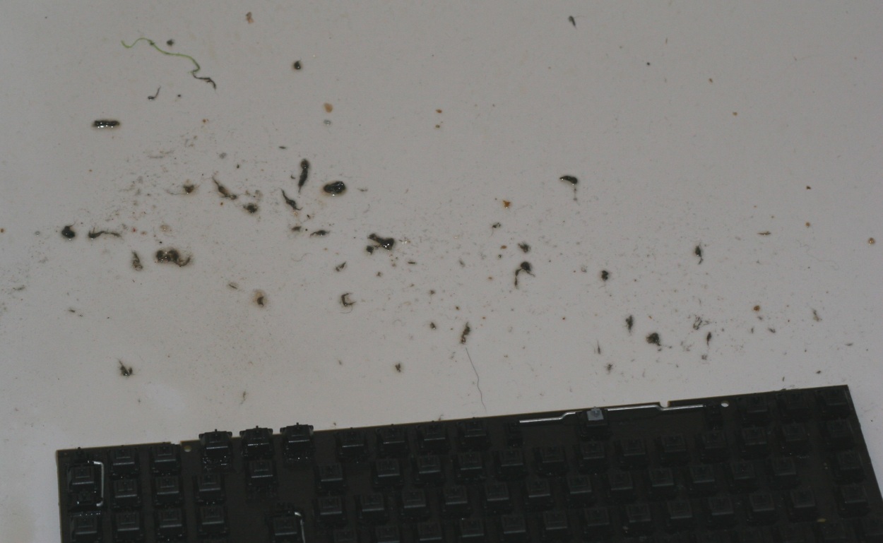

A picture of the steam cleaning process, showing the PCB in a shower base (I didn't know beforehand how much water would really be involved, and I didn't want to spread the dirt everywhere) and some of the dirt that came off. As you can see, the whole cleaning was relatively dry, at least in comparison with bathing the whole PCB.
Some more dirt in the shower base... Lovely, isn't it? :D

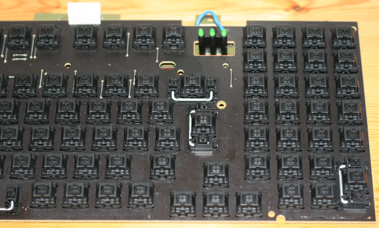

A picture of the clean and dry PCB, showing the left side with the switch for the spacebar (grey switch), after I tried to lubricate some of the switches. The shiny parts of the PCB (bottom left corner and the area near to the spacebar stabiliser) are the result of me smearing some of the silicon oil on the PCB by mistake and clumsiness...
A picture of the right side of the PCB after steam cleaning. The things that look like scratches (amongst the switches) are "residues" of the hairs that didn't come off, because of the steam cleaning, since they somehow sticked to the switches as they were wrapped around them. I removed these with a paintbrush, tweezers and a vacuum cleaner after the PCB was completely dry. These "residues" could probably have been removed very easily by wiping (so no damage to the PCB whatsoever), but I was too lazy to do so.
A detailed picture of the stickers on the PCB, showing that the cleaning was indeed rather gentle, as they weren't damaged.

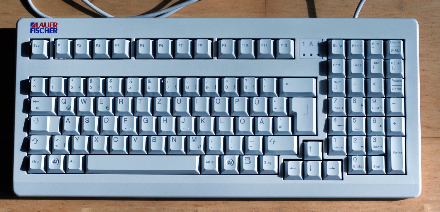

A picture of the whole keyboard after cleaning (the case was cleaned "the traditional way" with a washing-up brush and neutral soap), before I put the caps back on, while I was still full of hope considering the switches...
The clean board (top) with the keycaps back on. I got rid off the really nasty stains by a lot of rubbing with petrol, by the way.
