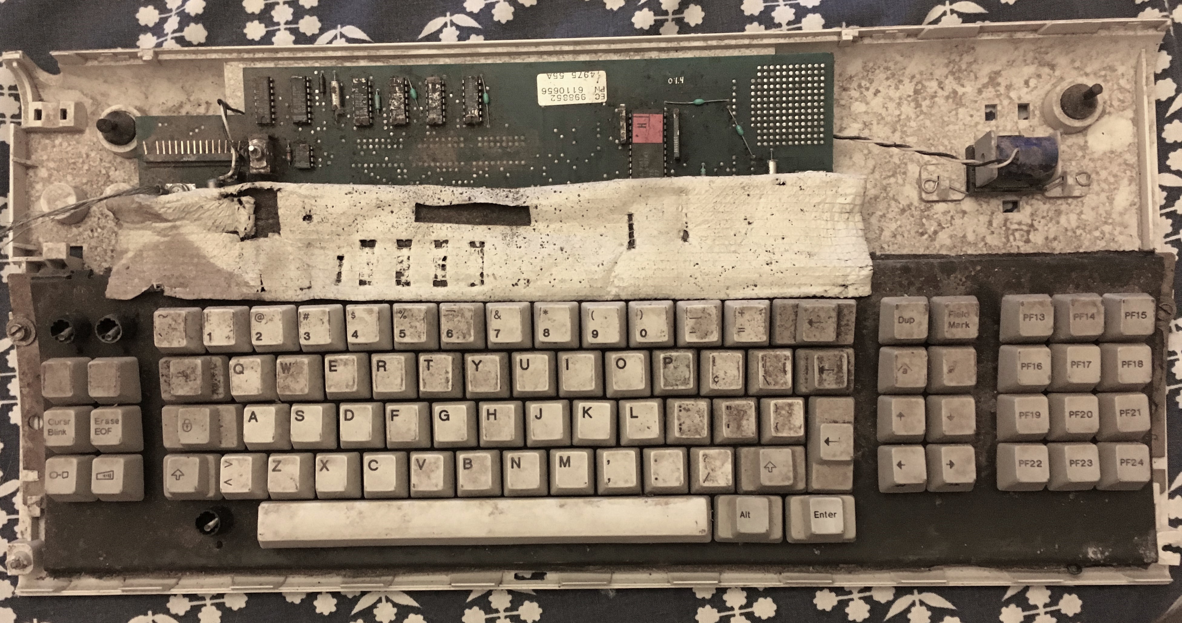

Only ever seen a handful of these converted, so thought I would share this one and give the old Model C some love.
So this is probably the most oft-maligned member of the Model F family. Little more of a pain to convert, case doesn't like to be shipped like the F122 but worse, needs a new armature for the blue switch to have a place to sit and work, and a layout that belongs to late-70's terminals more than anything.
Fortunately, I love late-70's terminals and use this kind of layout more than anything so it's a natural fit, doubly so since it's basically a Model F of my 3278 beamspring. :D
This one was no exception to the stereotype in having all but one of the internal screw mounts busted and a missing spacebar. The side was even held together with duct tape. Only thing that really disappointed me though was it had outlines of the extra feet on the back which meant it had them on for a long time they were lost by the time I got it.
Duct tape removed
Foam still good. I love that about these models and the XT's. So many of them have the stuff that's good practically forever.
Module removed. I had to sand and repaint the barrel plate but the backplate is immaculate.
Original controller removed and excess foam trimmed from module.
Now repairing the case. I used the usual heavy duty epoxy for a couple hairline cracks and reassembling the jigsaw puzzle that was the right side keyboard screw mount. I also reinforced the weak spots on the mounts with putty. You can't see it with the module in.
For the top I was able to reuse the brass insert that survived and used an M3 nylon standoff for the other. Both solidly encased in blocks of epoxy putty that also reinforce the corners. Side effect is it makes where you rest your hands on the board when typing feel way more solid. I recommend anyone with one of these does this reinforcement, not just for the reinforcement but because it fixes so much about the perceived flimsiness of the case.
Also, notice the top door for the dipswitches is melted shut. Didn't feel like cutting it back open because there's nothing there you'd actually want to get at anymore.
