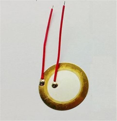

I truly wonder what this is, I would have said it was for a speaker if there was holes for the sound to go out, but there isn't, so what could this be for ?

The round socket was probably for a piezo transducer. Depending on what it was connected to it could have beeped or clicked, either as feedback for a keypress, or as a "bell" (Teletype term) to signal the operator. Yes, I'm dating myself; don't tell my wife! A piezo probably wouldn't have been used on a PC keyboard (although I think some early Zeniths had one). More likely the same case was also used for a terminal application.
The 2763 IC is definitely an EPROM. As keyboards got cheaper and more mass produced the ROM was more likely to be uh, integrated into the controller. The folks who weren't there at the time really have no idea how the computer industry exploded. In just a few years it went from thousands of computers being sold in a year to millions. So the early keyboards are literally thousands of times rarer than what came later. And of course the early stuff was more primitive, (usually) better built, and much more expensive. The separate EPROM was probably used because they didn't build enough of these to justify a dedicated controller.
I see, interesting to see that an EPROM means that they didn't build enough of them to justify a dedicated controller, but that enough were made to be made into a terminal version. There is so little information in this keyboard, I truly wonder where it came from, and what kind if terminal is was used with. I have so many questions about it now hahaha. I really am glad I got to learn that it was an EPROM, I feel like it makes this keyboard special since it's from the PC-era but something that was used earlier. that mix of technology is very intriguing !

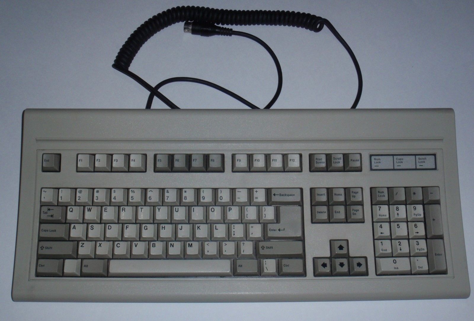

The big arrows suggest Datacomp. It reminds me of a Monterey K103, but it's not quite the same. The terminal thing is just a guess, but that was a more common place to find a beeper or "bell" than a PC keyboard.
Monterey/Mtek K103
Monterey/Mtek K103
Myoth
15 Sep 2018, 23:33
This is true, it does look a lot like this Monterey K103, even more so when the profile seems to be the same as Monterey and Zenith keyboards. The lock light sticker is even very similar. Which confuses me even more, I have no idea where to get inofrmation from this keyboard and there are so many hints, it's overwhelming in a sense.
