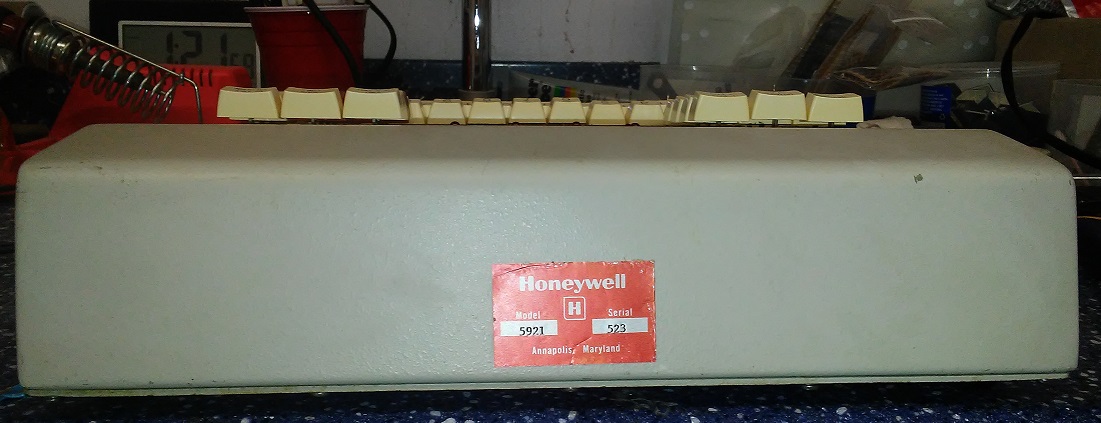

I was able to pick up this rather interesting old board. It's from the Honeywell VIP 5921 terminal. I haven't been able to find out too much about it, though it was from the 1970's according to the epocalc computer models database.

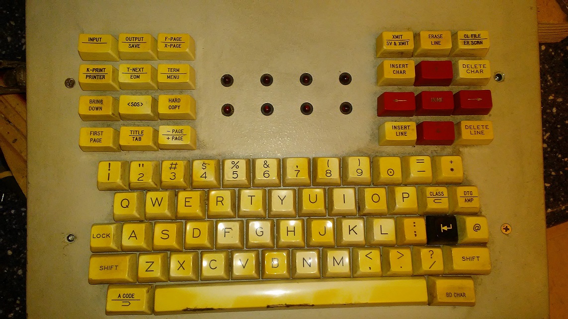

It was pretty yellowed and dirty:
Caps off and case removed:

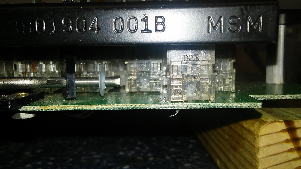

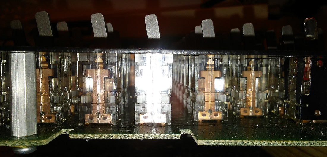

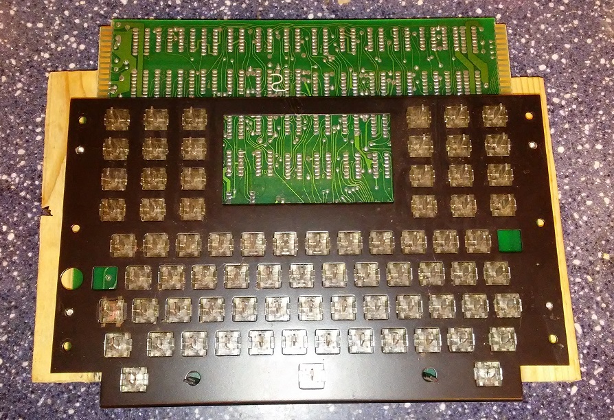

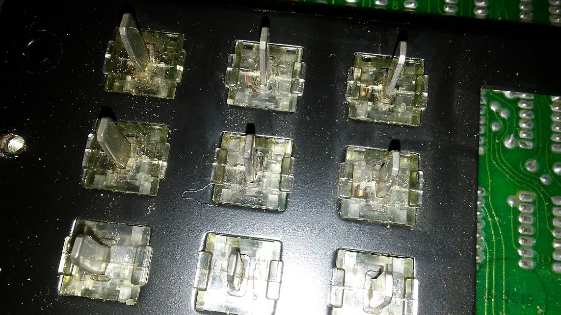

The switches are made by Oak and are ones I haven't see before:
Oak Switch_small.jpg (235.56 KiB) Viewed 5432 times
The switches would have to be desoldered to remove the face plate, so I didn't do it.

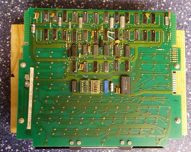

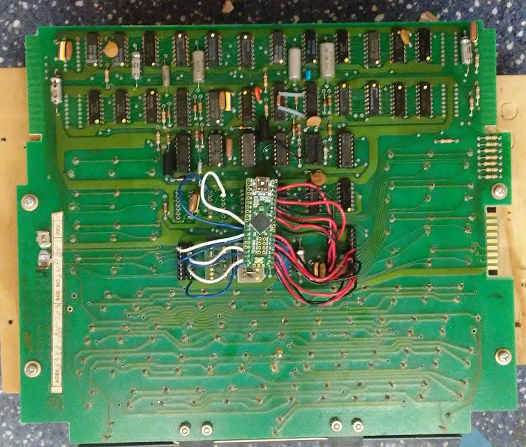

The PCB is interesting, it took a little while to figure out the matrix:

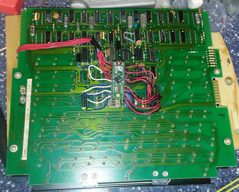

Then wired up the matrix to the Teensy 2.0++ and ran wires to the onboard LEDs:

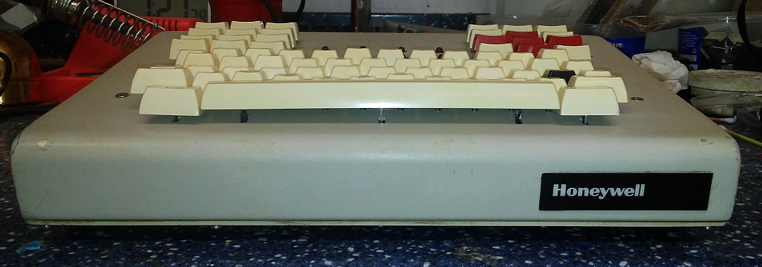

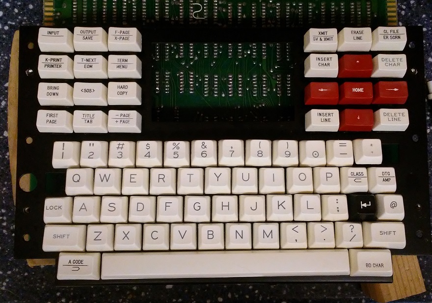

Cleaned up the case and then Retrobrited the caps and they look a lot better:

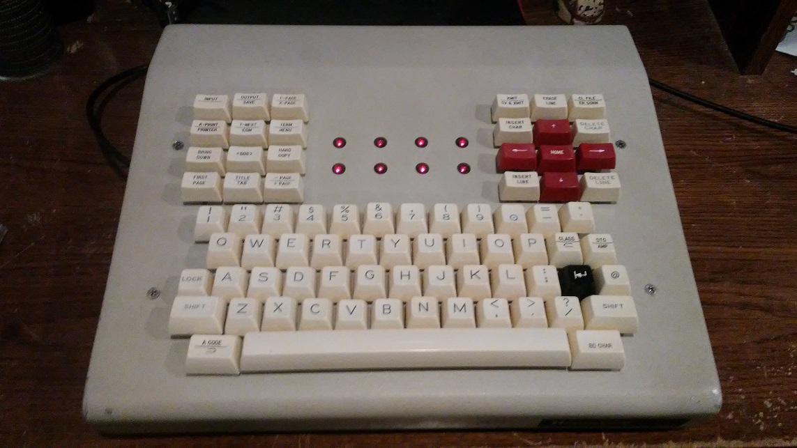

Flashed my firmware and tested, then reassembled everything and up and running:
Honeywell 5921 done small.jpg (218.52 KiB) Viewed 5432 times
The switches are linear, rather smooth and fairly heavy. Not bad overall in my opinion. I made a short video of typing on it:

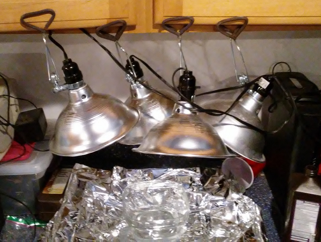

I've done several sets of keys now with 3% H2O2, a dash of OxiClean and simple clamp lights with good results so far. I posted some pics and a description here: workshop-f7/another-go-at-retrobright-t17393.html . I left my first set unsupervised for about 8 hours and got away with it but I would recommend supervising things closer as it is definitely possible to over bleach things.

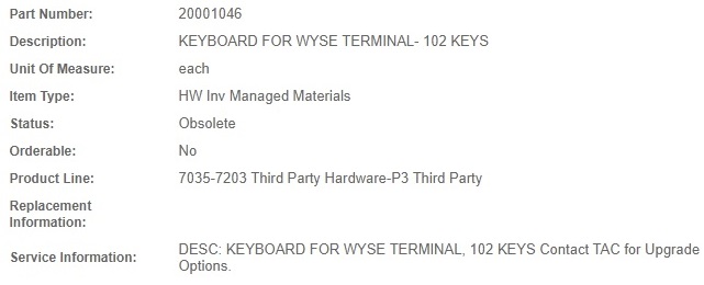

Well I've spent the last week going back and forth with Honeywell, trying to learn something about this keyboard/terminal. I had to set up a Honeywell account (which was not as easy at it sounds) and exchanged email with a number of people, but at least someone at Honeywell did make some effort to look it up and at least sent this:
Unfortunately, there are only 76 keys on this board so I suspect it's so old that they don't have any records. Well, I still have to thank them for at least trying to answer a question that certainly isn't going to sell any new product.

In that picture the black lights were overhead and the halogen lamps at the sides. Two lamps were attached to a board and two to overhead cabinets. Since then my set up has been ejected from the laundry room and I have been using it elsewhere in the basement (see pic below). I've done four, or I think five now, additional sets of keycaps with good results. Since the set up I have has worked well (and since the keycaps I've done have been vintage and I would be unhappy if I messed them up), I have not experimented further with lights, etc.
That being said, I have doubts that the two 60W CFL blacklights are adding much to the process. I'm not a chemist, but my suspicion is that it the IR EMR from the 90 watt halogen bulbs, which heats the peroxide bath quite a bit, that is primarily responsible for driving the chemical reaction forward. This could also explain observations that sunlight (approximately half of the suns energy that reaches earth is in the IR spectrum) seems to work better that UV lamps - though of course can't be certain since the sun's energy output across the spectrum is so great.
I think experimenting with black light only/ halogen light only , and heated bath in the dark, would be worthwhile. I just don't have any keycaps, or other yellowed plastic I want to experiment with at the moment.

In the picture you showed above, what are the materials beneath the lamps? I cannot tell if it is plastic wrap, plastic bags, aluminum foil, or some combination of these. Do you use a glass or plastic container for the hydrogen peroxide solution?
Thanks again.

Interesting! I used a glass (Pyrex) pan. The reflective materiel was from a Mylar emergency blanket I had on hand - no other specific reason I chose it.
So it sounds like something specific to the UV light. I have found the light mix I have been using does seems to work well. As you mentioned it would still be interesting to see how varying this affects things.

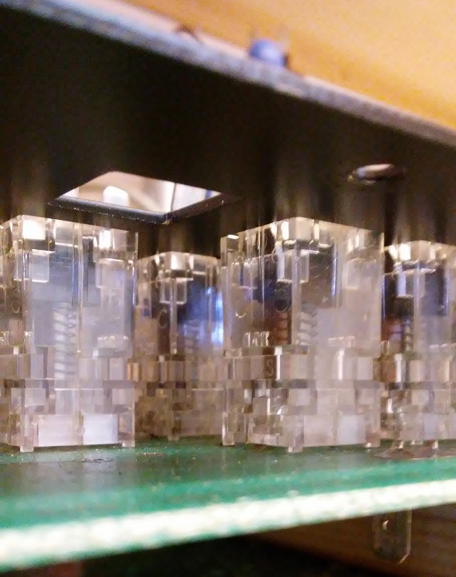

Menuhin
29 Oct 2018, 21:55
The close-up lit from above photo of these "OAK" switch housings makes these switches suddenly look like some kind of MoMA exhibition items. :shock:
