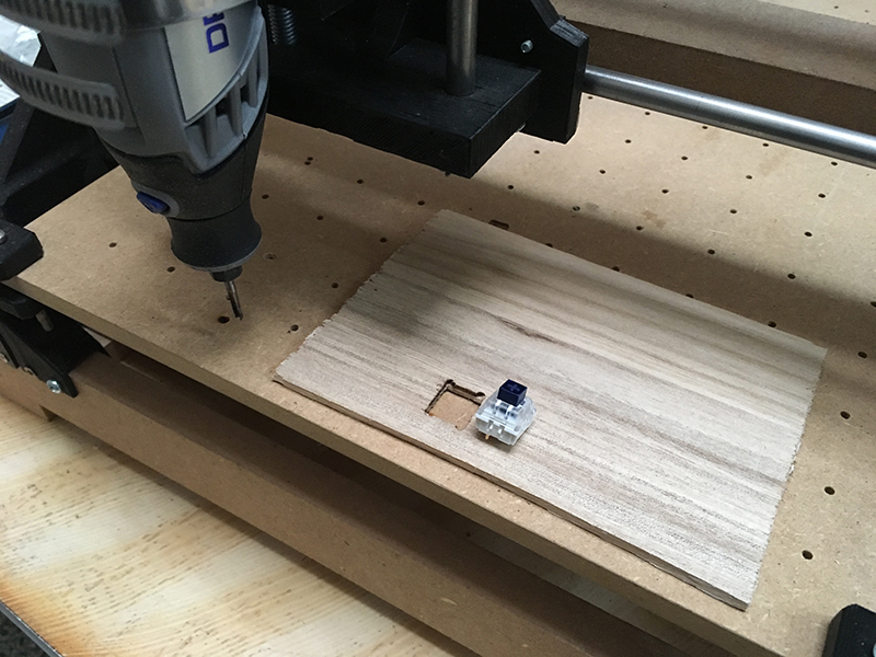

Hi all! After a long time trying to sort out life matters in order to have the space and the time to dedicate to this project, it's finally on!
My cheapo CNC machine has finally behaved itself and I've managed to send the right orders from the cad app to make my first successful switch hole (yes, it was way more complex than just push button -> print).
Cheap CNC apparently also means poor support from cad software, so I had to actually learn G-Code and modify the translator to run the right instructions during milling.
Next up is making a full plate out of that beautiful paulownia wood, too bad the plate is twice as long as the supported volume for my cnc, so there's gonna be some more trial and error...
If this is interesting to someone, anyone, then I'll probably keep this thread running with my attempts at making a whole custom keyboard.

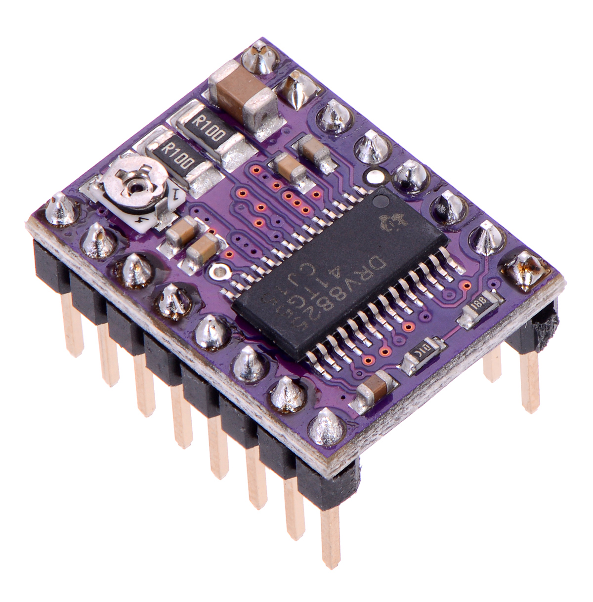

Last sunday I made the most significant progress with my crappy CNC, I had an issue where the vertical motor was skipping some operations, eventually nailed it down to this little thing here called the motor's driver:
Each stepper motor has one of these and if they heat up too much it will stop working for a bit.
Turns out that little screw in the picture is used as a potentiometer to regulate how much current goes from the driver to the motor, after regulating it all went fine and I was finally able to print.
Finding and solving this issue was hell! imagine a whole sunday spent testing all possible scenarios when all you wanted was to machine your damn switch plate!

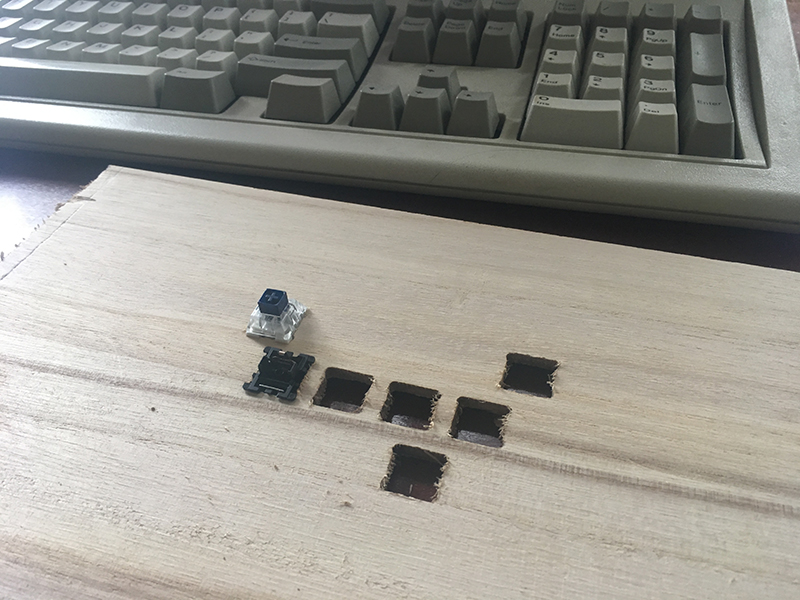

Finding the right size for the sketches took some attempts, putting just the right size of the switch in the cad software wasn't good enough, they came out very loose.
Eventually I've found the right measure to have a very firm mount for any mx compatible switch.
Photo 02-10-2018, 09 43 30.jpg (361.42 KiB) Viewed 4263 times
Oh, because of the grainy wood I guess, I did not need to level down the switch clipping area to 1.5mm thickness, it just fits on 4mm wood and stays there firmly.

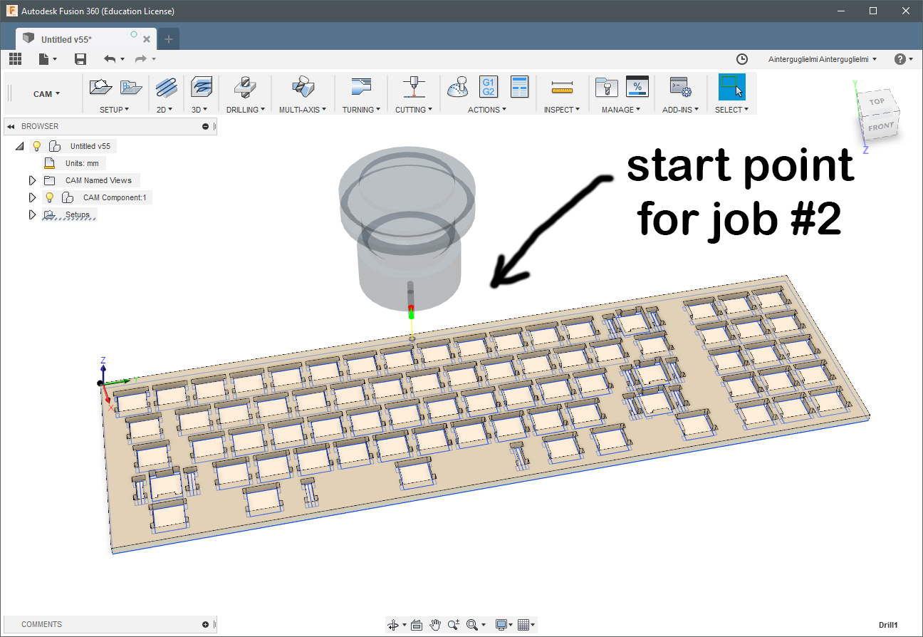

I'll probably do another post on how I can subdivide jobs for the cnc to machine a plate that is bigger than the supported print area.

The way the machine works is by telling it before each job where is the start point.
It goes like this:
1) I manually position the router in an approximated start position.
2) I hit start and the machine will start from that point.
3) in the cad app I make sure that before to end the first half of the plate it will leave a little mark on it.
4) Once job #1 is done, I move the wooden plate forward on the cnc and I re-center the router onto the little mark left from job #1.
5) hit start and continue with job #2.
This way I can machine a plate that is bigger than my cnc, which, when I bought this piece of crap, was my main concern.
There's still a lot that could go wrong, like hinges loosing up during the jobs, but I'm working on that too to reinforce the cnc structure.

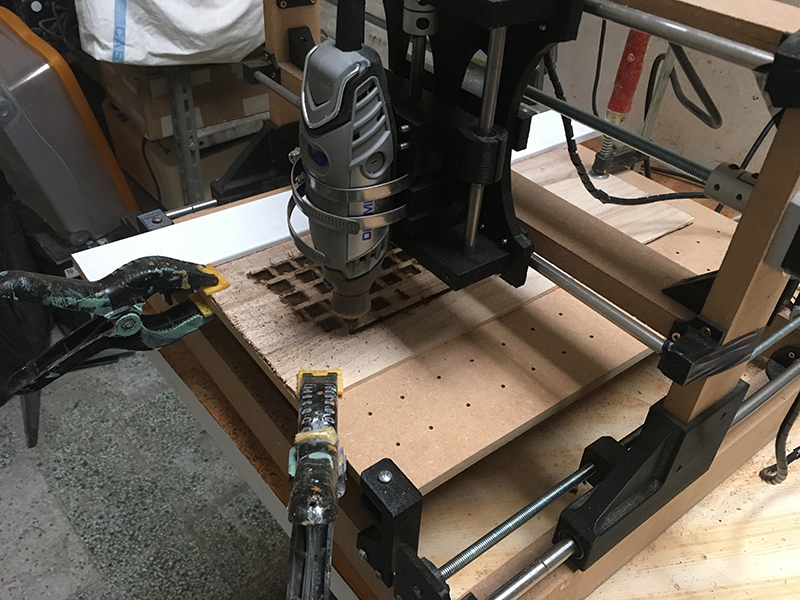

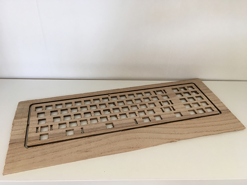

It took another few attempts, but I can now make my own wooden plates fairly quickly : )
Photo 07-10-2018, 08 55 58.jpg (294.64 KiB) Viewed 4177 times
Photo 06-10-2018, 13 39 49.jpg (420.41 KiB) Viewed 4177 times
I'm already working on the case, I'll keep working on 4mm sheets of wood, I like the DIY kit feel of this project. Taking the machined piece out of the little tabs holding it and giving it a light sand is lots of fun.
