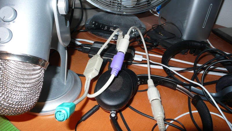

1. I never found a AT->USB.
2. I use several AT to PS/2 and PS/2 to USB converters. Some work , some don't. I never really got a handle on them. I just keep trying till the combination of them work...
Typing this on a AT connected chicony kb-5181 :
The AT to PS/2 to USB
