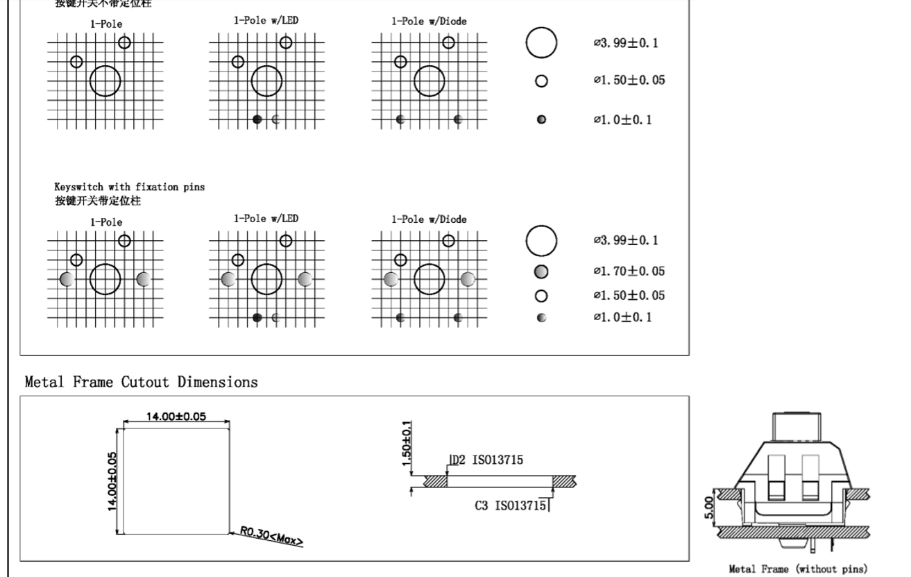

Switches are NovelKeys x Kailh BOX Thick Clicks Navy. Looking at the data sheet it seems they need square holes but I honestly have no idea how they are supposed to "mount" to the plate with the square hole. It appears they press fit between the small tabs on the body ?
I am familiar with KiCad as I've used that before for a totally different project for a simple Hakko solder tip holder. As stated, no traces required for that but was just an exercise to learn KiCad. Relearning 5.0 release now.

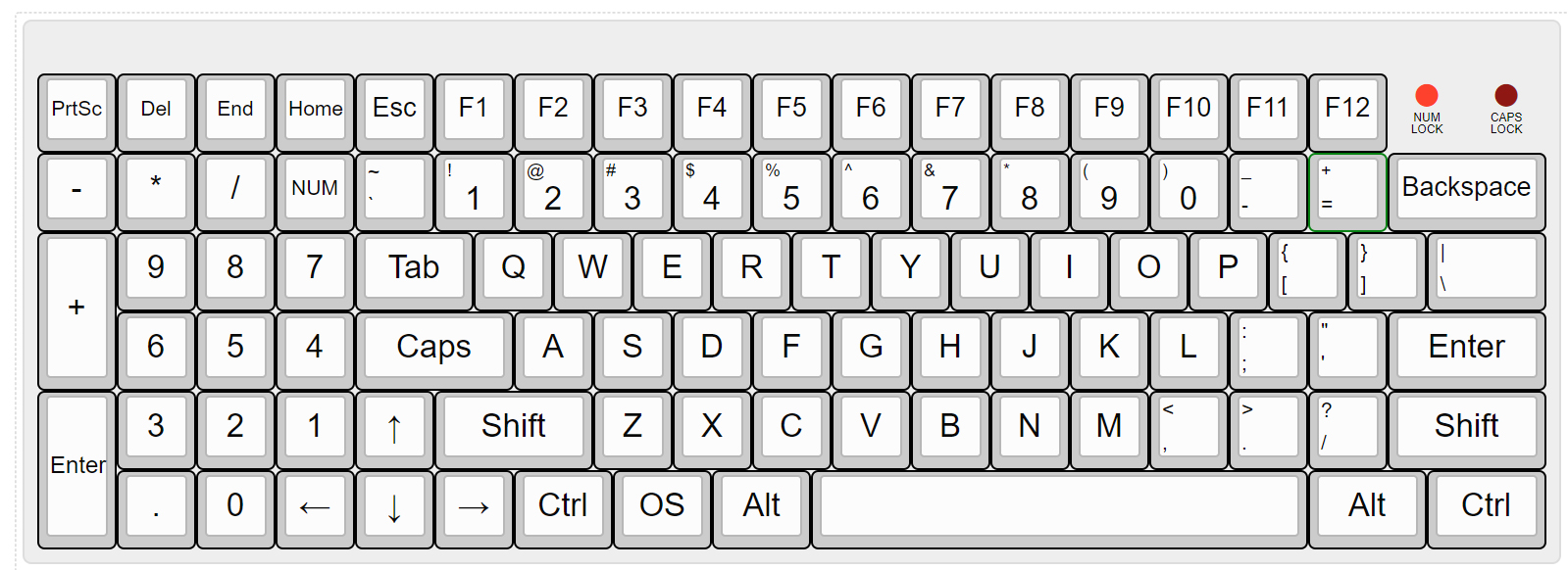

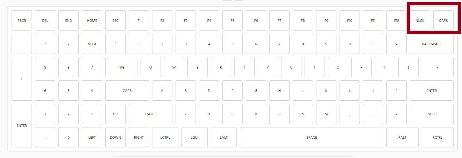

I am not entirely sure how the matrix works but have a vague idea. Vague meaning I know when a switch or combination of switches is pressed, that results in a unique series of closed contact points being sent to the controller. Other then that, I'm lost.
My matrix would be slightly mirrored but not exactly. As you can see the numpad is on the left and is mirrored to reflect what I thought would be proper. There is a proper way to type and I'm not there yet but learning. This seemed like the right choice. This also leaves room at the upper left for the num lock and caps lock indicators I'd like to include.
The idea is to make this a left handed board, work the bugs out and learn how it's done properly. After that I'd like to do a full on Russian keyboard, but with some changes that I need to understand in order to program properly. An example would be replacing № with @. There's no way I'd be able to use a keyboard without the @ symbol in this day and age with email lol. Can't see a time how the № symbol is relevant yet in the language but the @ is a must.
Little details in symbol programming, key spacing and correct footprint placement on the PCB will also need to be learned. The default unit seems to be 19mm from center key to center key. I'll need to figure out the proper placement in KiCad and go from there. Maybe you are correct on starting out with something more simple but I honestly have no use for a 4 x 4 pad at this point. Might be a good way to learn with less information though but still wouldn't get me to the goal of a full 104 layout.
ETA: By Correct Paths I mean the correct way to connect the columns in the matrix. The ANSI 104 is angled the further in you get on each side. Making the choices unclear for me as to what switches are connected to each other.

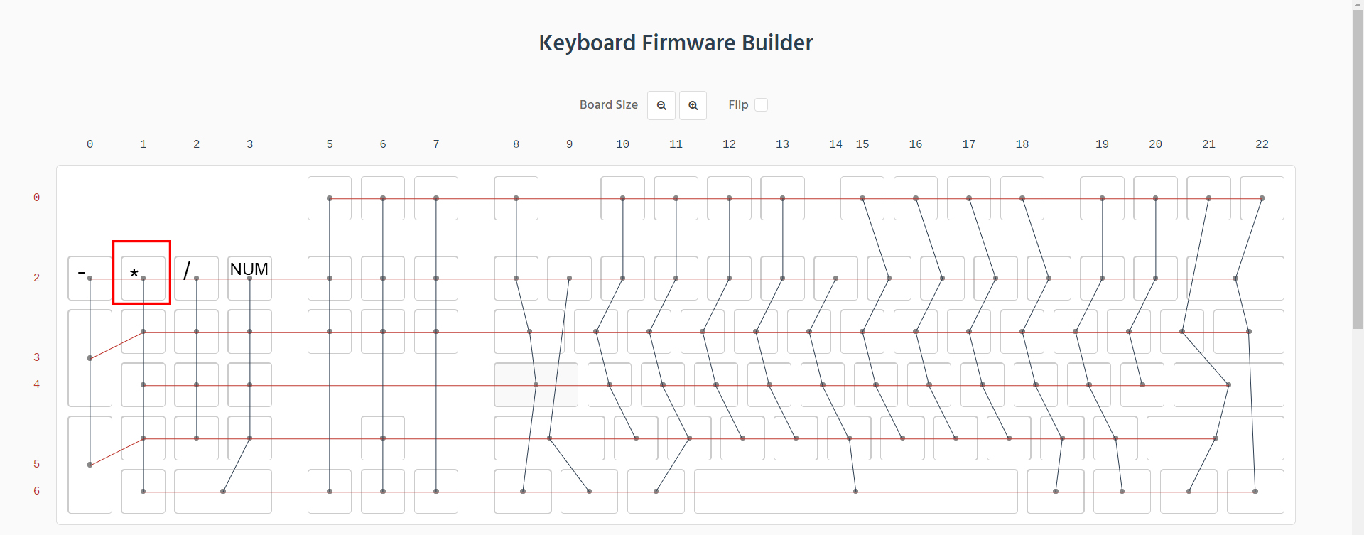

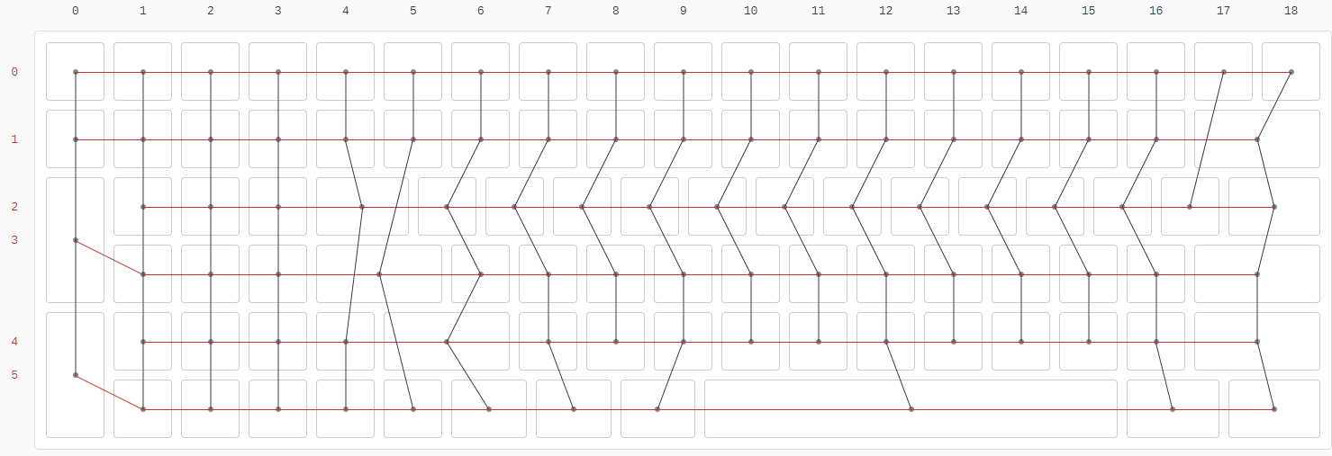

When you press an ohmic (contact) switch, one column and one row close a circuit between two pins of the IC or microcontroller. Every key is a unique combination of row + column and hence a shortcut between two pins.
Let's see a quick example, first I have this numpad:
And his matrix:
For example, * is the same as row 0 + column 2. Which is the same as B0 + B7.
You only need to be sure that every key is a unique combination. The page builds the code for you, nothing more easy than that.
And his matrix:

This is where I'm lost. I had no idea you could choose the pins yourself ? Thought you had to pick pins in some sort of order ?
This is what makes it so confusing...
What would you put it for the layout below using the Teensy ++ 2 ? That's really the only way I'm going to understand this I guess.
- LH-Example.png (110.18 KiB) Viewed 8102 times

Just use the ones that the page gives to you. It's the safest way because these microcontrollers sometimes have oscilators or pins with weird outputs.
I couldn't tell you what combination was the key in the picture because I don't know what pins you have assigned by default (but also you can choose your pins if you want). When you are wiring your keyobard and you want to know what pin is what, you need to see the "PINS" tab. Pins are not necessary related with the row/column number and all of them work by the same way in two groups, which are rows and columns.
This is not related to the keyboard firmware, but will help you to understand some points. Every letter in a pin name is just a port, and the number is a bit from this port. For example, B5 is the bit Nº5 from port B. In the PIC era you were forced to use the entire port as input or output, if you were using a pin from the port B to turn on a LED, you were not able to use any other pin from this port as an entry. Fortunately (and not), in our era, in most microcontrollers you can independently define each pin as an input or as an output. For example, if you use a PIC for a keyboard (which I never seen before), you will need separate ports for columns and rows, because one sends current and the other receives it, I don't remember which one does what, but just think like "male" and "female" pins. This is why you will find rows and columns with the same letter and it will turn confusing, but do not panic, it's normal. Just be sure you don't have any pin repeating in somewhere. And also this explains why you can't connect two columns or two rows.

Don't use BOX switches! The cruciform shapes are too thick and have been shown to break keycaps' stems! There are several threads about this.
Yes, the switches are supposed to clip into the plate with the small tabs on the north and south sides of the switch. These are (supposed to be) are on plastic springs that are part of the switch housing.
The use of the clips require the plate to be 1.5 mm thick. If it is too thick, they won't work and it will only be a press-fit (the tabs will be pressed in all the time).
Not quite. The unit is 3/4 of an inch, where an inch is 25.4 mm. That makes one key unit 19.05 mm.
It does not seem like much but when you have more switches and keys that are multiple units, it adds up.
Do use a scheme for labelling the logical rows and columns in the schematic. I suggest R0,R1,R2 ... and C0,C1,C2 ...
The convention is that each "column" is strobed and that each "row" is sensed.
The microcontroller strobes each column one at a time in series by shorting its pin to ground.
Of course, these are logical rows and columns, and your logical matrix does not have to correspond to your physical layout but it could make it easier to reason about and lay out.
You connect each switch in series with a diode. Which side of the switch the diode is on does not matter but it has to be "pointed" towards the column.
Diodes allow you to have n-key rollover. (This is so taken for granted in the community that people rarely mention it, but it wasn't already, so I do it just in case)

Can anyone explain how the status LEDs are connected and assigned ? It's probably simple but I'm just not understanding what to select in the Keyboard Firmware Builder.
The first picture is a potential layout. The second picture is the wiring generated by Firmware builder. Third picture is the key map and the LEDs in question are highlighted. The builder seems to be treating these as keys with wiring and KC codes. What's confusing to me is where is the option to indicate they are LEDs and not keys in the builder ? Or am I just missing something altogether ?
