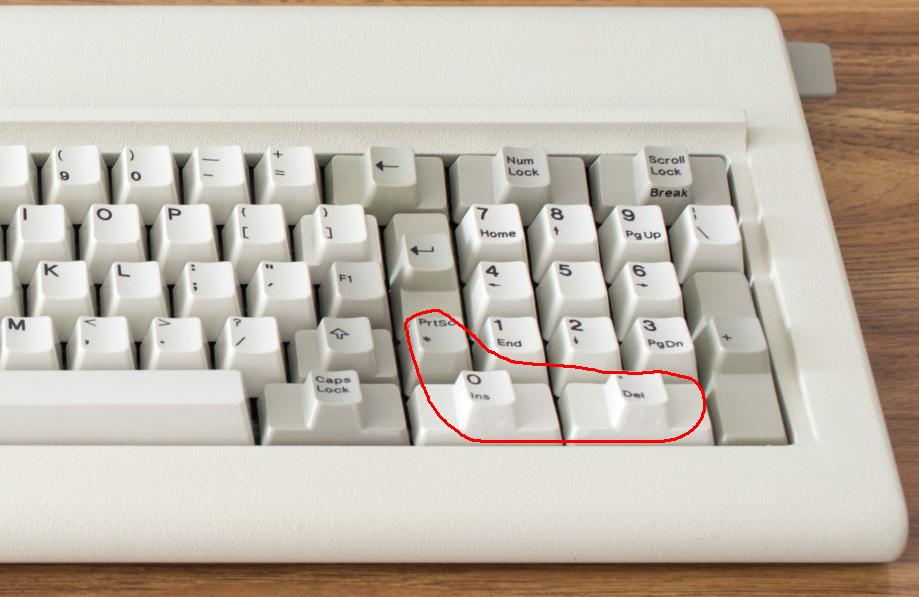

Waxwood wrote: ... Also, they keyboard appears to lack a Delete, Insert, and Print Screen.
Are you talking about the Model F X? It's all there:
