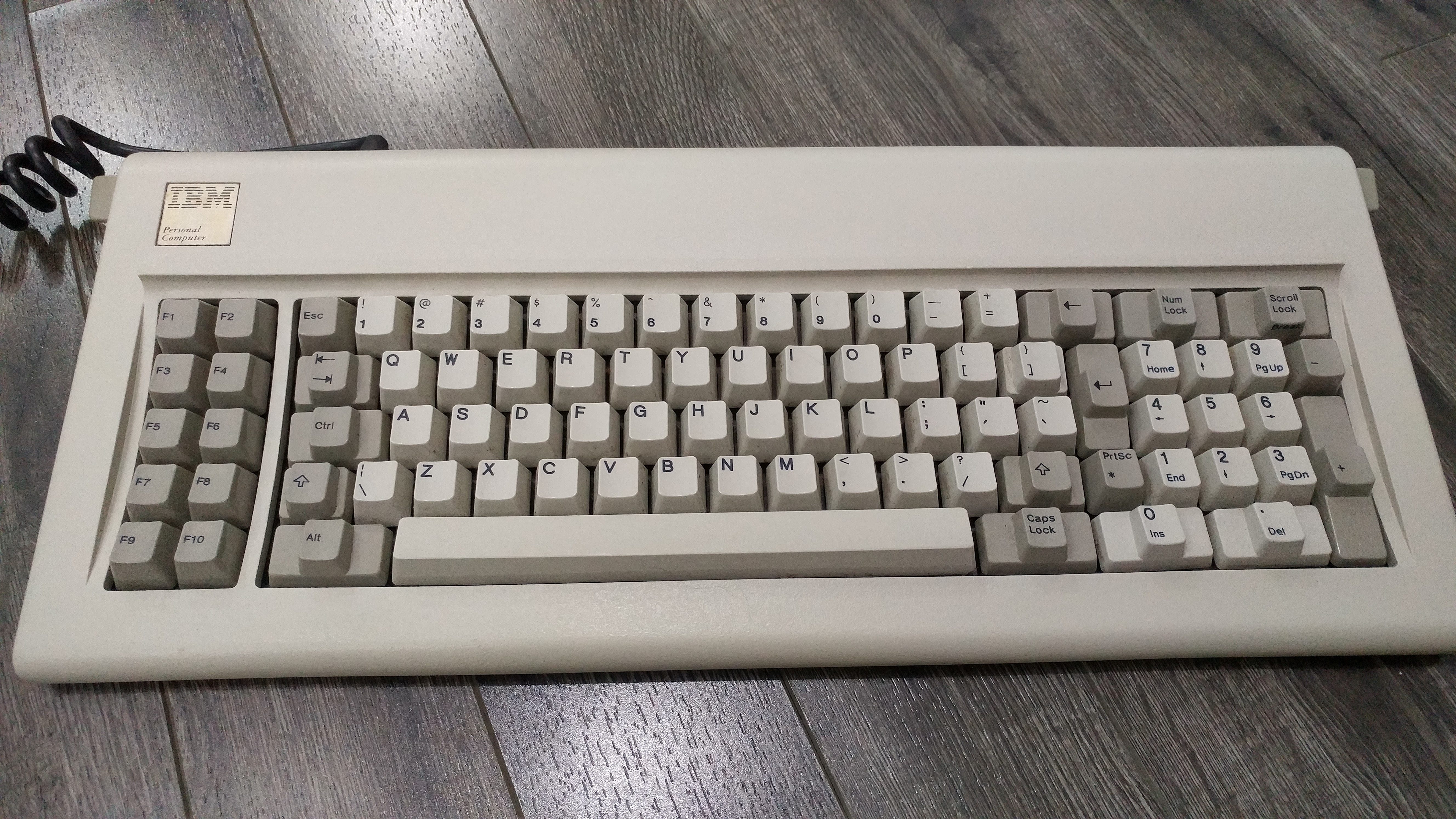

I recently received an IBM Model F XT keyboard.
It appears to be in very good condition. I've attached a photo.
However, it is quite dirty, and I want to take it apart, clean it, possibly dissemble it completely, replace the foam.
I'm not sure where to begin or even how to remove the keycaps properly.
I have watched Lucar's video (https://youtu.be/wPOe0Pmd3gs) several times, but am wondering if there is a set of systematic instructions on how to do this. Some of processes in the video are not quite clear, but it is indeed an outstanding video.
I'm guessing that a number of rebuild guides exist.
I also have a couple of other question, the ALT key does not make any 'click' noise at all. It depresses and springs up quite nicely, but it does not click. Is that normal? What might be wrong?
Also, in my typing test, the space key is indeed much too stiff. I just found these step-by-step instructions/video on how to do the key-mod: workshop-f7/model-f-improvement-dis-ass ... t6982.html
Any other advice on modifying the space key?

Congratulations on your new keyboard. It looks quite tidy, indeed.
I get the impression, that replacing the foam has become a "must", through all the nice tutorials floating around.
Apart from a NOS keyboard, I have opened and cleaned 4 dirty XTs so far and none of them needed the foam to be replaced (although they were quite degraded - meaning you could sometimes brush off the upper layer of the foam, where it's visible).
The key feel and sound were the same (or even better actually), compared with the NOS board with intact foam.
If the keys work fine and the barrels sit tightly, I wouldn't open the two metal plates. If it's not broken, don't fix it.
Unless you really want to do something about the space bar. Then you have no other choice, I guess.
Concerning barrels: It's normal, that the barrels in the top left corner (F1, F2 etc.) are a bit loose, but that's because the one bracket of the barrel plate, that's bend differently than the others, is usually not tight enough. You can press the two plates together with your fingers and will see that the top left barrels are then tight as well. So you can correct that with pliers easily.
Concerning the Alt key: That's probably just, that the spring doesn't sit correctly in the keycap.

+1 on the leave the foam alone. I have 4 model Fs, all used, and never needed a foam replacement on any of them. If the foam needs replaced, sure go do it. But often it’s just fine.
I have been inside most of my Fs, though. Just not for foam. I like to explore their layouts.
My Kishsaver went from this:
To this:
All just by opening it up and moving hammers and stabilisers between barrels. Well worth it!

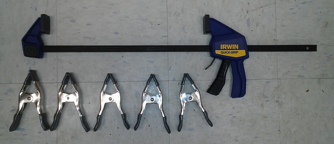

Waxwood wrote:
I'll see if I can document the clamping process using C-clamps.
If you have gone to the trouble to repaint your plate, the sliding is likely to scrape under the clamp feet unless you pad them with fabric or cardboard. My guess is that you are looking at 3mm-4mm sideways.
The spring clamps that I show in my 122 ANSI guide have the advantage of spring pressure rather than absolute clamping.

As far as board reassembly - I did my first XT board "by hand" with hand pressure and a rubber mallet to align the plates - it was a major pain in the butt! Then I wised up and read more on DT and GH about rebuilding these boards and learned about clamps - as others have mentioned on this thread. My subsequent reassembles have been WAY easier! I've been using spring clamps and a bar clamp, like these:
I can't remember whose post I read about this on , and can't seem to find it right now, but with the spring clamps holding the plates together, I've found the bar clamp pops them back in position very easily!

I'll get a few more hand clamps. I only have 4 right now.
The one member advised using C-Clamps, but fohat recommended against it for reasons that seem quite sensible to someone who's never done it yet.

.... with the spring clamps holding the plates together, I've found the bar clamp pops them back in position very easily!
Thanks for this advice! I've started to prepare my tool kit. I'll proceed carefully to be sure I don't break anything.
