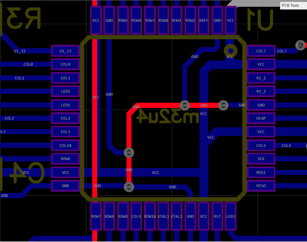

My confusion stems from going over the open source GH80-3000, which uses the ATMega32u4-AU and has support for 117 keys. Trying to create a standard 101 - 104 key PCB using the ATMega32u4-AU and it just doesn't seem like there are enough pins on that chip to support 6 rows, 21 columns and status LEDs. I'm probably just not understanding how this all works yet, hence this post.
It's my understanding that each row and each column needs it's own unique pin on the chip. The ATMega32u4-AU has 26 pins available for use, which is not enough for 6 rows, 21 columns and status LEDs as I currently understand. The AT90USB1286 MU has 48 available pins, which would be more than enough. Unless I'm just not understanding how the wiring matrix works with the controller, which is quite possible.
Just trying to create a left handed keyboard, as it just makes more sense to me as a die hard Numpad user. Obviously I'm in way over my head and am trying to learn how people know what controller to chose and ohh you need some decoupling capacitors here, sprinkle some resistors for the LEDS over there, wire it like this etc...

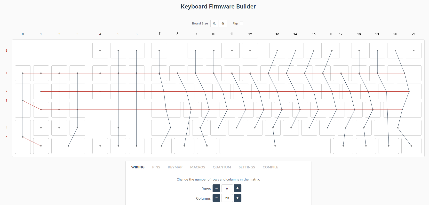

Sorry to ramble but that's where I'm at right now. Sitting in KiCad looking at the board matrix, counting rows and columns. Looking at the Firmware builder and the ATMega32u4-AU data sheets, not finding pins on the chip that Firmware builder says to use. Those pins are on the Teensy 2++ but not the ATMega32u4-AU itself. Which makes no sense to me why the firmware builder would say to use pins E0 - E7 when selecting the ATMega32u4 as the controller when the only pins on that controller are E2 and E6 ?

I guess understanding how the matrix is created is my issue then. I was under the impression that it should follow the physical layout of the keys in order to be valid ?
An 11 x 11 matrix would be perfect for the ATMEGA32U4 but I'm not understanding how an 11 x 11 would work if following the wiring shown on firmware builder.

Zoomed in on the PCB a bit and think the LED question answered itself. Looks like Pins 30, 29 and 12 are used for the LEDs ?

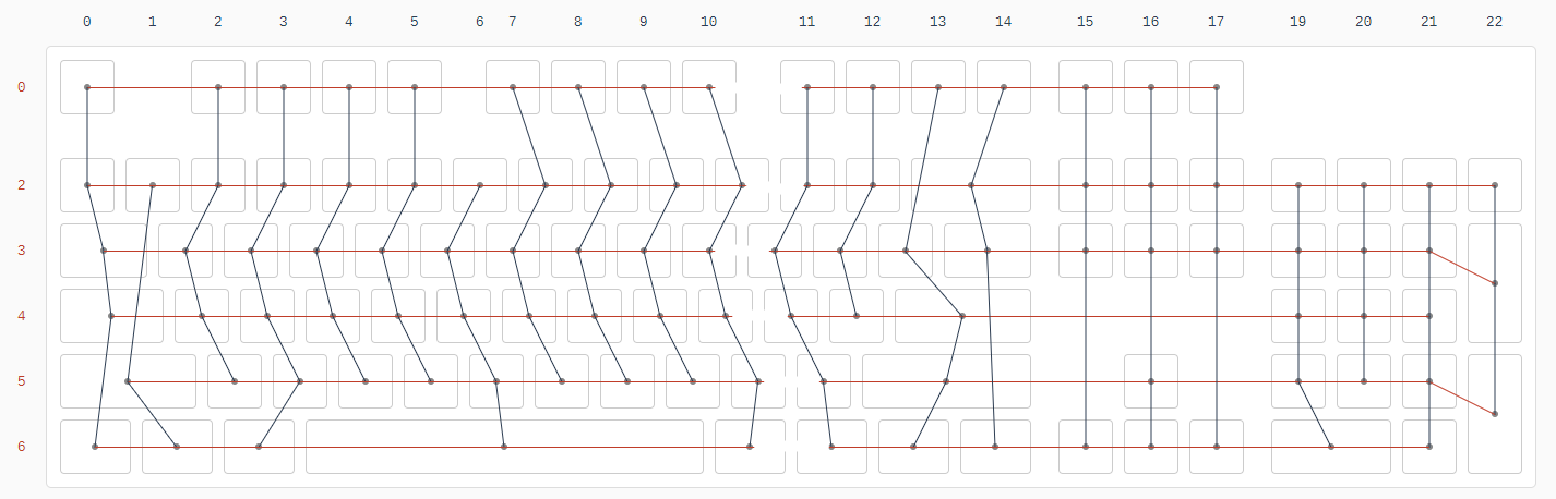

You have already drawn a matrix for 6*22.
Consider two adjacent physical columns as one keyboard matrix scanning column. For the sake of scanning, you will get 6+6 = 12 rows. You get an easy to wire matrix with dimensions of 12 * 11.
As for as creation of matrix with dimensions 11 * 11. Just divide the switches to ordered groups of 11 pieces. Then one group is one column in the scanning matrix. First row will connect first switches in each group. Second column will connect second switches in each group ... etc.

vvp wrote: You have already drawn a matrix for 6*22.
Visualized version of what vvp said:
then wire column 0 to column 11, 1 to 12, and so on up to 10 to 22.
You'd have to manually specify the details of the matrix in order to generate compatible firmware for it.

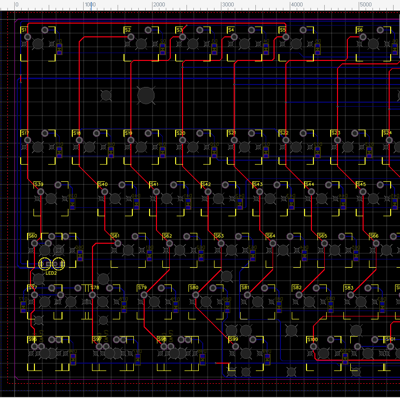

The replies here made me go back and look at the PCB design again and to actually start following traces. Sure enough there are long columns in a few places.
Now I understand how a " 6x22 " can fit on the ATMEGA32U4 by simply extending some columns to include more keys versus actually trying to physically mimic the key layout on the board. I'm still wondering if anyone has used the AT90USB1286 for a board though and will keep looking. They are twice the cost of the ATMEGA32U4 though.
