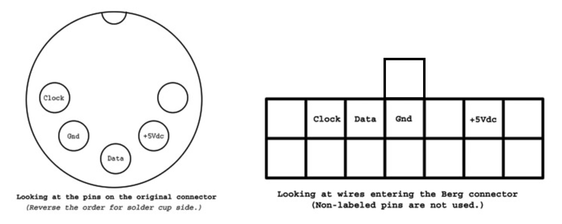

That's the pin assignment:

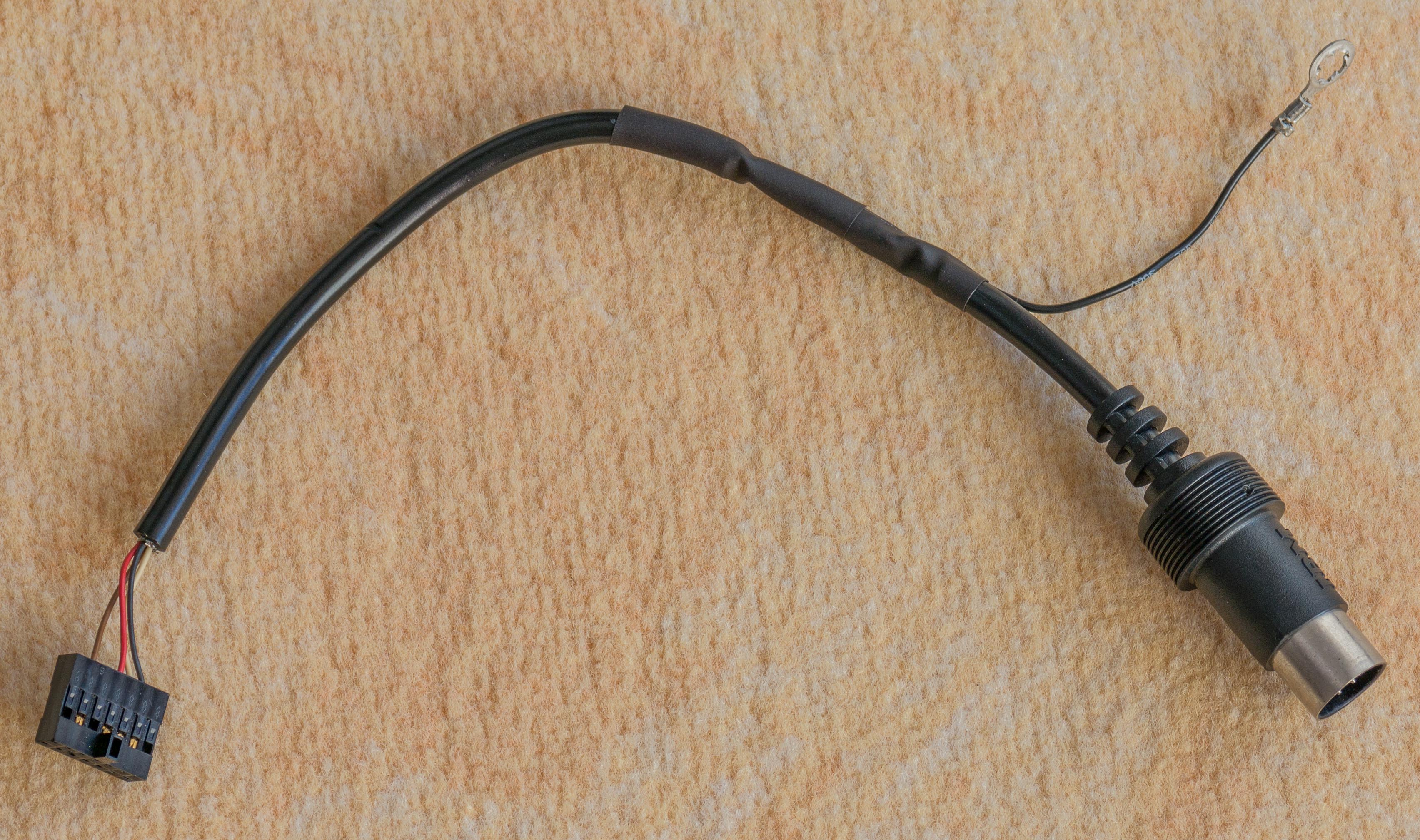

If the cable is indeed broken, you could do an internal USB mod, which I've done twice so far.
First I soldered the two ends of the original cable together. (Testing it two times during the process to make sure, that the damage in the cable is not in these pieces.) Then all you need is a long USB extension cable and you can put all inside the case together with the Soarer's converter:

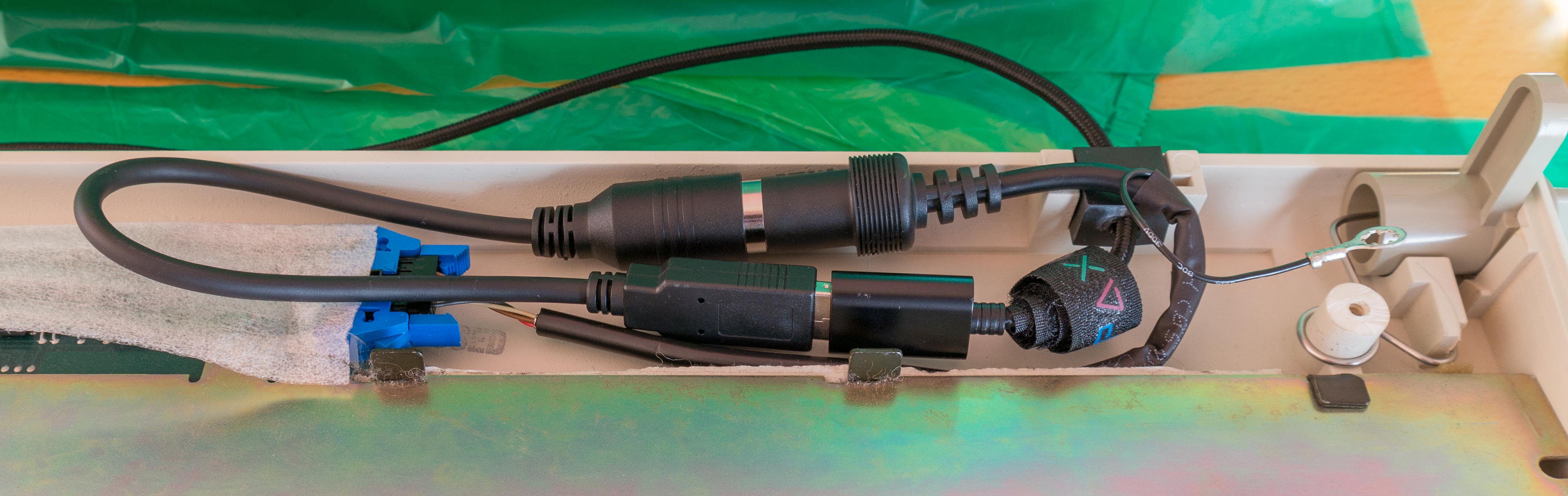

On my first XT refurb, I installed an internal Teensy with Soarer's converter and a USB-B connector so that I could have a detachable cable. This required drilling three holes in the case -- one of the connector opening and two on each side of the opening for the mounting screws.

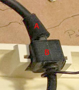

"grom(m)et" is this one, right? (sorry, not my native language) (In my pictured case part A was already ripped from part B, so I didn't reuse it.)
Part B is kind of glued to the cable, so I doubt you can get it of without cutting it open on one side.
Then there would be the other question: How would you get it onto the USB cable in one piece?
(In my first conversion I did use the whole grommet after cutting it open over the whole length. Inside the case it doesn't matter anyhow. On the outside (part A) it has the cut on the underside and I didn't bother trying to glue it or something.)

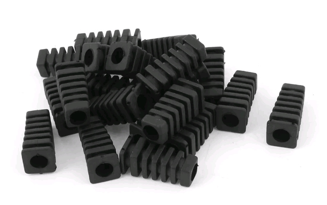

Ok would something like this work and also where does the ground cable go and is it necessary?

Sure - after some modification - and if you can get it onto your usb cable in one piece.

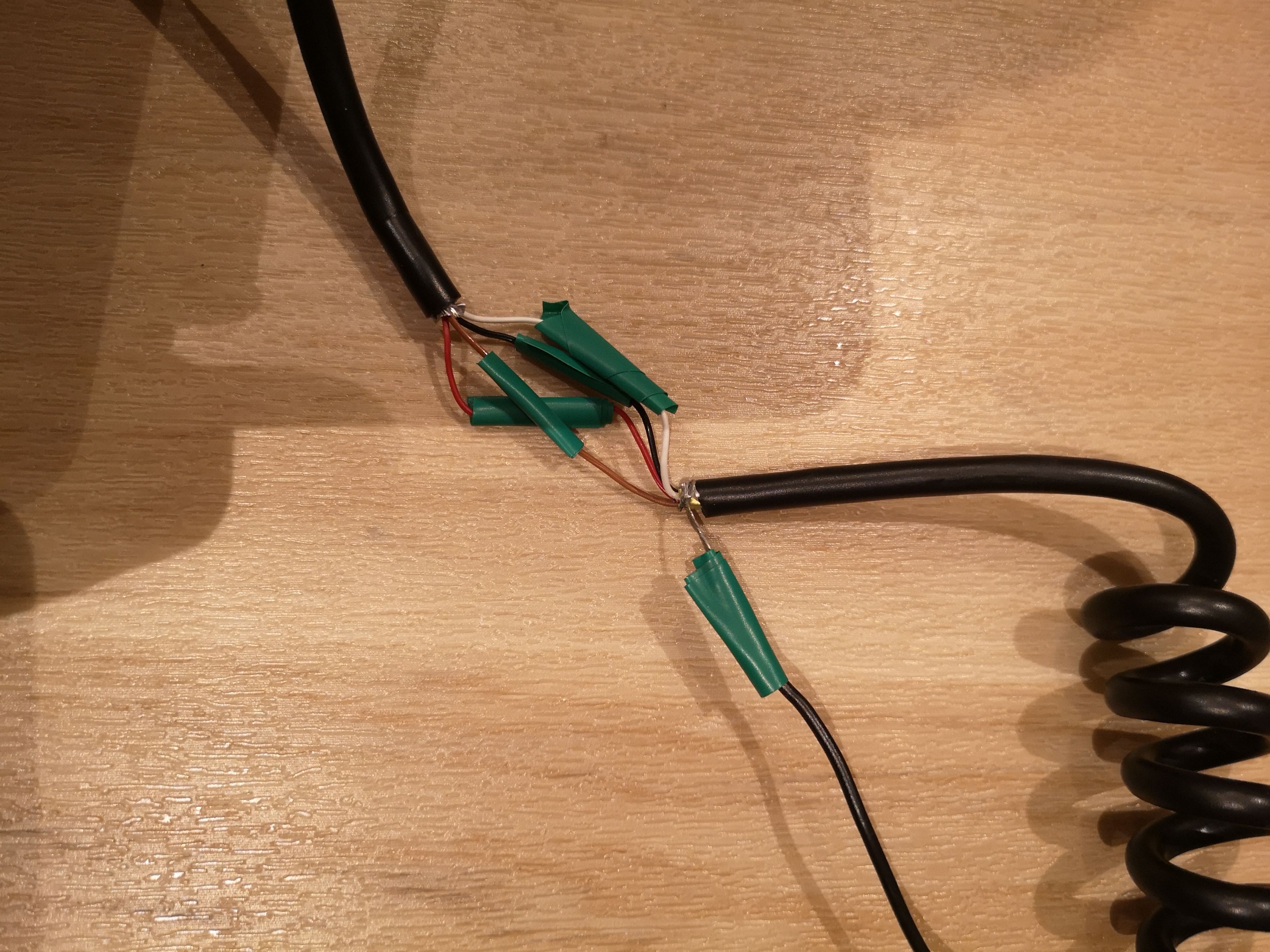

Yay turns out the original IBM strain relief was sevoured also the ground cable was too and after some splicing of the cables the keyboard is now working Thanks everyone for your support
I have uploaded some pictures of the wire
connections it's very messy but it works.
Now just need to tidy all the wires up.
