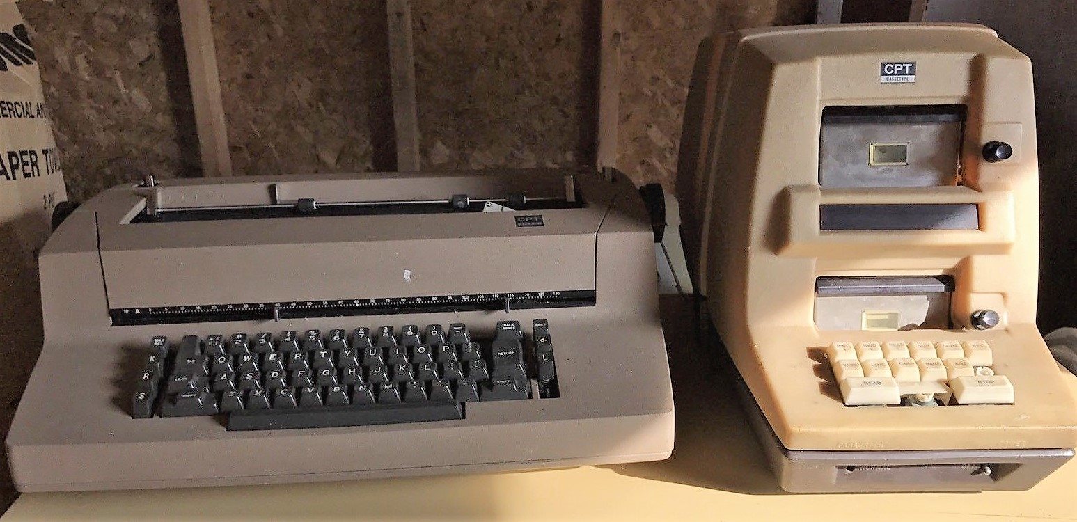

I am guessing the keys and all internal mechanical parts have been replaced with a Cherry keyboard; essentially making the IBM Selectric a keyboard for input and a printer for typing out letters. I have a few cassettes that have letters stored. Anyway, I was just curious if there was an actual IBM Selectric model that had a Cherry keyboard or if this had been extensively modified to remove the entire mechanical keyboard mechanism. Here's what it looks like. Naturally, more pictures to follow when I can take it apart. The keys on the console are pretty cool too. This is from 1972 or so.
CPT 4200
CPT 4200
CPT 4200.jpg (225.33 KiB) Viewed 3512 times

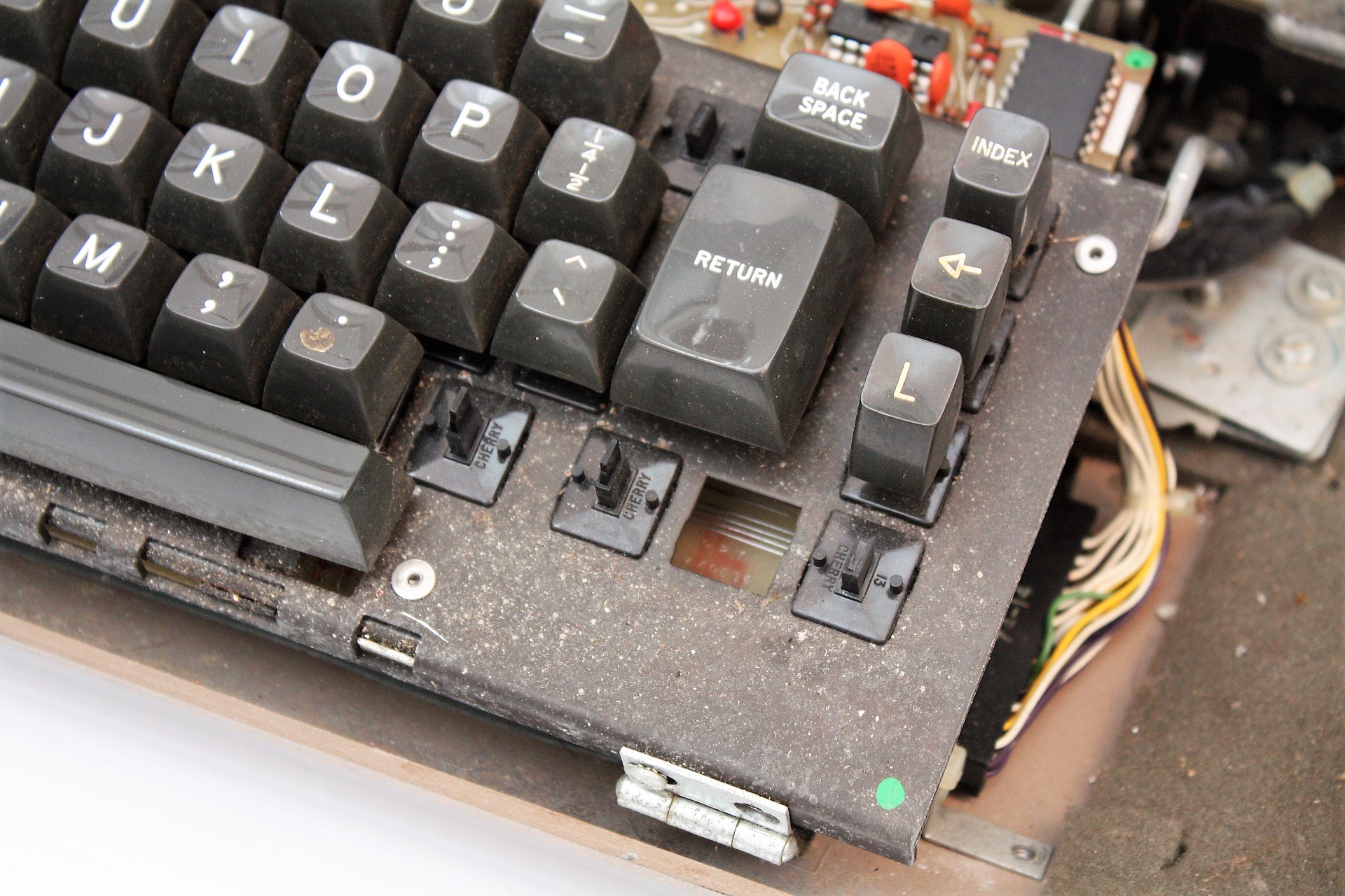

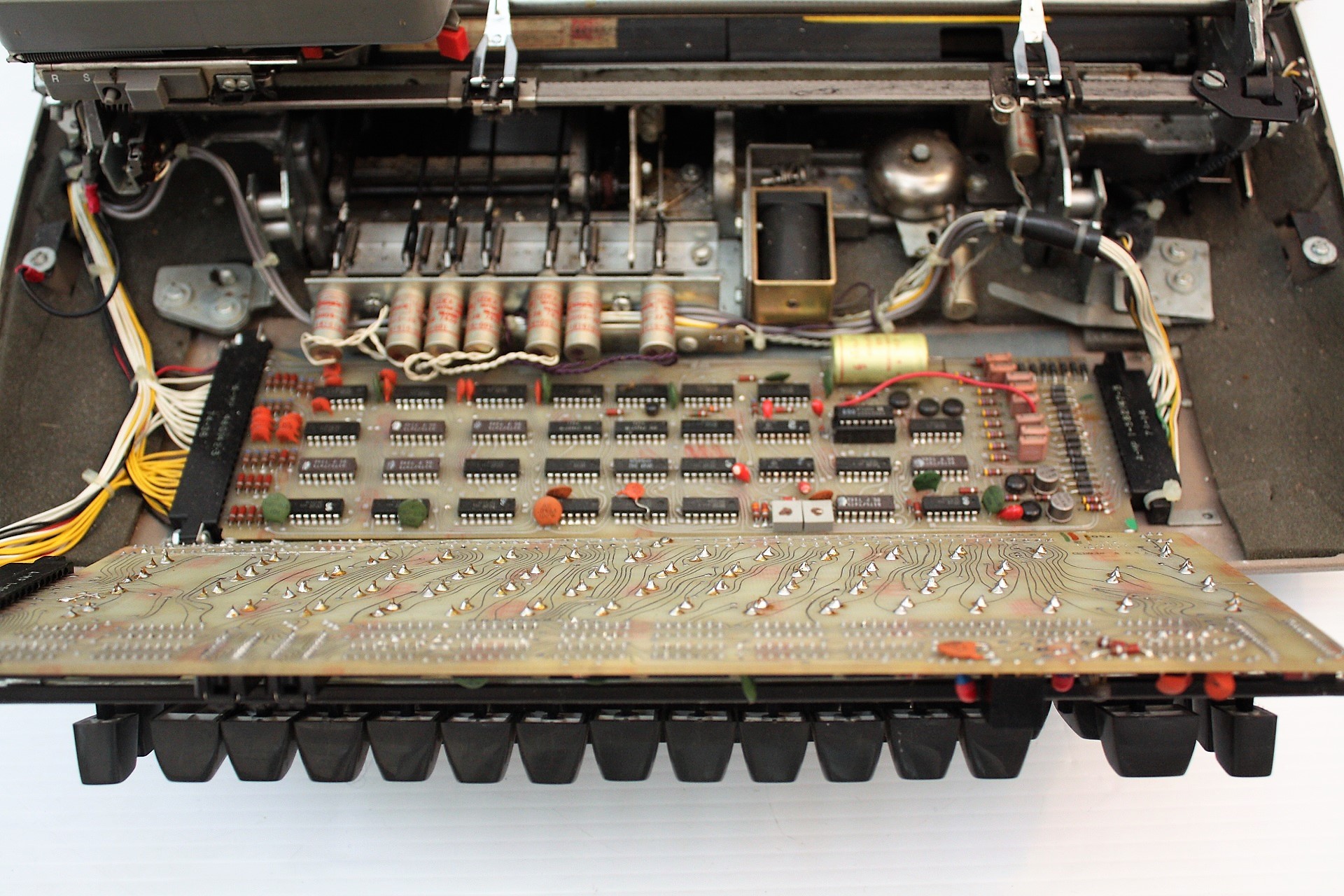

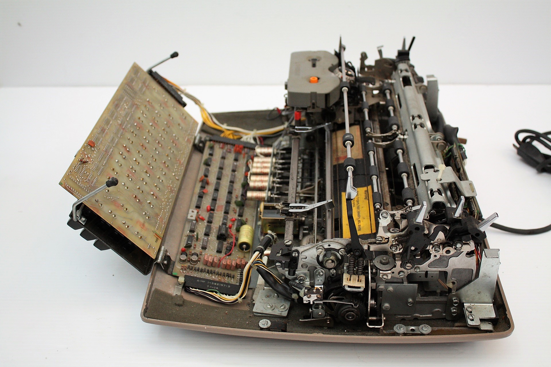

I don't know exactly what was in them to begin with (I'll look around) but here are some quick pics while I have a little daylight light. How did they do in terms of what you were thinking?
Key Caps/ Cherry Switches
Front view with keyboard folded out
Side view with keyboard folded out

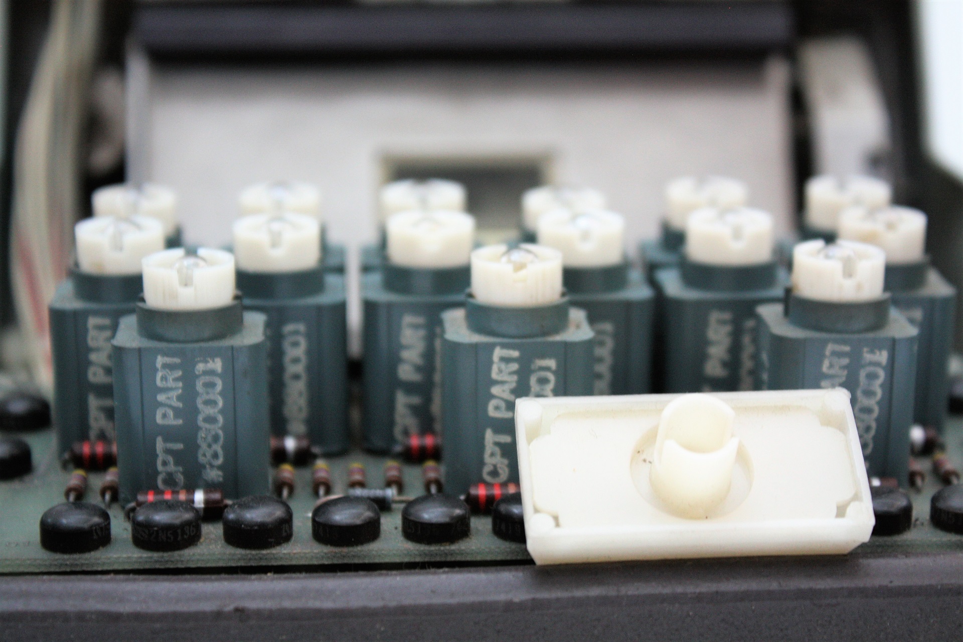

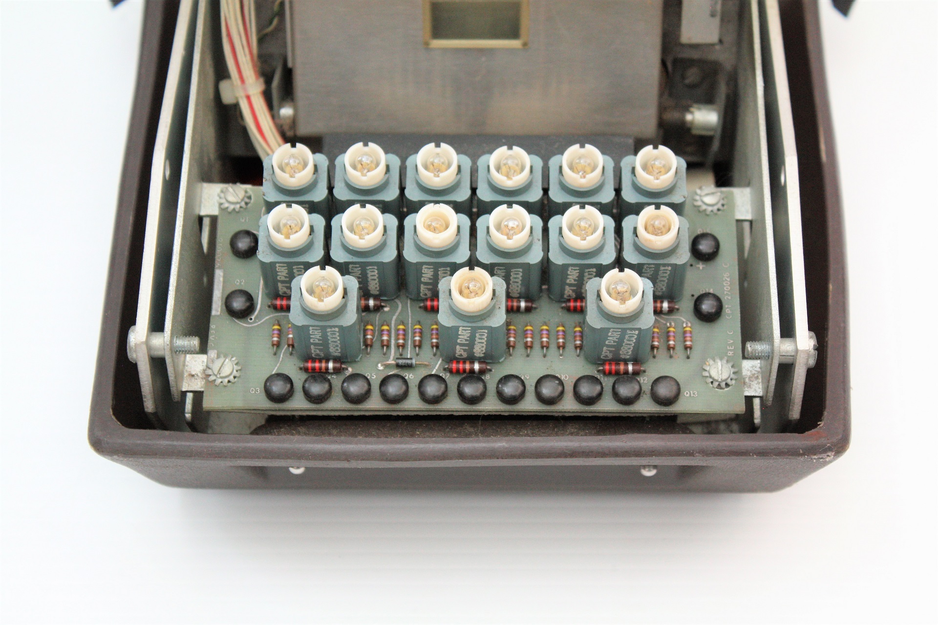

Screw LEDs. Incandescent bulbs is the way to go! These are the key switches on the console portion. They light up.
CPT key switches with incandescent bulbs in the centre
CPT switches with hollow opaque key cap
