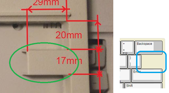

This board was made using imperial measuring system, but measured it using metric as accurately as possible. Here you go guys, for future reference:

Ok, I can't take this anymore. Generally speaking, I don't like to chop off parts of a keyboard or do major modifications to it that aren't really needed, but in this case... this being a PCJr keyboard to begin with, I'll say that THAT growth on the case should be sawed off and the freed space be used with an actual key.
Gaaaaaaaaaaaaah. Chop this off!!! (YMMV)
zrrion
14 Dec 2018, 19:42
Look, he's already using a board most people wouldn't even look at, he might as well embrace the quirks of the layout.
14 Dec 2018, 20:11
The lower left side we can call a quirk (YMMV); the \gap, OTOH, is just a design defect (YMMNV).

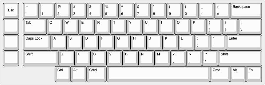

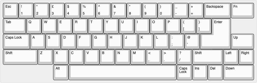

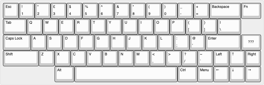

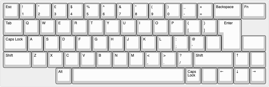

Working on rebuilding PCjr keyboard on my own. Come here for layout advice.
Here is original layout: http://www.keyboard-layout-editor.com/# ... 7d9c443fdc
Here are few layouts I'm considering, any ideas what may work best? Any other creative ideas?
"Chopped" http://www.keyboard-layout-editor.com/# ... 2290a82fda
"Standard keys only" http://www.keyboard-layout-editor.com/# ... 23c36e7ac4
"ISO Enter" http://www.keyboard-layout-editor.com/# ... d04e13dc65
Excelso
17 Oct 2020, 23:40
The second one seems pretty good for me.

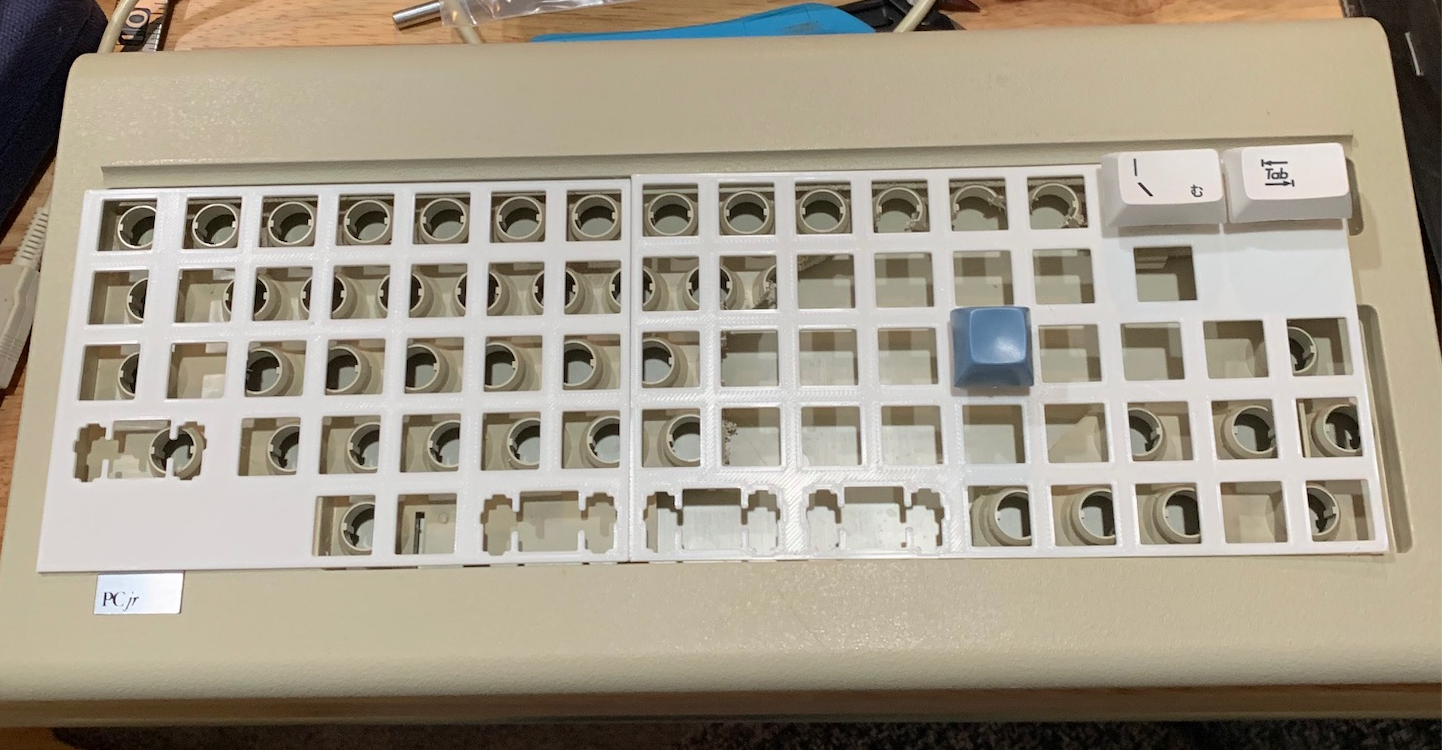

@rayndalf I highly doubt original keycaps are reusable. The way Enter and Spacebar mounted is just awful and not reusable.
There were some ideas around adapting keycaps by making inserts for them or inserting smaller MX keycaps into PCjr's.
Progress so far is I have plate working, need to figure out if hand wire or try PCB design next.
