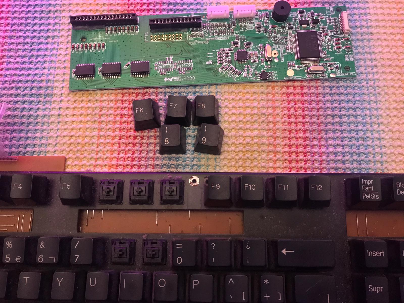

At first i connected them stright away but they didn't work at all. In fact they both made windows pop a "non recognized hardware" message up, so i decided to look for more info in case they needed a special software or something. It seems not to be the case, so i think the board may be dead. I disassembled one and the board seems to be in good condition. Here are the pics:

Does Windows give any more information when you plug it in? A more detailed error message might tell if the keyboard is broken in some way or if it would just require drivers.
I suspect that it could identify as multiple interfaces: keyboard and card reader, and possibly more.
I don't use Windows myself so I don't know what's available. If you were using Linux, I would ask for an output from the "lsusb" program. First "lsusb" to get the Device's ID's, then "lsusb -v -d <ID>" to get how it describes itself. If not in lsusb's list, an excerpt from the output from the program "dmesg" where error code should be found, if any.

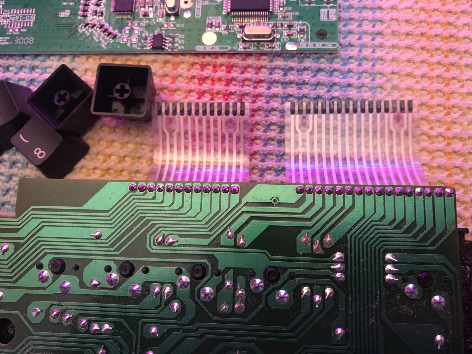

Otherwise, you could connect a microcontroller to the flat connectors. I count 12 and 16 leads respectively. 3+1 of these should be for the LEDs though, the last one common. If you don't care about two of the LEDs, you have 24 I/O lines which should be enough for a Teensy 2.0 microcontroller board (with 25 pins), giving you one LED.
But the question is if it would be worth it. Beside the cost of the controller board, there would be a bit of work reverse-engineering the matrix, programming software (called "firmware" when in a microcontroller) and some soldering.

Too bad. I would start with downloading the source for TMK firmware (or other similar keyboard firmware for the Teensy 2.0). There should be a directory with subdirectories for different devices. Copy a directory for another keyboard and start by modifying the files within.
This does not look like it has diodes, so you would have to enable ghost detection/blocking.
It looks like the matrix is all on one side of the PCB with jumpers on the top side, all of the same length. Reverse-engineering the matrix should be straightforward ... but an amount of work.

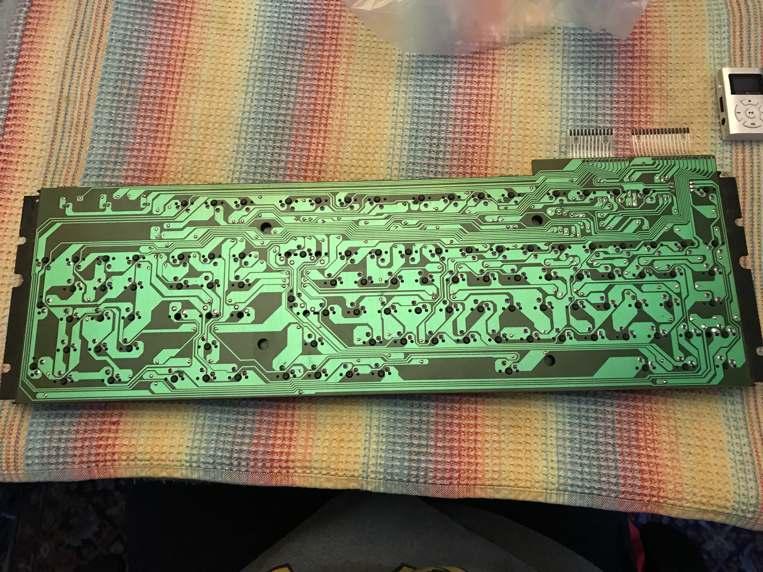

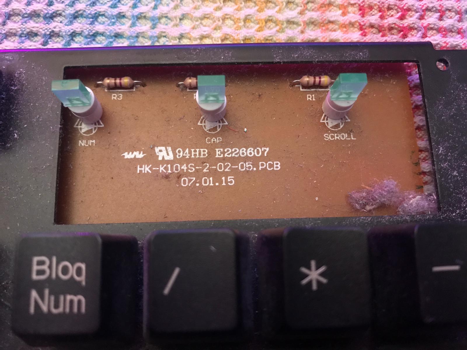

30 Dec 2018, 17:19
The PCB is a single sided simple one, and i've discovered the leftmost three are the leds. Again, i don't know if this is a standard thing or every single keyboard have their own proprietary connections, and they all look almost the same.
Here's the picture of the entire PCB connections, in case you wanted to see it:
