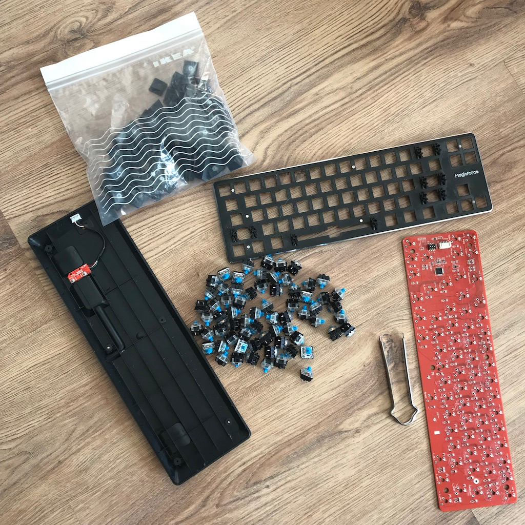

I have a dinky Magicforce 68 keyboard, which I bought when it was first announced simply because I liked its keyboard layout (I still do). It also has a nice metal top plate. However, every other aspect of the keyboard turned out to be terrible: the keycaps are shite, some of the switches (I went with the Gateron Blue option) lost their clickiness, and finally the controller died, leaving the keyboard 100% dead.
At the moment I need a semi-decent keyboard to use at work, and I want to rebuild this MagicForce into something better as cheaply as possible. I'm going to reuse the existing case and the top plate, but pretty much everything else has to go.

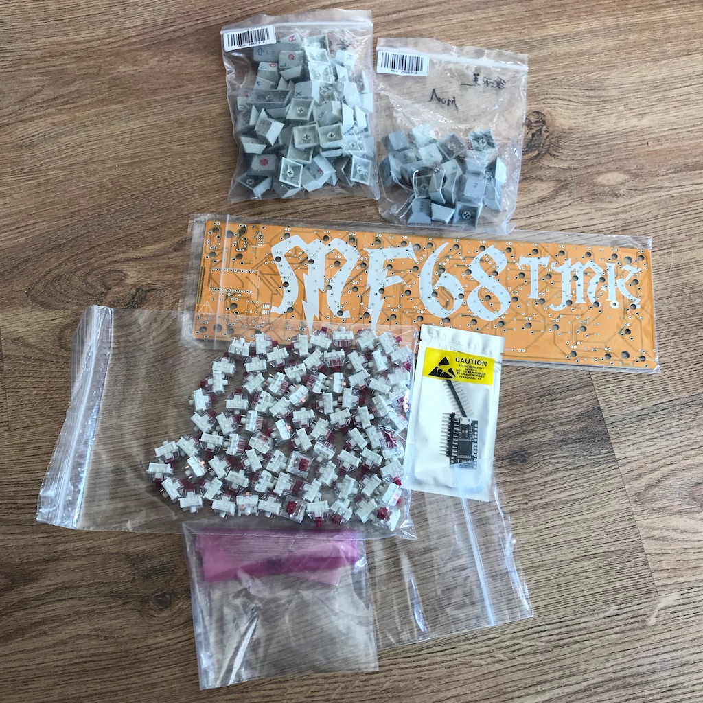

For this project, I settled on the following components:
- MF68 PCB
- a cheap Pro Micro controller
- Kailh Pro Burgundy switches (mostly because I got a bag of these for free; they also seem to be pretty quiet which is important for an overcrowded office)
- QMK/TMK firmware customised for MF68 by 40percent.club
Not decided upon yet: keycaps (I'd like something PBT and inexpensive).
To be continued when all the components I need for the build arrive.

The old stuff, disassembled. I used a cheap desoldering iron from CPC Farnell and it worked surprisingly well, it took me about 20 minutes to desolder all 68 switches.

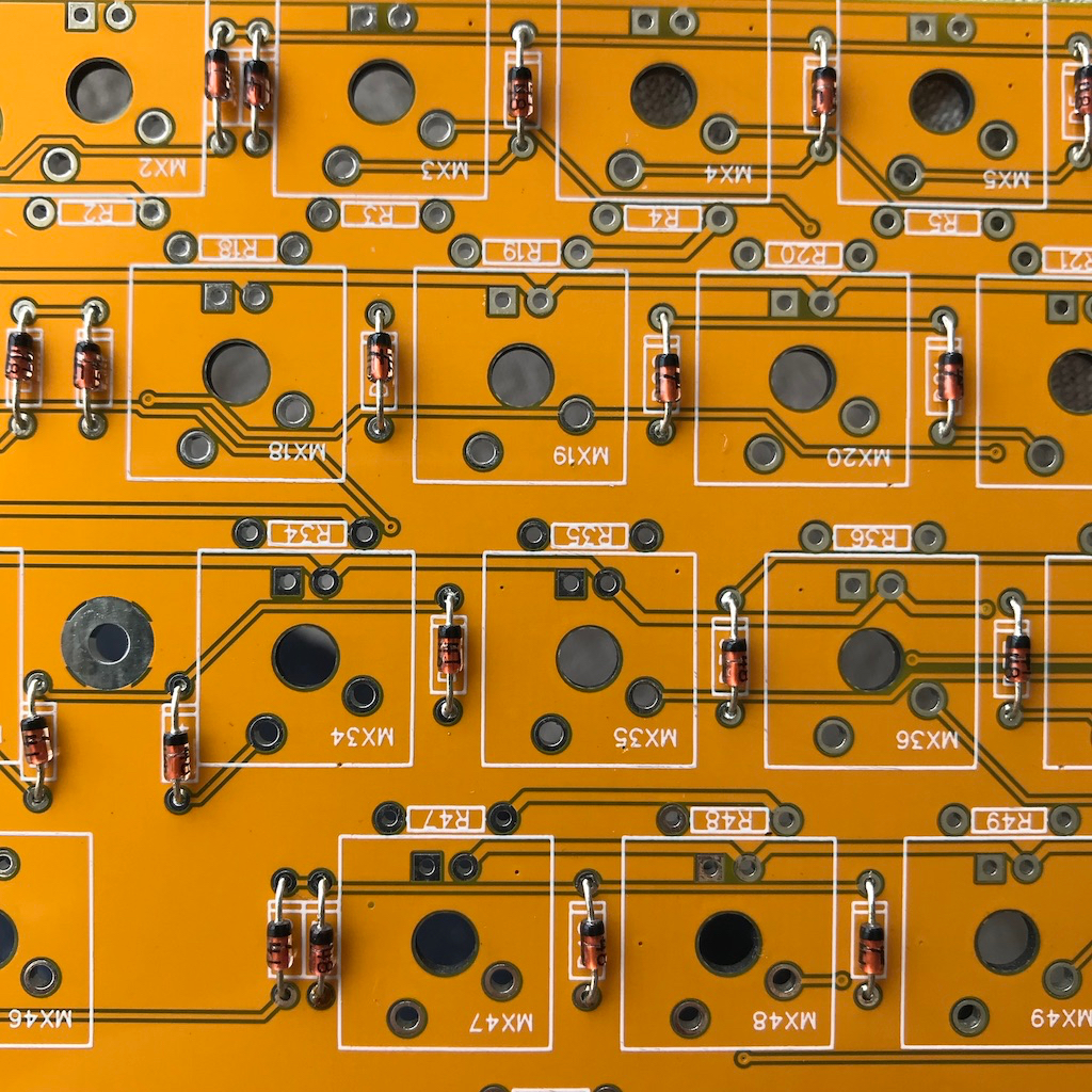

New stuff: MF68 PCB, Kailh Pro Burgundy switches, a Chinese Pro Micro (and pin headers), diodes, keycaps.
The diodes are in (this was probably the most tedious part of the process).

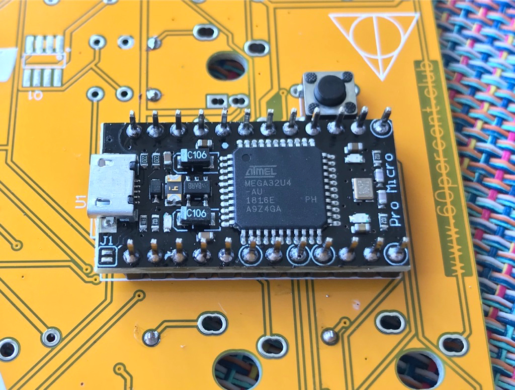

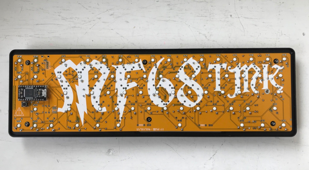

The microcontroller and the push-button are in.

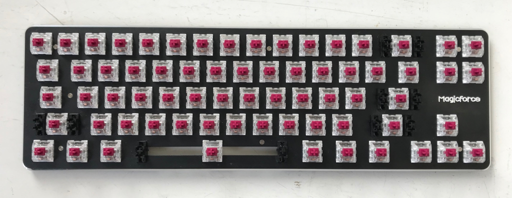

The new switches are in (I cleaned the plate before installing the switches).
Almost done with the soldering. (Later I discovered that I forgot to solder a couple of switches... oh well.)

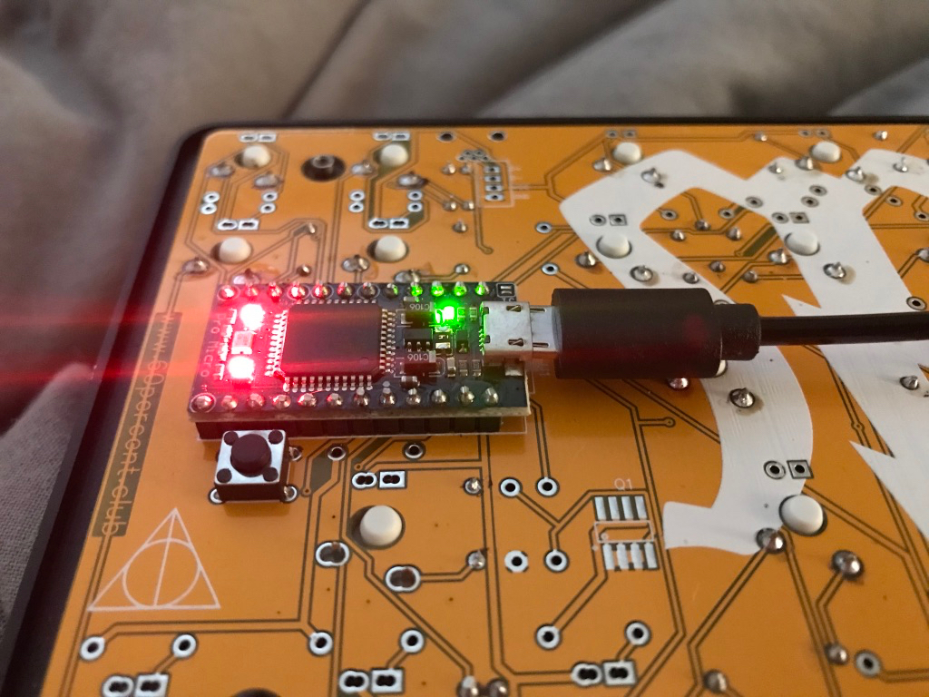

Flashing the firmware. For some reason, cloning QMK from Github took more than 2 hours.

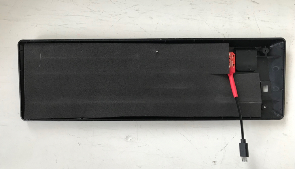

Preparing for the final assembly (or so I thought). A piece of thin craft foam is there to reduce the amount of noise the keyboard makes. The pigtail is made from a cut-up microUSB cable. This particular cable turned out to be very annoying because all four wires inside the sheath were the same color :twisted:

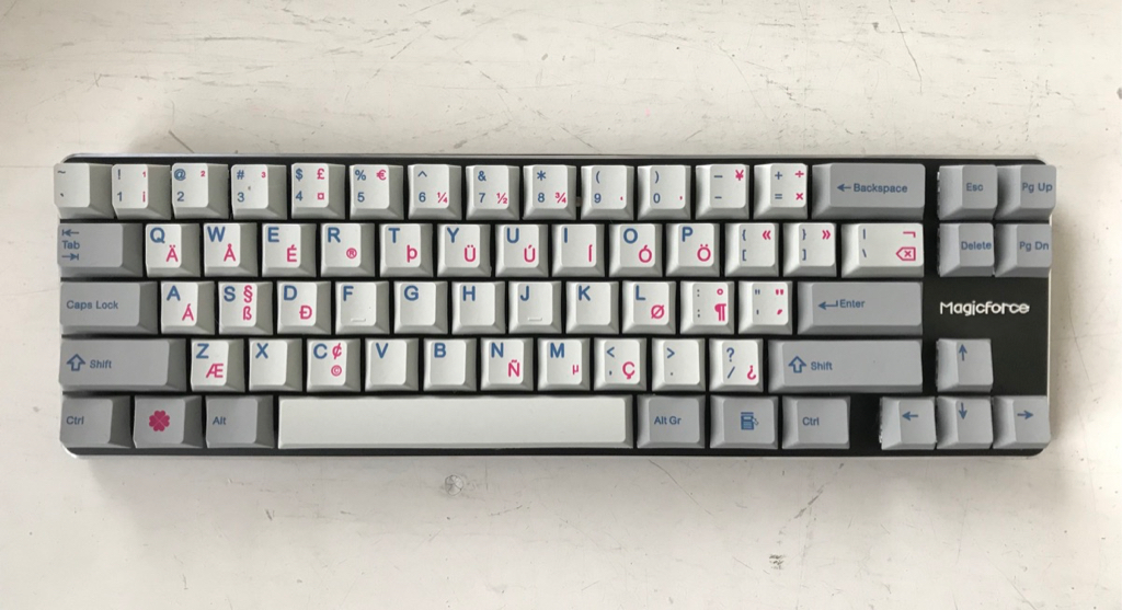

Final result:
The whole process was much faster and quite a bit less painful than I anticipated. I am now thinking about building a split ergonomic keyboard before the end of the year...
The keycaps are KP Republic Irish (PBT, dye-subbed). They are actually quite nice despite their very low price (I got them for about 18 euros I think).
Pleasantly surprised with the switches as well, they're noticeably quieter than Cherry Red/Brown/Black. Very smooth. I've read that they're not the best in terms of lateral stability, but they have about the same amount of wobble as my Filco with Cherry MX Brown.
The only problem is that I don't know what to do with this keyboard, I wanted to use it in the office but in the meantime I tendered my resignation :-) I still have 2 weeks left, but it just isn't worth it to bring it into the office for just 2 weeks.

Just three days in, the keyboard stopped working. I opened it up and discovered that the very stiff cable I used to make the pigtail... simply sheared the micro USB port off the Pro Micro. Now I understand why people complain about the goddamn port all the time. :evil: I managed to solder it back on with a heat gun and a pair of tweezers, and it even works (!), but I will need to get a softer cable to make a new pigtail.
