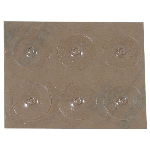

Hypersphere
01 Feb 2019, 20:00
There is a product called "Loc-Dots". They are clear plastic circles with central nubs designed to be homing key locators. They are available on Amazon for $4.29 for a sheet of six.
